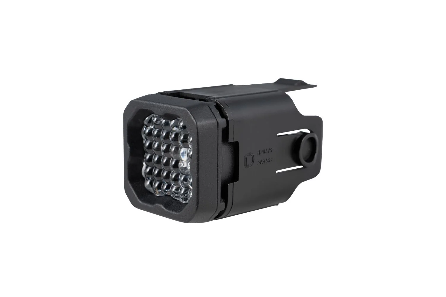

My word of advice.... Do yourself a favor (If you have a trailer hitch) and just go with the @Diode Dynamics, Stage Series HitchMount LED Pod Kit.

Installs in about 5 minutes. Pretty much any guy or gal can easily install.
Gives you that additional b/u lighting you seek and no fit or moisture issues and no removing bumper and dealing with cutting into / bastardizing factory wiring.
I used to install the rear bumper LED reverse lights for other's but after being faced with all the install headaches involved and then having the guy/gal not be happy with the problematic offering... well, now a days, I tell people no way will I install them for you and here's why.. AND, then tell them to go with the @Diode Dynamics which is not problematic and easy to install themself if they want to do themselves.
https://www.jlwranglerforums.com/fo...unt-led-pod-kit-the-best-5-minute-mod.103255/
