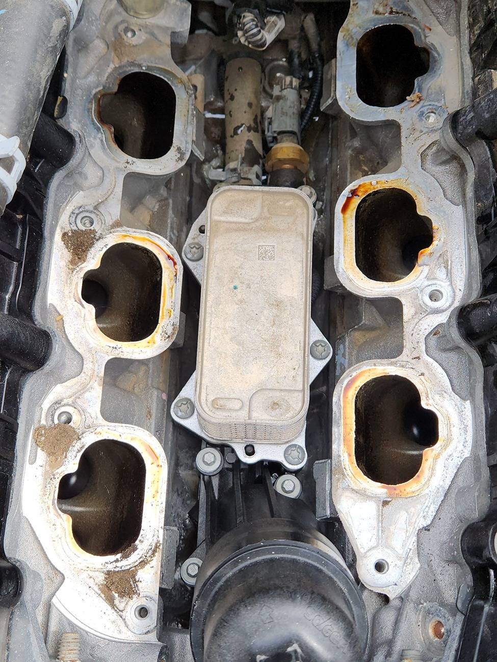

Catch can...solution looking for a problem? ~34k miles and no buildup of carbon on the intake valves or ports.

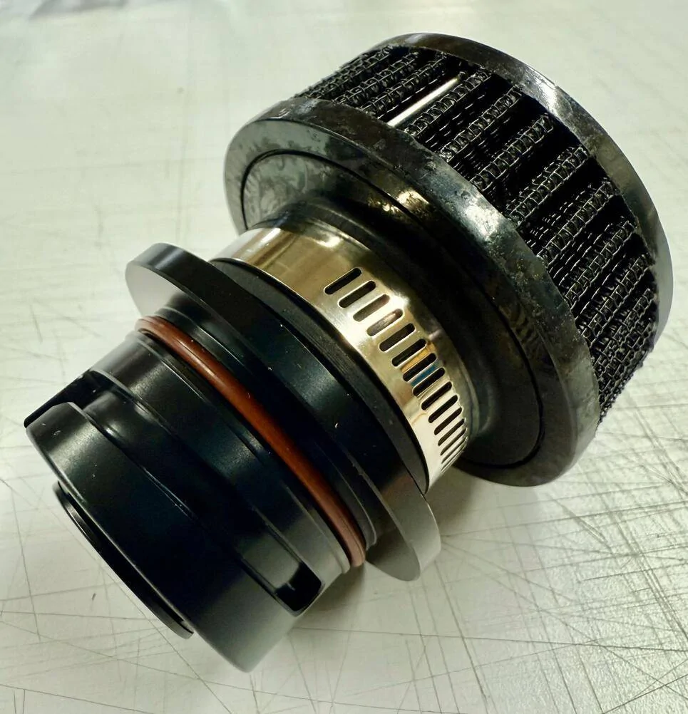

So, I'm admitting that I'm sucker for cool looking gadgets to put on my Jeep. I ordered an oil cap breather, but wasn't thinking about the mess these things could make under the hood. Anyone using one or have experience with these in a 3.6l V6 Pentastar? Now hesitant to use this thing if it's going to slowly mist the inside of the engine compartment with vaporized oil.

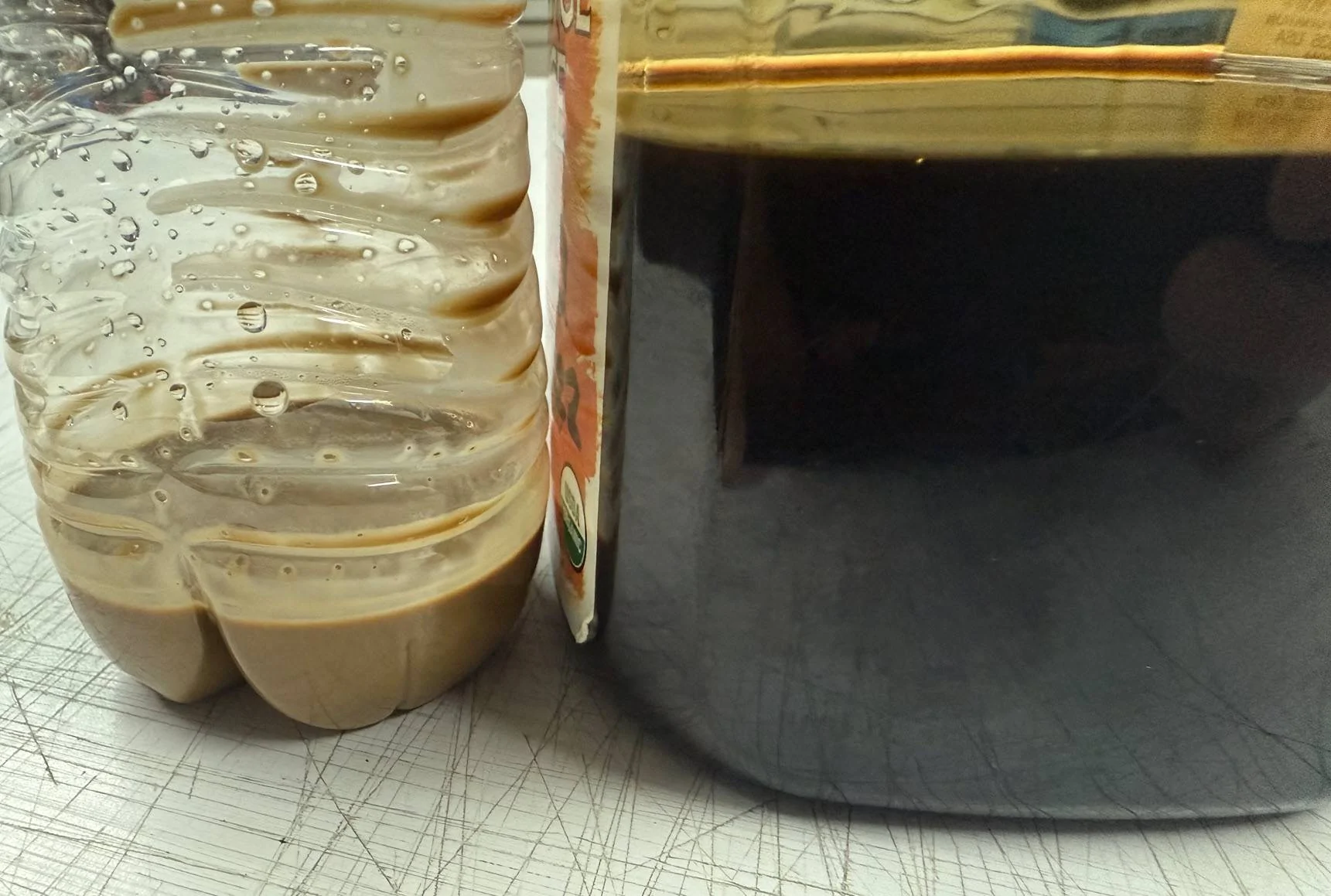

Quick update:
The contents on the left are from the catch can, emptied at about 1.3k miles after installing the UPR oil cap breather. Note that this was during the winter months of December to January. I've been emptying this catch can for over two years (large container on the right) and have never seen this milkshake-like content before. I understand it's normal, and the oil on the dipstick looks fine. I have noticed that the valve ticking has been much less or almost non-existent lately—possibly a placebo—but it's really not ticking intermittently like it used to at idle. I'm sending the current oil in for analysis just to be sure and compare it with my previous results. Also, no oil mess under the hood from the breather cap like I had previously expected.

The fluid on the left has a high water content. It's just a product of the particular environmental and operational conditions during the test period.

I've had catch cans on my corvettes and pickups and this is normal in a cold climate during the winter. Come summer it will be almost straight oil. You need to check and drain the catch can weekly from all of the condensate during the winter months.

You could heat the slurry on the left and perkolate the water out of it, leaving just oil.
