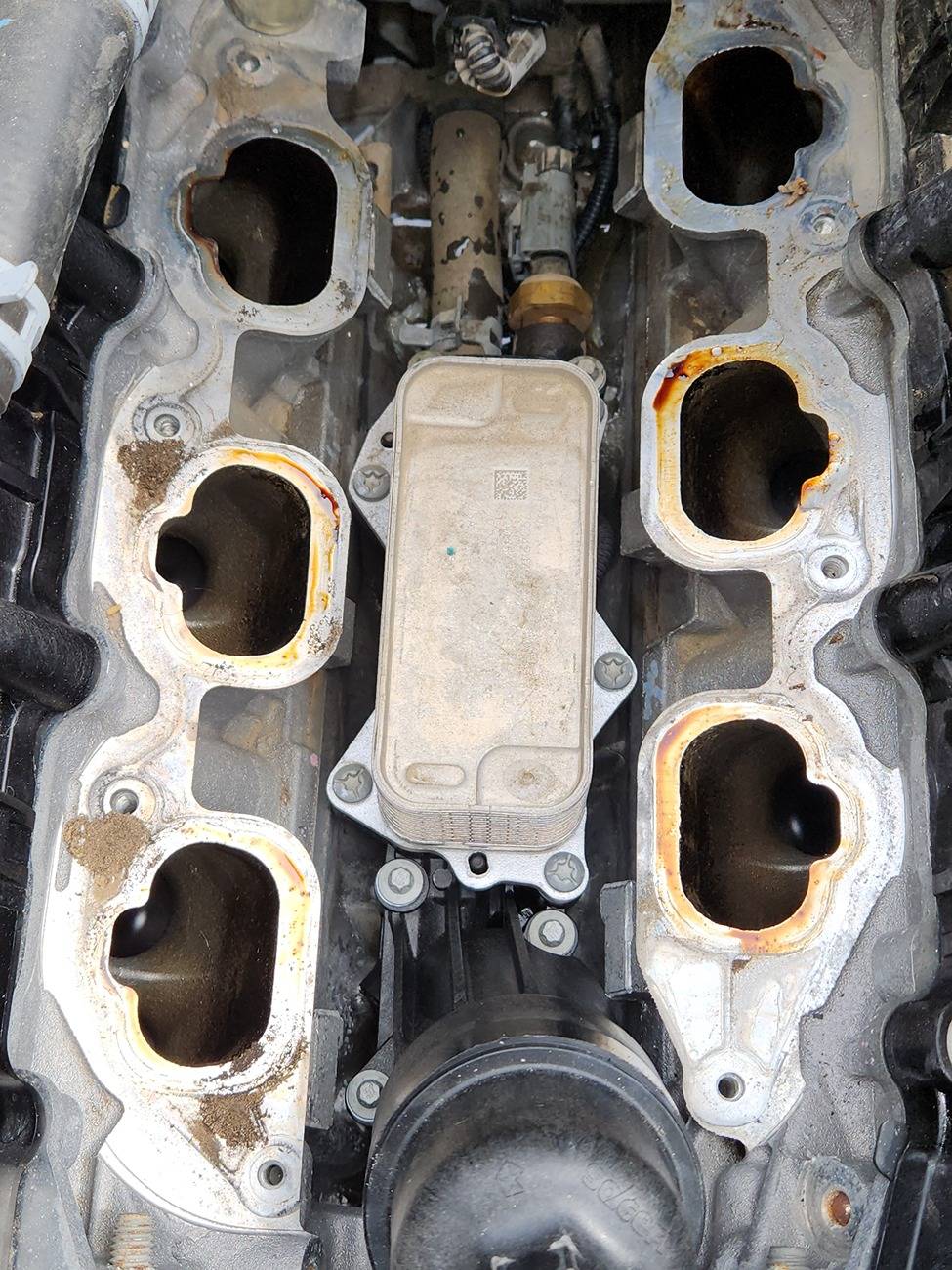

Catch cans can be made from about anything from a free coffee can to a mega bucks space shuttle accumulator. Both will do the same thing; expand and condense the oil vapor. A larger one works better than a small one. Locating it where it's cool helps condense more oil/water vapor out.
But here's a 3.6 with 34k miles and no carbon buildup on the intake valves and ports. What problem are you trying to solve?
my main reason for installing an oil catch can was the detonation/spark knock I was having.
I first noticed climbing a steep hill in 4WL at 4000 elevation with 91 octane and could not believe what I was hearing.
After some research and reading that crank case fumes/ mist can degrade the octane levels I decided to give it a try.
After installing the UPR oil catch can NO more detonation/spark knock. Completely gone.
The added benefit is catching removing the oil in the intake stream.
I now have one on both my Wranglers and my 6.2 f250.
