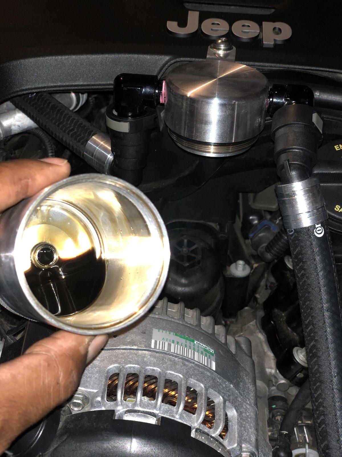

I installed a UPR can a week ago and after 500 miles I got at least a quarter inch of oil in my can just driving 60% highway and 40% city. I’m impressed and happy with my purchase so far. Jeep only has 16,000 miles on it. I wish I would have had it this summer when I was wheeling. The pic attached is how much I had in my can around the 500 mile mark.

Great pictures and thanks for sharing. Just wanted to add the fact that the UPR catch cans fill up so fast is because they coalesce so much better than the other catch can designs. The majority of other designs let an excessive amount of oil escape and pass right through the catch can and only leave a small percent of what's actually traveling through the PCV system.
Even though many see oil in other catch can's they don't realize it's usually just a fraction of what they should be catching causing the placebo effect. We always have customers tell us their catch cans fill up quicker than brand x they used to have and they cannot believe the difference in the diffuser/filter for coalescing can make such a big difference.
Also, we will be offering an upgrade for existing customers with a different bottom to the catch can more geared to rock crawling and true JEEP designated component like all our kits as we don't believe in one size fits all products like all the other brands.
Have a great day, Joe

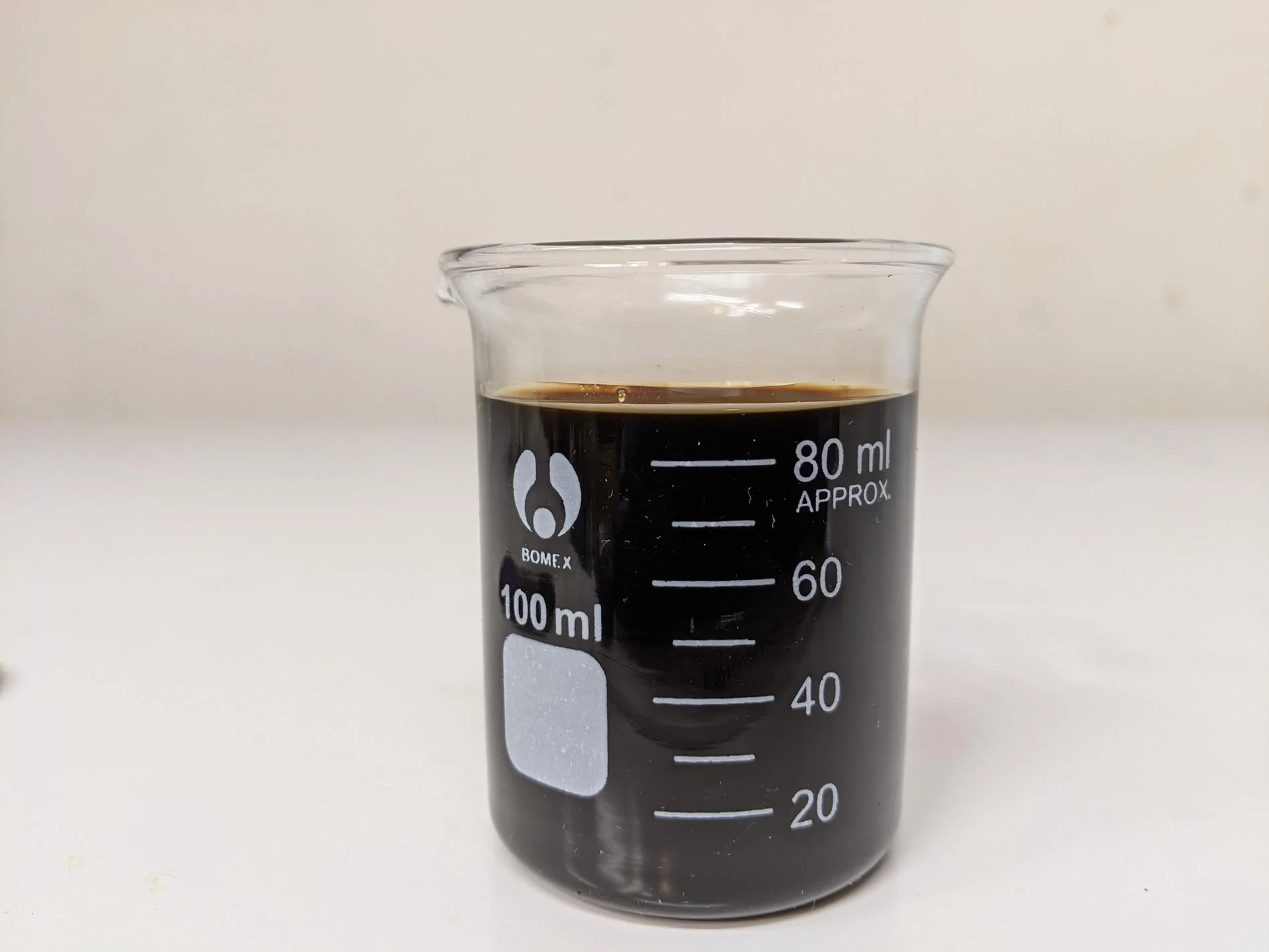

Wanted to give a bit more feedback on my UPR. At 3K miles it needs to be dumped (at least on my engine). There was about 90 ml after 3,082 miles on a road trip. It was emptied before the trip. As near as I can tell 100 ml is the limit before it reaches the bottom of the diffuser and is subsequently pulled into engine.

Wow, only 100 miles or is that a typo?
