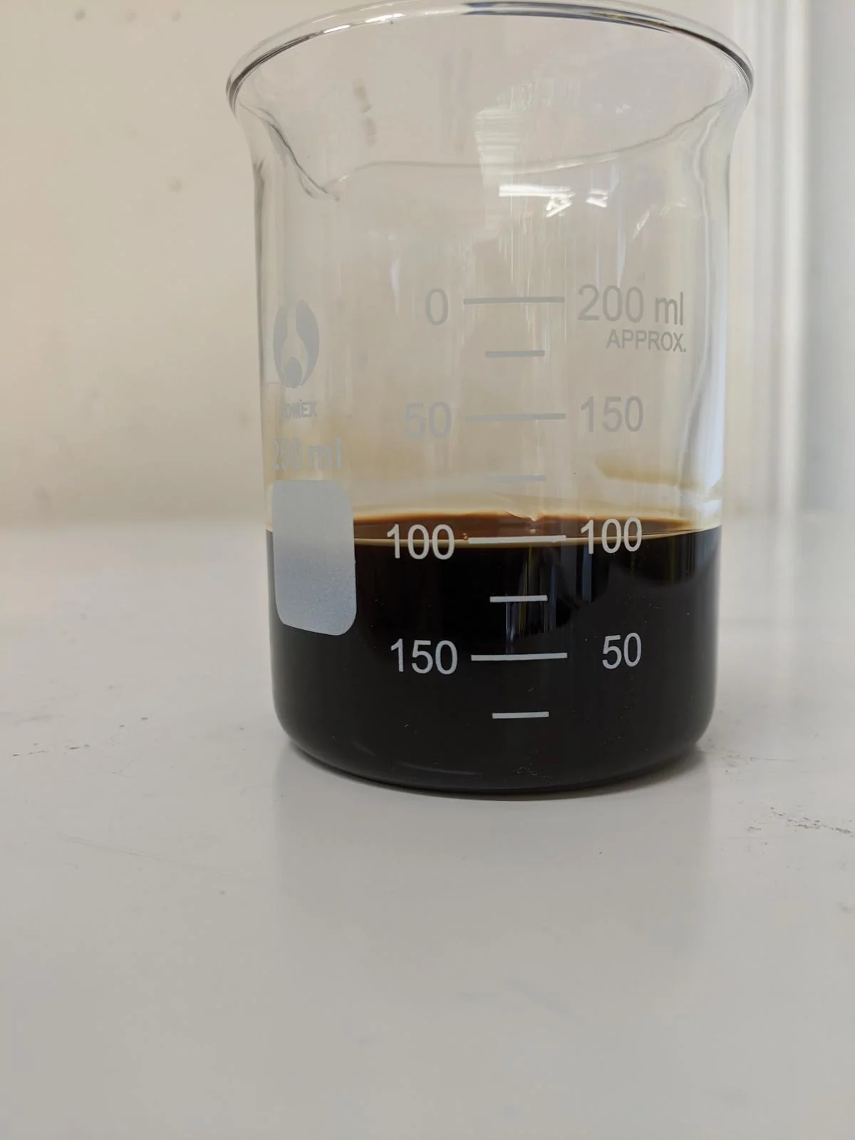

After 5,500 mile since the last time I dumped my catch can, I dumped it again today. A few things to report:
1. You (at least I) cannot go 5,500 miles without dumping the catch can. It currently has 100ml in it and that is just the amount needed to put the oil level even with the bottom of the diffuser outlet inside the can.
2. I think it means that when 100ml is in the can, that any additional oil will go into the the intake.
3. I am totally satisfied with my catch can and what it does. I definitely do not want that oil going into the intake.
