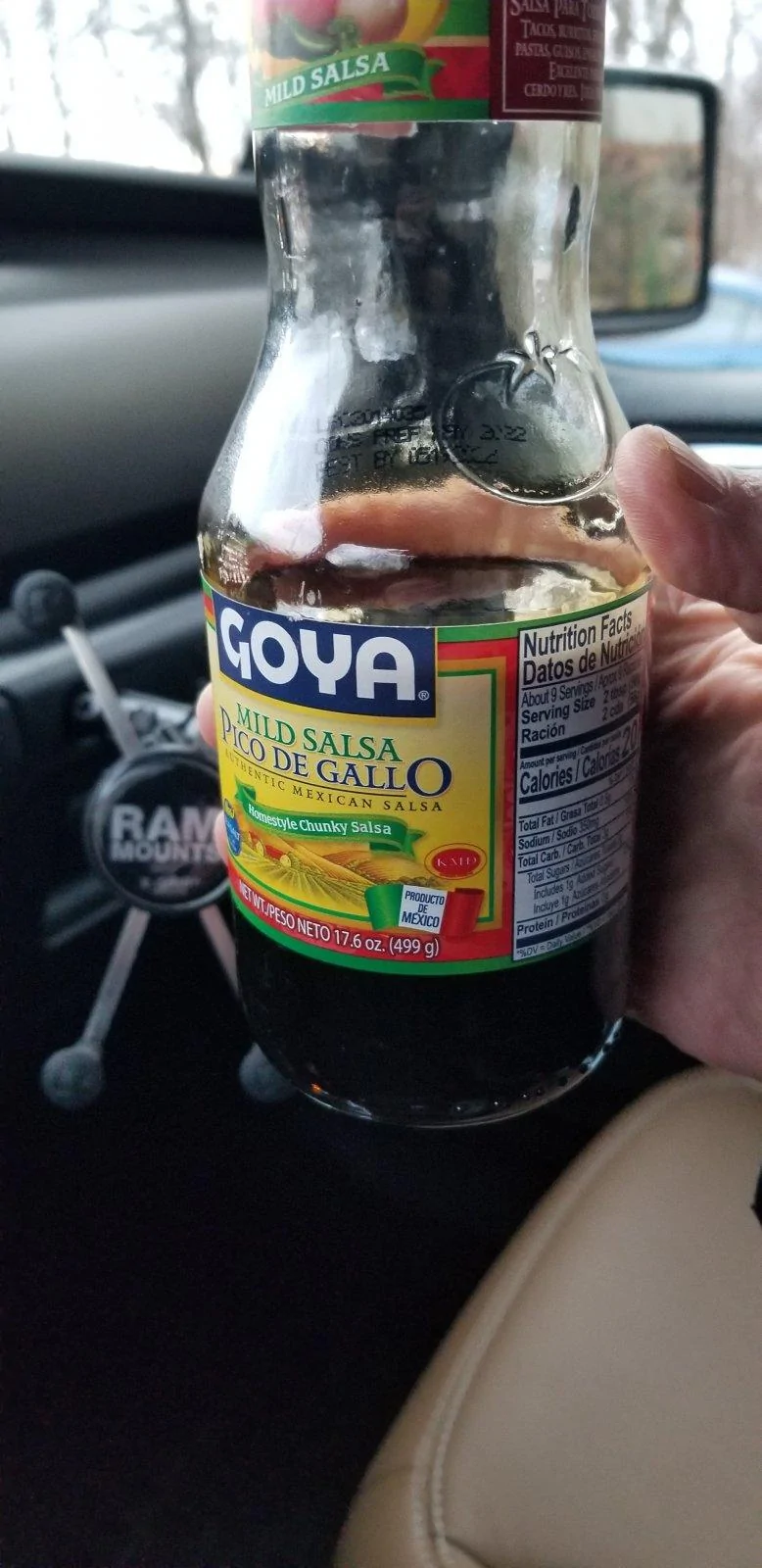

UPR catch can, 11k miles worth of oil collection on my 2020 JLR 3.6 engine, very pleased with my purchase.
