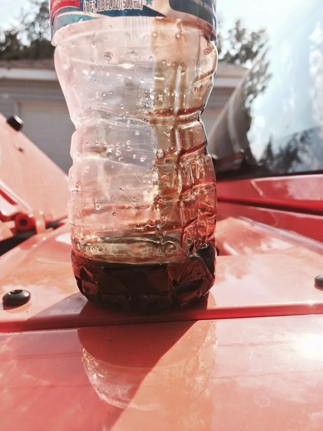

Everyone has their opinions on whether a catch can is or isn't needed on the 3.6L motor. My 2¢ there are benefits to using a catch can. I got my first exposure to catch can's when we had our Hemi Grand Cherokee. When we traded in the Grand Cherokee I figured it was going to be a hard to find a buyer so I decided to try and re purpose it on my 3.6L JK. I noticed benefits from the time I installed the catch can from better fuel economy (about 1mpg or so) to it burning cleaner with no carbon build up in the tail pipe or the throttle body
This was what my catch can captured in a few months. What I happened to notice over time is the more highway driving I was doing the more the catch can captured.
Jeep Wrangler JL Oil Catch Can ? 11960000_1132836450064714_951132754401204605_n.jpg?_nc_cat=100&_nc_ht=scontent-ort2-2
As of yet, I have not done one on my JL, however it is something I'm considering the results I had on my JK.
