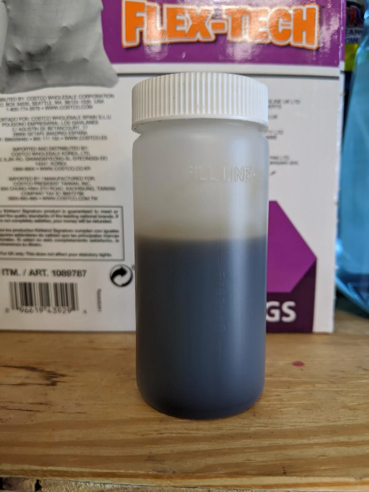

Emptied my UPR catch can today after 2,000 miles and there was nearly enough oil to fill a UOA sample bottle. I plan to send it off for a UOA after I collect a bit more just to see the results. Based upon this, put me firmly in the pro catch can camp. The oil trapped by the catch can would have otherwise been dumped into the intake.
If there is this much oil after 2K, what will it be at 5K? Keep in mind my 3.6L has only had synthetic oil and has a shade under 13K miles on it.
@DanW
I wanted to update this again. I am preparing for a road trip and as part of the I did an OC and dumped the catch can. This photo shows about 2K worth of oil and after an additional 2K miles, there was enough to completely fill the space left in the bottle with about the same amount left over.
This tells me on a 5K run, the catch can is trapping about 5-6 ounces of oil that would have been otherwise dumped into the intake and subsequently burned. I plan to check it when I return and see where it is. The trip will be about 4K miles in total.
Totally satisfied with my UPR purchase!

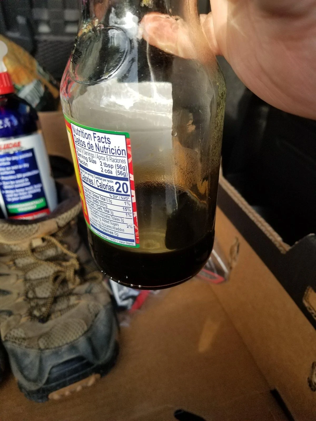

I absolutely love my UPR catch can, my mileage avg was 22.8 and 23.2 on my recent trip to Smoky Mountain Jeep fest in TN. My highway best before installing the can was 21.2. I am impressed. The attached photo is an accumulated amount after 3500 miles of driving.
How often do you have to empty it? Also, UPR has the option of a one way breather right below the catch can selection. It says "required". What is the breather and is it actually required?
