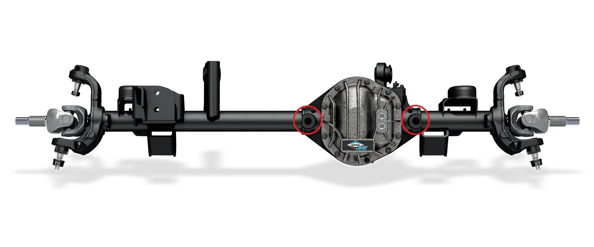

You can measure the caster at the two points circled in red.
Depending on how you place the angle at those points 0 or 90 degrees should equal -6 degrees of caster.
Oh yeah I should have mentioned that. The axle has 6* of cater built in. If you measure those points and get 0*, then you have 6* of caster.

Ok so I bought the gauge AnnDee4444 posted. And measured like AnnDee4444 and TTECHRIS showed (thank you all very much). I have somewhere between 4 - 4.5 degrees (I wasn't worried about being exact) so like I thought I would benefit from the longer Mopar LCAs. I'm going to try and pick up a set this week... Thanks for all the info!
