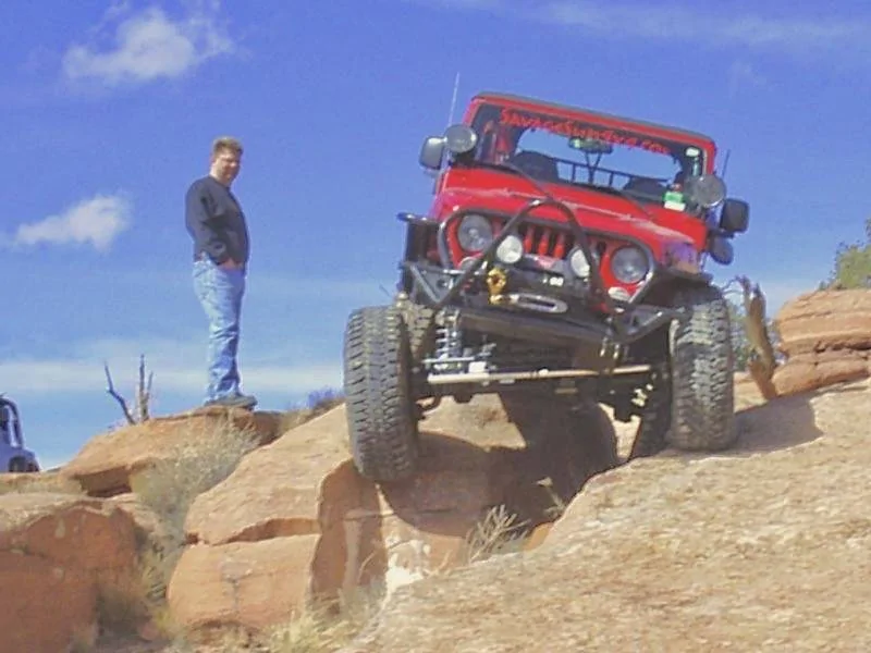

Here is a couple of pics of my TJ. I ran Currie Anti Rocks, (I think now they have a different name Rock bottoms or ????). Unlike most that Bolt them on and go I actually dial them in. In doing I go for MAX stuff, in fact I rub and build the rub in purpose, its not much, it barely touches, but what it tells me is that I am at max stuff and if I have that then I know I can also attain my max droop.
It may be that the Ranchos had far more travel for a TJ...These pics were taken about 2003 and that is Rancho RS9000 XL.
First pic is to show near full stuff, looking at I prob have about 2 more in to before I tube fender..
The next pic is the install of a AEV 3.5 in lift kit SPRING only (I don't do kits I do compenents) I put the spring in there fully extended, no compression and did not remove the shock to do it.
One has to be careful in that you can lose a spring by having to much droop. This is where you adjust the Anti Rock to make sure you have max droop but not so much as to have the spring fall out and I have seen plenty of fall outs on the trail.
The problem with big shops, and in fact MOST shops is the lift kit is never dialed in. When I built a Jeep for a client, i never called and said: OK Jeep is built come get it. Instead, I spend about 3 days dialing it in. The client does not know how to do it or he would have installed his own kit.
Take away: Never an issue with stuff or droop...

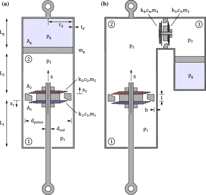

The reservoir is all about heat dissipation. If you think you'll be spending long hours on rough or wash boarded dirt roads, or want to bomb through the desert at high speeds, your shocks will be working overtime and you want the extra heat dissipation to help prolong the life of the shock. For rock crawling and any slow speed stuff, the reservoir adds no benefit. That is when you want to look for the collapsed and extended stroke lengths and match it to the flex you're looking for.
It is true that having a shock piggyback or reservoir does help with cooling and heat dissipation, there's another large, overlooked benefit to running a piggyback or reservoir.
I'll explain. Assuming that most performance aftermarket shocks are a monotube, you'll have everything in the same shock body. Oil separated from the nitrogen charge by a IFP (internal floating piston). Simple and works well, except the fact that you are limited on usable shaft length by the IFP. Too long of a shaft and the piston can strike the IFP and cause damage.
However with a piggyback like our Falcon 3.1/3.3/3.5, Fox 2.0 piggybacks, and many others, the IFP and nitrogen charge is moved into the reservoir, and as a result the effective shock shaft length can increase greatly; thus adding travel potential to the shock without increasing the main body length. Because of this a piggyback shock will have often 1-2 inches extra on the fully extended length compared to a same length body monotube.
Here's a crude image from google that shows what I am referring to.
And because of this extra up travel the bypass ones on the right are able to deal with bigger impacts without bottoming out? (Jumps etc.?)
That’s more about suspension setup. Once you use up uptravel, you should hit bump stop before bottoming out the shock.
