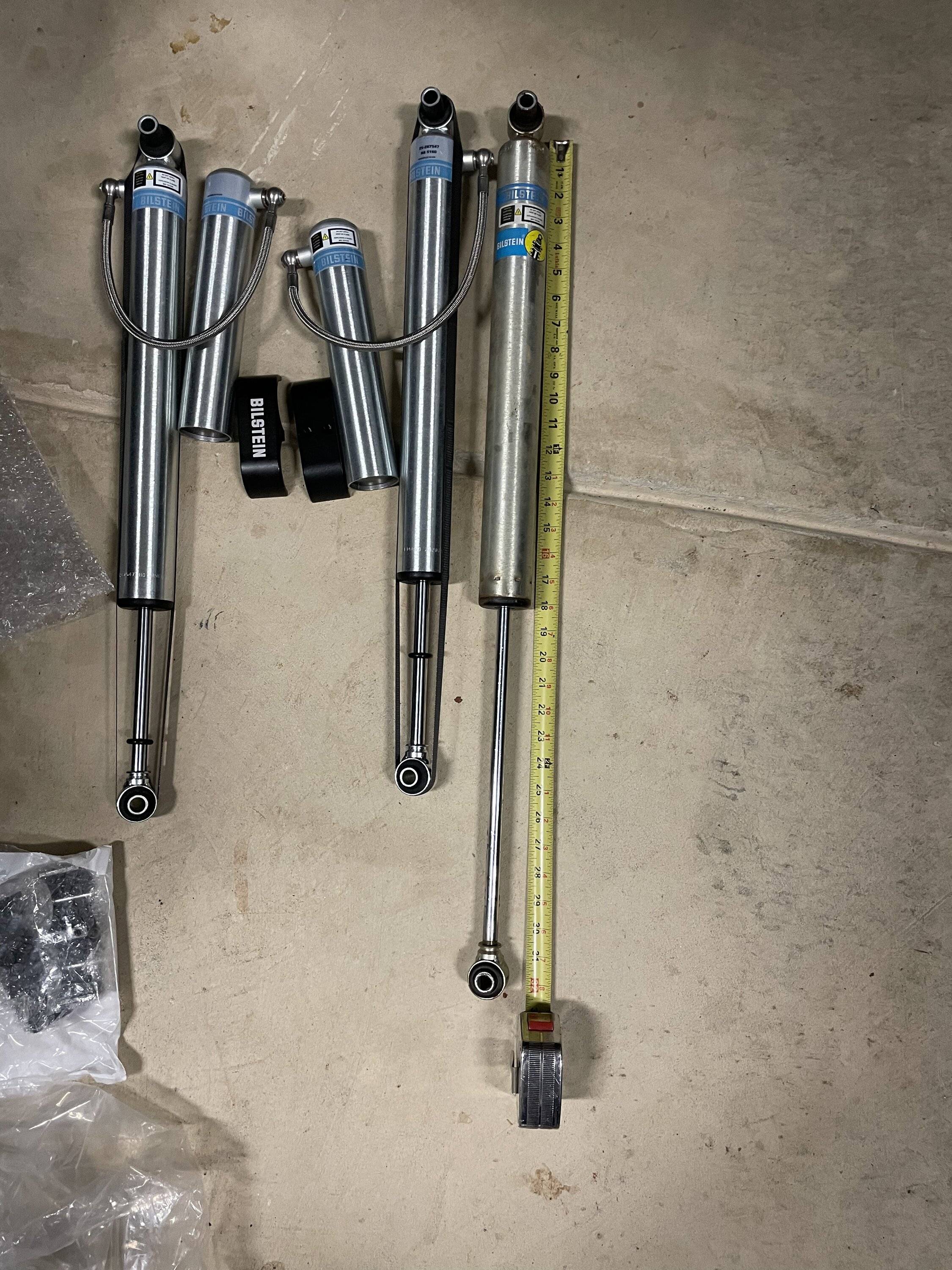

Now that we’re back, I was able to throw on the rear 5165s, and I think this pic shows the difference with Reservoirs.
Resi still bound on the left has a longer extended length than the mono coming off. Same “lift” rating.
Jeep Wrangler JL Best shocks? 2935018A-068A-4663-8577-F26D54C05ED1
EDIT: that’s not where you measure shocks from, swear it moved all on its own.
