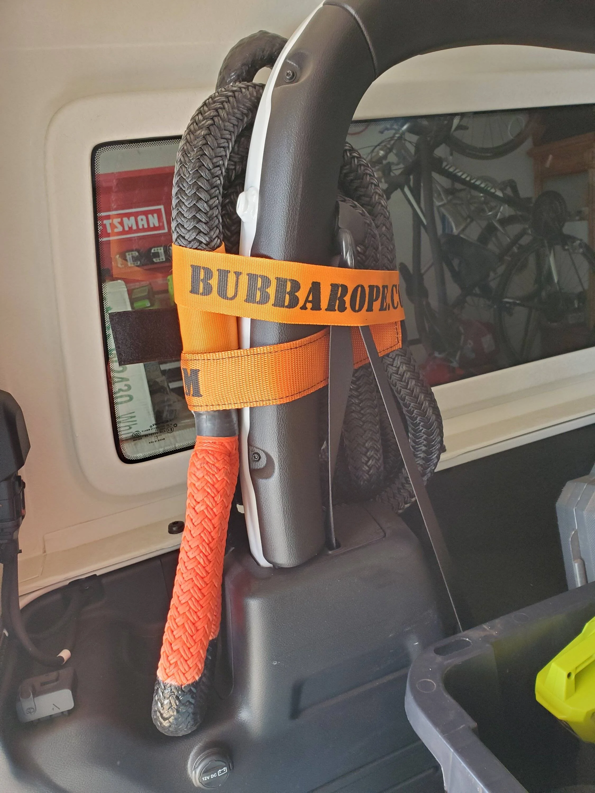

No, but a 1 ÂĽ" 20 foot buys safety. I use my 1 ÂĽ" Bubba at least once a month and don't worry about it breaking. breaking strength is 52,300 lbs
