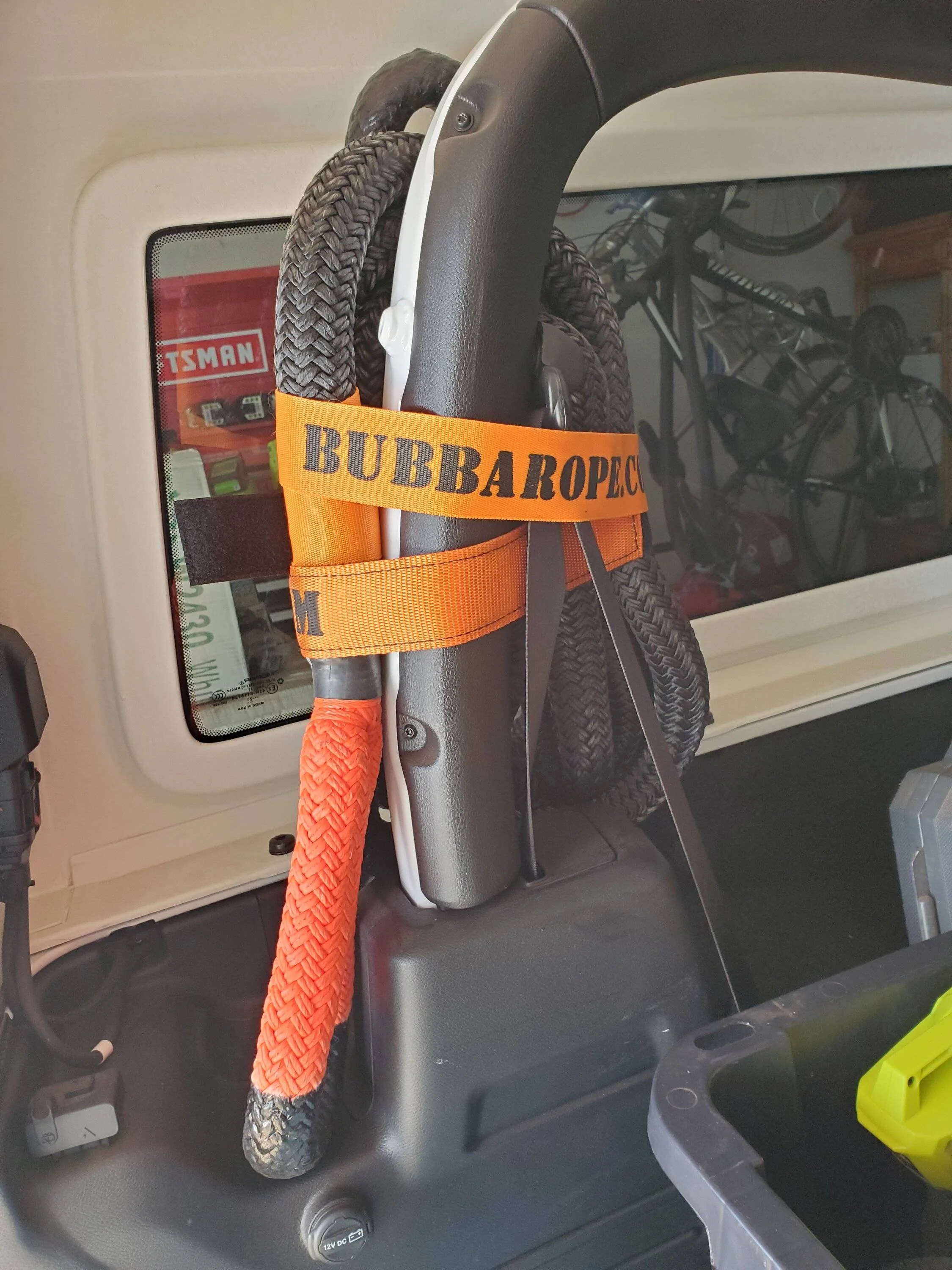

Pic's are old but Bubba is now between the roll bar and the side window. Fit's nicely
Jeep Wrangler JL Kinetic rope? bubbaRo
