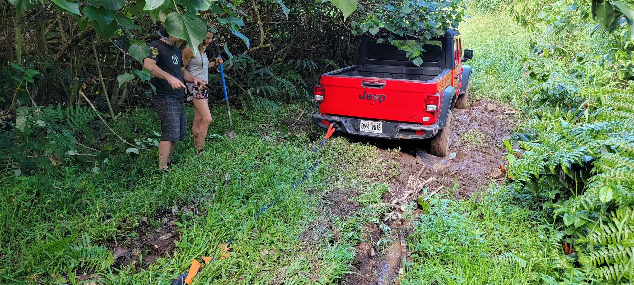

After reading @wilbornz thread, I got a 1 1/4" Buba rope, 20 foot. I've done several recoveries with it. Last week I pulled a JT out of deep mud. I had to back into 100 feet of deep mud so a 30' wouldn't have helped. With the 1.25" rope I have the confidence to yank hard and get him out on the first pull so I don't get stuck pulling on him. I warned him I was going to yank hard and told him to keep backing up for the next 100 ft until we got to solid ground. He was an experience wheeler so the recovery worked on the first attempt.

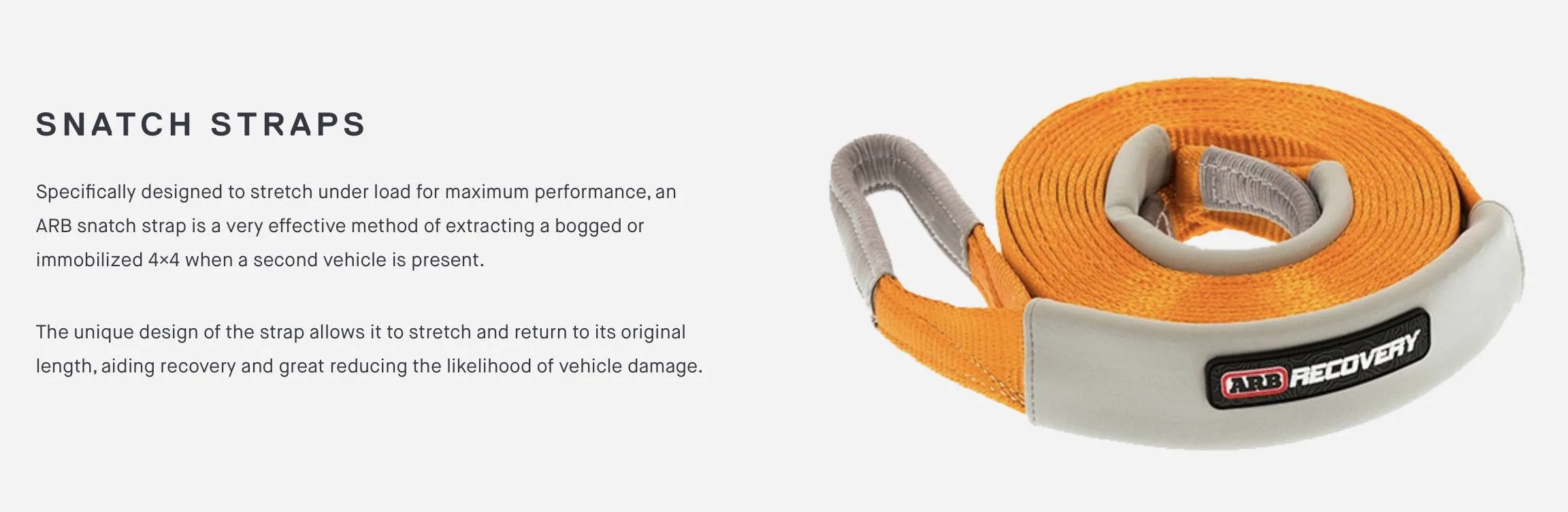

not only kinetic rope makes a easy recovery but also will not damage your vehicle, especially diff gears. if you use arb type of towing strap then likely you can break a tooth on your ring gear if you pull hard.
The arb is not a tow strap. It is kinetic…. Arb doesn’t make a “tow” strap.

As far as kinetic/tow/snatch equipment goes, I don’t recover people for a living. My recommendation for the arb snatch strap is based on my experience. My Arb is now 8 years old and still stretches and works. I think someone should carry something just in case, but a kinetic rope is too much $$ for most people and takes up too much room. I keep my ARB tucked under the rear hatch, in case I ever need it. I have a recovery bag that I carry on purpose when going off road. If I pull up to someone stuck and they don’t want me to pull them out with the ARB, that is fine with me…

I used to use an ARB snatch strap, they work great. About 8 years ago when I was introduced to kinetic ropes I could not believe the difference. ARB has 15-20% stretch while kinetic ropes are around 30%. It doesn't seem like a big difference, but the smoothness and increase ability to get unstuck is significant. There isn't that jerk you feel with ARB and how easy it is to pull someone out is noticeable. They are worth the money for sure, but I would only use one on people that you wheel with. Too much potential for damage with the forces that can be created with a kinetic rope to use one on a vehicle w/o proper recovery points. When I did SAR we only used winches, no yanking people out because of the risk of injury and damage.
I don't know if it is true, but I've heard the ARB snatch straps have a short life, like 15-20 stretches. I've only seen that from people online and not seen it stated anywhere on ARB released info, so again not sure where people are getting that info and if it is true. Maybe it is on the box or data tag on the strap. I do know ARB says to only do 2-3 pulls and then let it rest to cool and retract. This could be a source of a lot of failures -> misuse and over using equipment.
