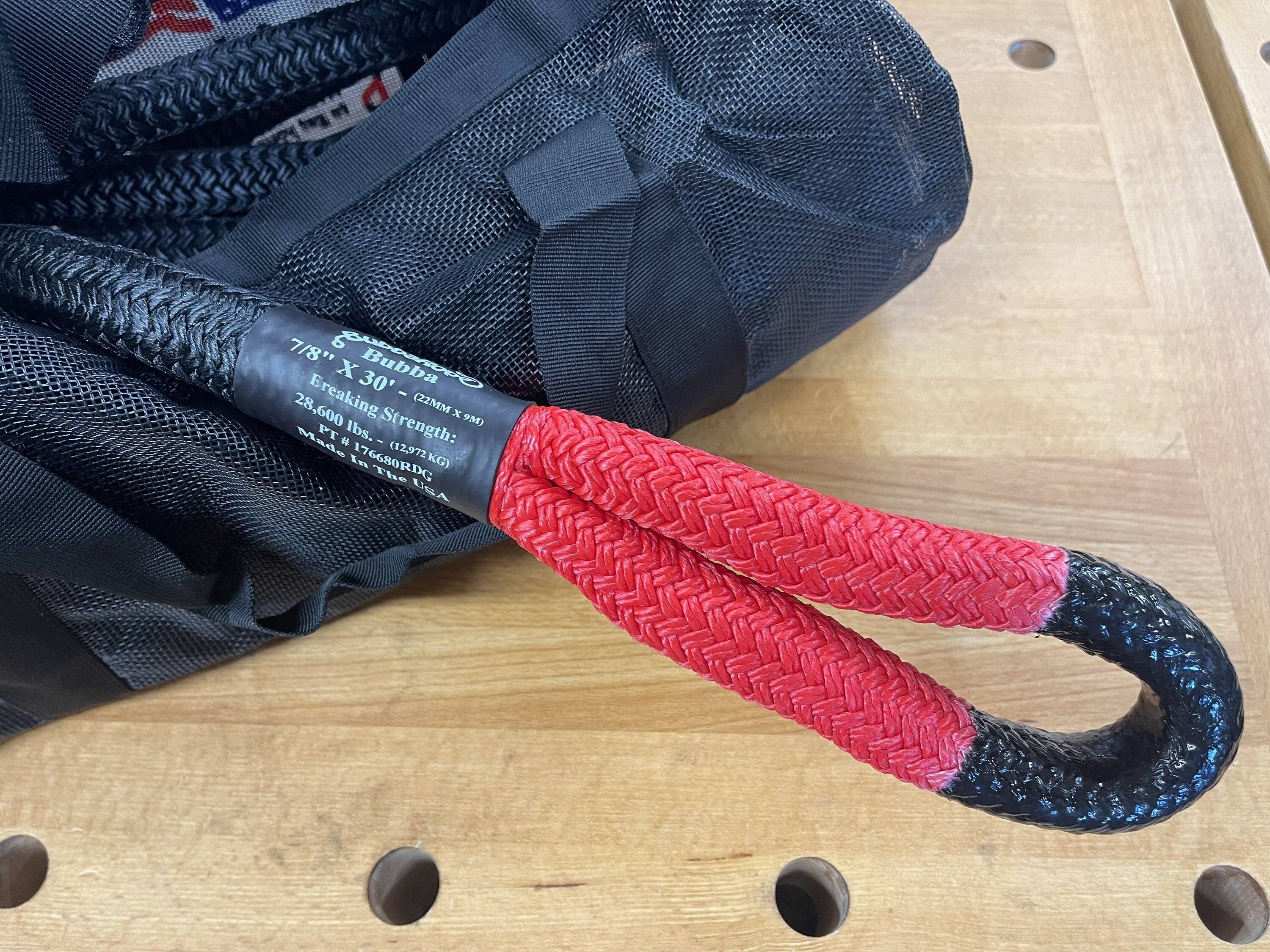

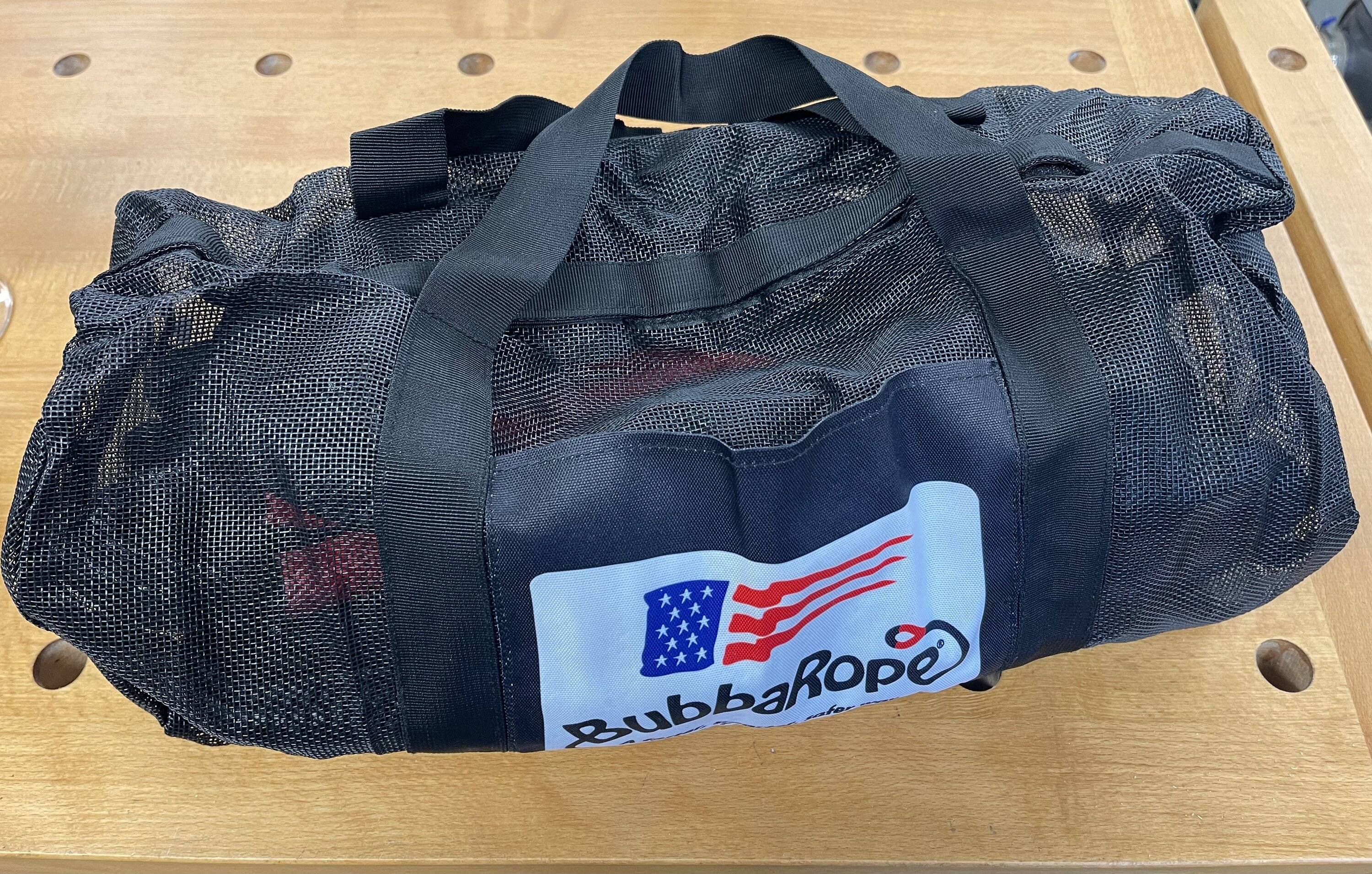

Amazing Amazon. Ordered yesterday, arrived this afternoon. It's a little beefier than I was expecting and it does stink a bit. Comes with a heavy duty mesh duffle bag w/velcro 'zipper'. And it's made in USA.

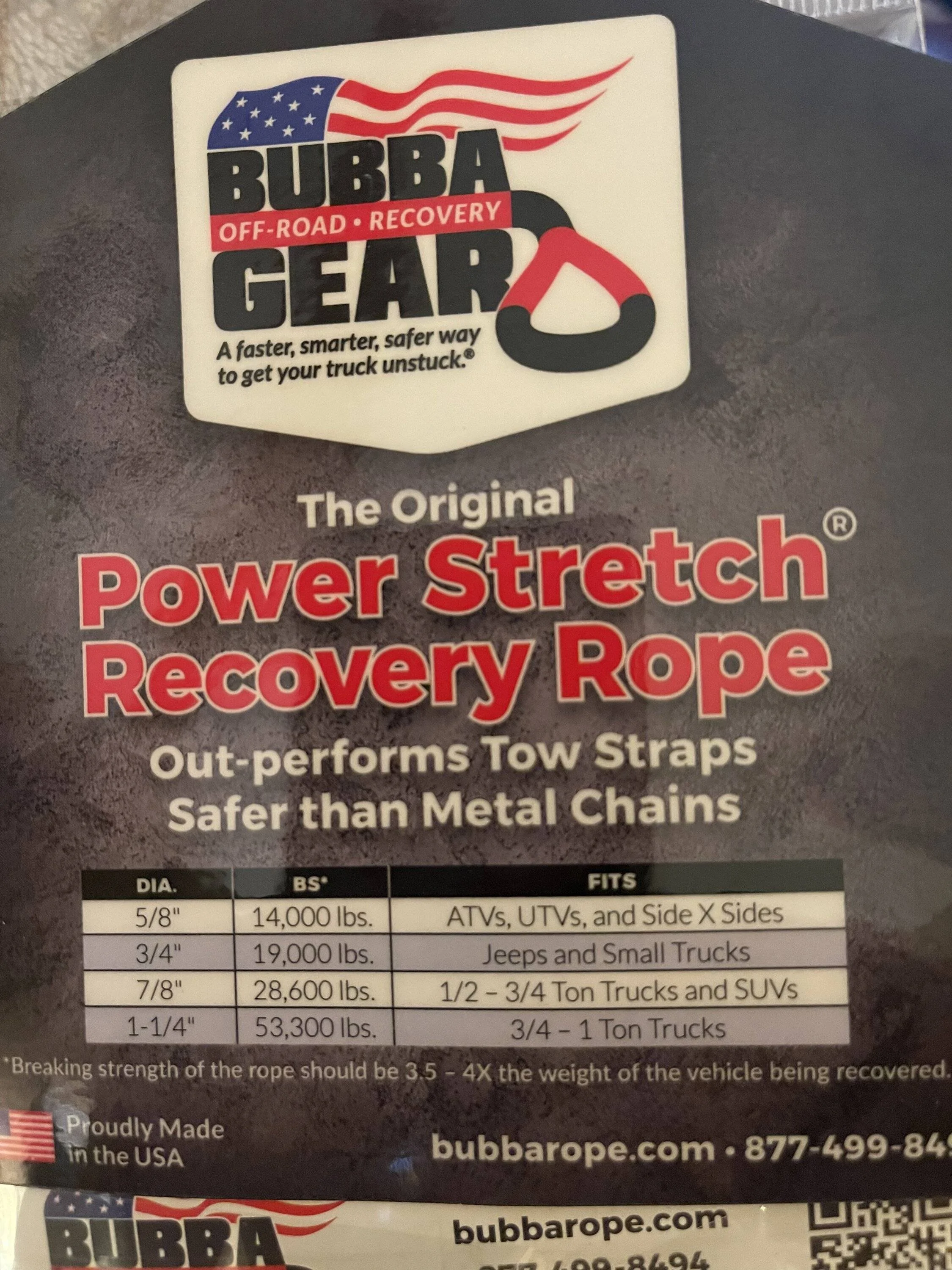

I’m already second guessing my selection of rope diameter. Here is a pic of the tag that came on the rope. Fine print says the breaking strength should be 3.5-4 times the vehicle being recovered. My Jeep is well under 5K. Wondering if 7/8in is too ‘stiff’? I’m surmising my Jeep will be at one of the ends of this rope.
Jeep Wrangler JL Kinetic rope? A7E37AB9-4C27-404E-B62A-7536F848B510
I’m also on a quest to minimize my content weight and volume so going to a 3/4in rope might make more sense? Anyone want to try to talk me out of exchanging it and save myself about $65?

Most kinetic rope manufacturers recommend not going too big as a light vehicle won't stretch the rope enough for it to really work properly. That said, I went 30' 1.25" figure the extra length should help with the amount of stretch I can get out of it. Used it a couple dozen times over the years without issue. It's probably 10 years old and works like new still.
If it doesn't have much drag, what difference does it make. I've done over 20 hard pulls with my 20 foot 1.25" Bubba and it stretches fine.
I have a 30’ rope because I can always shorten up a 30’ but can’t lengthen a 20’ rope
15 feet with a 7/8 would yank harder than 20 foot double size (1.25"), only 15' to stretch. I have 80 feet on my 12K superWinch and three 30' tow straps. Obviously you can't yank with anything but a Kinetic rope.
I've got the Bubba 1-1/4", 20 foot, and as previously posted, I've done over 20 really hard yanks in my JLR. First was the mud bogged JT where a winch would only pull my rig to the bog. A 30 foot rope would have worked fine there. The other was a flipped on side TJ that I had to yank really hard over 20 times.
I'm convinced either pull would have broken a 7/8" Bubba.
Lots of lessor yanks and it's much smoother than even a 4 MPH yank with my 4" tow strap.

Everyone has made the assumption it's a 7/8" rope? Is that right? If so, find a better class.
Here's @wibornz breaking his 7/8" rope, and he wasn't stuck that bad.
Never mind. I’m sticking with the 7/8in after doing some more researching/listening. Now I can sleep well tonight. Really appreciate everyones’ comments. Thank you.
