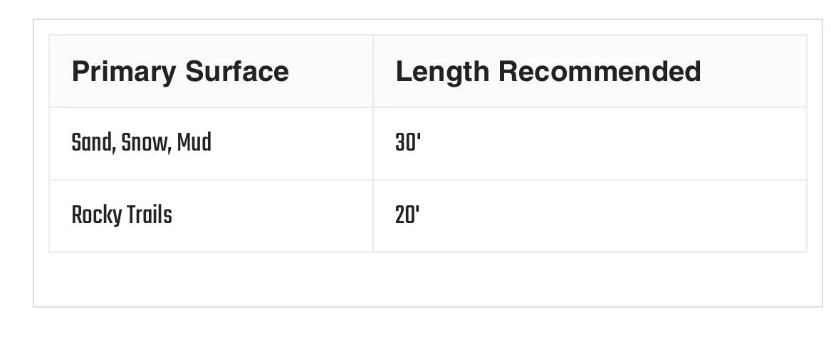

I just saw on the yankum website this chart… makes sense:
I went with the 7/8" x 30' Bubba Rope, with the intentions of using it in softer situations. In the rocks, I'm lining up for a winch pull.

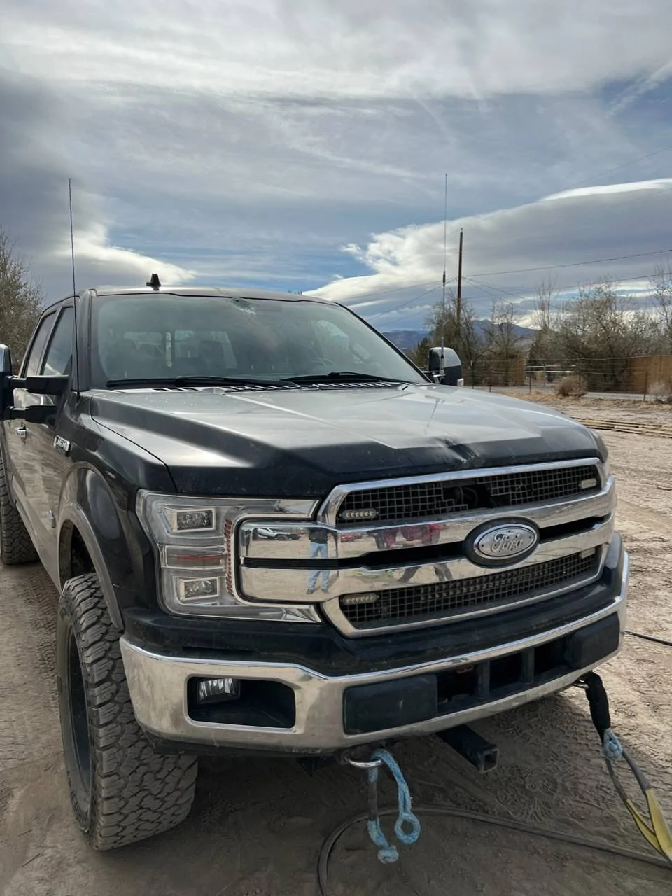

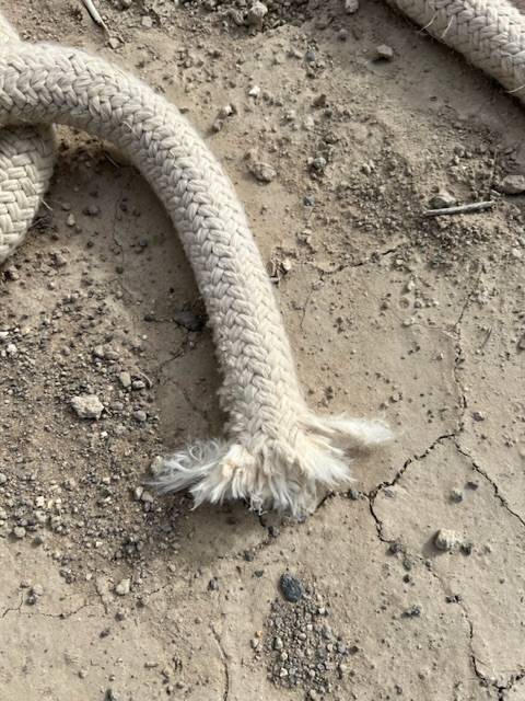

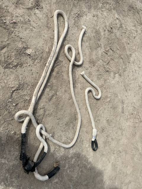

I attended an off-road recovery class where we broke a kinetic rope. I wouldn’t fault the rope itself, it appeared to be well made but it had been well used over several years and on this day perhaps abused. There were about 12 students and 2 instructors so they split the class into 2 groups. I was in the group that went last in the kinetic pull instruction. The instructor had a lifted F-150 on 37s and a lot of tools and recovery gear in the bed. The truck was not stuck but was heavy. The truck was in neutral. The students used their own vehicles (most were Jeeps) to yank the F-150 and get it rolling. Most students needed 2 pulls since they had never done this before. So by group 2, the 10th or 11th student, and around 20-25 pulls in an hour the rope had had enough. It snapped back violently and damaged the instructor’s F-150. Note the busted grill, dented hood and windshield.

Wow thanks for sharing. Lesson here I suppose is even a kinetic rope with soft shackle set up can cause serious harm.

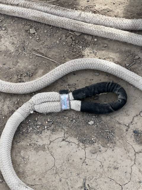

Yes, no metal was used. Soft shackles at both ends. The damage was caused by the kinetic rope. It broke about 2-3 feet from the tow vehicle.

That rope looks like it had been over used/abused for awhile. Taped up sections indicating prior damage. At least it was his truck that got damaged as that thing should have been removed from use, let alone used to teach a class. Kinetic recovery is likely more dangerous than winching due to the forces involved. You are creating a slingshot using two 5k+ pound vehicles. A 7/8" rope has ~30k lb break strength, that force goes somewhere when it breaks. My 1.25" rope has a 54k lb break strength, of course there will be damage if it is abused until failure. A new windshield alone costs 4x what I paid for my rope, replace it when it shows signs of wear.
