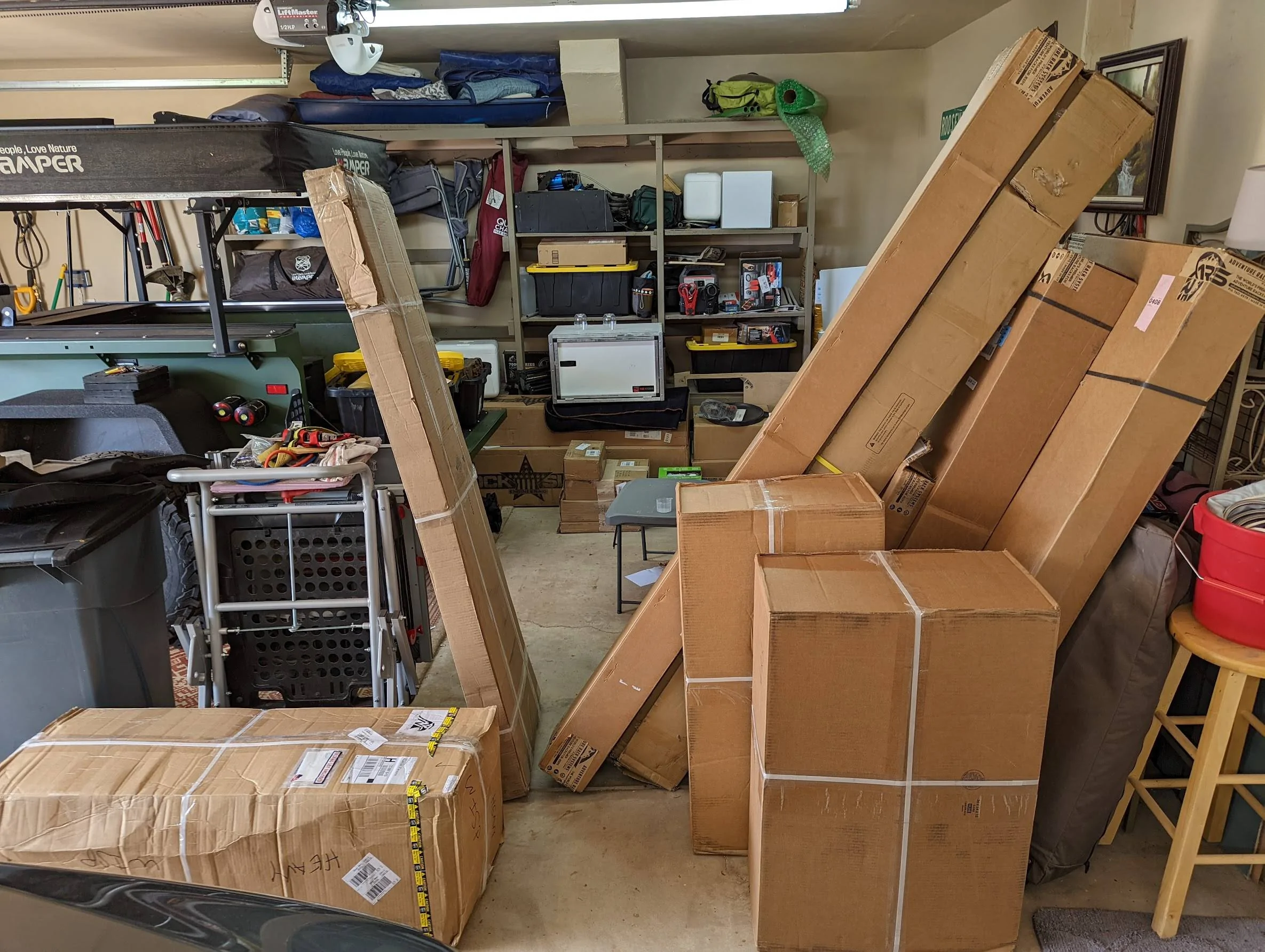

Here's what's waiting in the garage. Yes, it's a mess due to having our To Extreme trailer taking up a bunch of space, but every cardboard box in the foreground and background in this picture is something for the Jeep. This picture was taken before some of the later gear arrived.
Jeep Wrangler JL Ratbert's AEV JL370 JLURD Build Thread PXL_20220710_184723498
Here's a rundown of what's waiting to be installed:

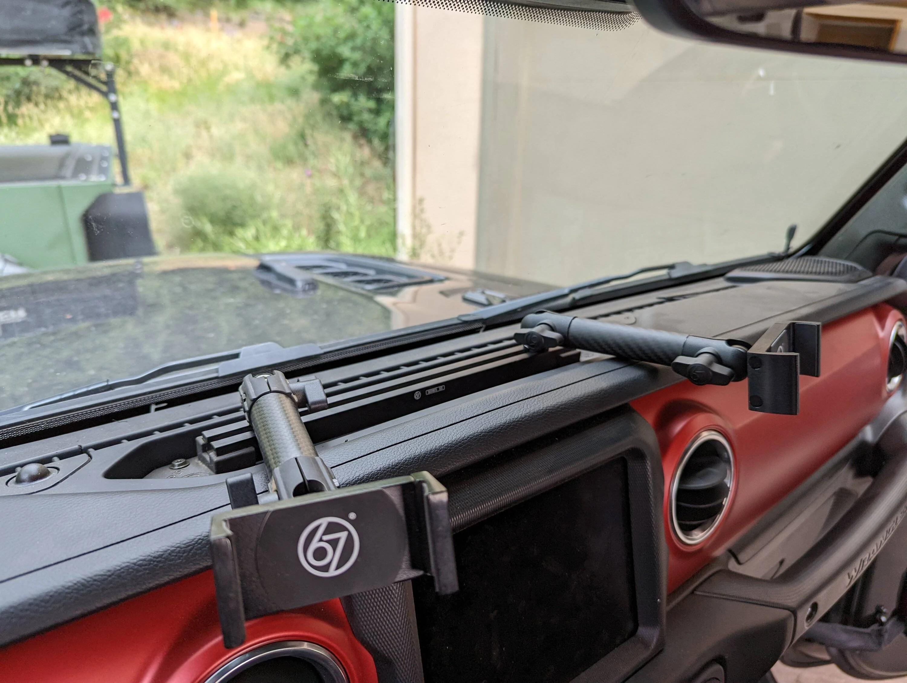

The 67 Designs Phone Mount is simple to install if you have tools that can deal with working in the confined area on the top of the dash.
I bought this cool flexible drill extension thing when installing this in my last Jeep a couple years ago. Fortunately my brother-in-law let me borrow his Dremel to drill the required holes.
Jeep Wrangler JL Ratbert's AEV JL370 JLURD Build Thread PXL_20220716_213550278
If you don't have tools like this you can always fold down the windshield for significantly easier access to the top of the dash, but I'm extremely hesitant to do that since the Jeep's manual says it's verboten with the Sky One-Touch.
67 Designs makes some great gear. They're extremely solid mounts that aren't going anywhere once tightened down.
