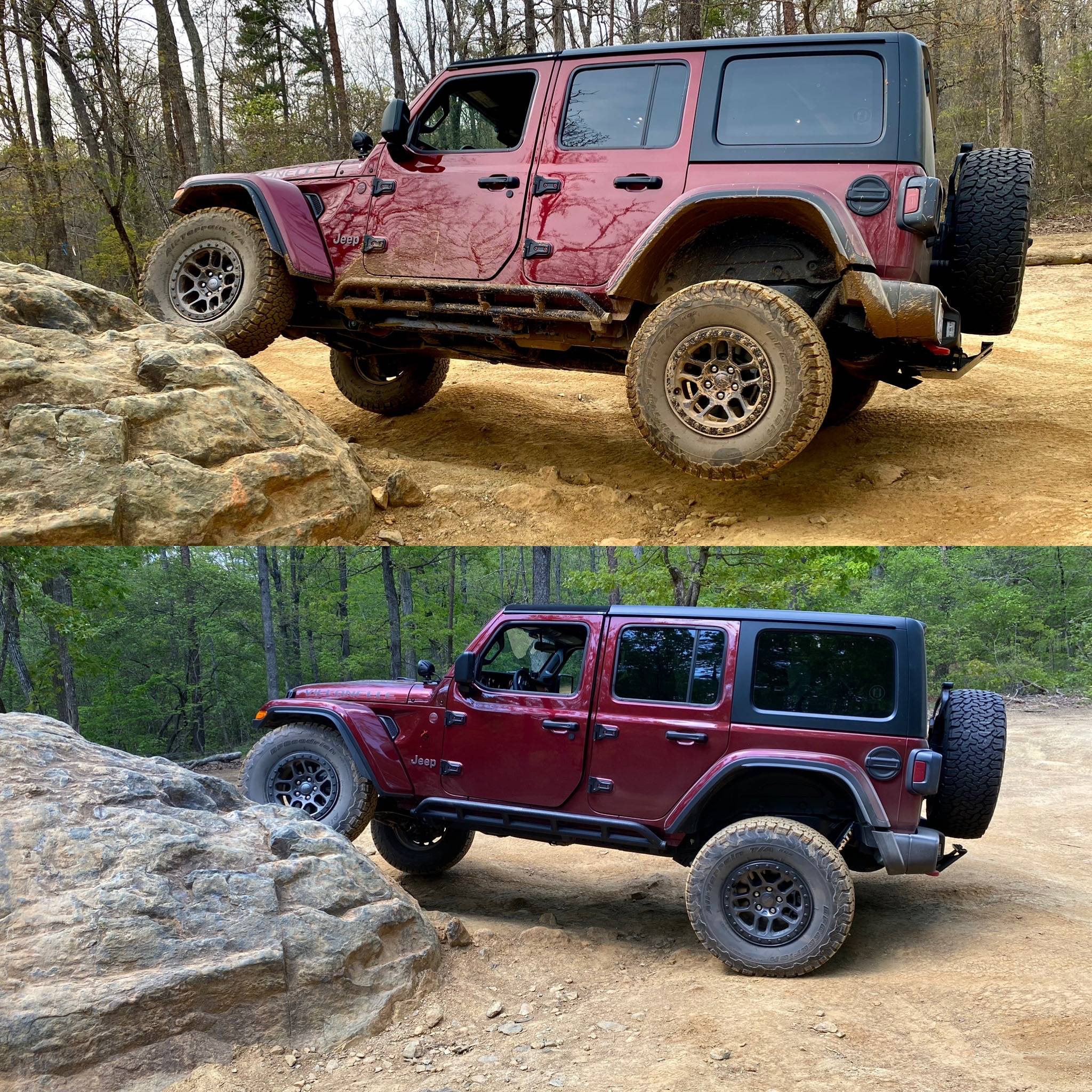

The factory setup limited flex. As I started to wheel more aggressively I wanted more flex. Added a RK 2.5” lift and the flex improved a lot.
First pic….top is factory, bottom is after the lift
