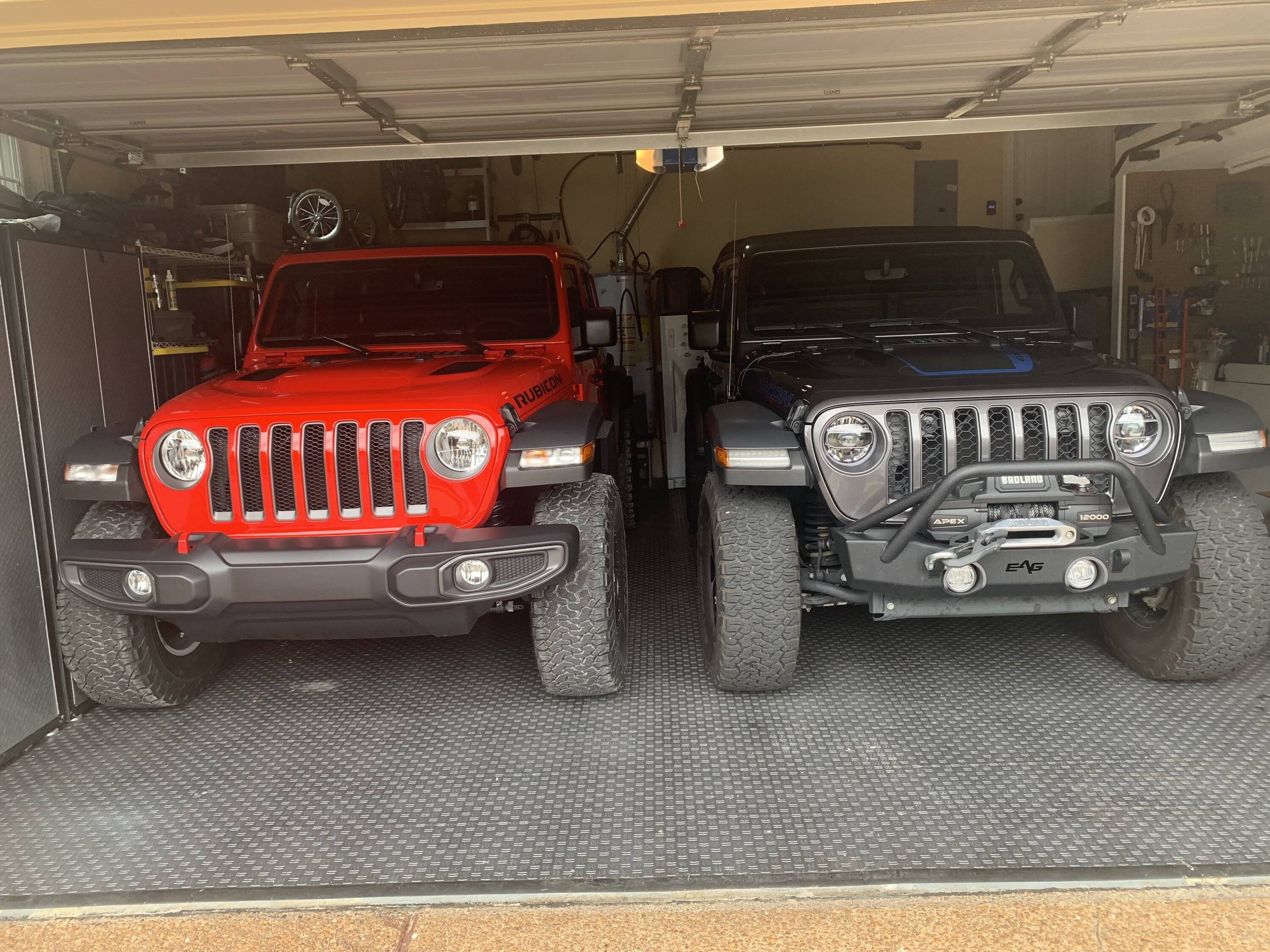

I picked up my 2022 Rubicon with the XR package last Friday. The Jeep has the 3.6L e torque engine, auto trans, sky one touch, and a few other options. I am upgrading from my 2021 4XE. The 4XE was stock with the exceptions of 35” tires, and a stubby bumper with winch (synthetic rope).

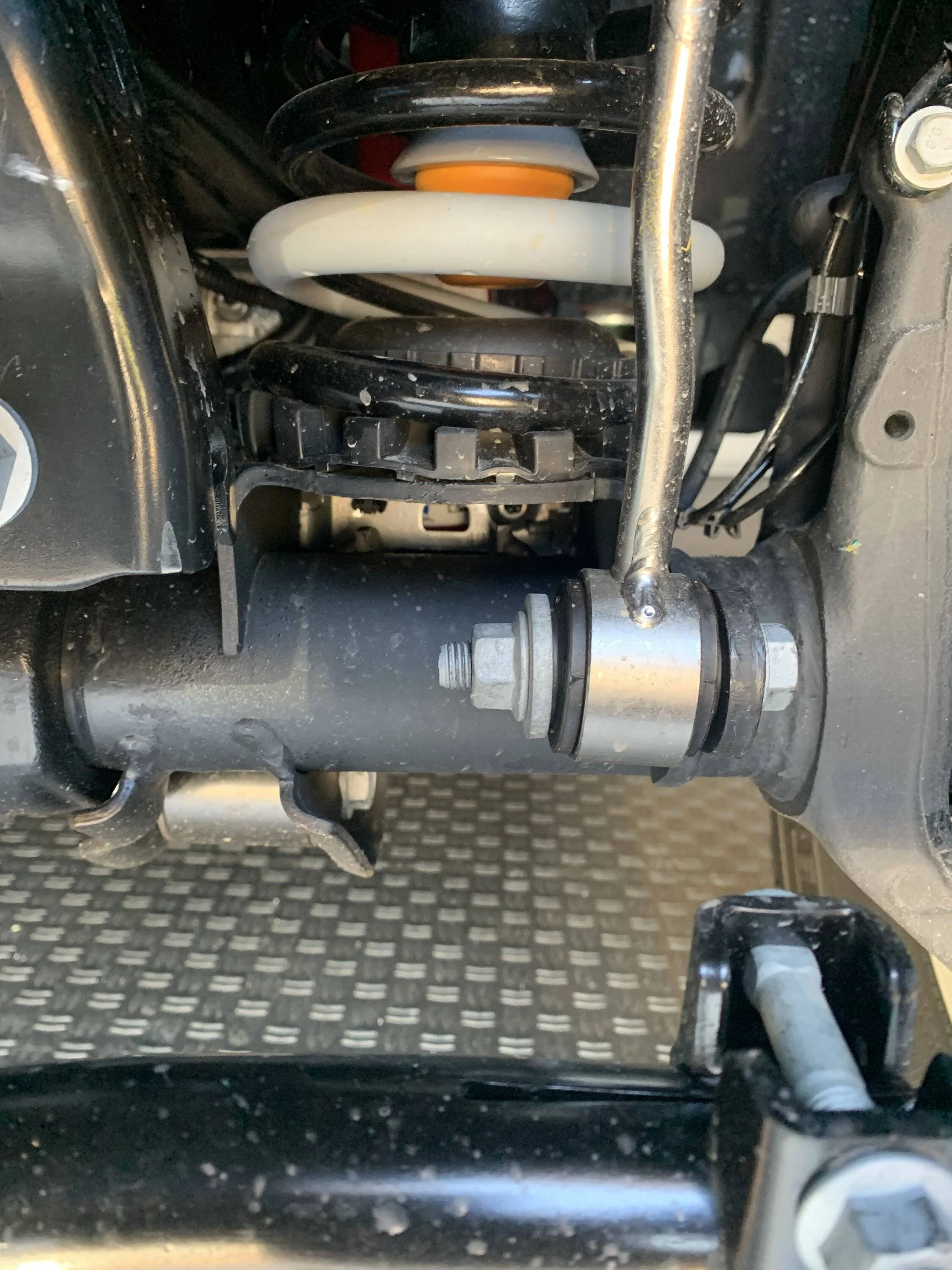

I swapped the bumpers on Saturday night between the two Jeeps. While I didn’t measure the before gap above the bump front bump stops, I did snap a picture of the after. I would put it at between 5/8” and 1/2”. I have a 3/4” spacer to install, but was just shocked at how little uptravel there was. Photo of the spring and bump stop below shows the “after” picture on the XR for when the bumpers had been swapped. If you zoom in on the before picture of the 4XE, you can see a good 2” of uptravel on the passengers side. I off-roaded that Jeep a couple of times, and never had fender contact.

For me, the “so what” is that the lift has much less functional value than I was initially expecting. it looks good, but I’ve already hit the bump stops driving around town. I’m going to have to install spacers to recover the limited uptravel it came with.
