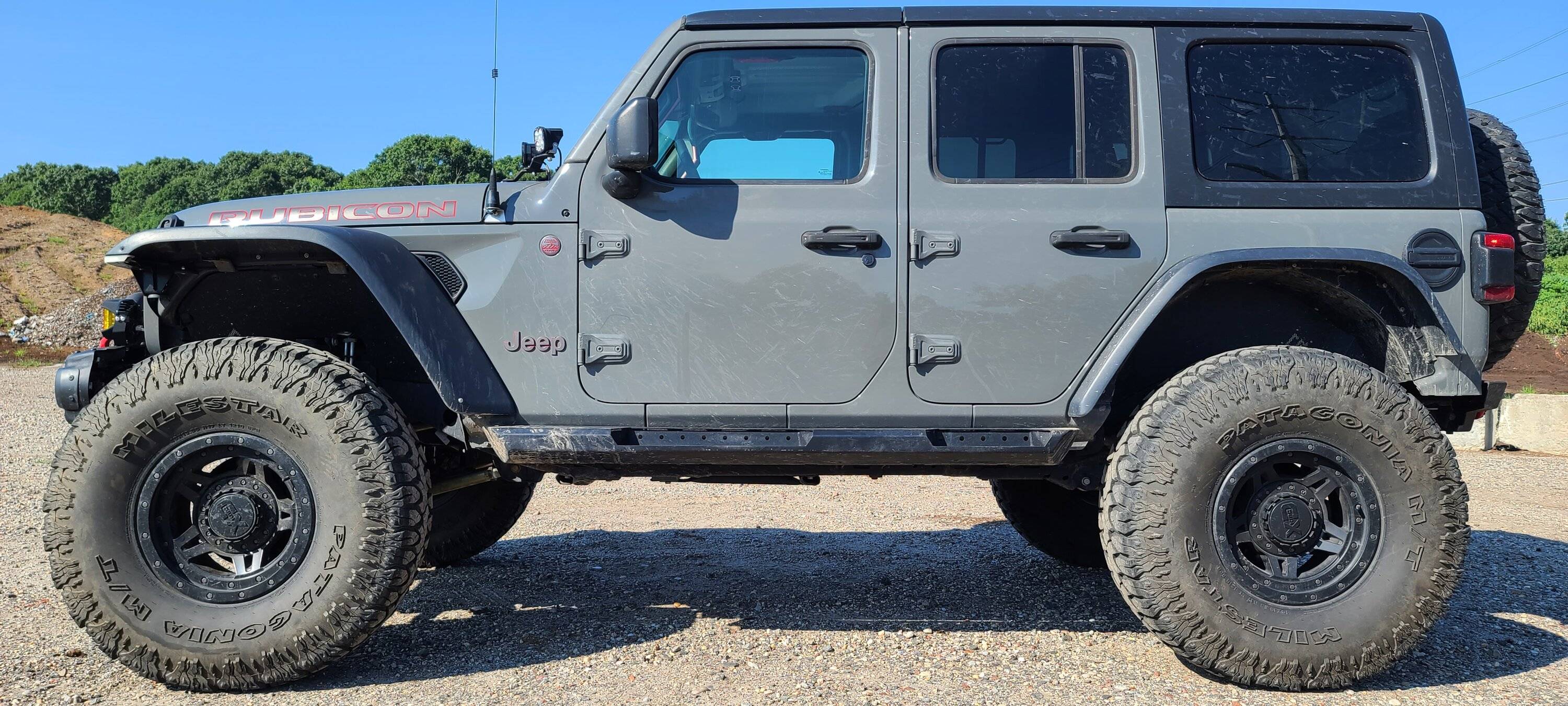

Um, not quite sure I'd personally give it 10x rating. Here's my stock Rubicon and than with 315/70-17’s and an actual 2" lift (ignore the chopped front fenders). Pretty much the xr and than some, when it comes to beefed up suspension and steering...
Jeep Wrangler JL XR observations 20190827_084948_resized(1)
Jeep Wrangler JL XR observations 20200423_092730
Definitely better looking and a bit more capable, but still relatively mild, and this is coming from the guy who paid for and installed everything. It's a great setup for those looking for a bit more right out of the gate.
This is what I would consider 10x better, and more mean and aggressive looking...
Jeep Wrangler JL XR observations 20220806_091606
It really just boils down to each individual and their specific use case.

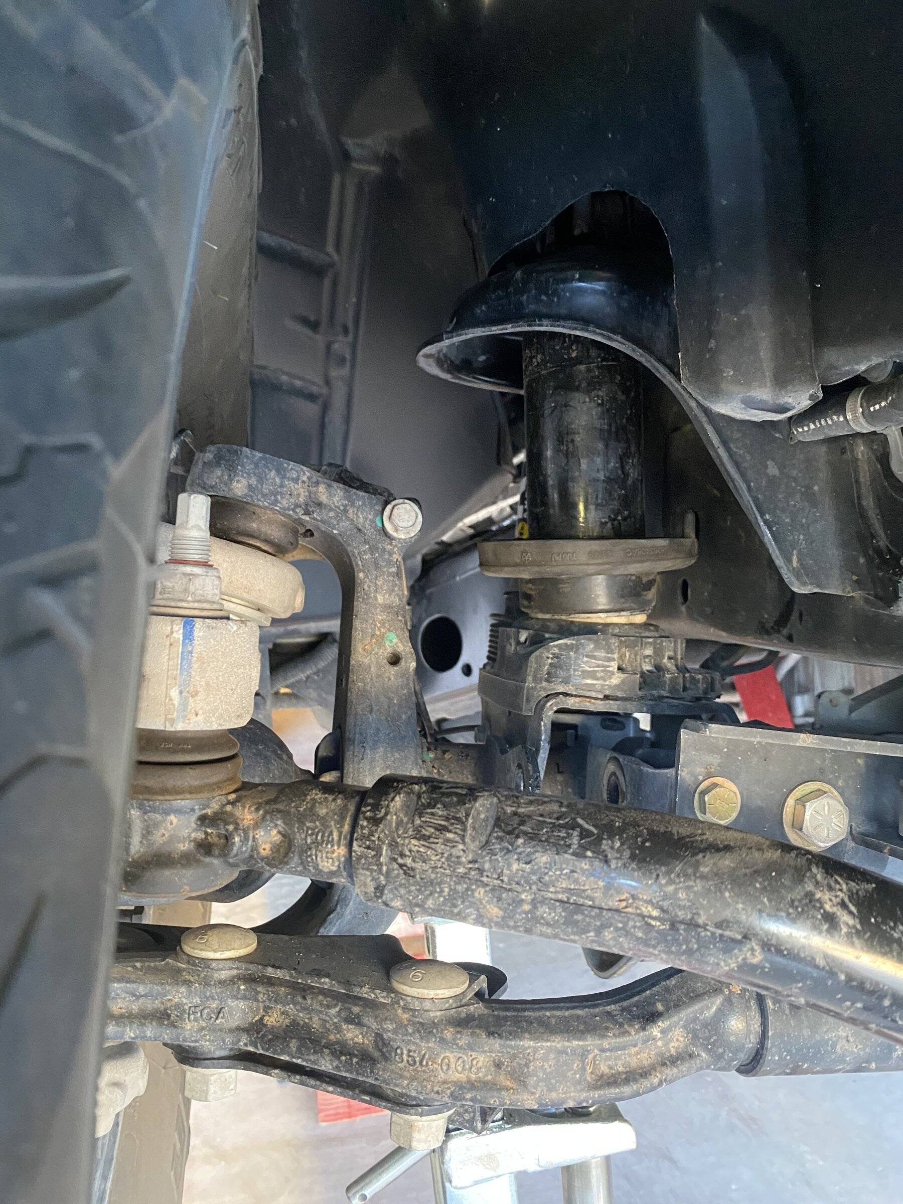

I don’t have an XR, I have a diesel (which has the same jounce tube). I also installed a lift within weeks of picking it up BUT the kit included bump stop extensions that were designed for the shorter jounce tubes.
So my resulting ~1” of up travel with the lift was still better than it was stock and I was bottoming out on the occasional pothole or speed bump.
The final straw for me was in Moab though when I had to go unreasonably slow over bumpy sections and was slowing down the group. When I got home I took the bump extensions out and now the springs and shocks handle bumps like they should.
Side note: I have the same size tires as the XR and these pics are with the springs out checking clearance. Not only to ensure I’m not going to hit the fenders but not bottom out the shocks. With only the (long) factory jounce tubes you can see there is plenty of clearance for the tire, and 37”s would probably also fit without any additional bump.

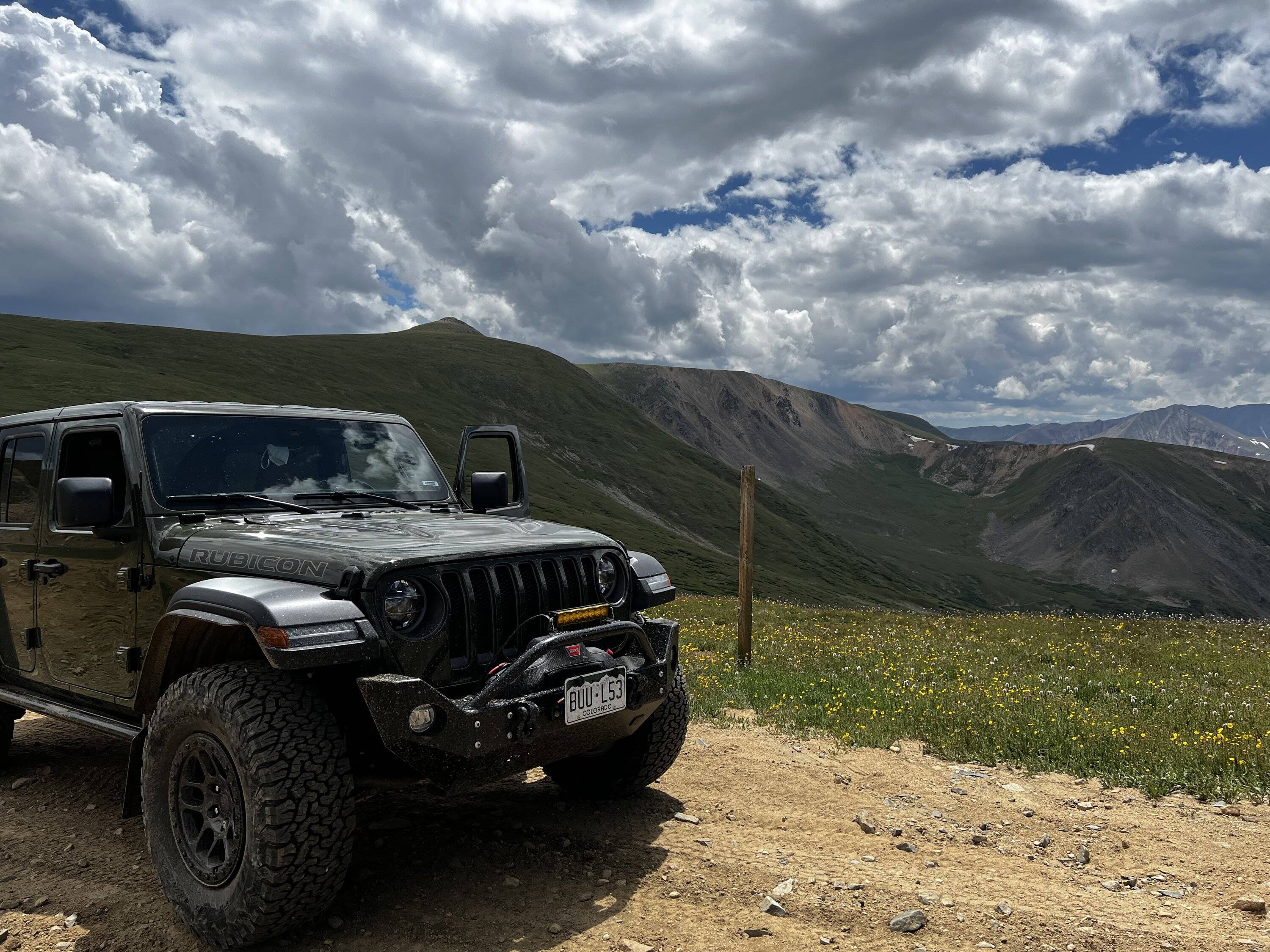

I looked at my front springs and didn't see any tags with part numbers..... but I did notice that my front bump jounce is very close to touching in the front just parked in my driveway. However I am not experiencing the bottoming out that others here are. Last Friday I ran 2 red trails outside of Montezuma (Red Cone & Radical Hill) and I was moving at a pretty decent clip according to folks I was with. I had no issues of bottoming out on bumps and there are quite a few bumps along these trails (also quickly ran two green trails to connect, Webster pass and Deer creek).
I do have an aftermarket front bumper and winch but my bumper is only 35 lbs (Rockhard4x4 aluminum) and I made sure the warn evo 8S winch had synthetic rope to keep weight as low as possible.
I still have plastic rear bumper but I also added under carriage aluminum skid plates and my XR drives like a dream.
I certainly am nervous when I see how little room is between the bump and jounce in the front but in the real world, it hasn’t seemed to limit my use or cause any bottoming out concerns.
Now I have a feeling if I loaded this Jeep up with gear and a roof top tent and carried another person or two along with me that I would be bottoming out ?

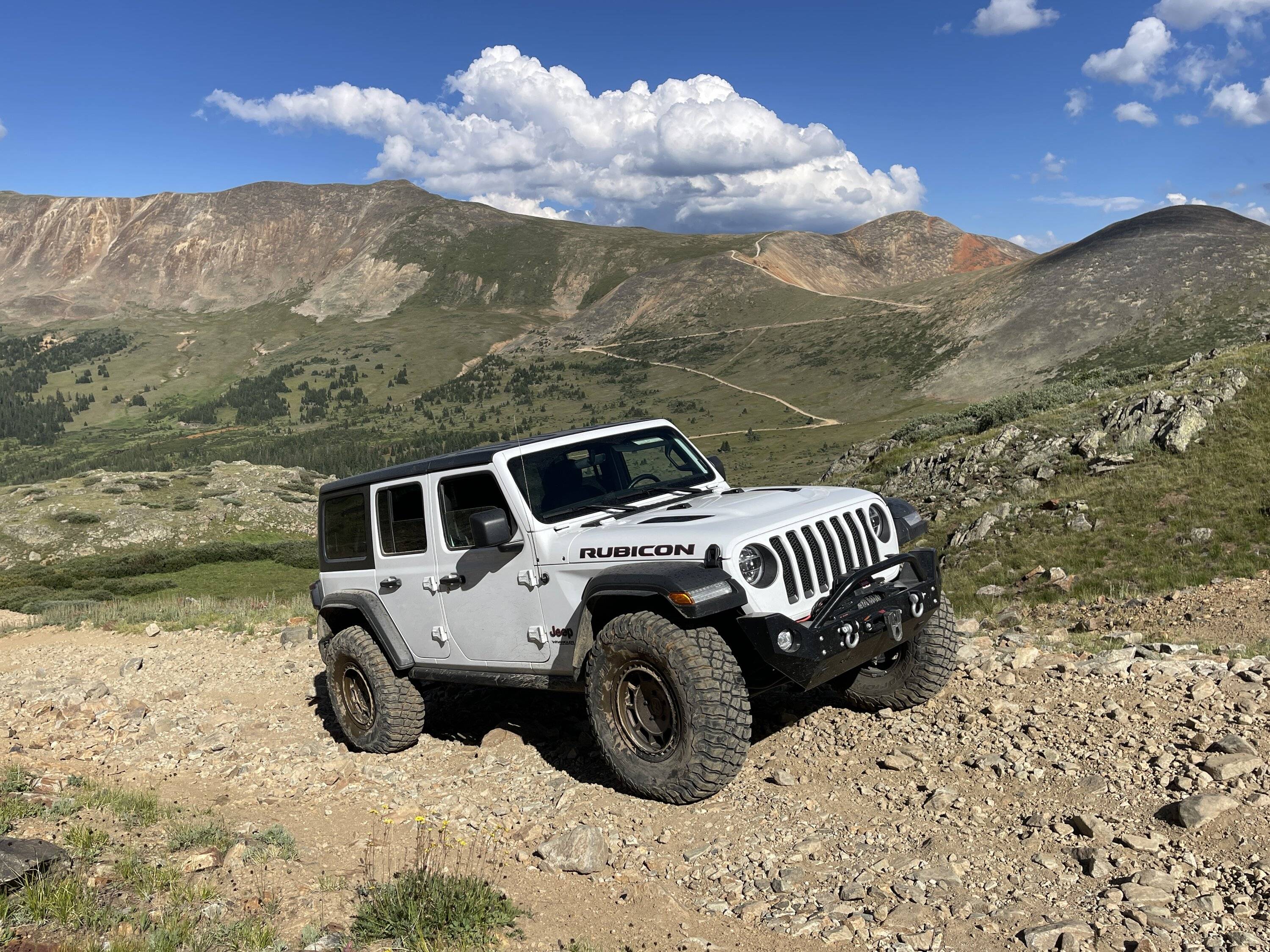

Nice rig! We have a similar setup but I went steel skids which weigh significantly more.
