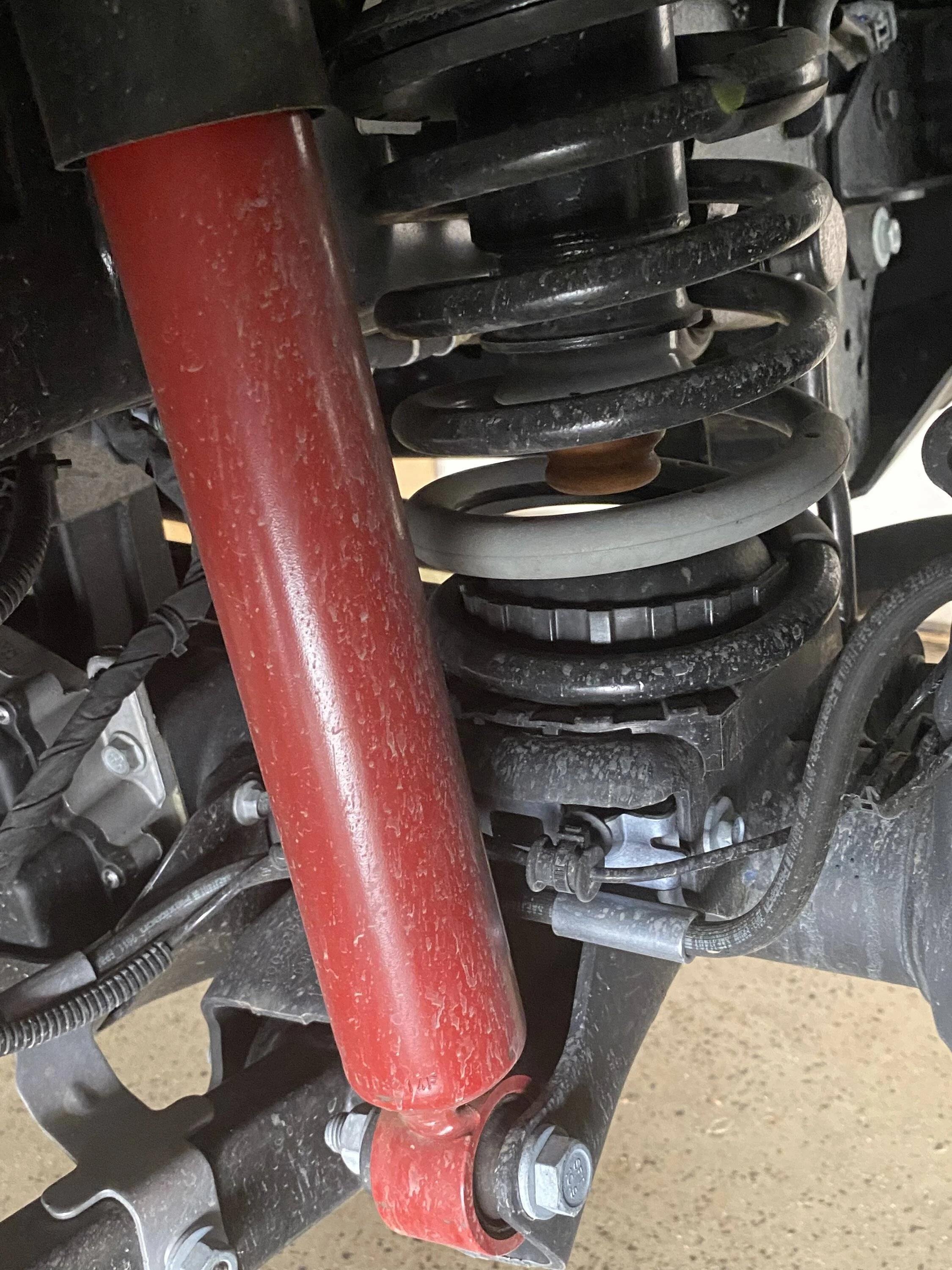

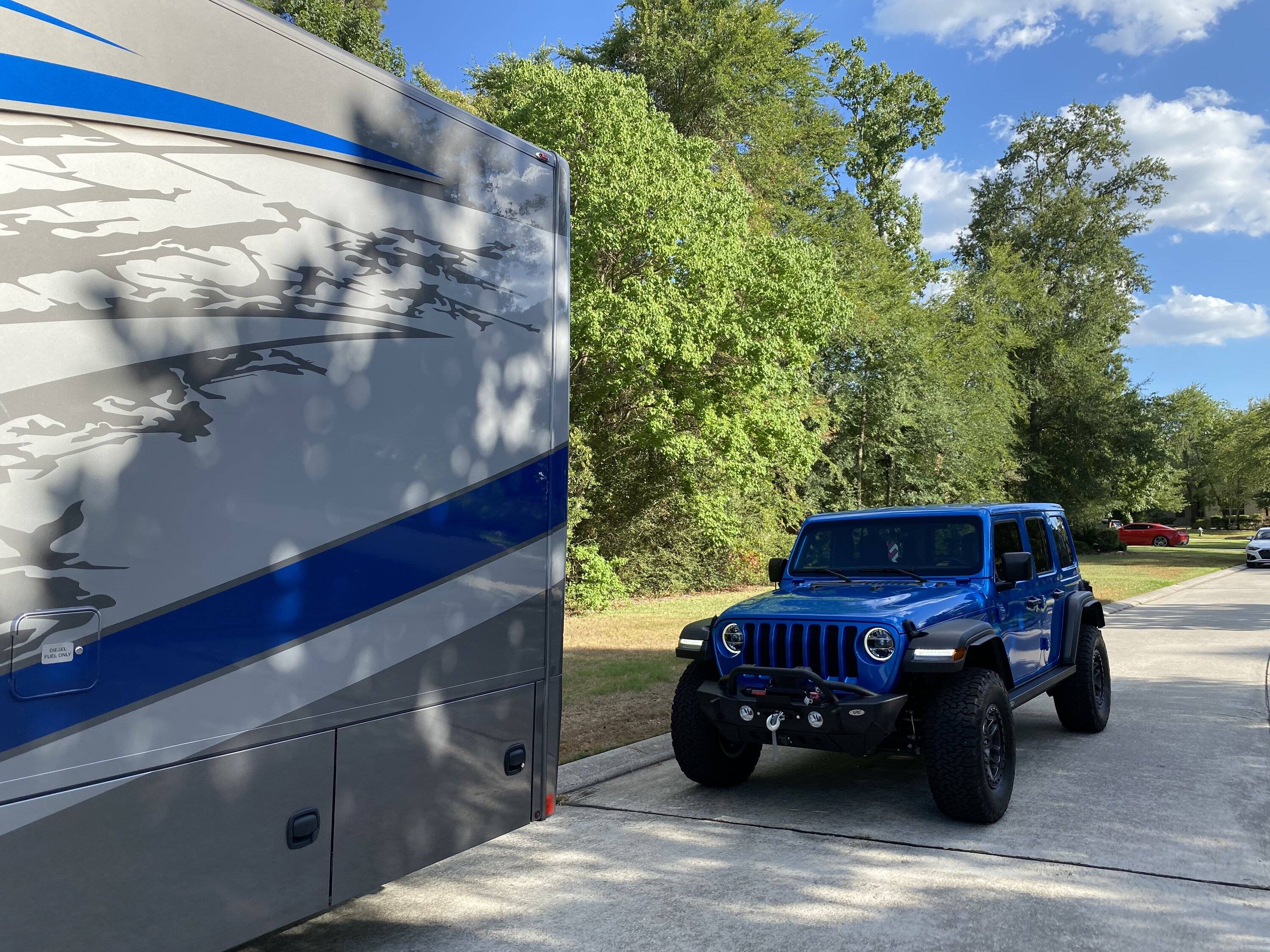

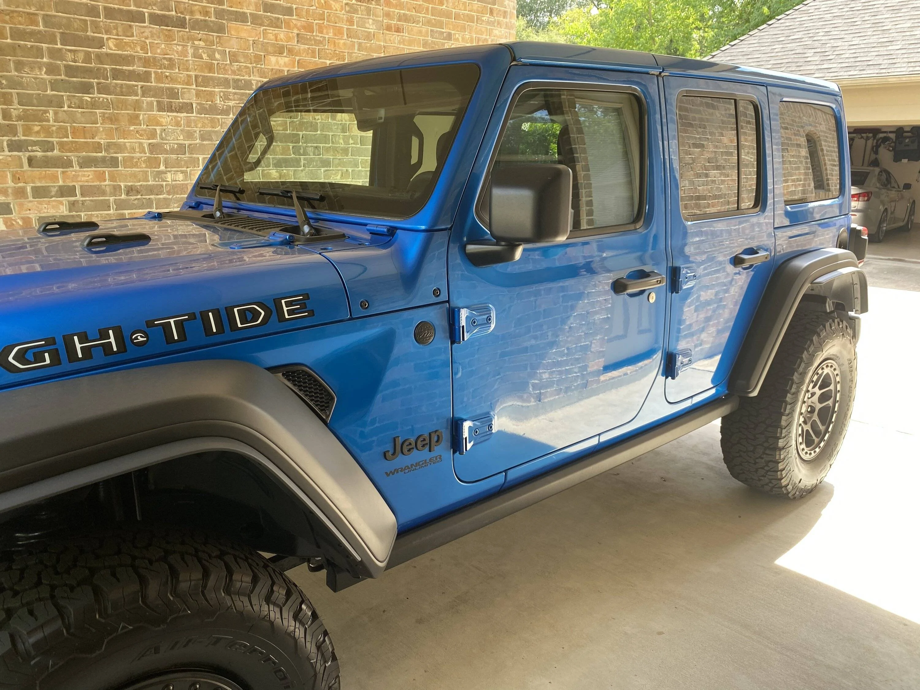

I’m pretty disappointed with the amount of sag from adding weight on my XR package, 2022 JLU High Tide. I took some measurements before adding my bumper, winch, and rock slide engineering steps plus adding recovery equipment, tools, etc… in the back (I wish I had taken weight measurements at each axle too).
I ended up losing about 7/8” in the front and 1/2” in the rear. And don’t have much travel left before hitting the bump stops. I don’t drive much and have only about 500 miles on this setup (800 miles total) but have bottomed out twice already.
I thinking spacers are necessary to get me back up but I guess would only be a temporary solution as I’d still like to add some skids and lights. I was really hoping the XR package would be enough so I could have a very capable Jeep from the factory with warranty given the cost.
I guess eventually I’m looking at a ~3” lift and dropping a few thousand, argh!!!!
Here’s a before, after, and bump stop pic
