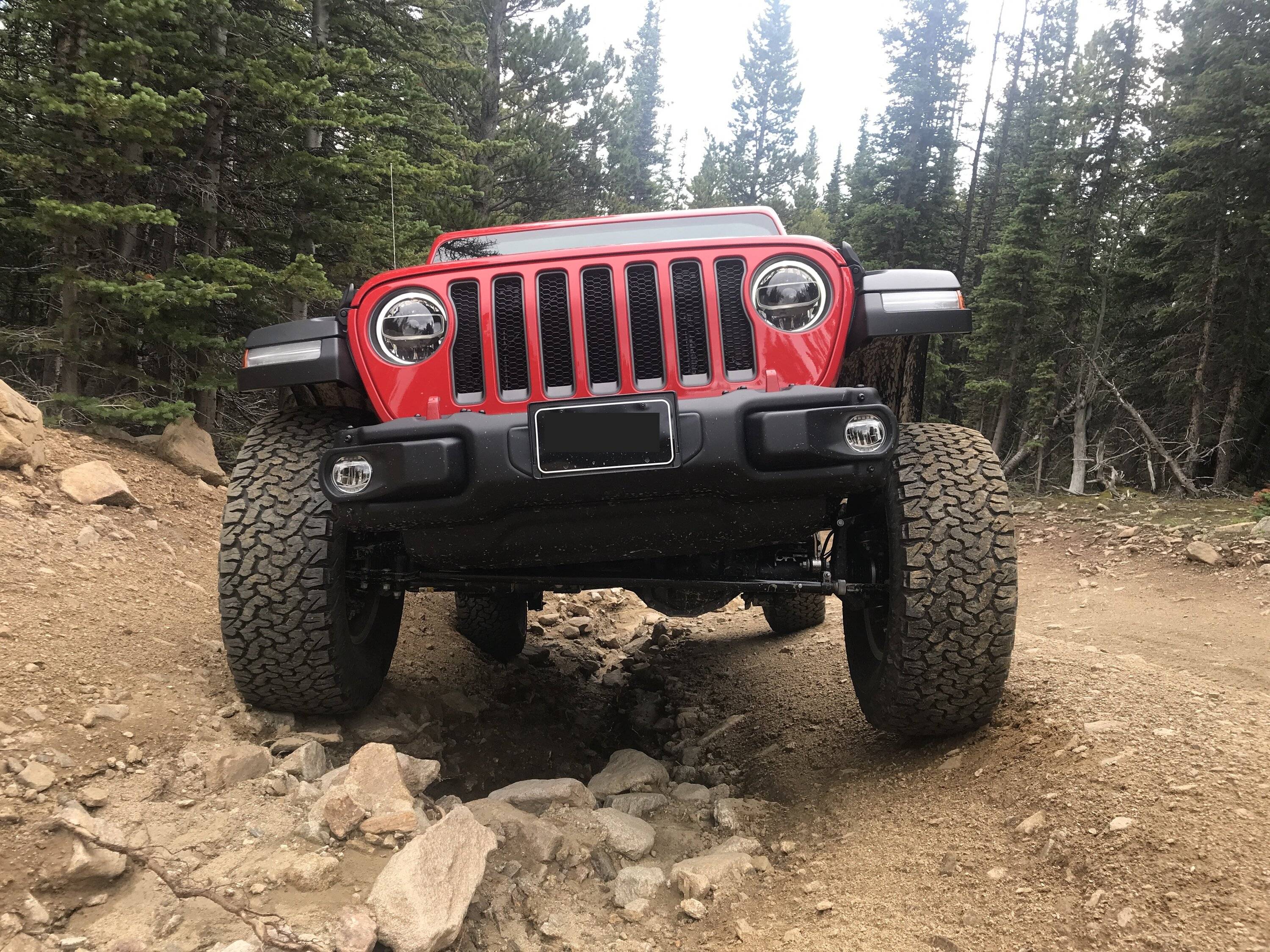

I got my XR out on a trail for the first time. For reference, I am one of the ones who only has like .7 inches of bump stop gap. All in all, I thought it performed well enough and I was generally happy. Moab will be a better test. I had fun, though.
