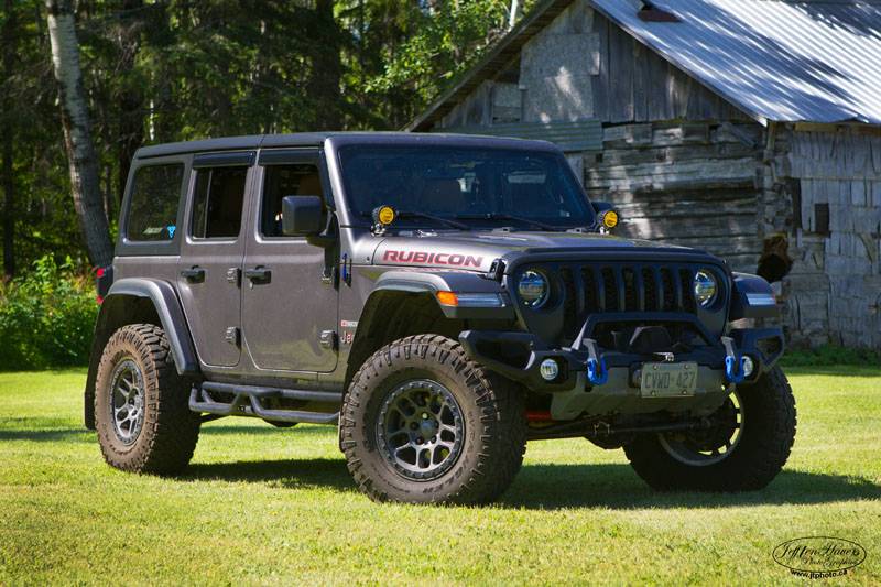

I'm struggling with what you're debating about here.
The problem is that a lot of people get the XR thinking they won't need to do anything to it. Things like installing a lift.
In the above statement "like" was followed by an example (installing a lift).
This is preceded by the "anything" would include changing the springs, or shocks, or cutting bump stops, or adding spacers, etc.
Some people like them stock just fine and that’s oK. They still work fine that way, but start loading the gear on and you have a different situation. I knew going in that I needed to put better springs and shocks in. I wanted the XR specifically for the heavier diff and 4.56 gears not the whimpy 1.5” lift.
2.5” springs make it perfect.
