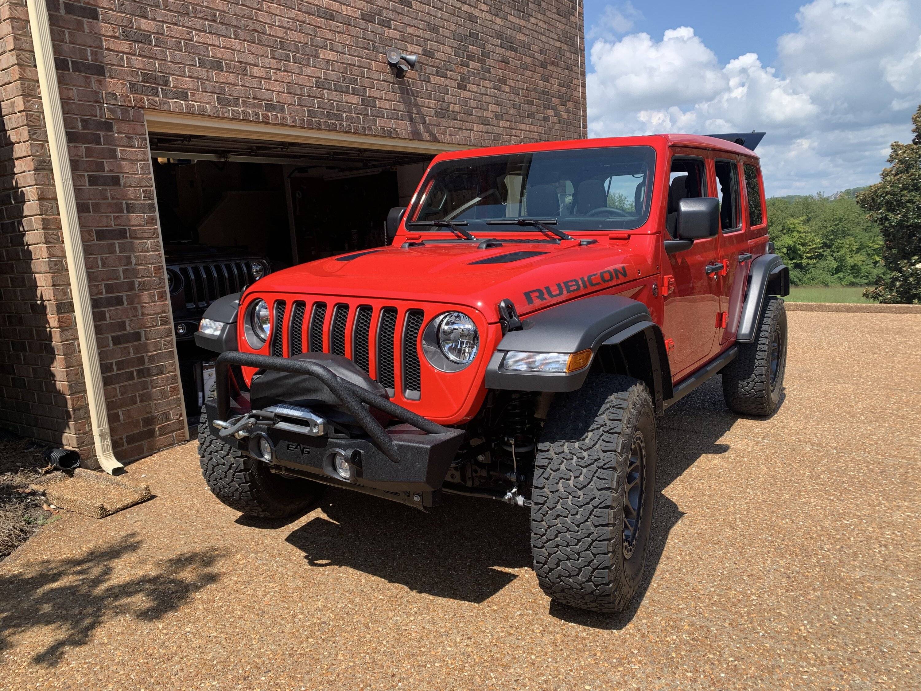

I added a 3/4” spacer, and recovered the height lost when I added the winch and bumper. When I can access better equipment, I’ll flex it out and see if I am going to install hydraulic bump stops to gain more up travel. I don’t plan to go higher than 35s because the top of the door to my garage is too close to the open SOT as it is. ?
The more I think about it, the clearer it is to me that the XR package should have come with 37s. The gearing is a bit low for 35s (for me - auto with 3.6). And the lift combined with the crazy long jounce tubes - makes sense for 37s.

I bet the did the XR as a way for people to get 37s with minimal modifications.
