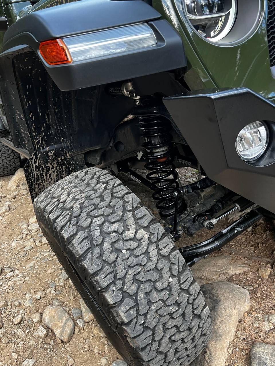

Even though the $42 Teraflex Eco-Diesel spacers largely solved my bump stop/up-travel issue, I have now gone way overboard with a 3.5 inch Teraflex CT3 lift and Falcon shocks. Went ahead and upgraded the steering while it was apart. Surprisingly with only 4,000 miles, I already had a little slop at the pitman arm. Now it flexes like I had hoped! Left it on 35s for now. Maybe toss on some 37s when these wear out.
Looks good. May want to check if additional bump stop required on front not to destroy your shocks ?‍♂
They are listed as long enough for 2-4.5 inches of lift, hopefully I'll be alright.
Referencing compressed length. Adding 3.5 lift, would think you need additional bump even though XR has extended.
