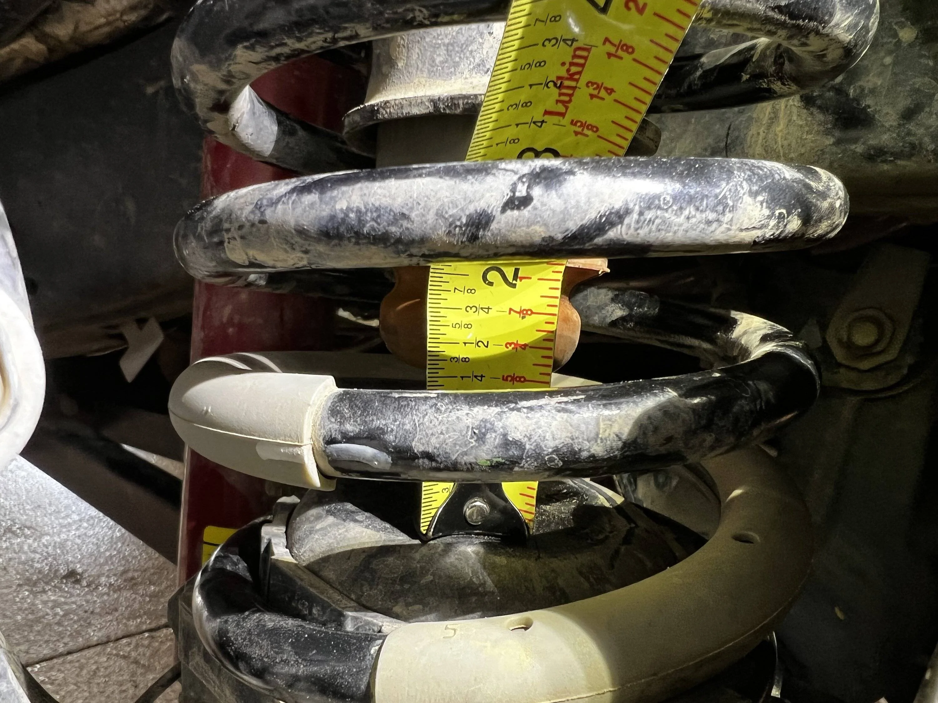

Craiger was/is correct. A one inch spacer from Teraflex pretty much solves this problem. I just installed it and gained about 1 1/4 to 1 1/2 inches of bump stop space. Shock length is also 1.5” longer now. I just took all the bumps/dips around town that I’d bottom out on and it was just fine.
