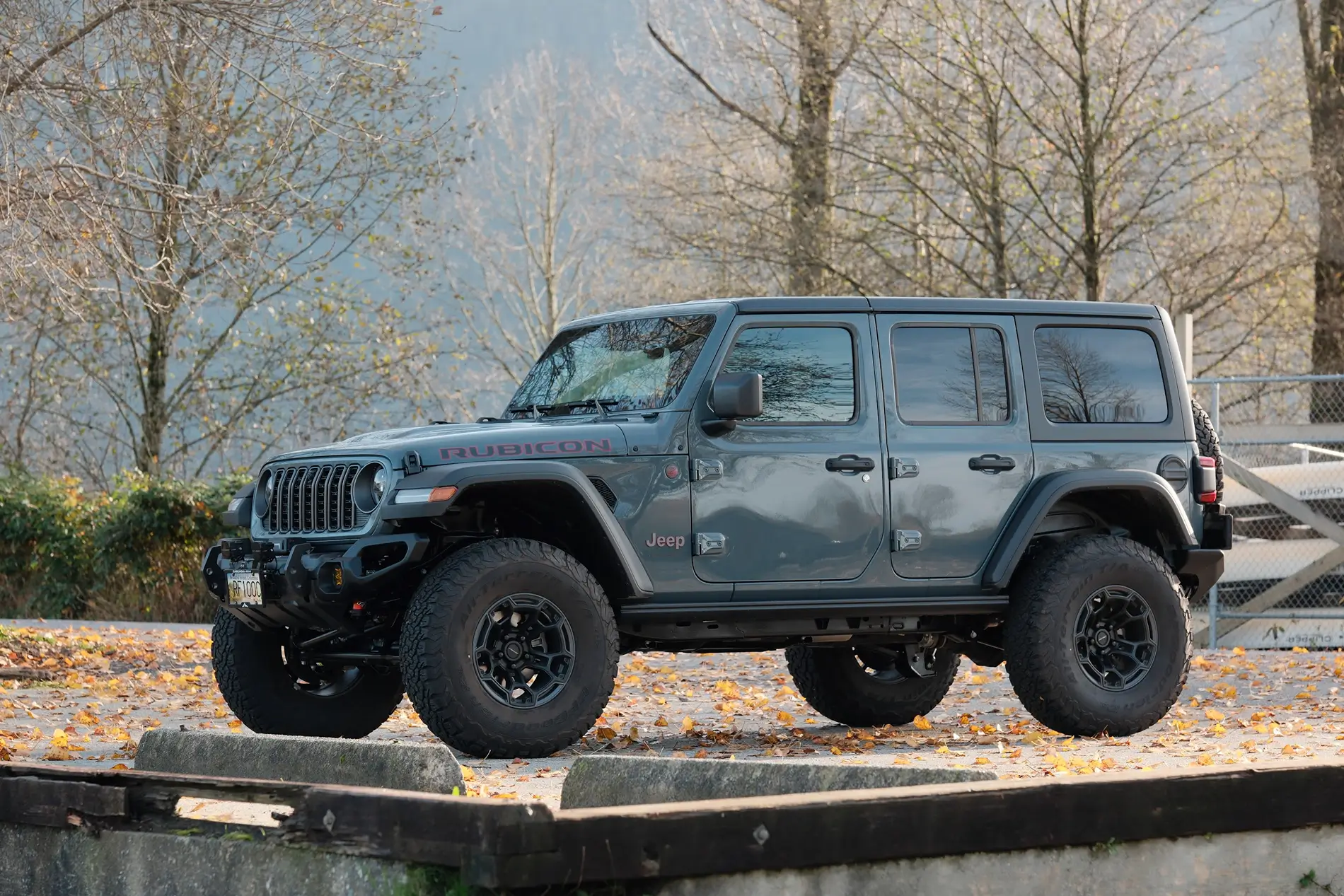

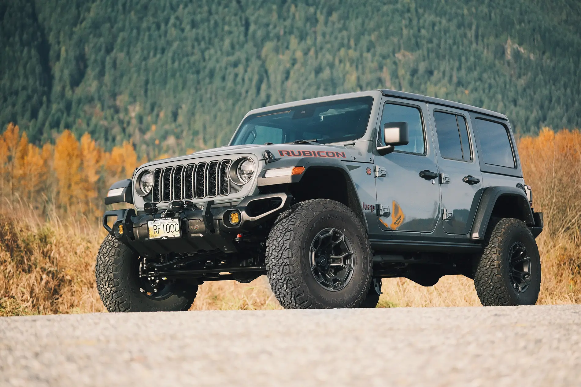

Since this was a rushed trade-in, my friend at the dealership worked on getting this jeep shipped from vancouver island to lower mainland. This was a left over 2025 stock that came with a 10k CAD discount on price. It was an interesting build set that someone custom ordered but decided not to buy. Anvil is an interesting color - it had shades of both my previous jeeps - it looks earl-like in full sunlight and darkens to almost sting gray in dim light. I will miss the earl color, but I think this one will grow on me just like earl did.
I transferred over pretty much all of my suspension components from the 4xe as is - excluding the springs. New AEV 2.5 springs set for 3.6/2.0 was put in. I don't think this thread will be as eventful and planned out like the 4xe. Nevertheless, looking forward to many more off-road miles with this jeep.

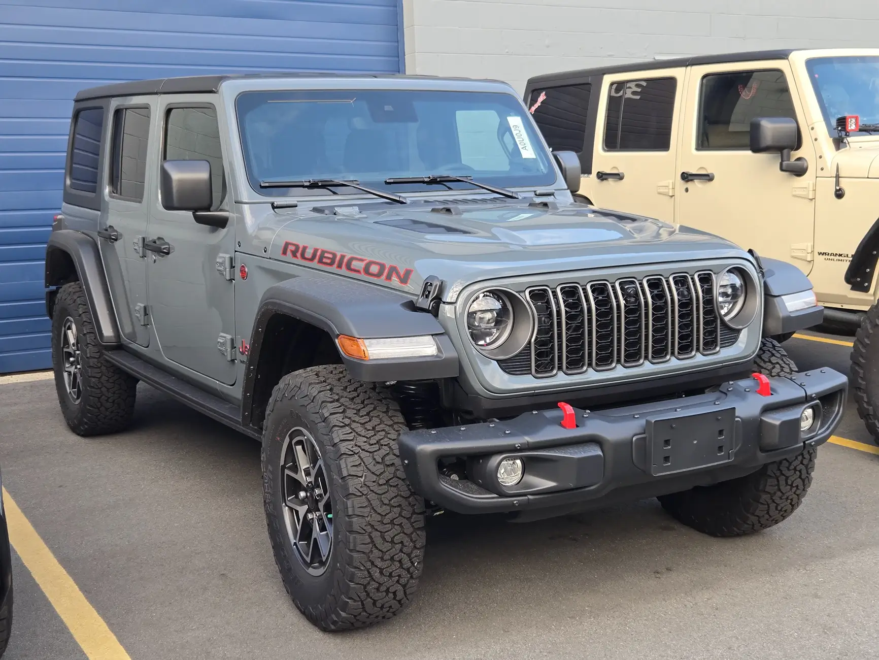

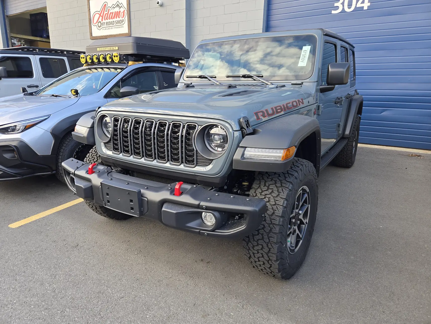

Stock State:
Jeep Wrangler JL GrayWolf 3.0 | 2025 Rubicon 3.6L - Build Thread 1763087520268-v
Jeep Wrangler JL GrayWolf 3.0 | 2025 Rubicon 3.6L - Build Thread 1763087552197-o9

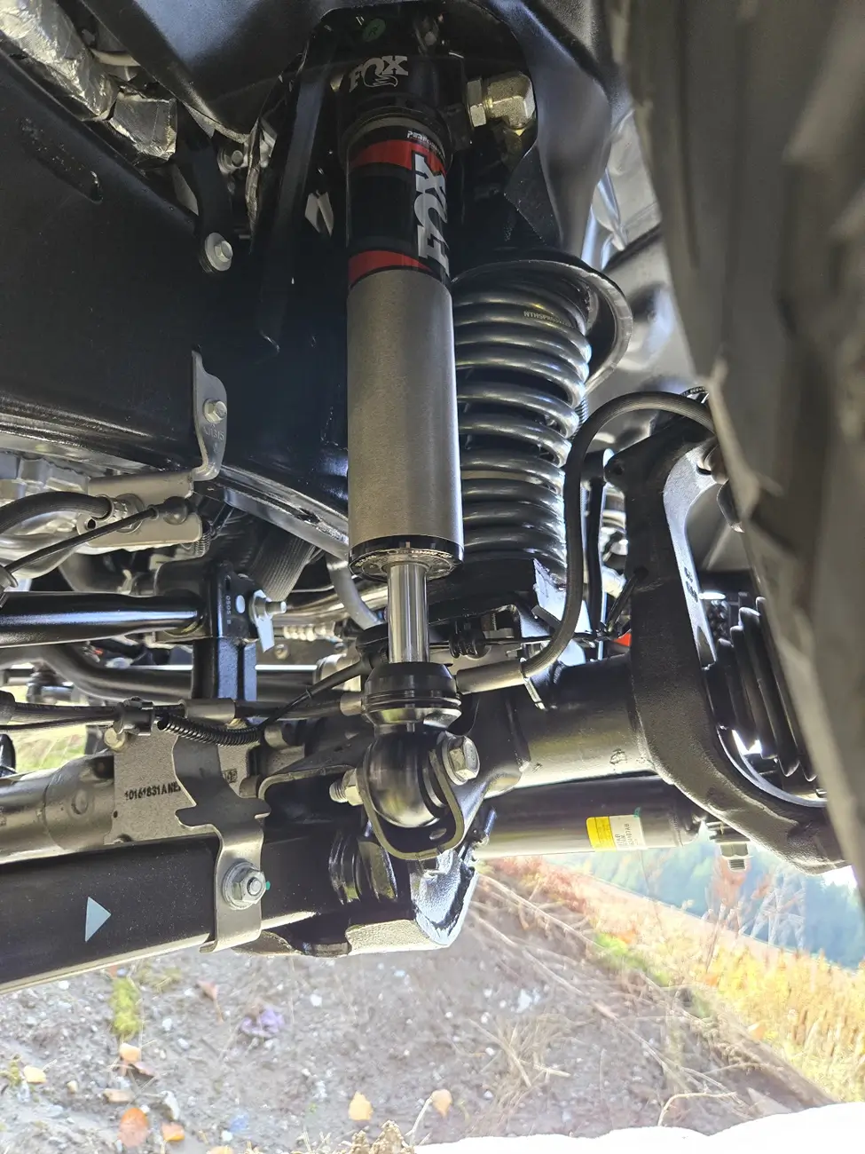

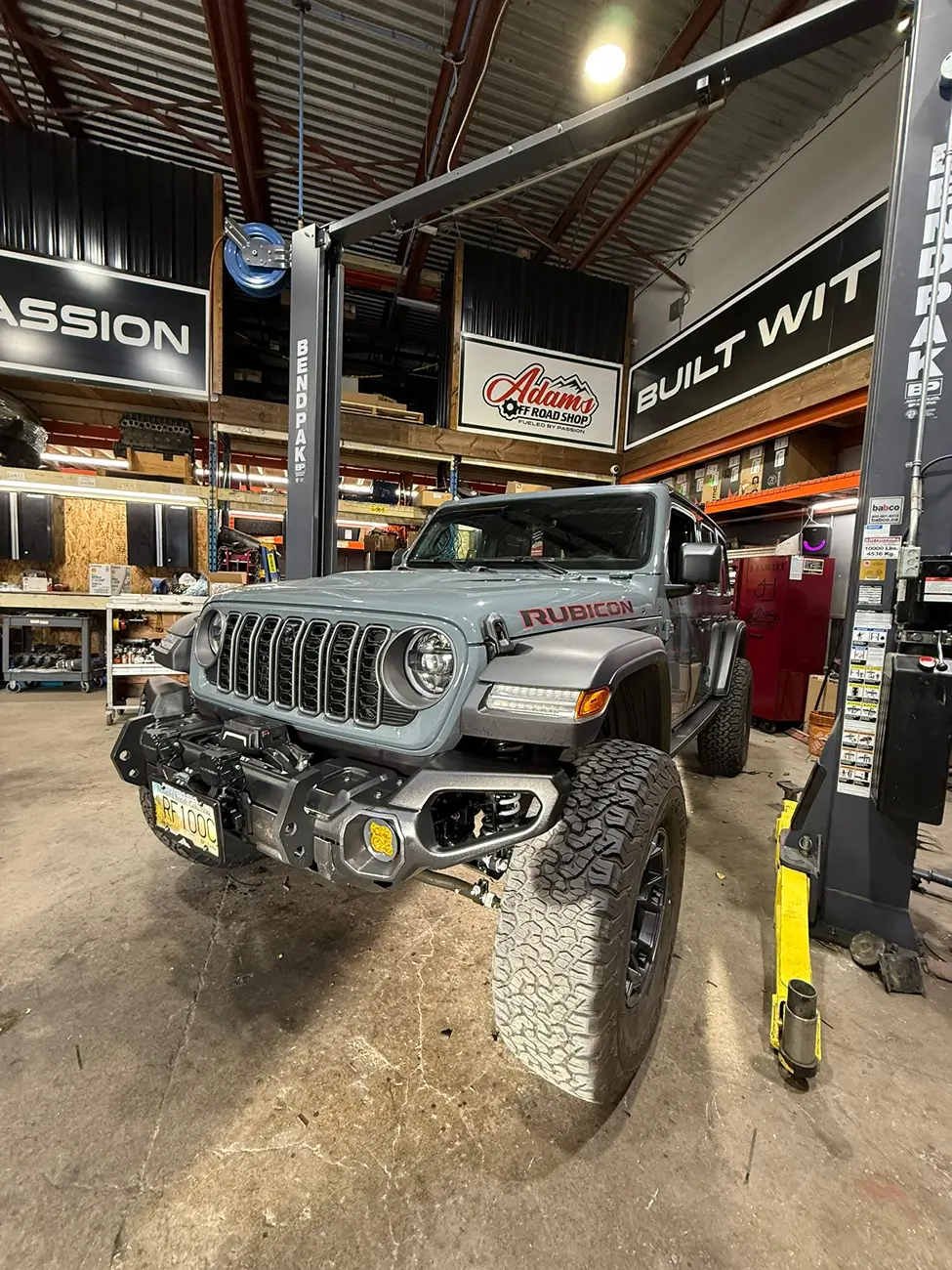

After Swap of Suspension - @ Adams Offroad Shop
Jeep Wrangler JL GrayWolf 3.0 | 2025 Rubicon 3.6L - Build Thread 1763087647371-0u

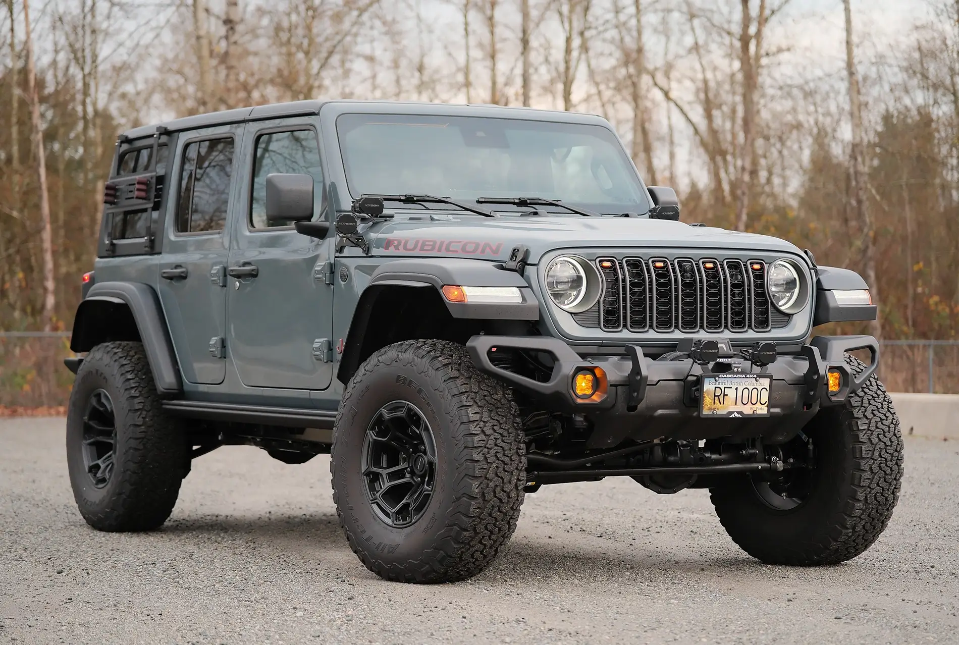

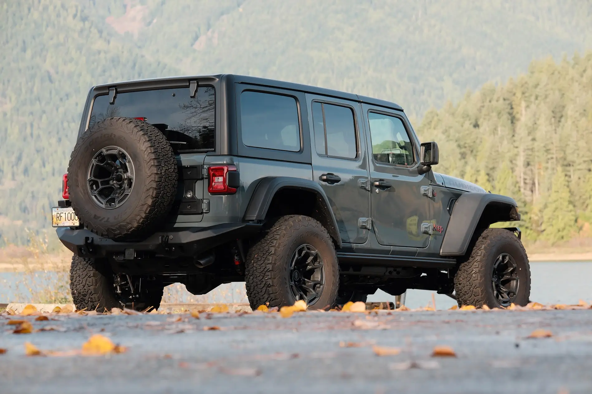

Current State (Nov 13th 2025)
Jeep Wrangler JL GrayWolf 3.0 | 2025 Rubicon 3.6L - Build Thread 1763087764410-h6
Jeep Wrangler JL GrayWolf 3.0 | 2025 Rubicon 3.6L - Build Thread 1763087708394-34

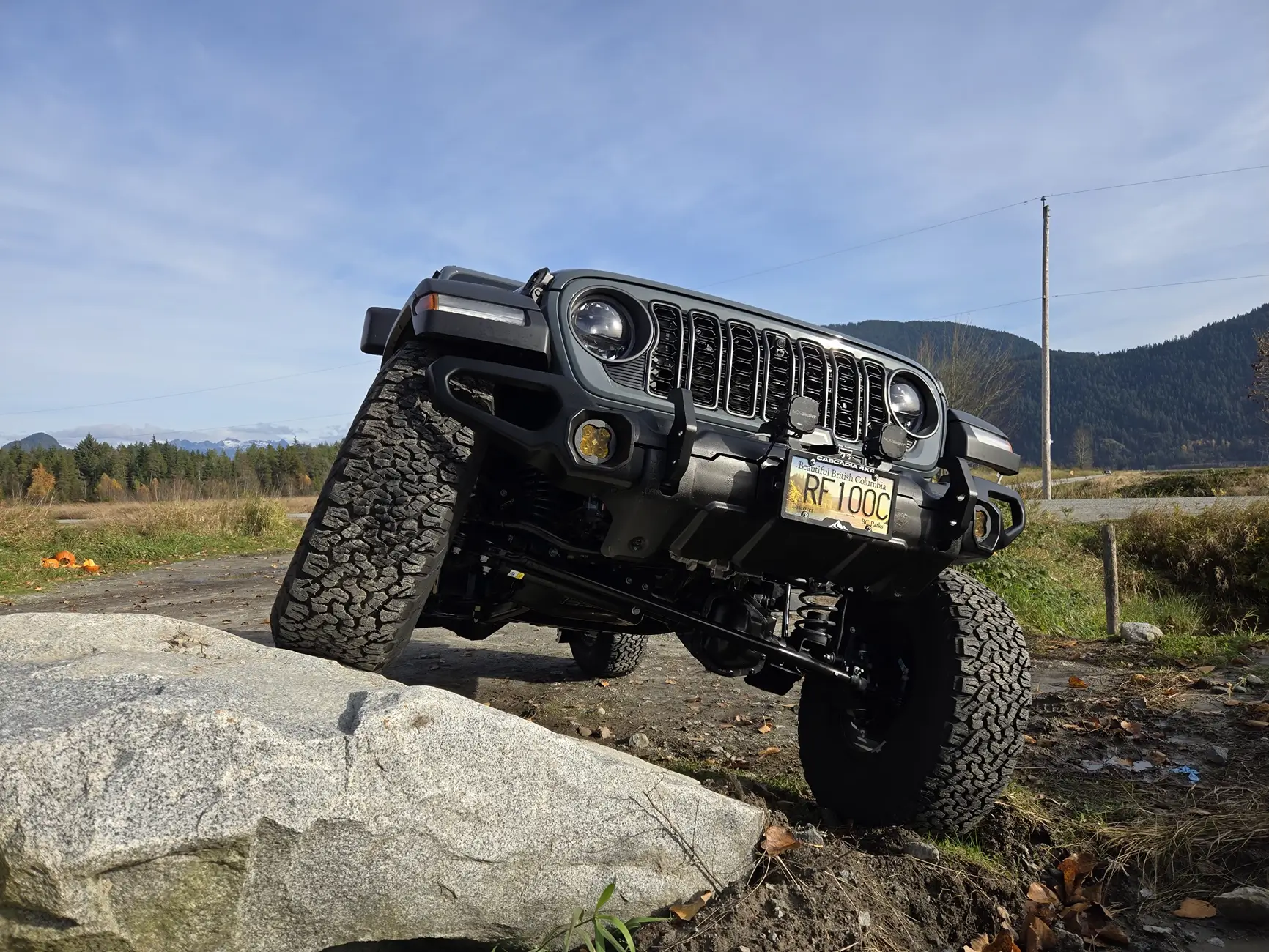

Flexing after the suspension was put together.
Jeep Wrangler JL GrayWolf 3.0 | 2025 Rubicon 3.6L - Build Thread 1763087437292-bc
Jeep Wrangler JL GrayWolf 3.0 | 2025 Rubicon 3.6L - Build Thread 1763087841133-s8

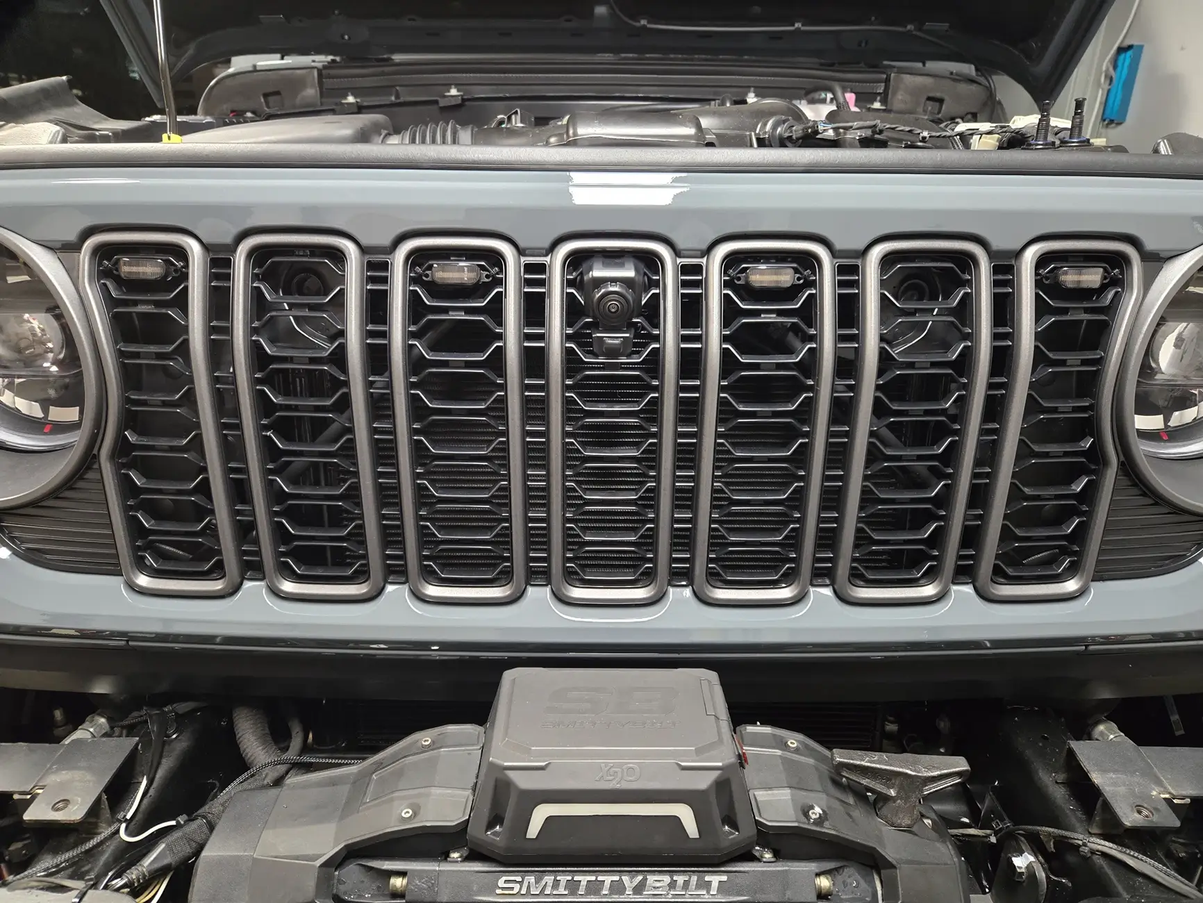

Cable Management so far. I still need to add 2 sets of cowl/a-pillar lights but those harnesses run along the back line - into the auxbeam hub. So it should look the same even after those 2 lights.
I added these battery terminal extenders that have helped cleanly organize things
