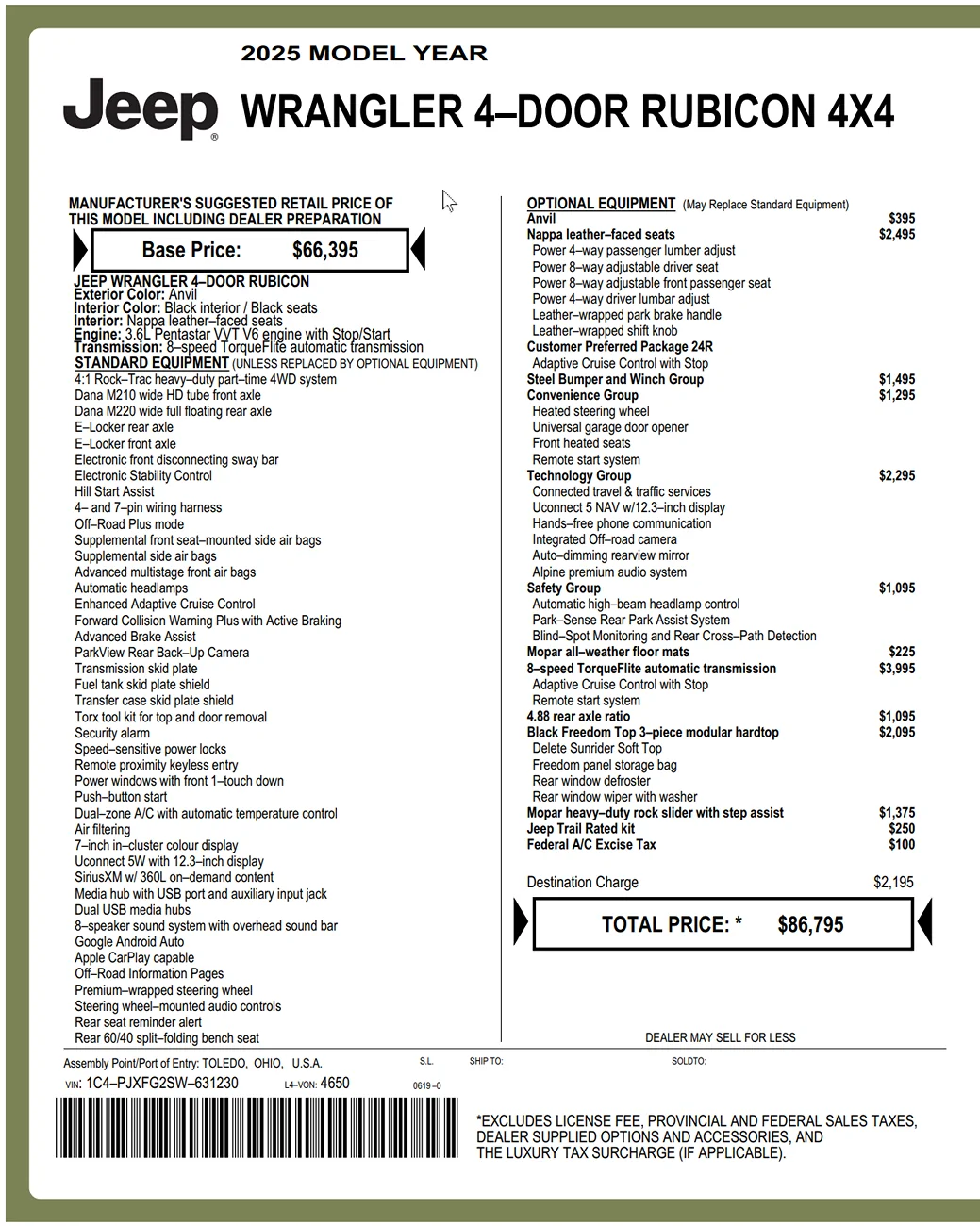

TIL - on 2025 Rubicon a factory 4.88 option gets you 10mm tube DANA M210 WIDE HD TUBE FRONT AXLE & the Steel Knuckles.
Great! I actually appreciated having those sturdy axles on the 4xe, seems like this jeep has it too. I didn't know the $1000 CAD 4.88 options bumps you up on better axles.

for that price, just the 4.88s make it a total steal… including the better axles make it just an incrdible value! Congrats to you for finding it, and to Jeep for making an awesome package (for a change!)

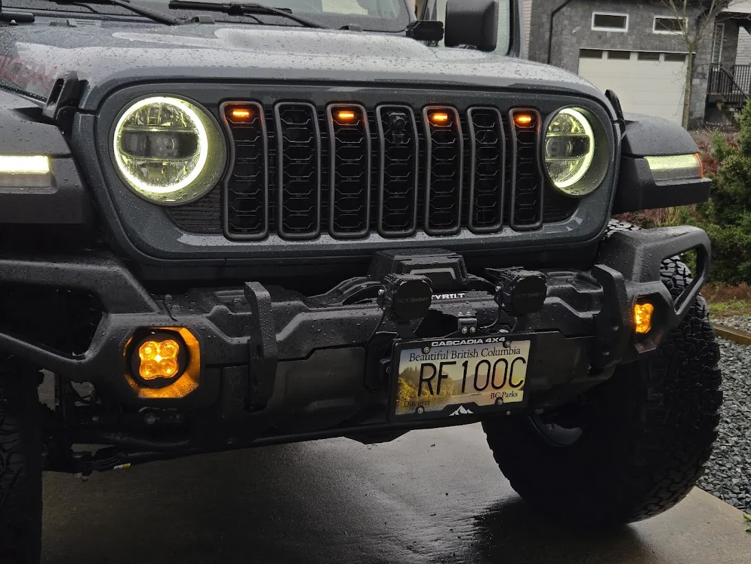

@ORACLElights - Pre-runner lights. These are actually very bright and I love the deep amber color instead of the sad yellow in the previous set I bought off amazon. Nicely done Oracle.
The amber matches my @Diode Dynamics SS3 Fog's amber DRL perfectly.

These look awesome, such a small but great upgrade! 👏🏻

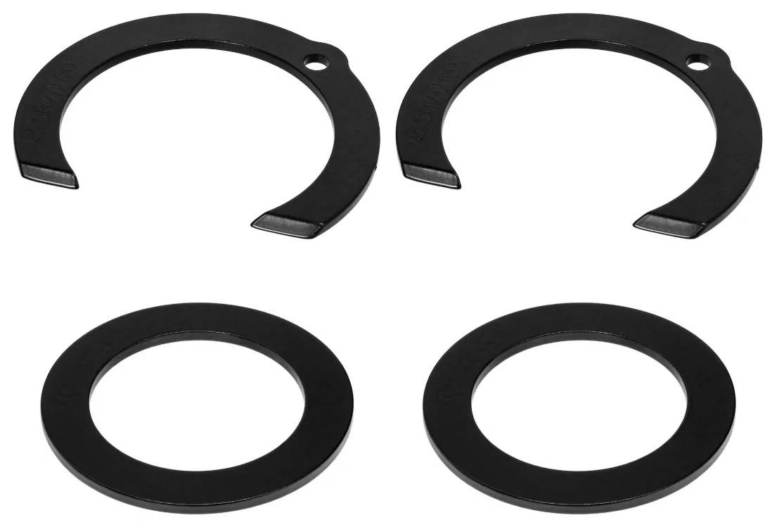

I have a bit of a lean on the passenger side. This is most likely because of the missing shims that comes in the AEV lift kit but they conveniently doesn't include them in their coil spring set. RockJock makes a similar shim set in both 3/16 and 1/4 size. I am going to get a front and rear 1/4 shims from them.
Jeep Wrangler JL GrayWolf 3.0 | 2025 Rubicon 3.6L - Build Thread 1763707286118-xm
Rock Jock - https://www.rockjock4x4.com/RJ-107SHIM-BDL

  • RockJock Front 1/4 shim - RJ-107100-3 (front passenger side)
  • RockJock Rear 1/4 shim - RJ-107400-3 (rear passenger side)

Your Window sticker has some huge numbers. Then I realized it's in Canadian dollars. :)
Seems it was a fantastic base starting point for what you have built.

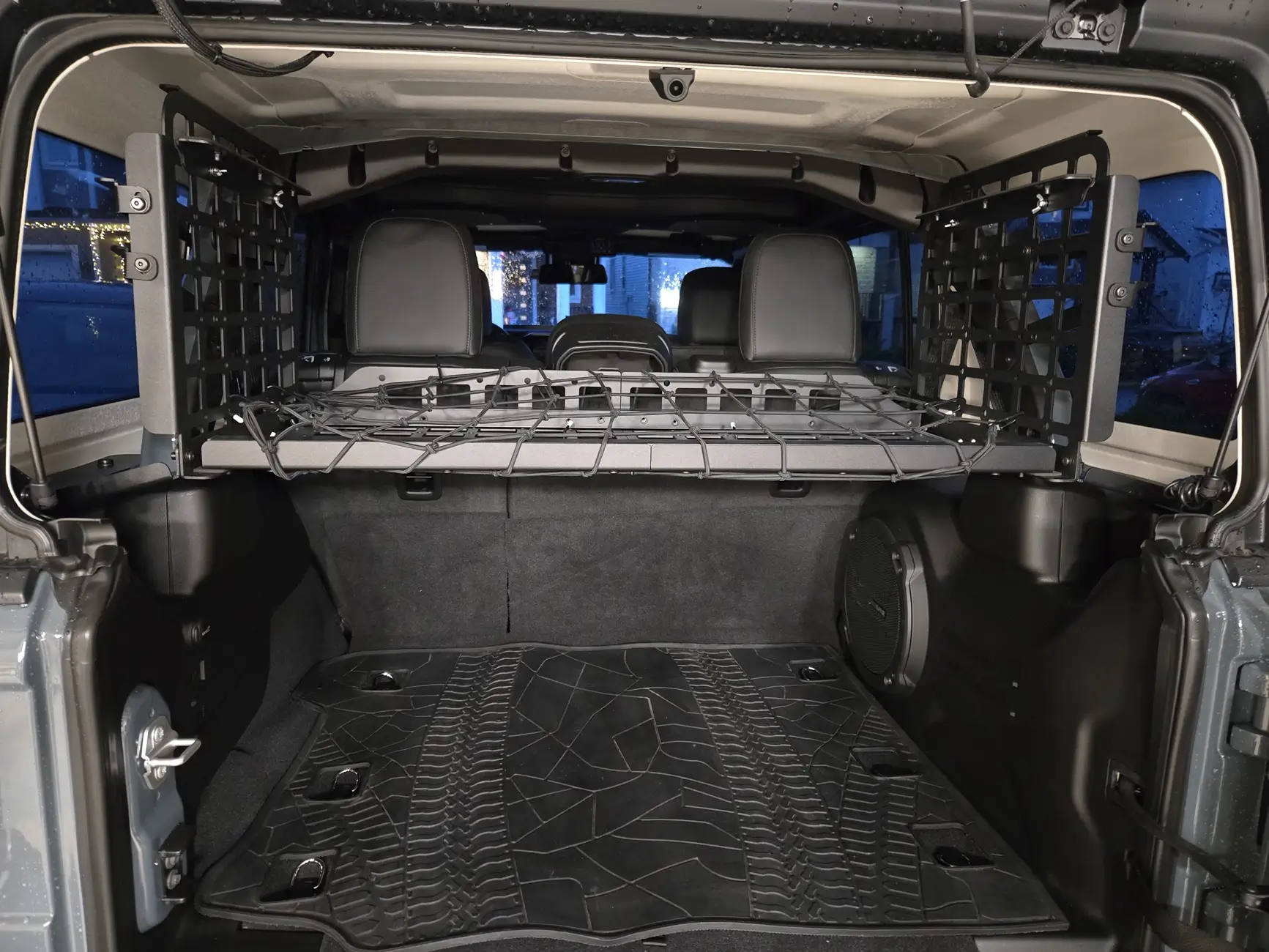

Got the cargo rack back up. Need to figure out how I can mount a single rotopax water can (2gal) on the right side bottom of the middle tray. This molle system has larger rectangles and the usual molle mounting bolts (like tacmolle) aint working on this one.
Jeep Wrangler JL GrayWolf 3.0 | 2025 Rubicon 3.6L - Build Thread 1764056623927-ly
Got the rubber cargo mat from my old 2020 jeep back in there. Trailrax pakrax bottom plates were slightly rusted, i scraped and sanded them a bit and spray painted. Will install them later this week.
