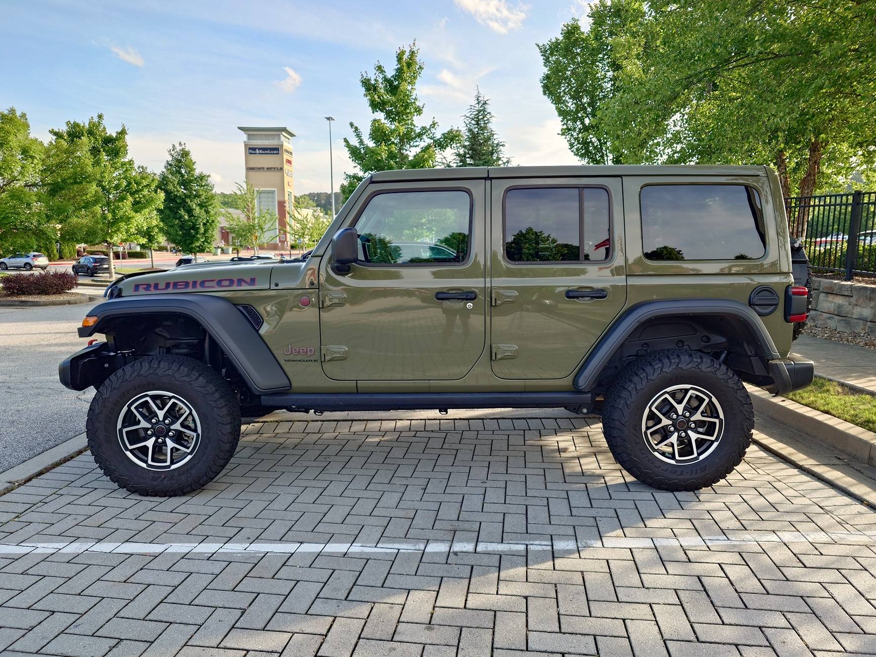

End of the day I bought it for $11,000 off MSRP without any markups or addons.

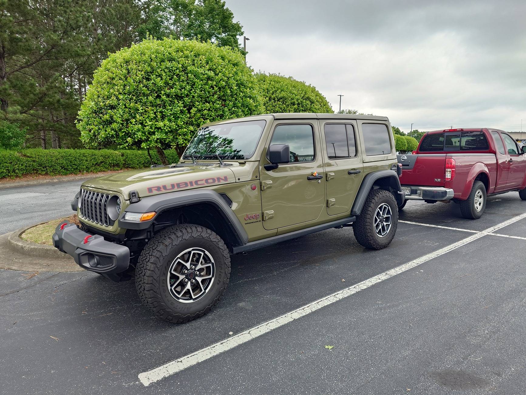

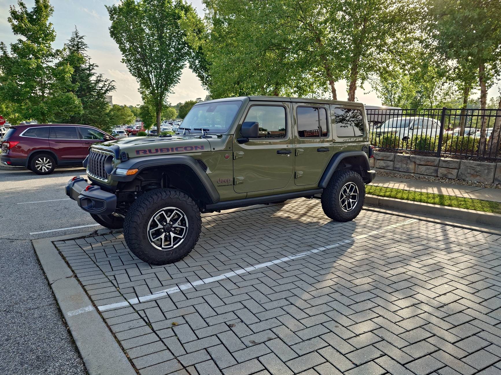

First picture at the dealer.

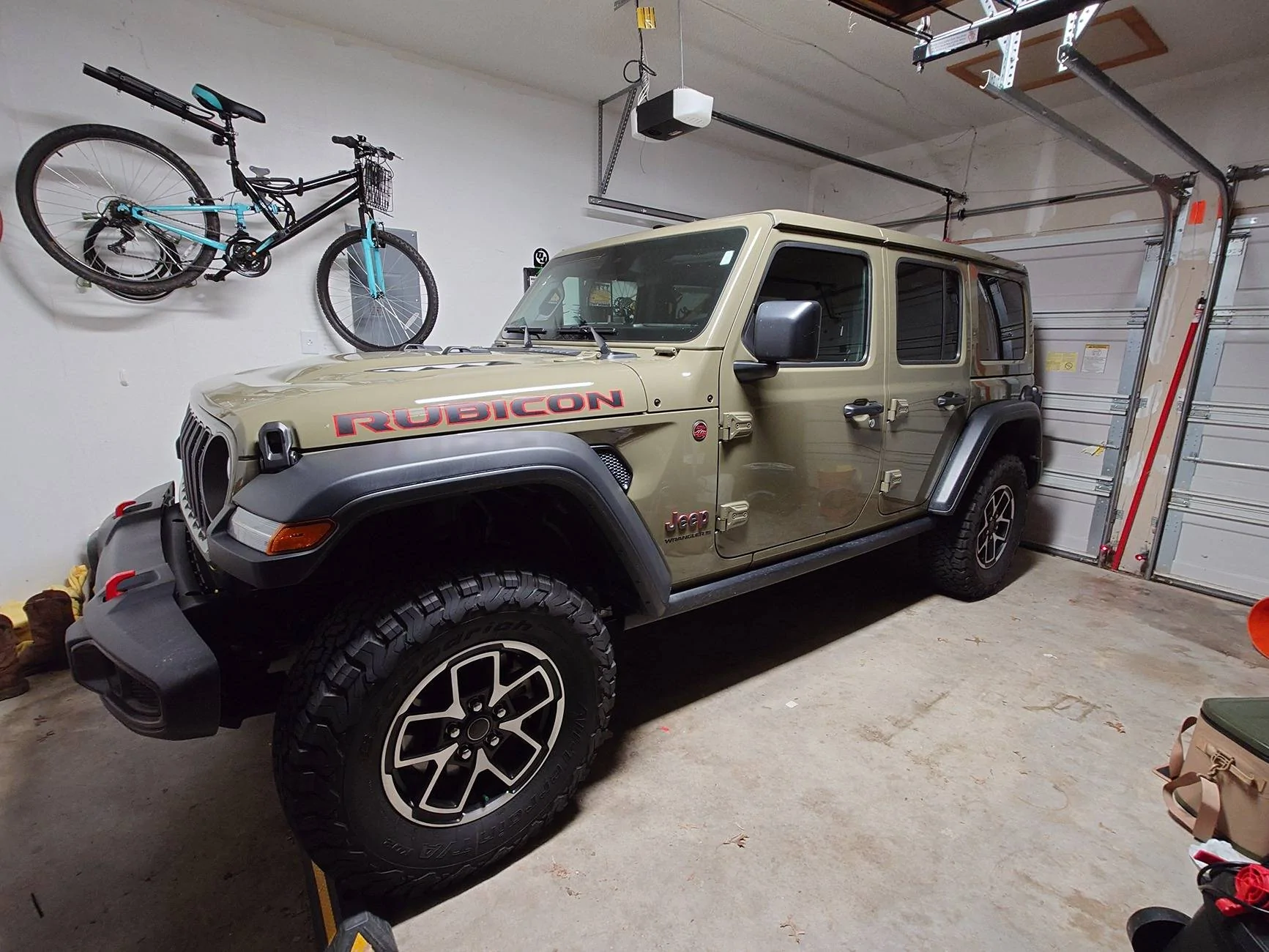

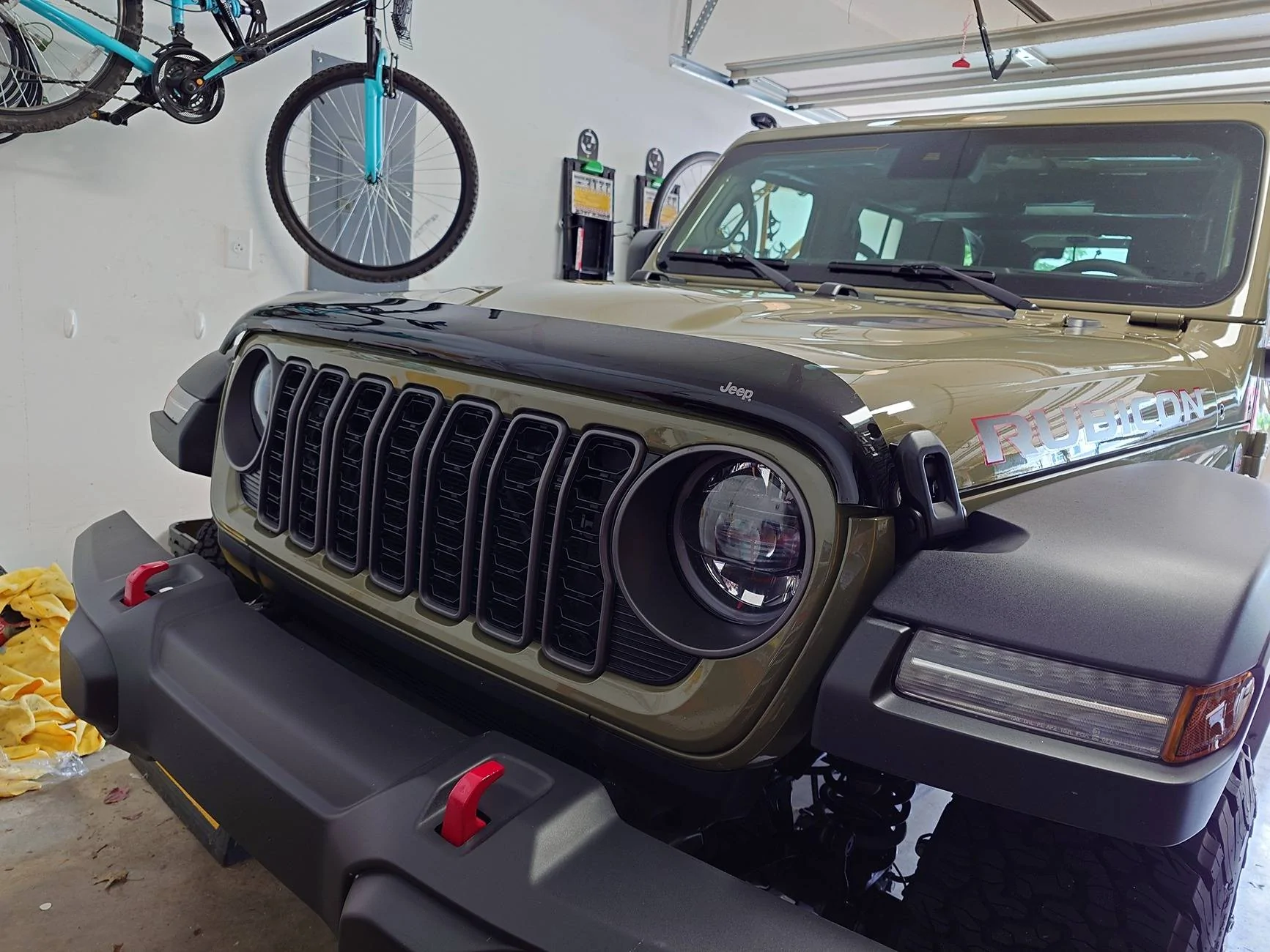

Officially in my garage!

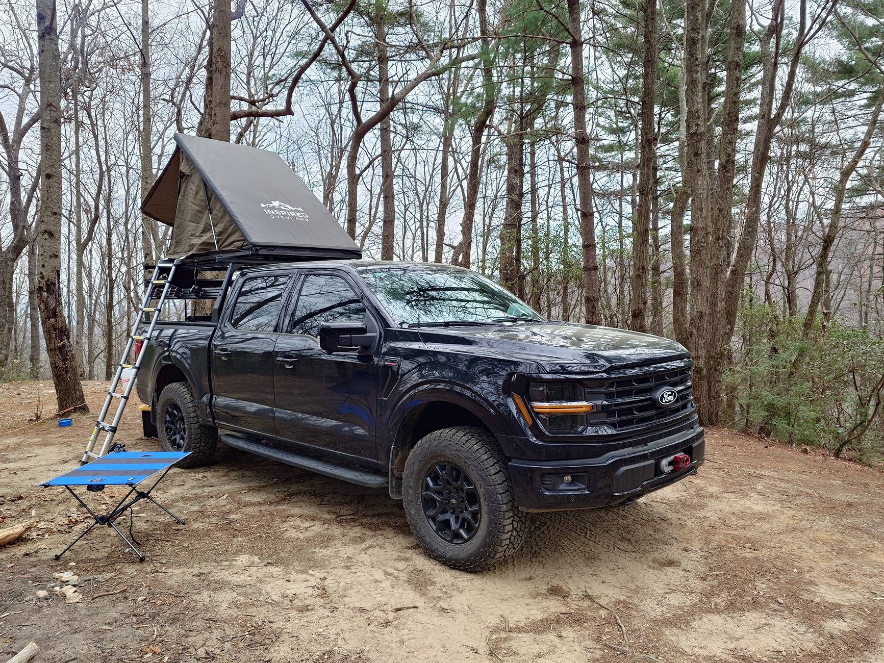

This is my overlander and tow rig. I do one big trip each year, then 3-4 day trips once a month or so.
It is pretty heavily modified. Eibach Stage 2R suspension, 35" AT4W, custom winch plate with a Warn EVO-10s, bed rack with RTT, Rotopax mounts and a 270* awning. Volant intake with the offroad focused Donaldson Powercore air filter, Raptor transfer case, Raptor front LSD, Tremor CVs, Raptor steps, fridge, etc, etc. I really want to supercharge it, but am waiting on the ECU unlock to come out hopefully later this year.
My old Gladiator that I sold, because it just wasn't very comfortable on long overlanding trips.

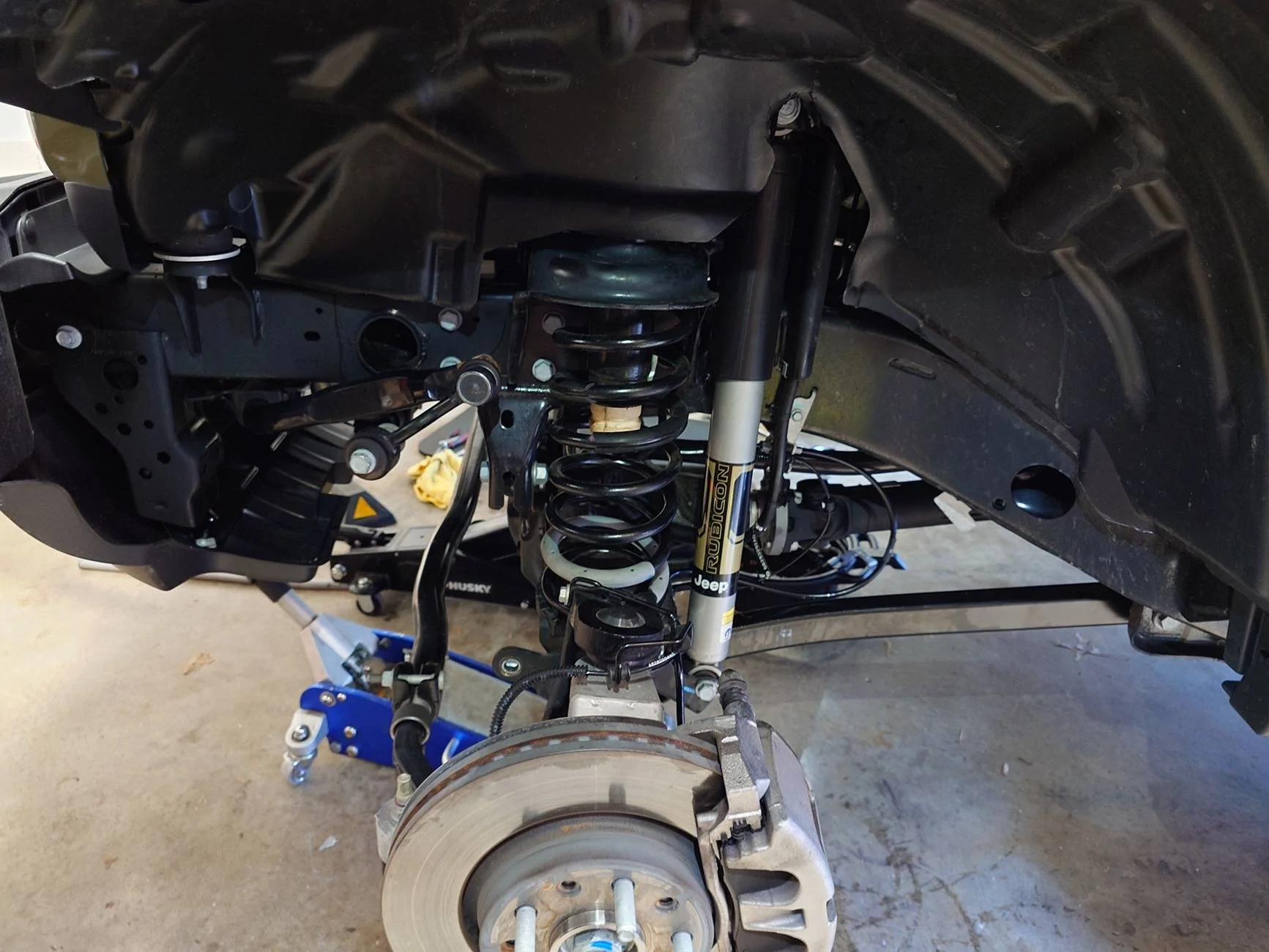

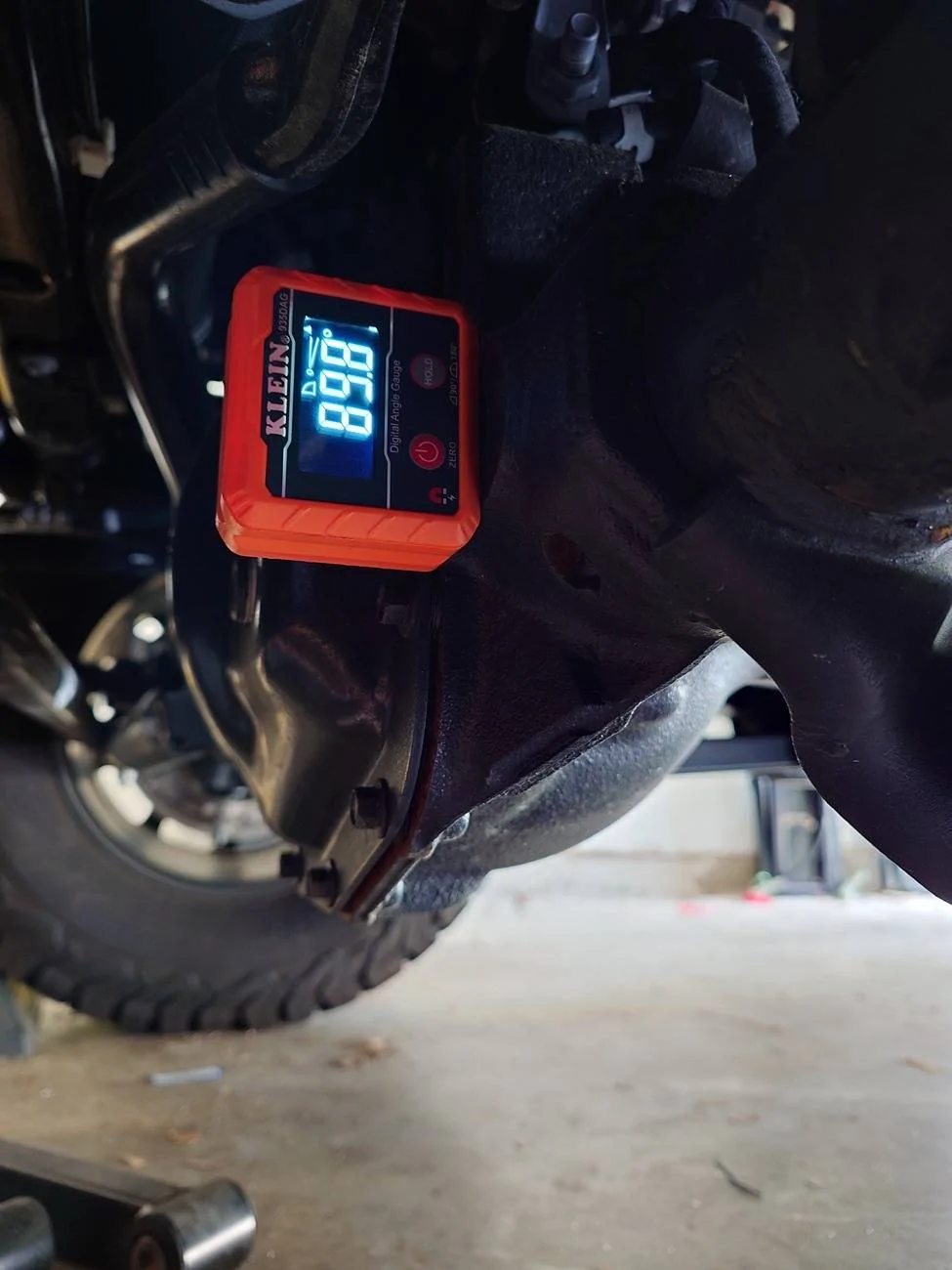

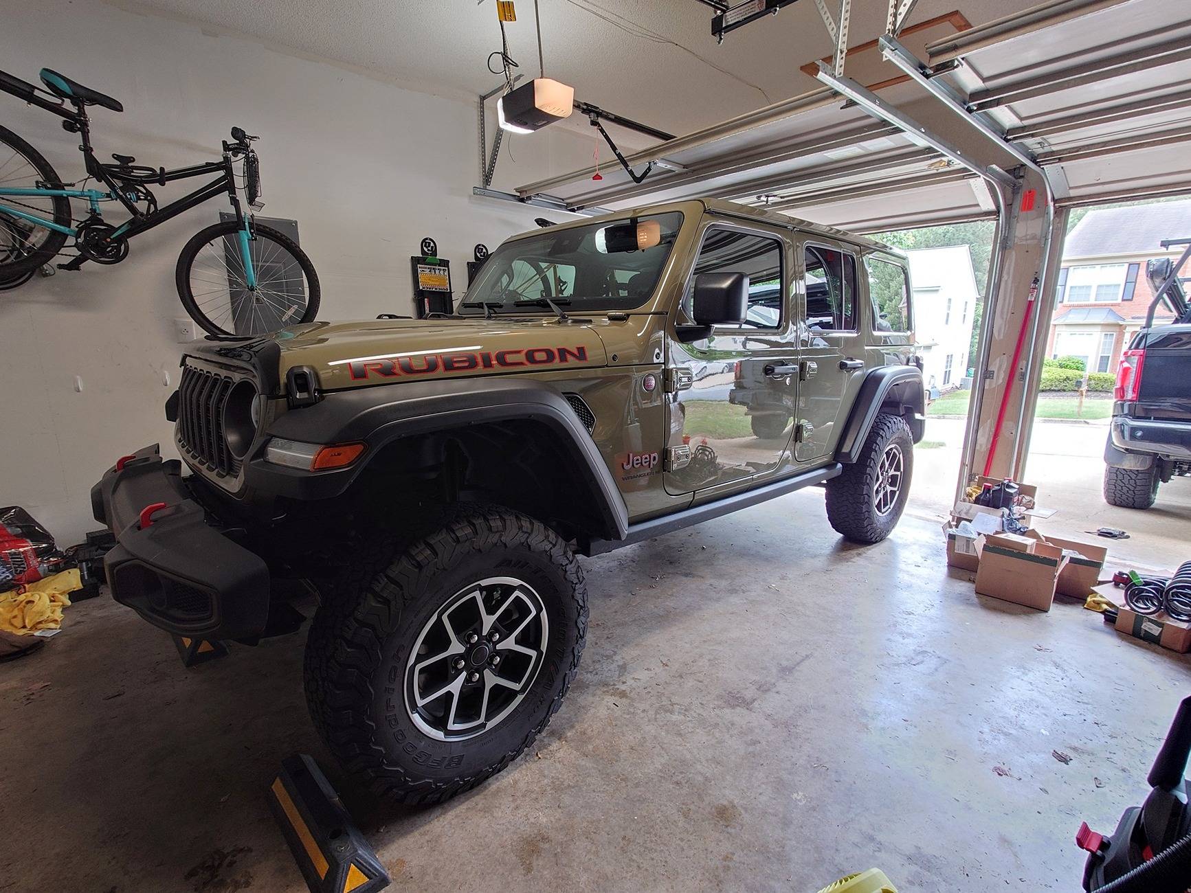

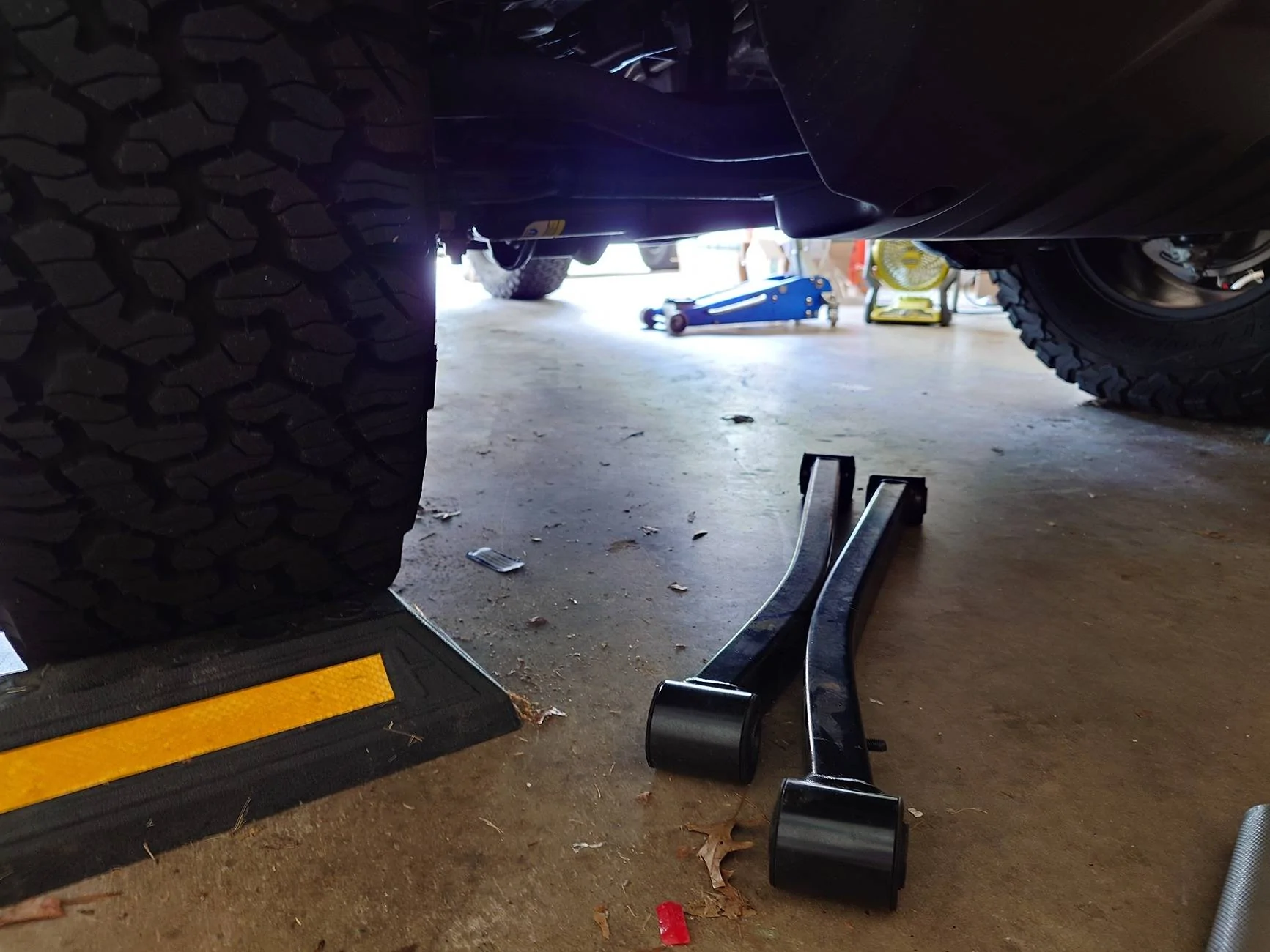

Late one night I decided to yolo and buy 392 XR FE take off shocks and springs, to do a OEM+ suspension setup. A long side those, I purchased the Mopar lift front lower control arms to add caster and the Mopar lift sway bar end links.

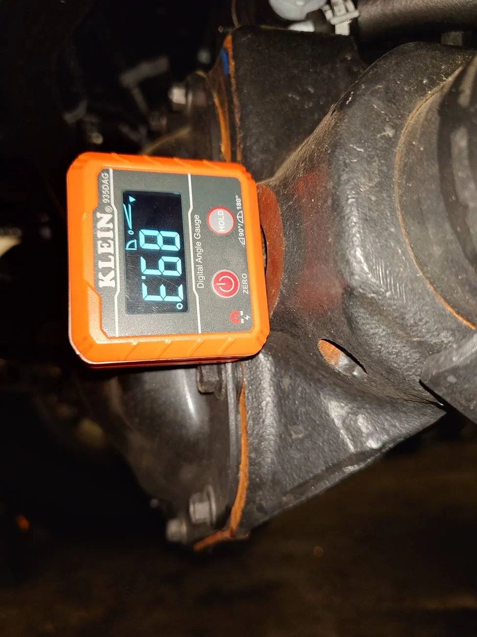

I decided to install the Mopar front LCAs first, and then check my caster. That puts me at a rough 5.8* before the lift. Seems about right based on others experience.

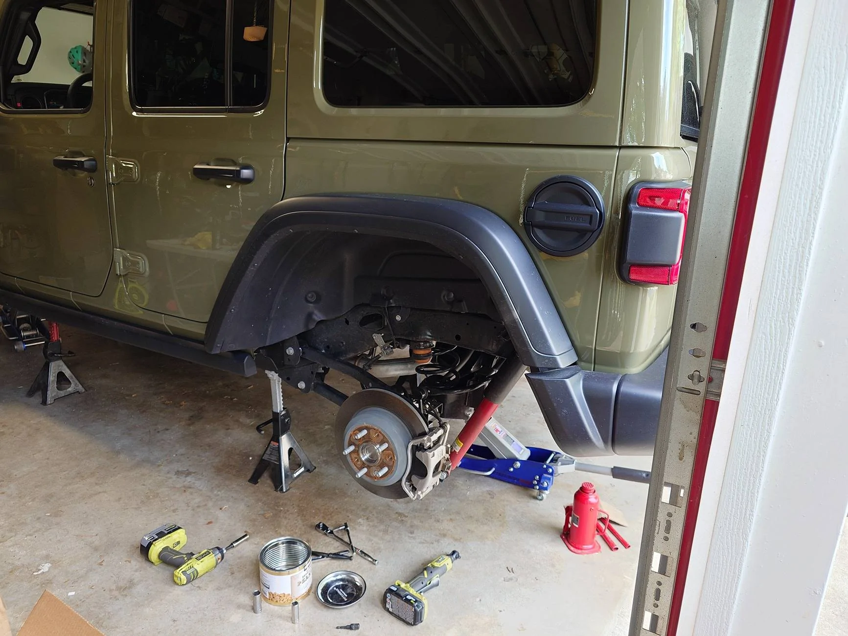

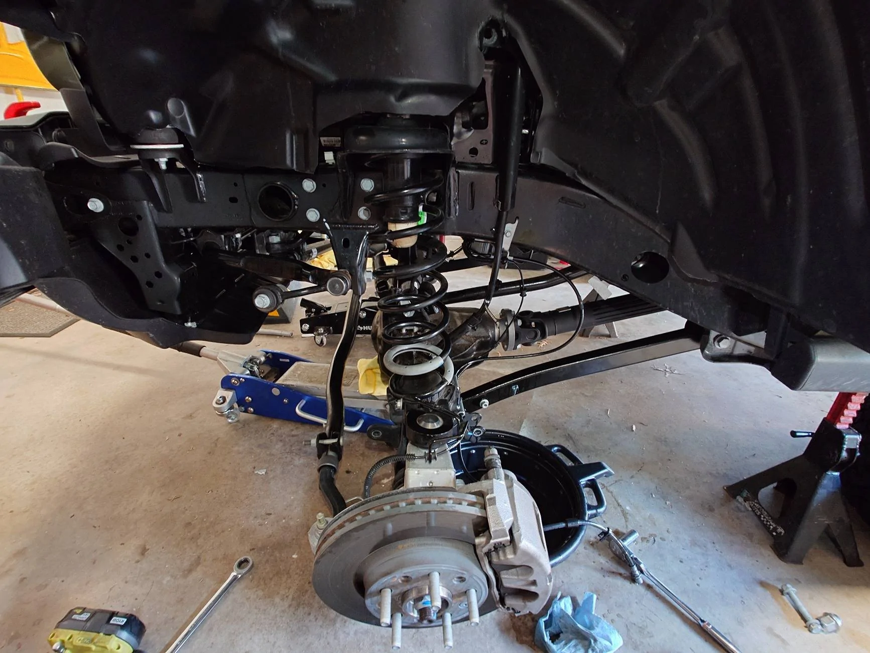

I didn't take many photos while installing the lift, because I was going fast. It took me 3 hours to do the springs, shocks, and brake lines! Cooking! Wranglers are so easy to put suspension on.
One tip, instead of trying to droop the hell out of the axle and loosen control arms, I simply used my super awesome spring compressor to slightly compress the springs, and the slid right in, making sure to align the coil ends and rubber isolators.

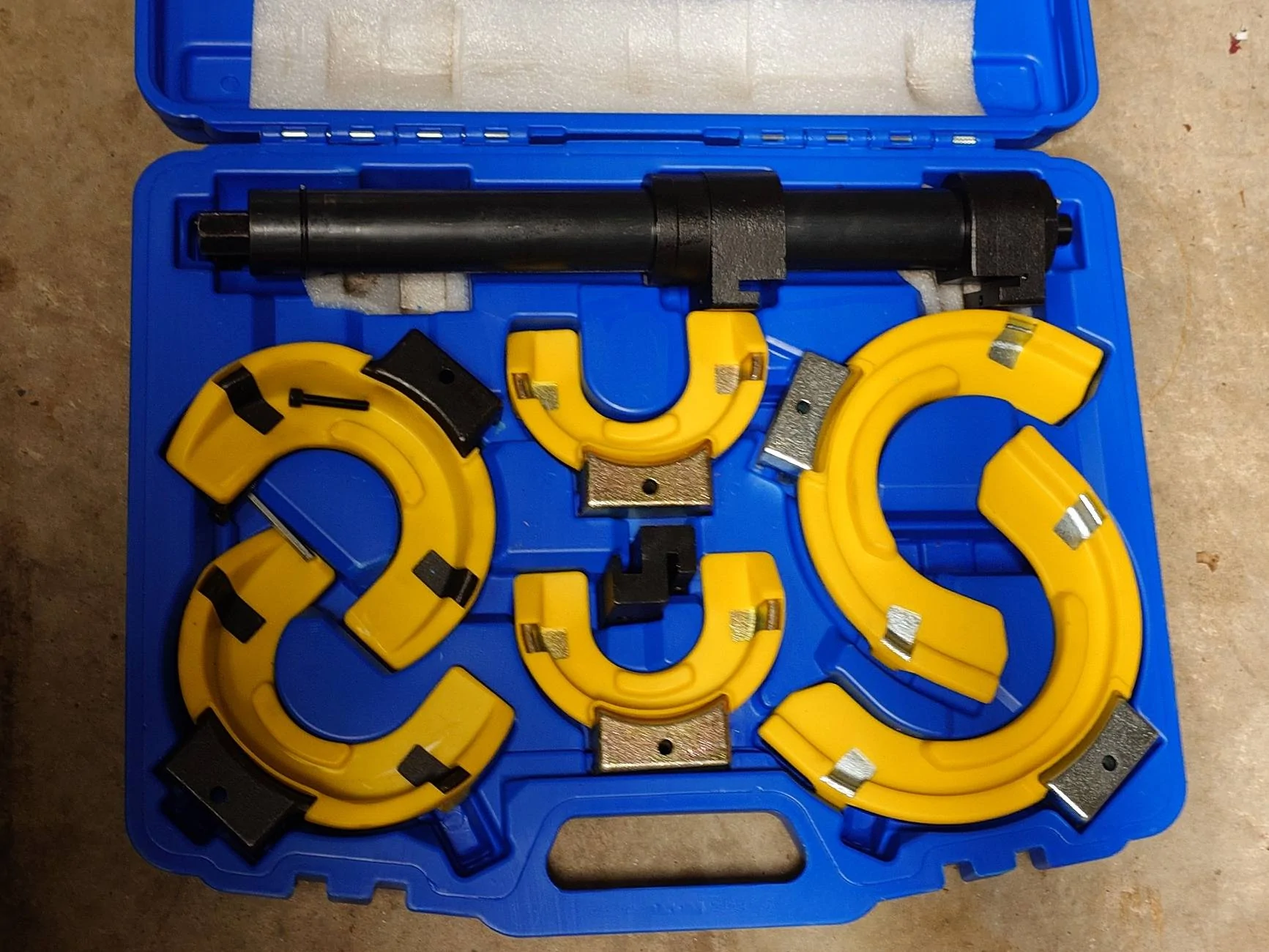

This kit from Vevor is really easy to use. Seriously took me seconds to compress the spring with a 22mm socket on an impact.
Looks like I lost half a degree of caster with the lift kit. It tracks well though. Crazy enough the XRs have the same LCAs as every other Wrangler.

Post lift!
Looks like I gained 2.5" in the front. It is perfectly level with a full tank of gas.
Jeep Wrangler JL Aonarch's 2025 JLUR '41 Build Post Lift (1)
That was more lift than I thought I'd get. SInce my curb weight is so high, I was thinking I'd get 1.5" of lift.

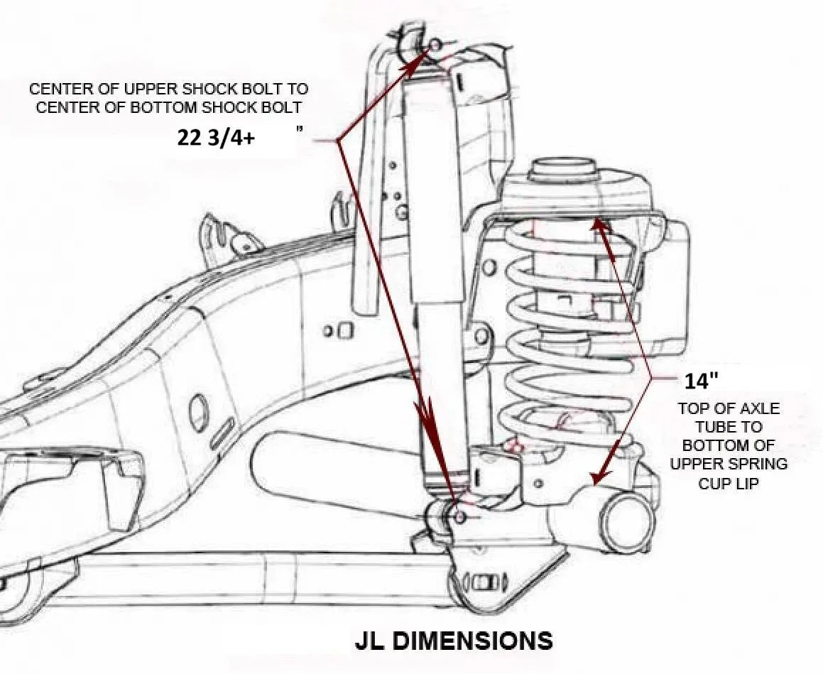

So now I had a conundrum. Are my shocks now too short? Shoot I probably need a rear track bar bracket...
After driving it a couple of days, I decided on keeping the springs. I'm happy with them.
I did order Teraflex front track bar, rear track bar bracket, and rear track bar.
I also ordered Bilstein 5160s for 2-3" of lift. Based on their sizing guide, these should be spot on for my level of lift.
I do have some 1" longer Metal Cloak durobumps, but I haven't installed them yet. I'll probably keep those on my shelf, until I decide to go 37s.

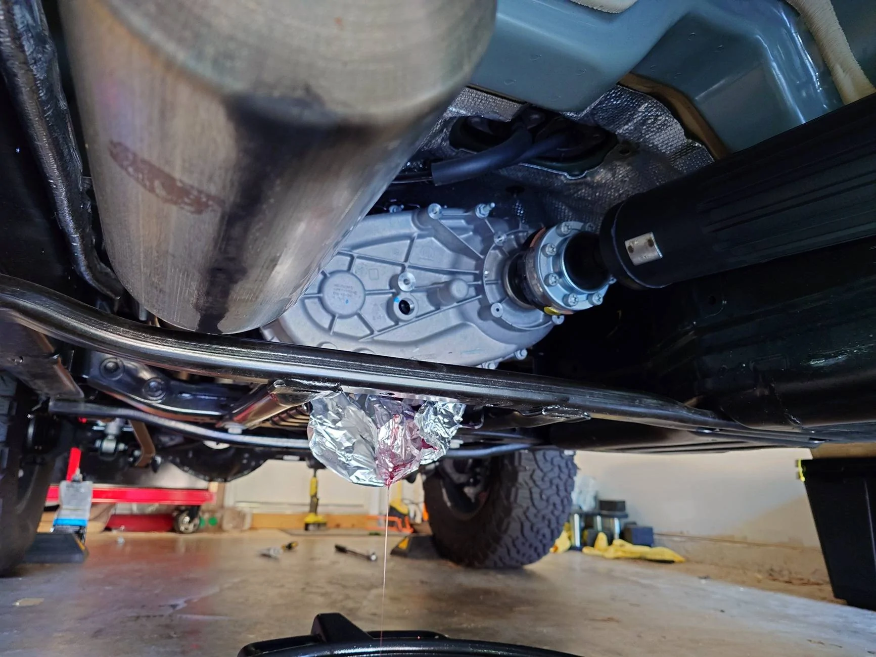

My transfer case was being a major pain in the ass to shift, I figured it's either not broken in at all (Probably never put in 4WD), or maybe low on fluid.
I did a quick fluid change with Amsoil ATF.
Instead of removing the skid plate, some tin foil works amazing as a drain funnel. I used liquid thread sealant on the plugs and torqued them to 21 ft lbs.
