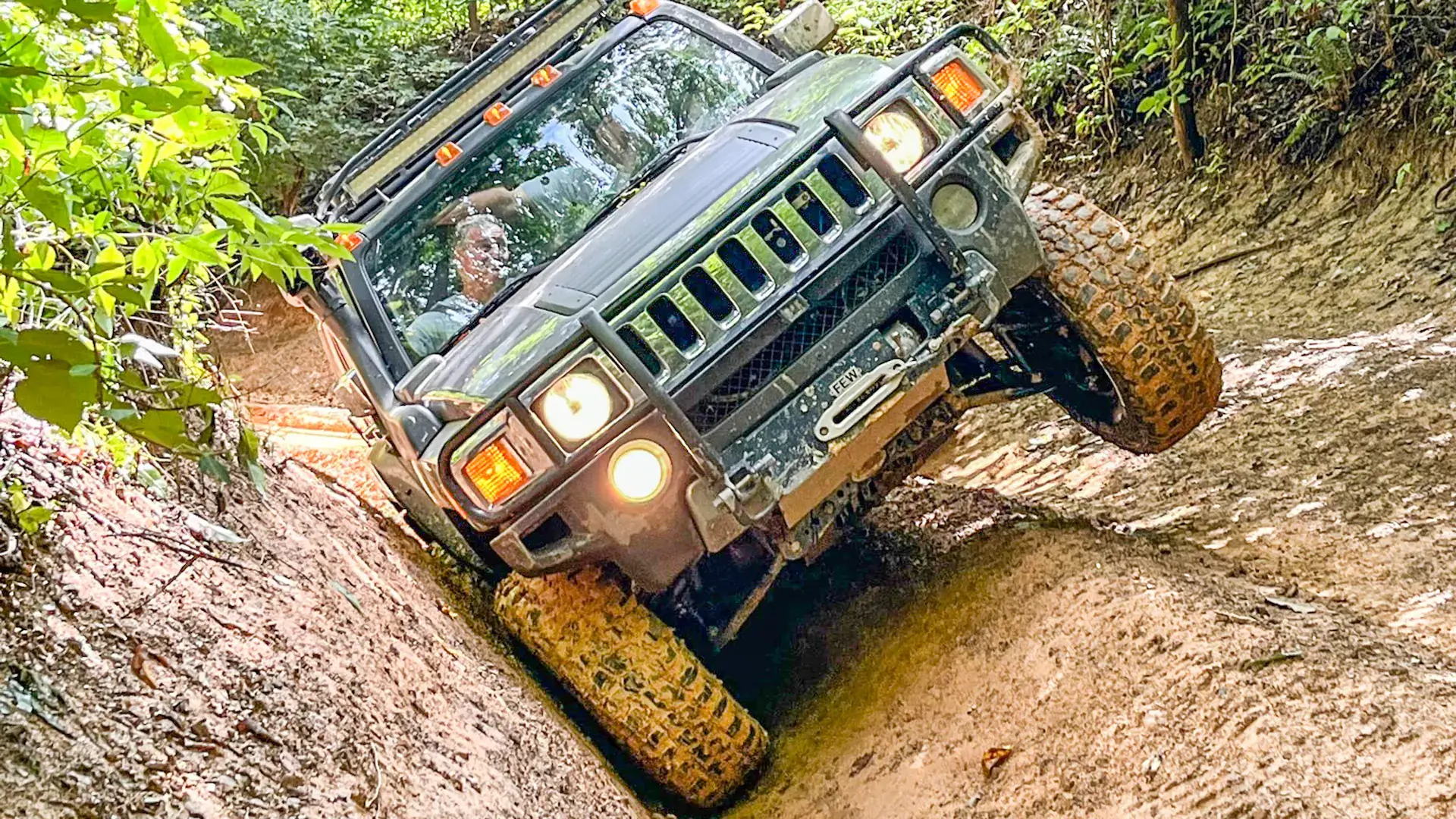

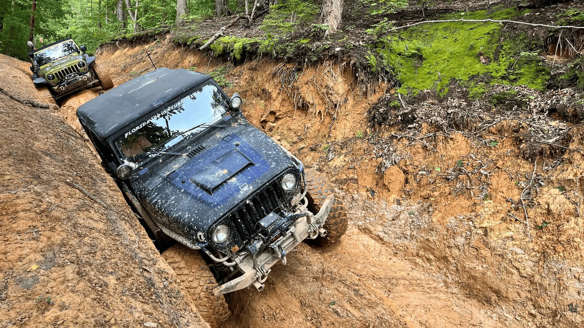

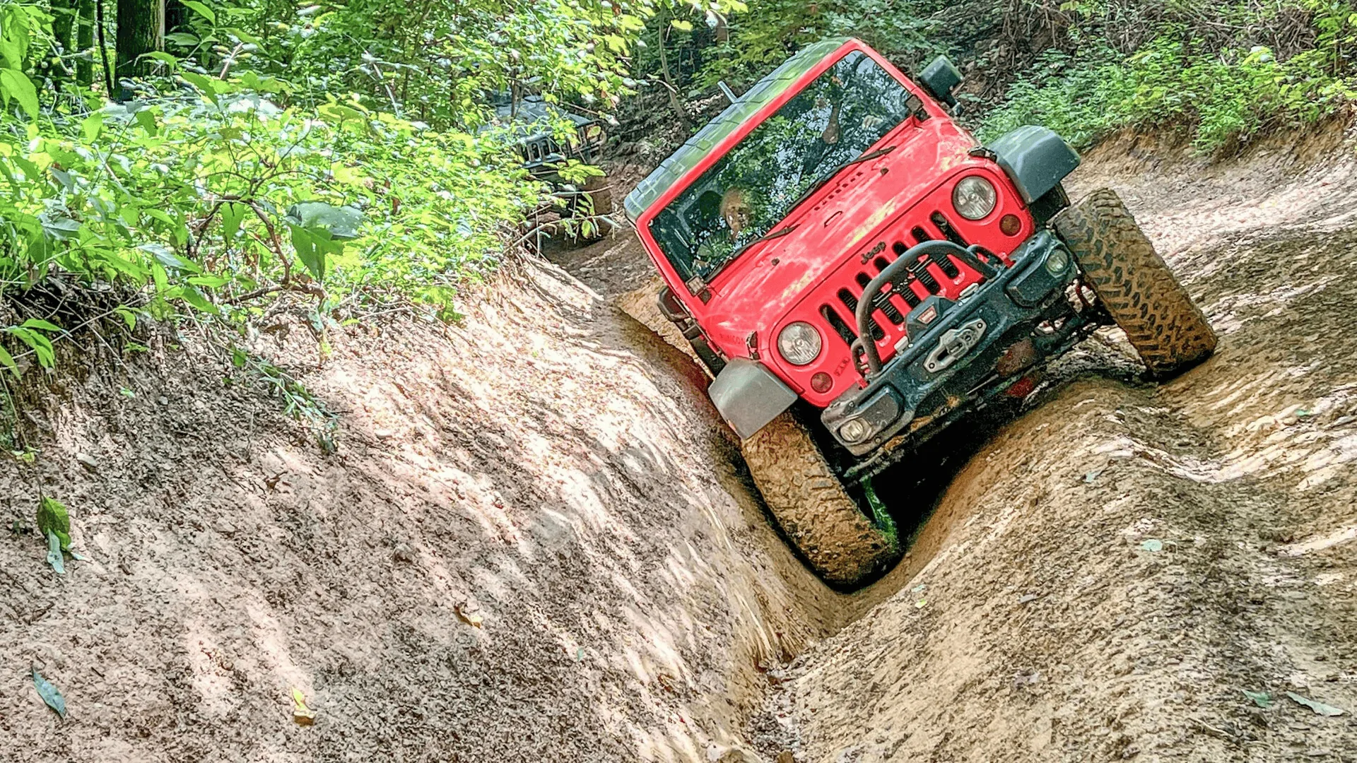

lol, but for real, when off road having the tire extend past the flare can be beneficial - if you're crammed up against a wall in the mud, such as the below, it can help keep fender/body out of the wall:

Yes... poke is a requirement in my opinion. It's your only saving grace for situations like ^.
