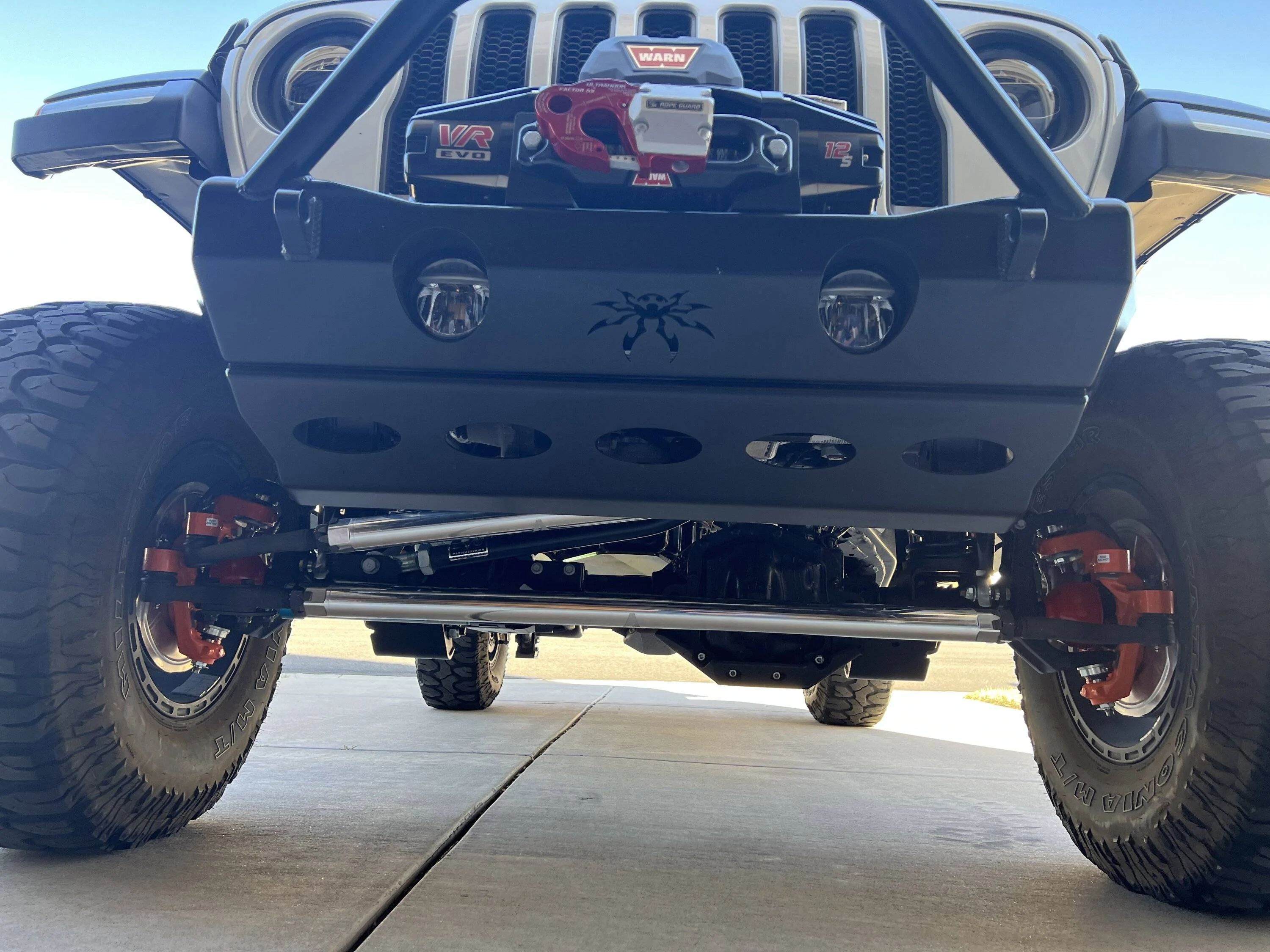

On my rig, I have 4-1/2” lift. In order to keep from rubbing everything I had to go with a 3.5“ backspace on my wheels. I still get a little rub on full flex. People running anything less then 3.5” backspacing on 37’s would just rip out the fender liners while flexing and rubbing front steering and suspension parts. The poke also helps tire placement when crawling also.
