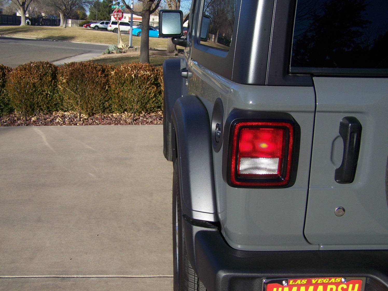

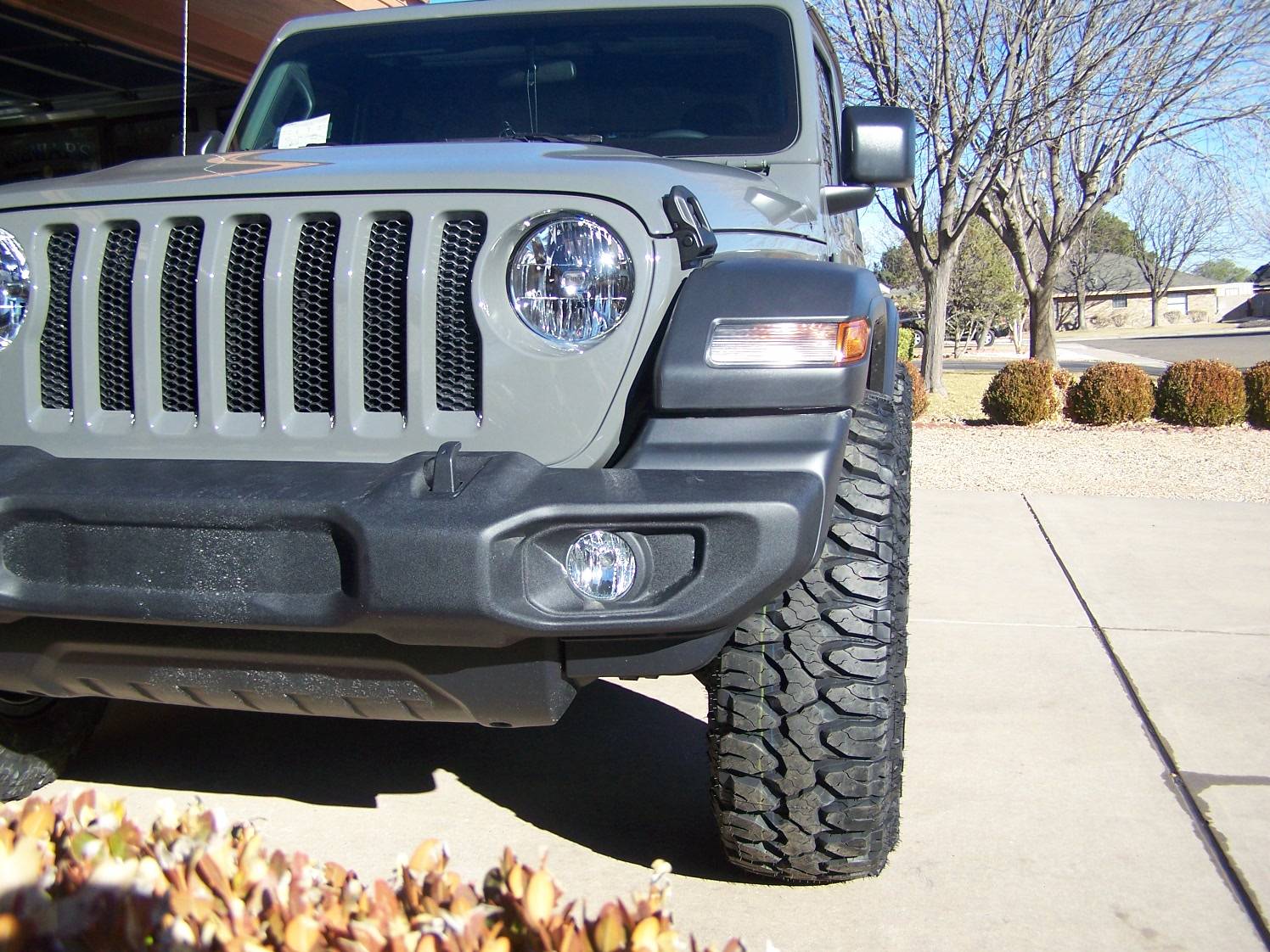

Skip, here's my fit at the fender stock, then w/ 17x8.5 +10 on 295/70, so your Toyos would be 5mm in from mine at the same +10 offset. If you were to run that +30 you'd be about an inch inside from mine (20mm for the offset and 5mm for the narrower tire). I think you'd like that fender fit w/ the +30 but if you think you might be lifting it up a bit in the future you might want to go a bit less positive. With my +10 set I can run my Rubicon lift w/ 35s (since I also have a high fender kit). Just food for thought :)
Jeep Wrangler JL Calculating tire poke 100_4025
Thank the photos are a big help.
