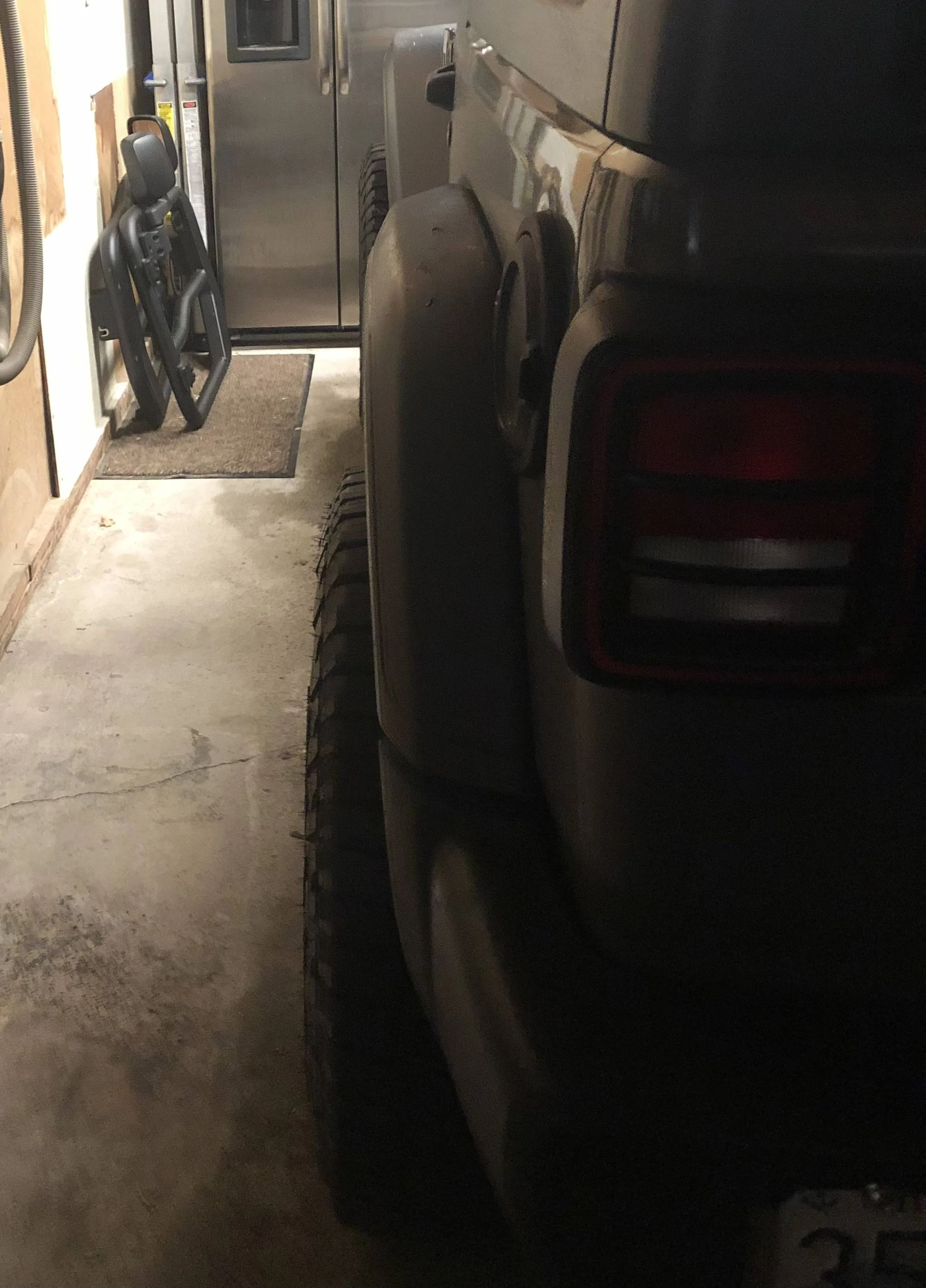

I'm looking to put 35's on my JLR. Suspension is stock. Want to use wheels with -18 mm offset. If anyone has a setup like this I would like to see some pictures. Having trouble visualizing how far the tires will poke out from the fender. Tires will be WildPeak.

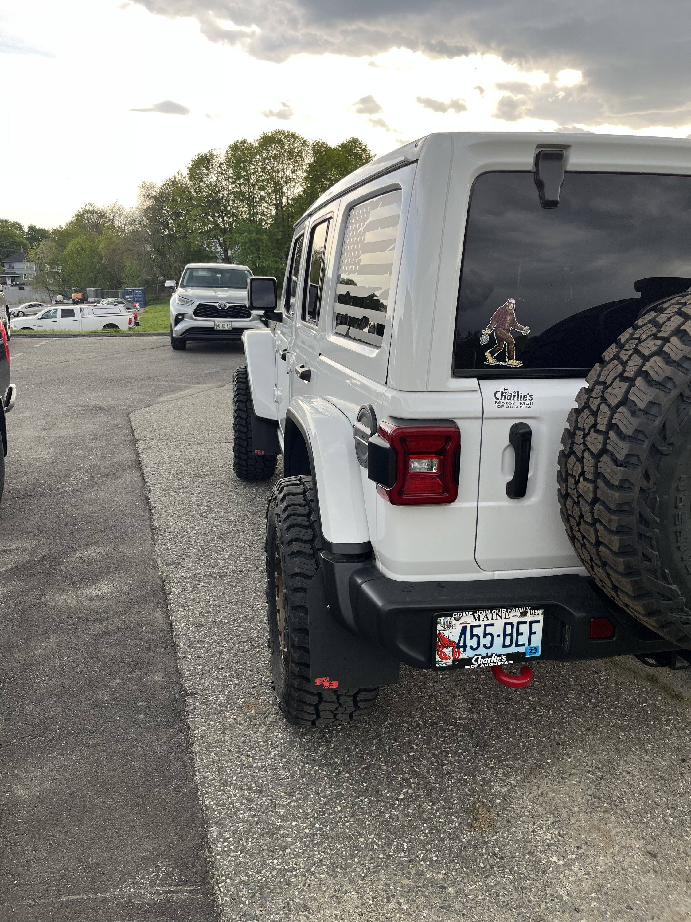

2021 Jeep Wrangler Freedom Edition 2 Door
33 inch falkens with -12 offset. So yours would be about one finger width -ish out further at -18.
Jeep Wrangler JL Tire Poke Pics IMG_0442

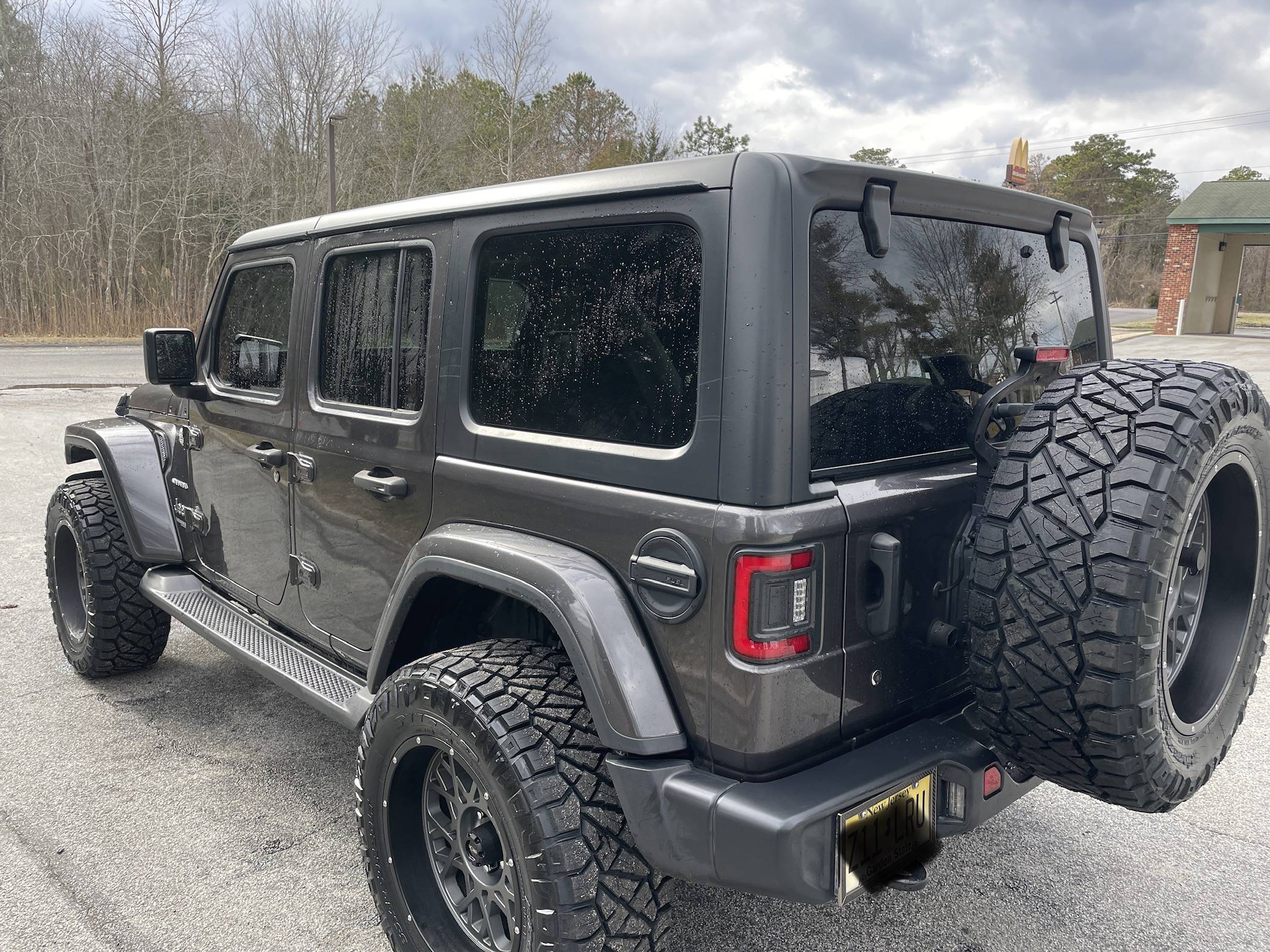

2021 JLUW Sport 2.0 L Turbo

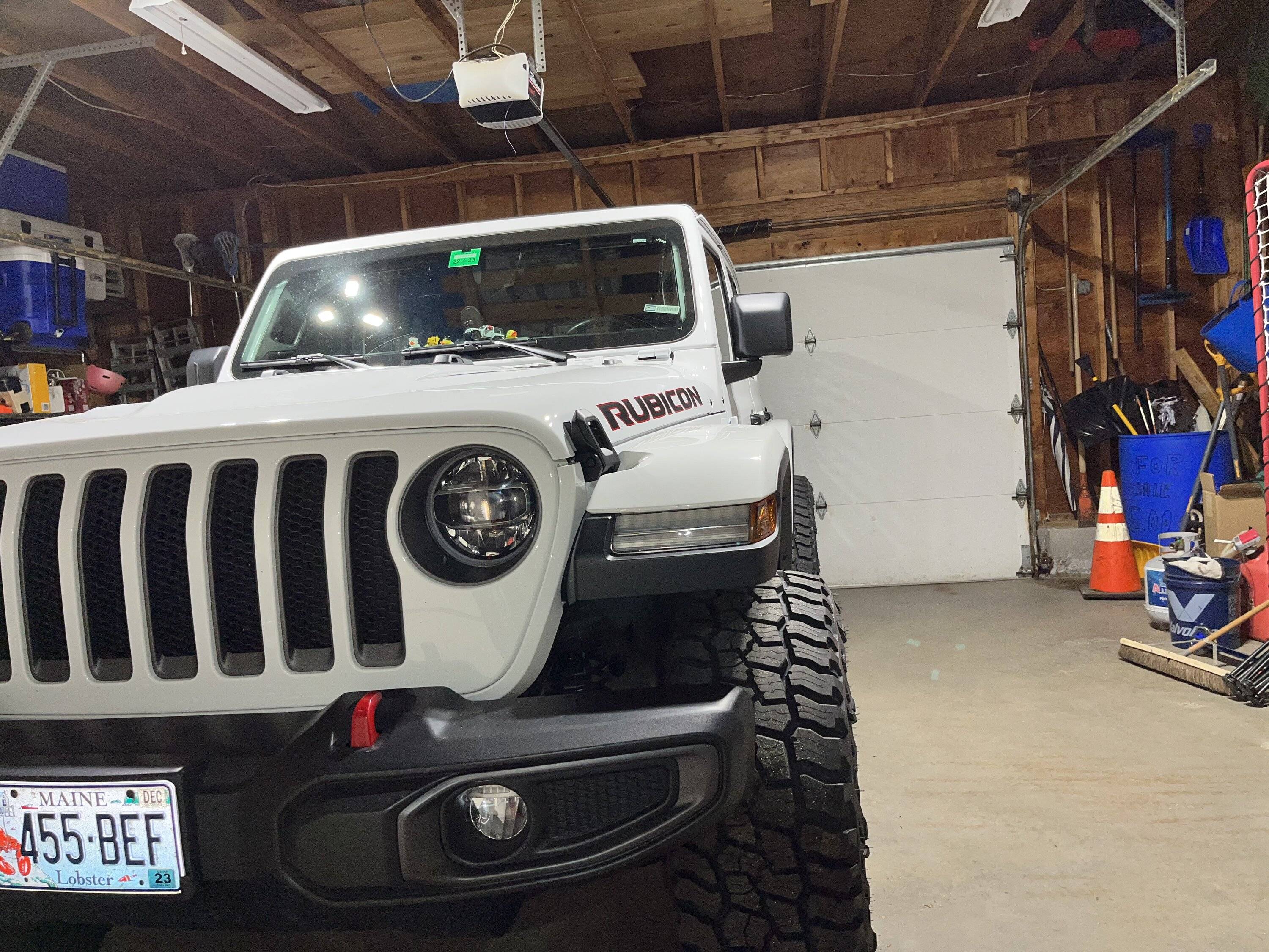

Don't have a good pic. Down the side of the jeep. But these are zero offset wheels with 285/70/17 Wildpeak tires. They extend a little over an inch past the fender. They did seem to reach full flex though without rubbing.
I didn't necessarily want the tires to extend past the fenders, but couldn't pass up the deal on the wheels. Plan is to get the XR fender extension and I think it will look good.
Should add that the jeep does have a 2" spacer lift.
Jeep Wrangler JL Tire Poke Pics image

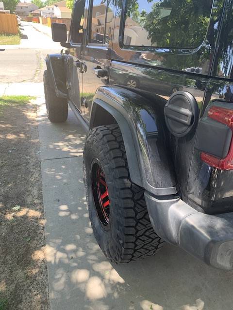

2021 Jeep Wrangler WILLYS
U.S. Military Vet, Former Corrections Officer, Current Maserati Claims Specialist

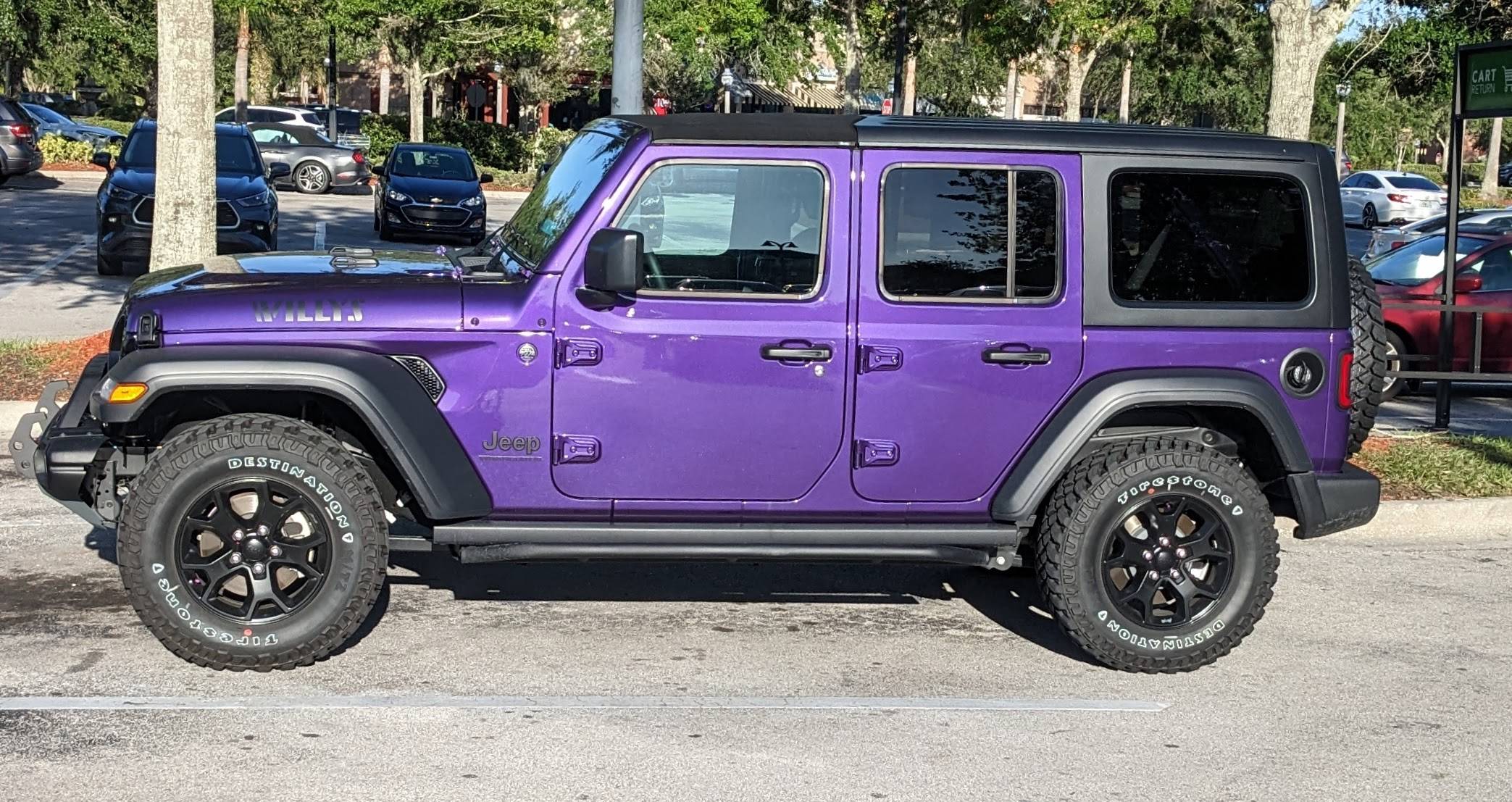

Not the best pics but this is on a 3 inch lift.. 17x9 wheels with -12 offset.. 35x12.5 inch tires
Jeep Wrangler JL Tire Poke Pics 20230120_211620
Jeep Wrangler JL Tire Poke Pics 20220815_093325

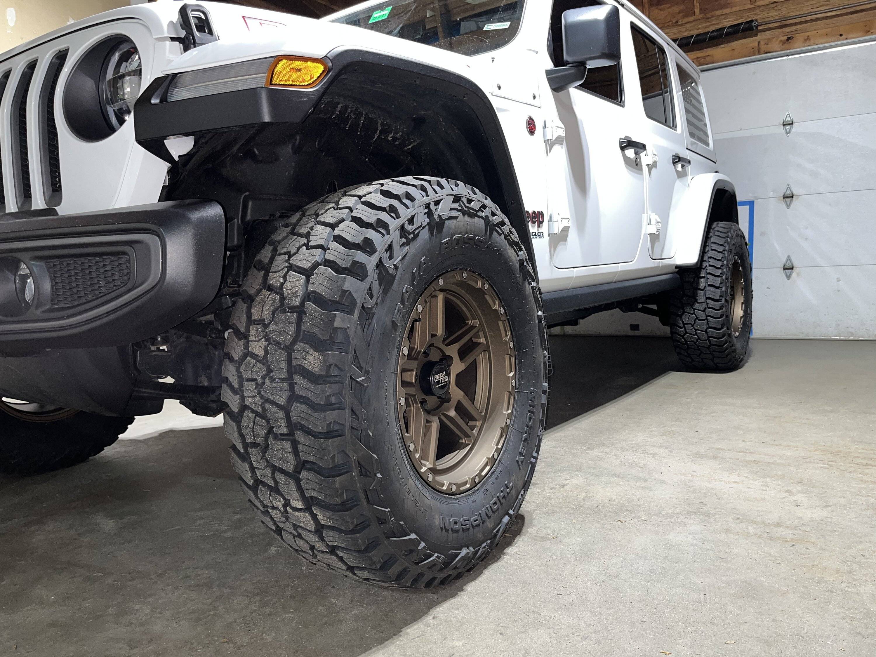

2019 Wrangler JLU Sahara/2018 Durango R/T
Locomotive Engineer

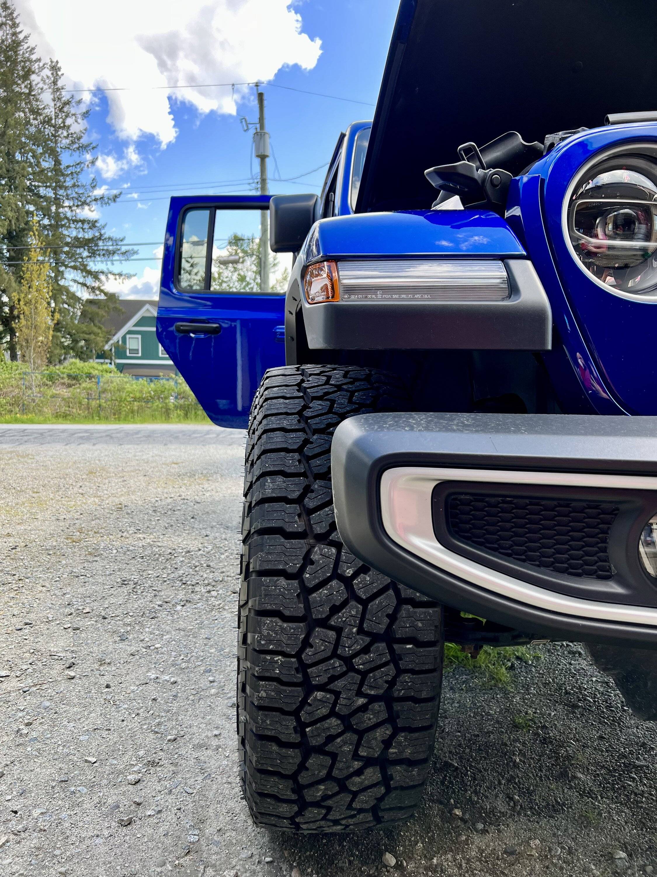

-12 offset fuel rims on 33's. I honestly wouldn't want it poking out much more than this. Already destroyed the rear fender flares lol

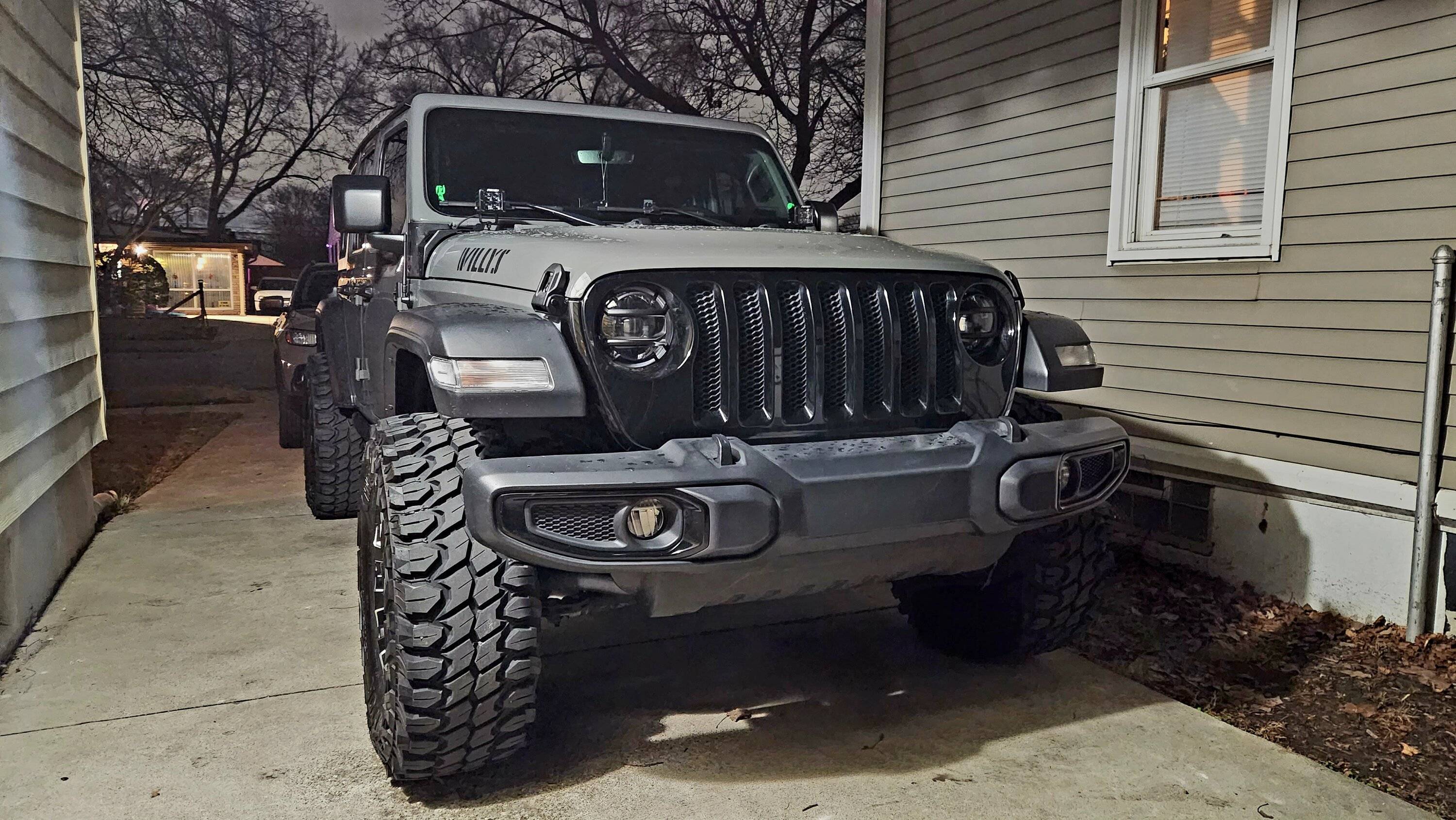

2020 JT Rubicon - Crystal Granite
Senior Full-Stack Software Developer
That bad, huh?
Are those 17x9? I'm looking at someone selling a set of all 5 KMC Rockstar wheels for only $1000, 17x9 -12 offset, and I'm on the fence. What size tires did you go with? I have stock '23 Willys currently.
