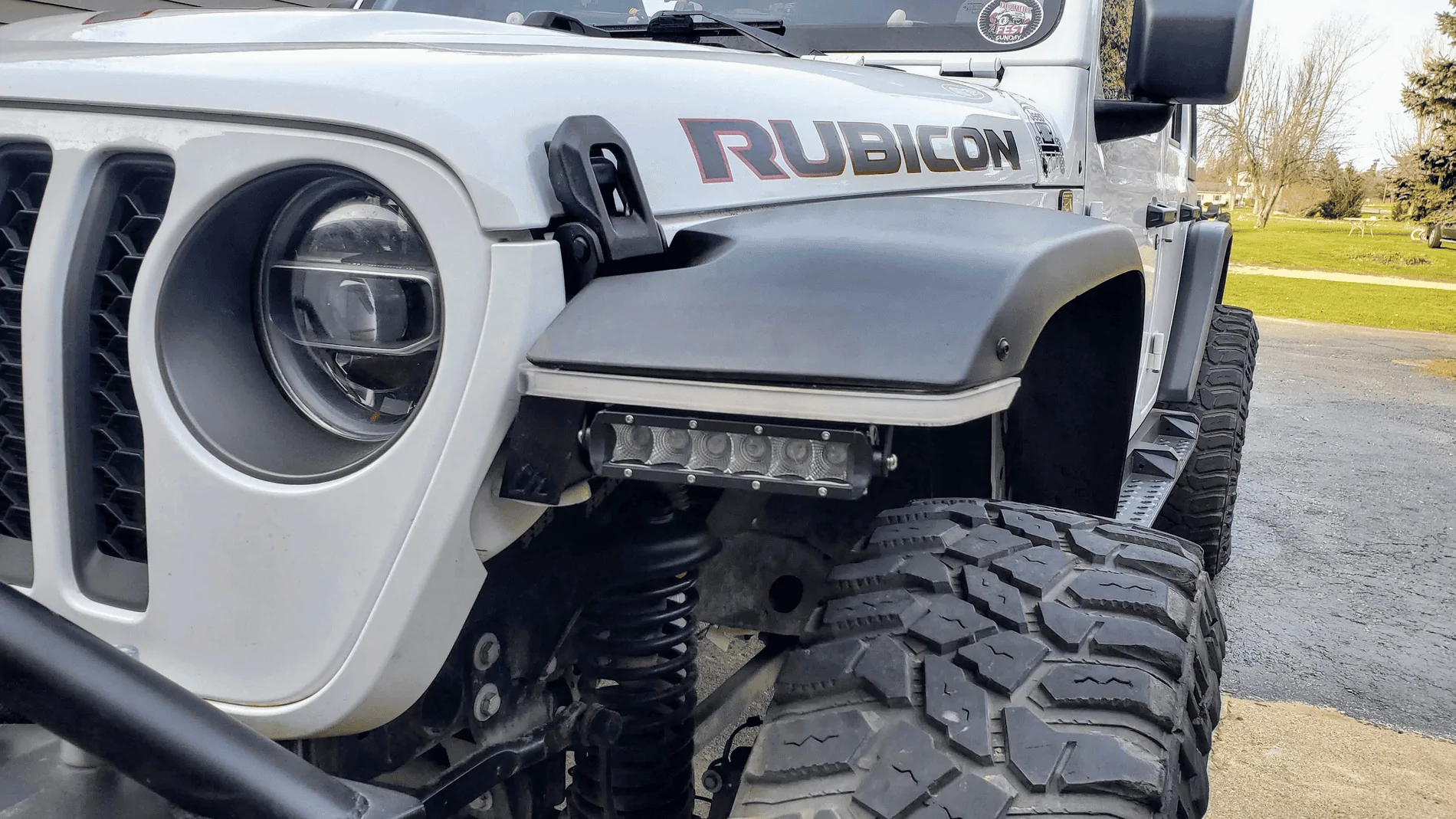

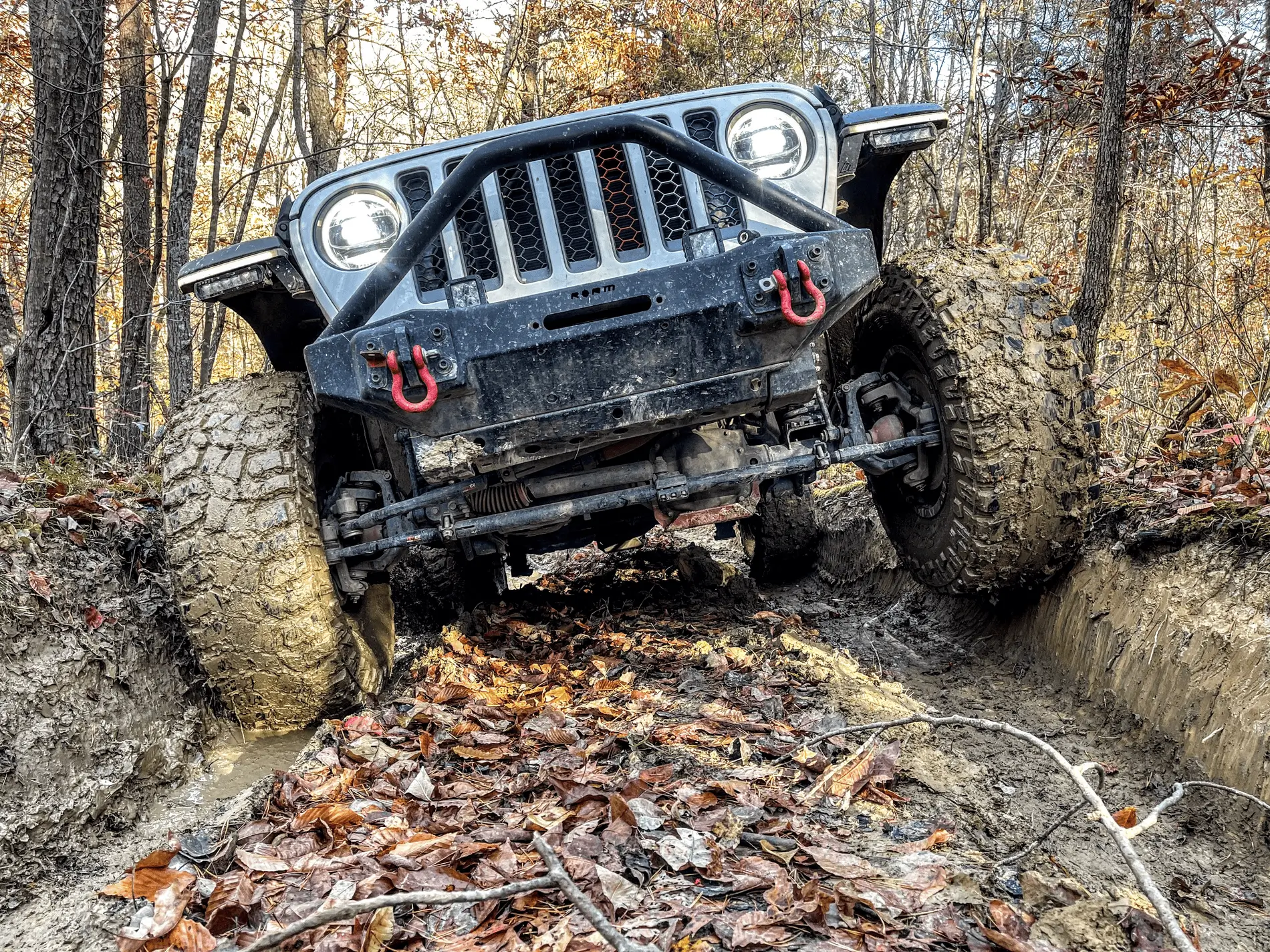

I may be wrong but more negative offset helps with flex. It gives you more arch for the tires to stuff in the fender.
All suspension setups will stuff a tire the same amount, but the length of travel to full droop is where all the gray levels come into play.
A negative offset and less droop will put the tire into the outer edge of the fenders. The same offset and a lot of droop will arch the tire further inward, and the fender liner becomes a bigger concern.
Here's the latter, which jives with what you're saying, courtesy of a lot of droop that needs the negative offset.
Jeep Wrangler JL Too much tire poke? 20200831_111107

I’ve got the 3.5 Metalcloak with fix 2.5 shocks. Think I have around 12” of travel. Your setup looks similar to mine. That’s why I thought the more negative would help me.
3.5" Gamechanger here as well. I've got the 6-packs. With the crazy amount of articulation that Metalcloak provides, we need the negative offset. Rock Krawler is the the same. A non Rubicon would need even more negative offset due to their narrower axles.

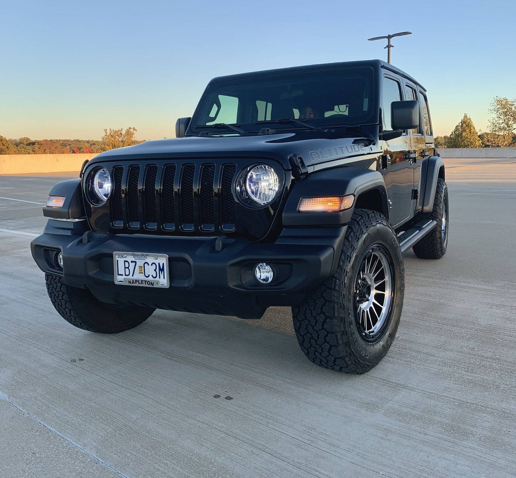

18x9 +18 offset with 275/70/18. I wanted minimal poke, since it’s a DD.
Jeep Wrangler JL Too much tire poke? 93C6F0A3-E531-429D-B7DC-8C63FAFC7E9E

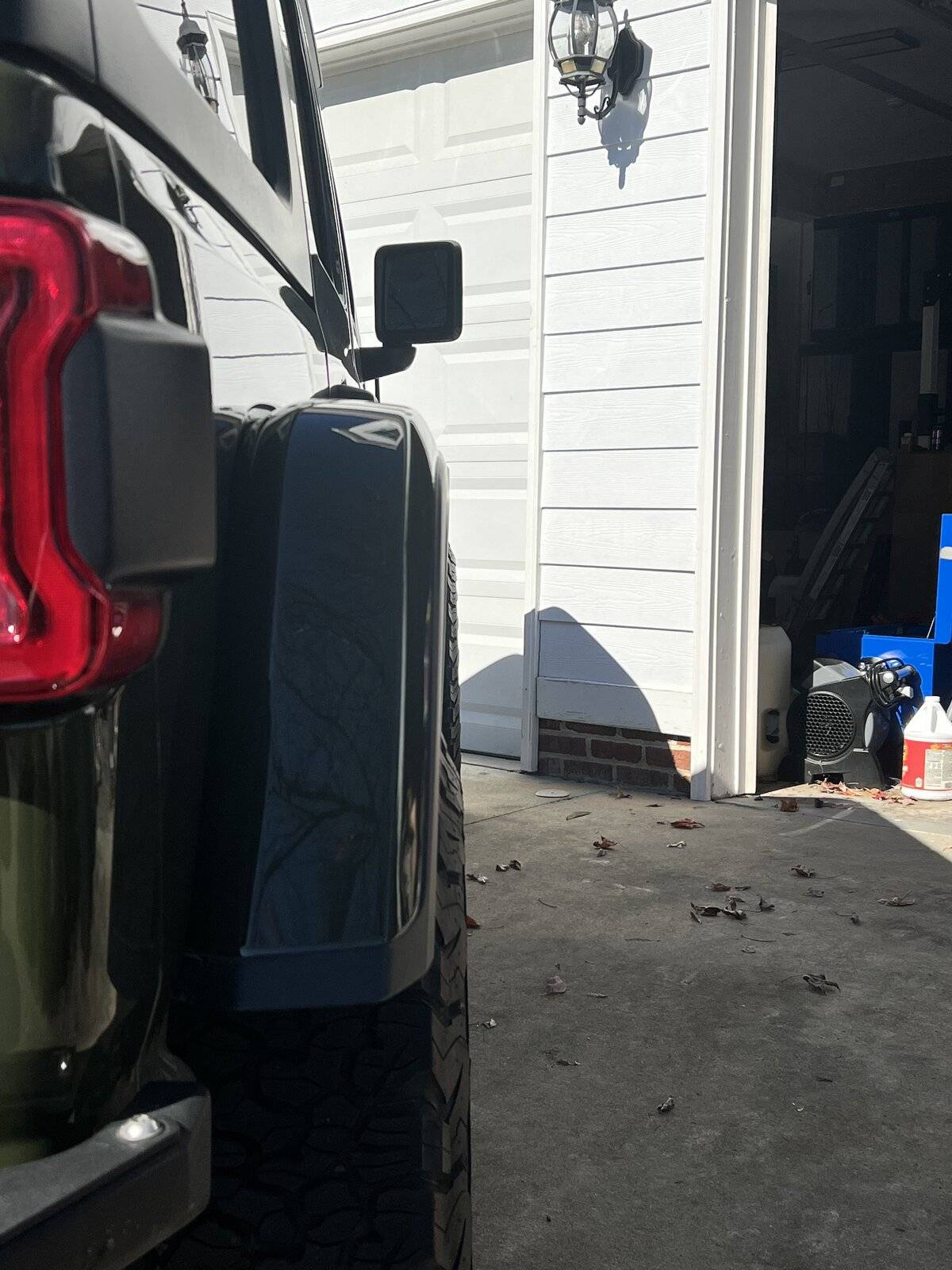

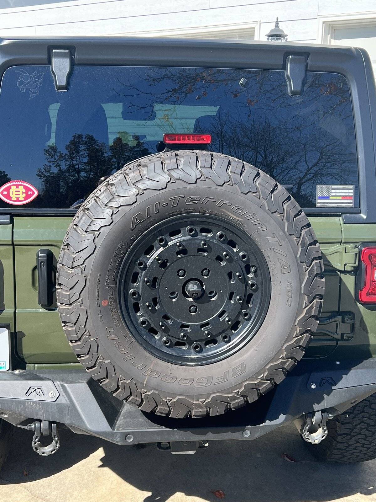

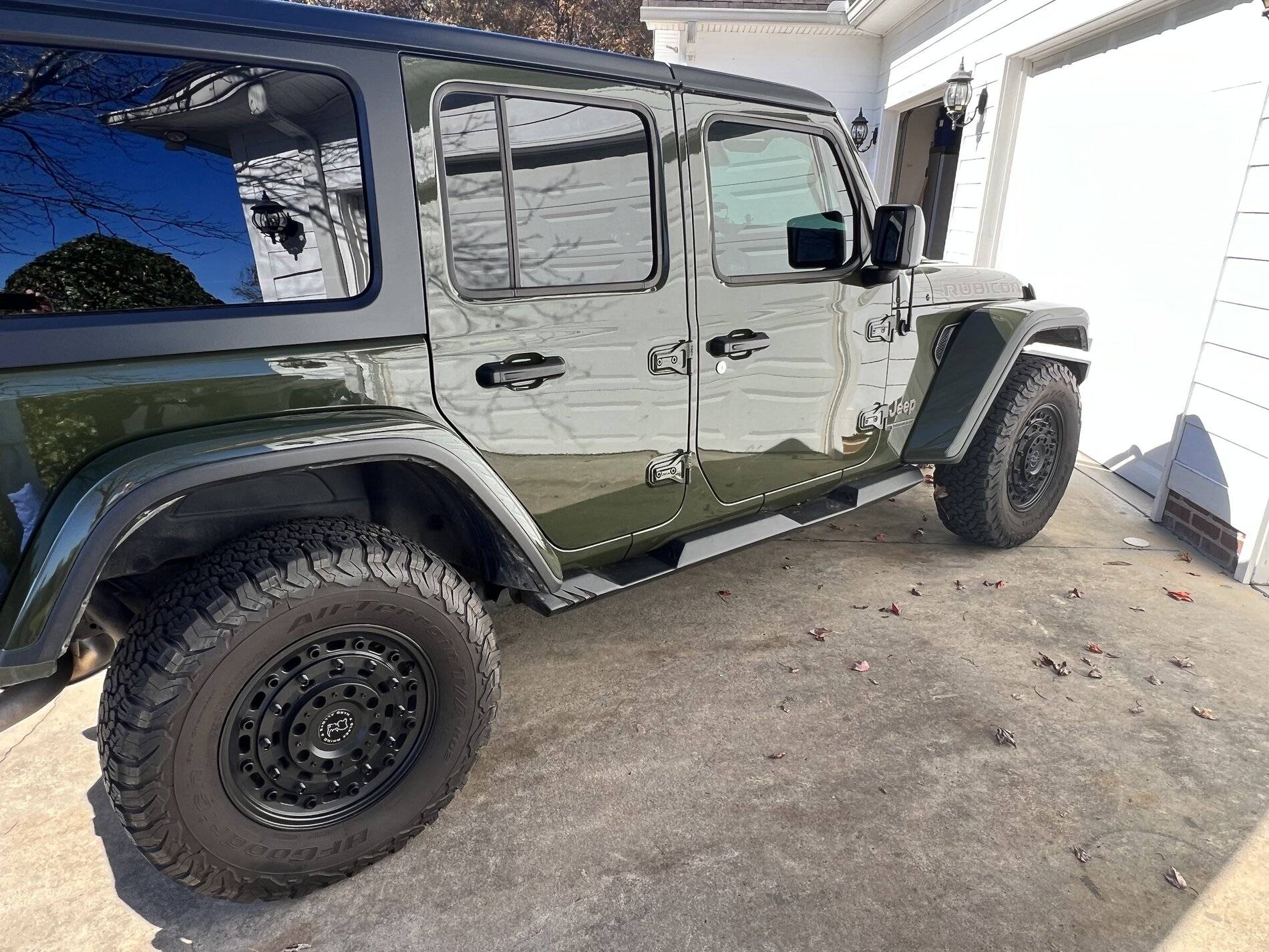

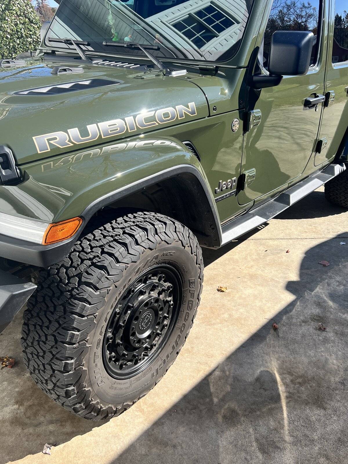

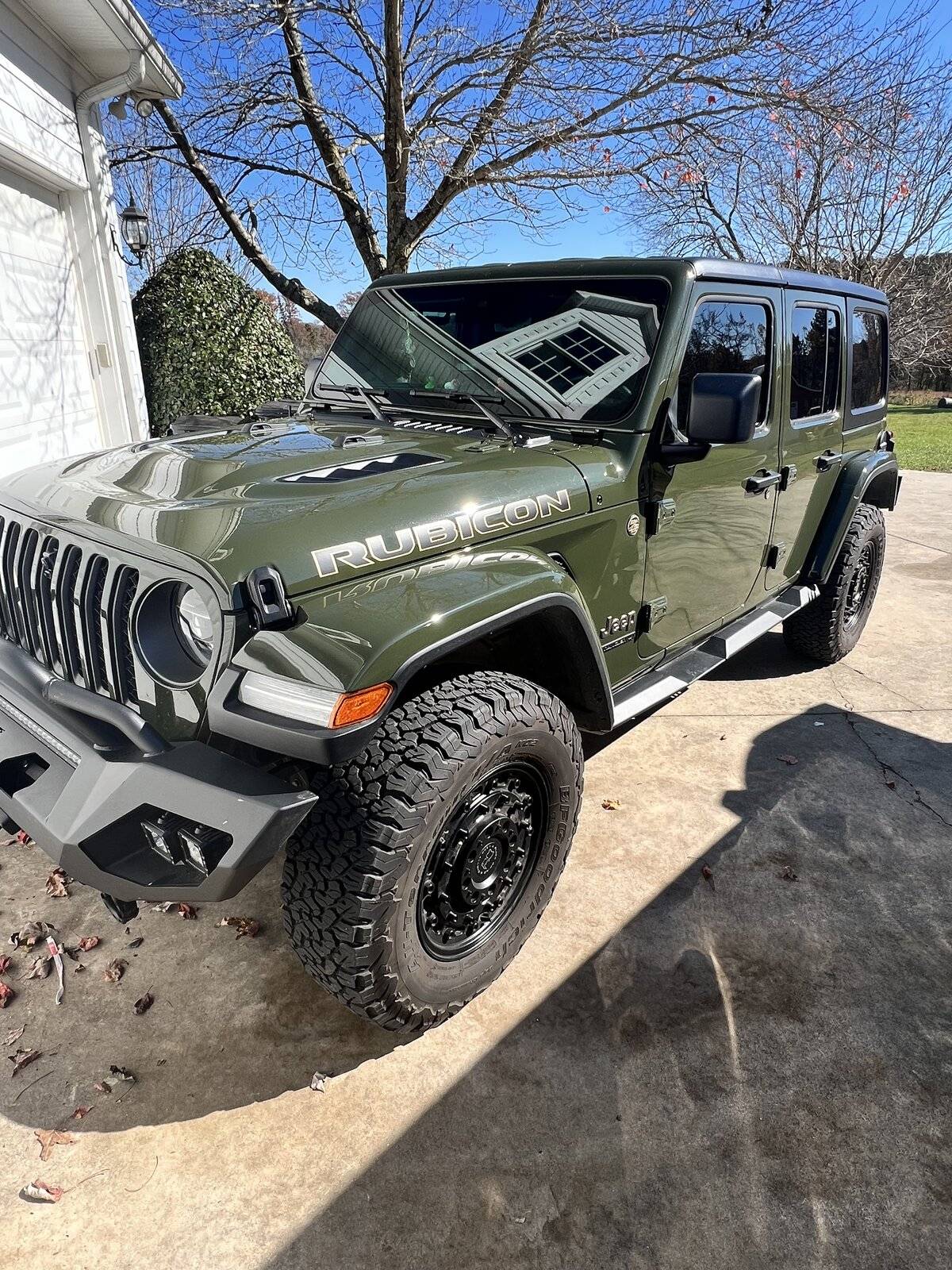

@dsiciliaa
Finally got around to taking those pictures I promised.
Jeep Wrangler JL Too much tire poke? IMG_5444
Jeep Wrangler JL Too much tire poke? IMG_5448
Jeep Wrangler JL Too much tire poke? IMG_5447
Jeep Wrangler JL Too much tire poke? IMG_5442
Jeep Wrangler JL Too much tire poke? IMG_5446
If you happen to like and decide on these exact wheels (17x8 with +30mm offset), shoot me a PM before you order. Due to my dumbassery, I happen to have a set of 5 untouched in the boxes that I could make you a deal on.

Thank you for this!! Really tough to find good images of this wheel with +30 offset hahaa. My biggest concern is whether or not there will be any rubbing with 35s no lift. I have a Sahara so less wiggle room under those fenders lol. I just like the tucked look and I've heard a lot of people say that -18 pushes that tire out quite a bit.

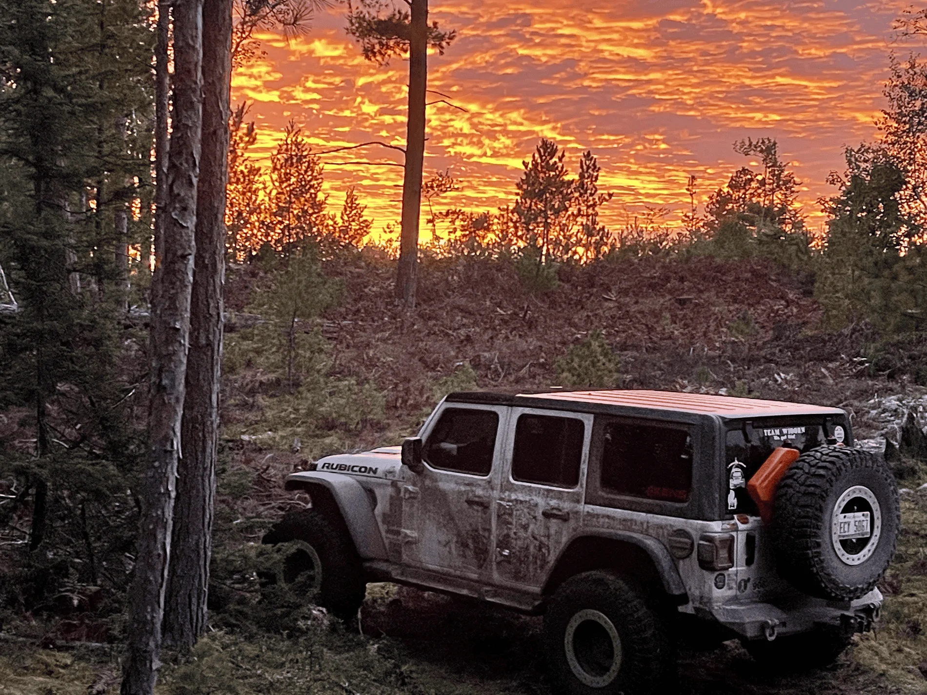

I have a -3.5 inches of backspacing. That is equal to .889 mm. My tires poke out. It looks cool, but if the pavement is even a little bit damp, my Jeep get dirty.
Jeep Wrangler JL Too much tire poke? 1637575705672
And it does not always fit in the rutts made by other Jeeps.
Jeep Wrangler JL Too much tire poke? 1637575773936
So if you like the poke, just be committed to washing it. It will look like this every time it rains and every time you take it wheeling. The cycle of washing is never ending. And this is why I have a subscription to the local drive through wash.
