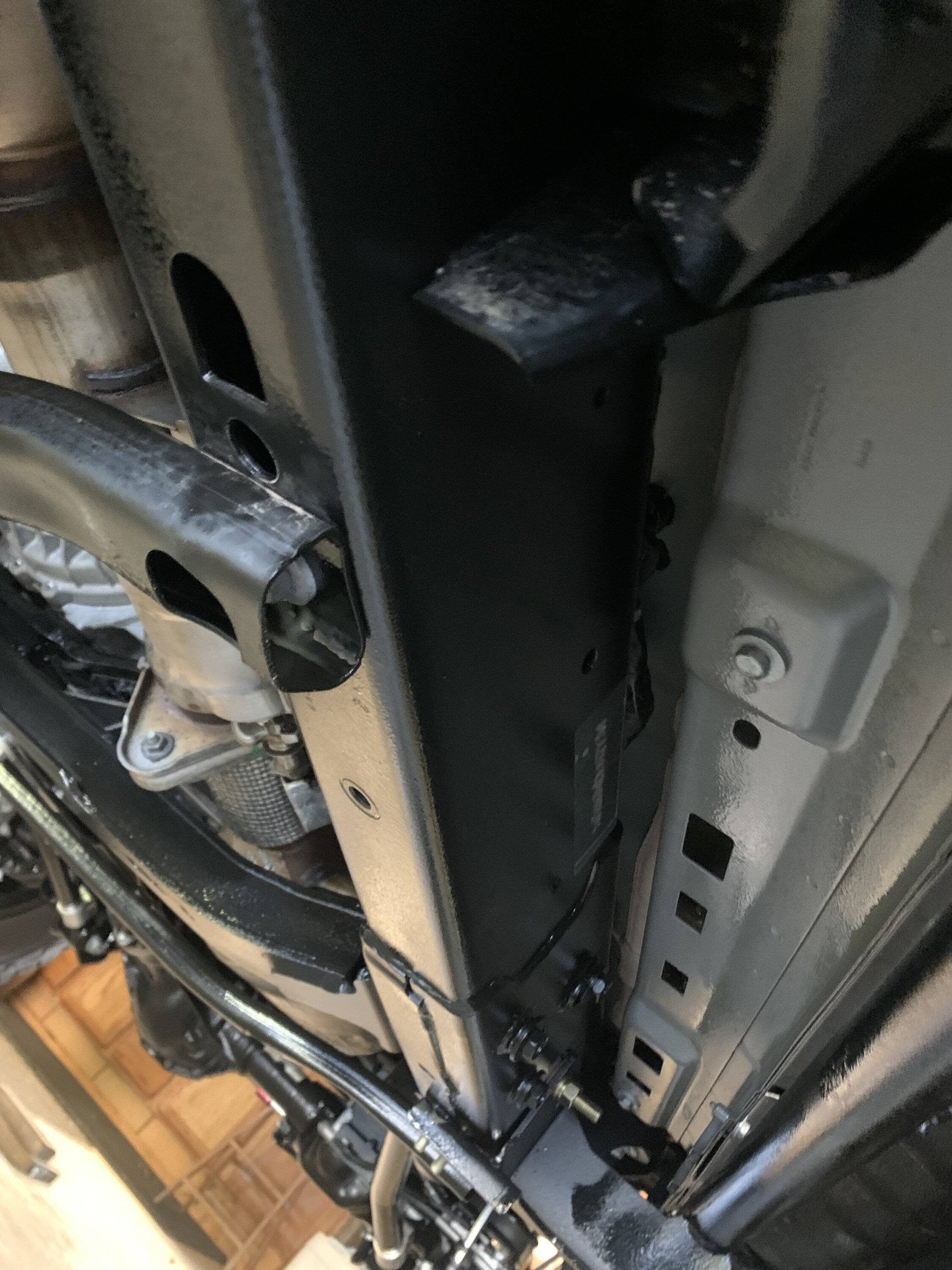

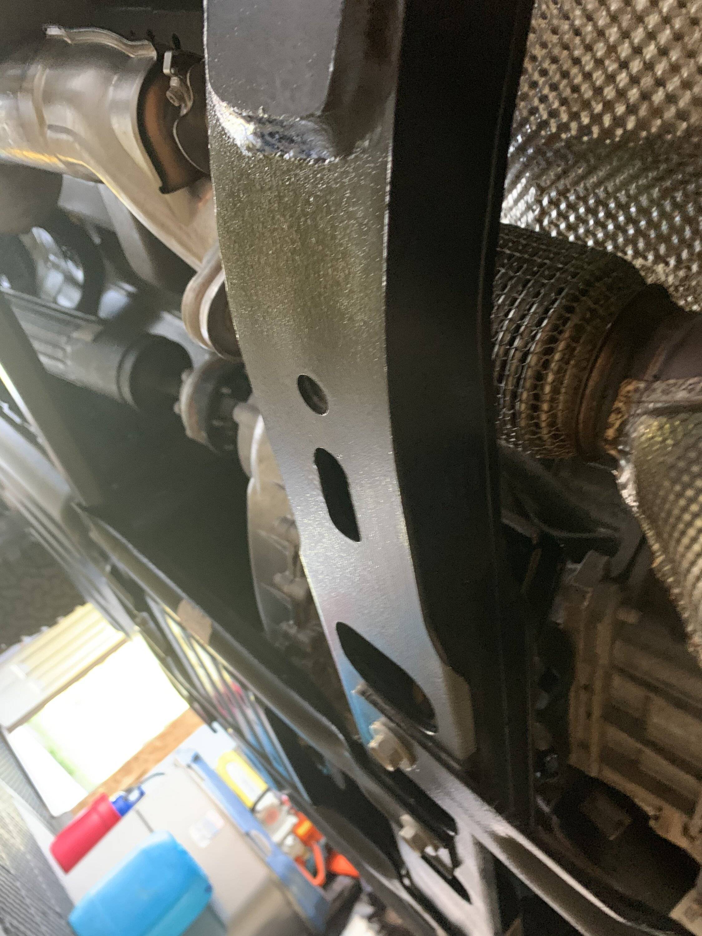

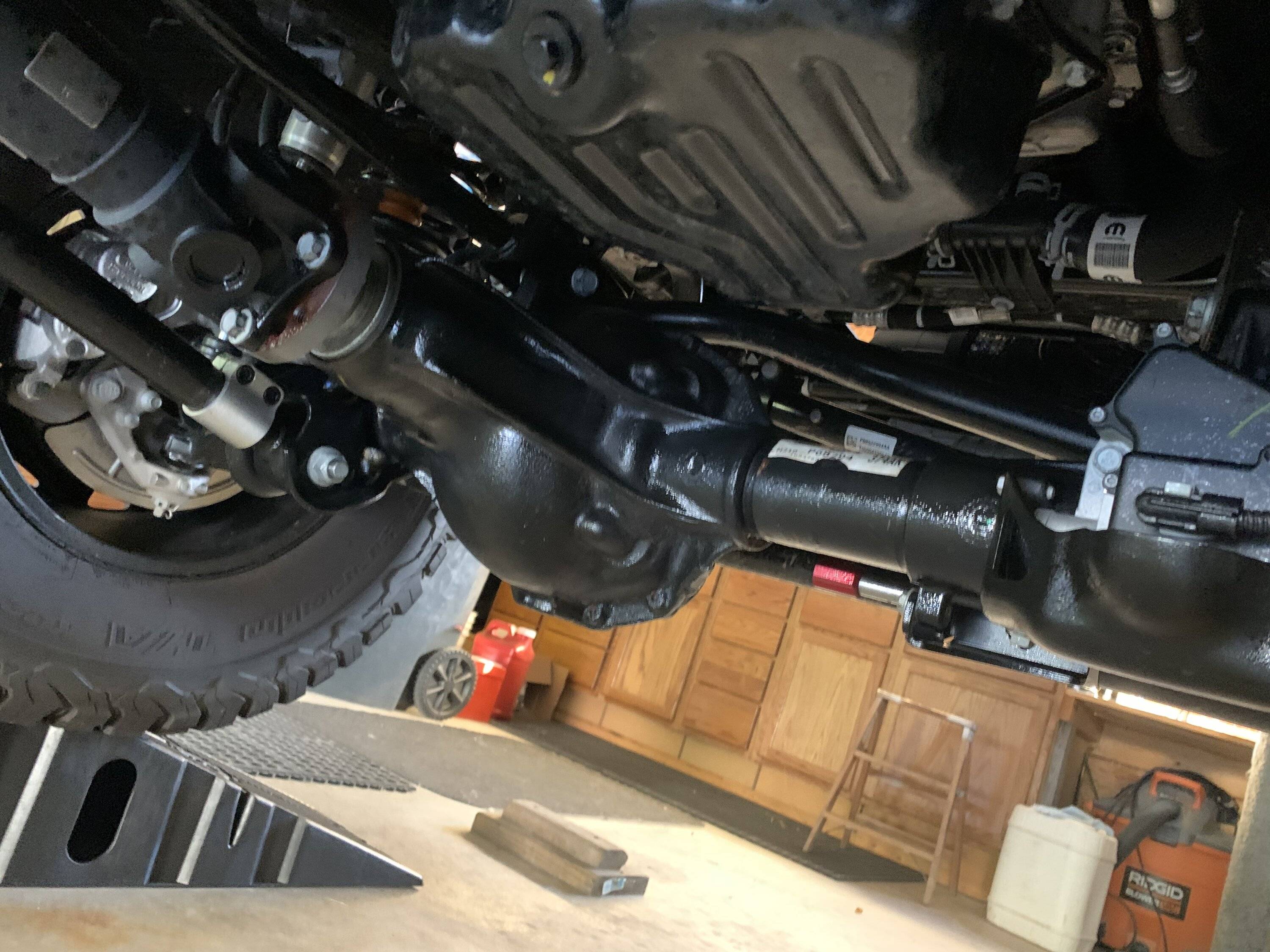

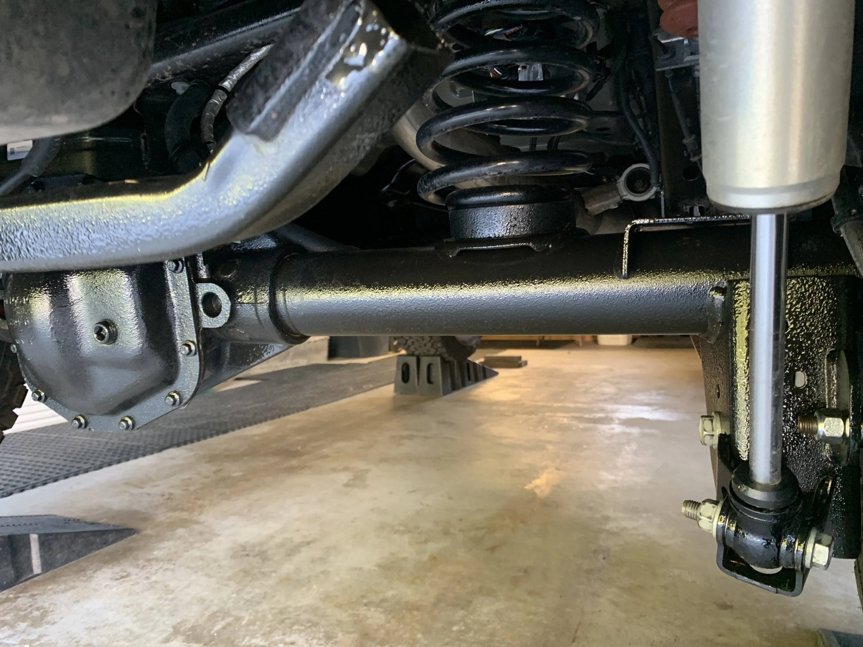

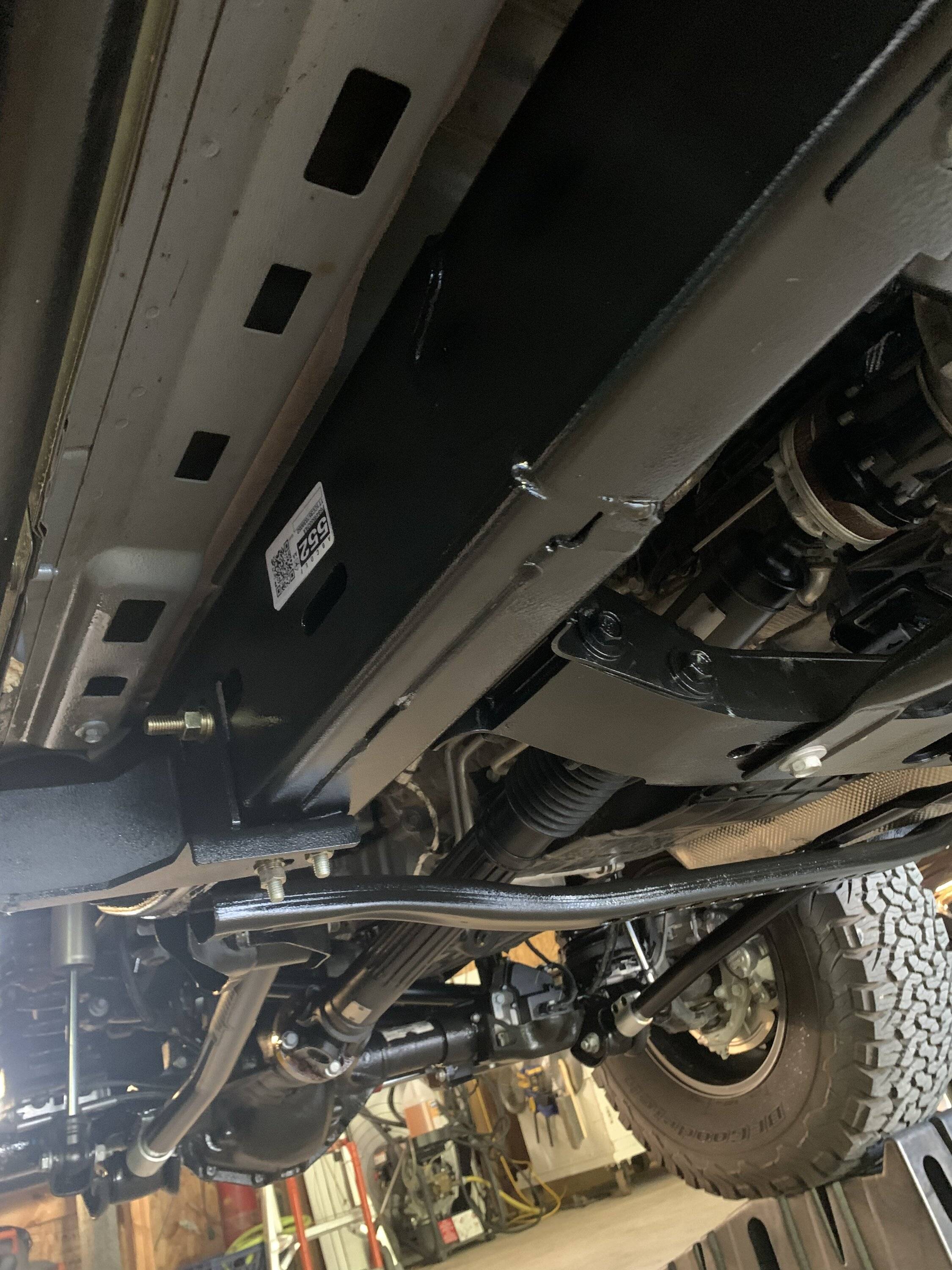

Used 2 cans of Fluid Film today.

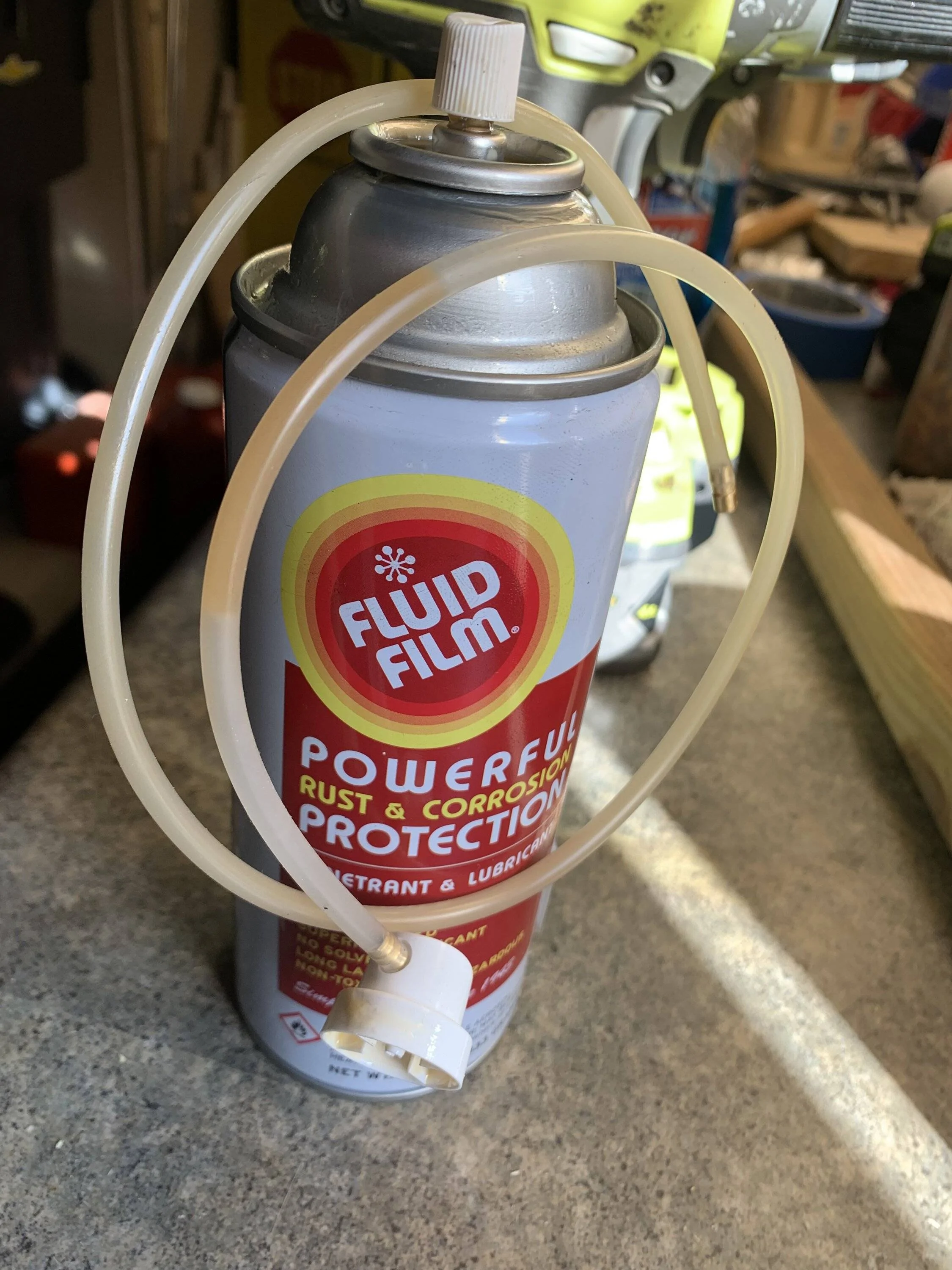

What's your method to spray it? That looks really good. Do you just spray at a distance. Everything in sight on the underside? lol
First, I have 4 ramps that I drive it up onto, then you can spray about 6" away from the large areas, then to be more precise you use the little red straw that comes with each can for areas you don't want overspray like by exhaust components, the small little tubing in the photo is for getting inside of the cross members or hollow areas, once you get it in a cross member you pull it out while spraying and it bombs the whole inside also, I also spay it wherever salt may sit like on the inside of my steel bumpers and so on.
