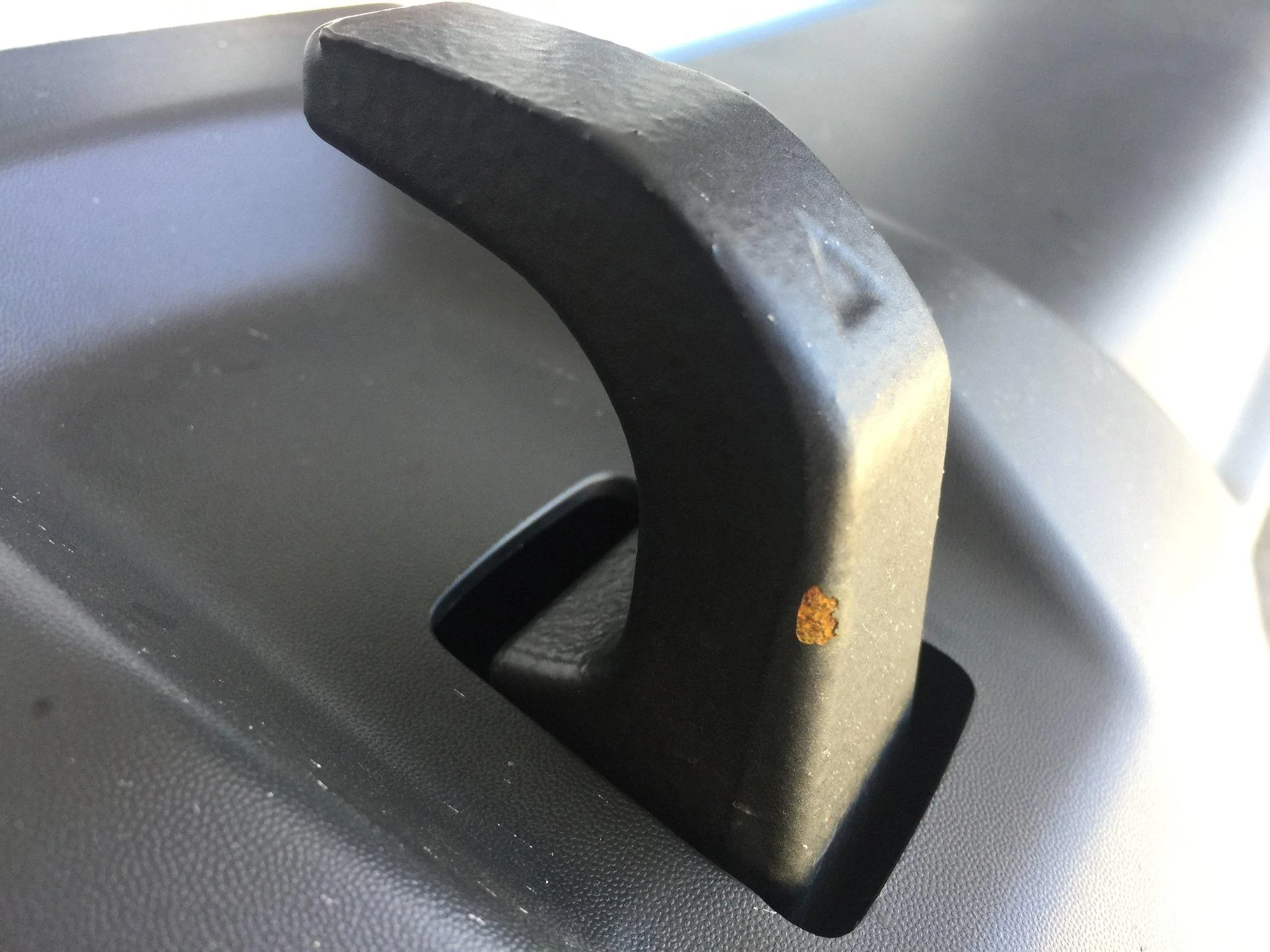

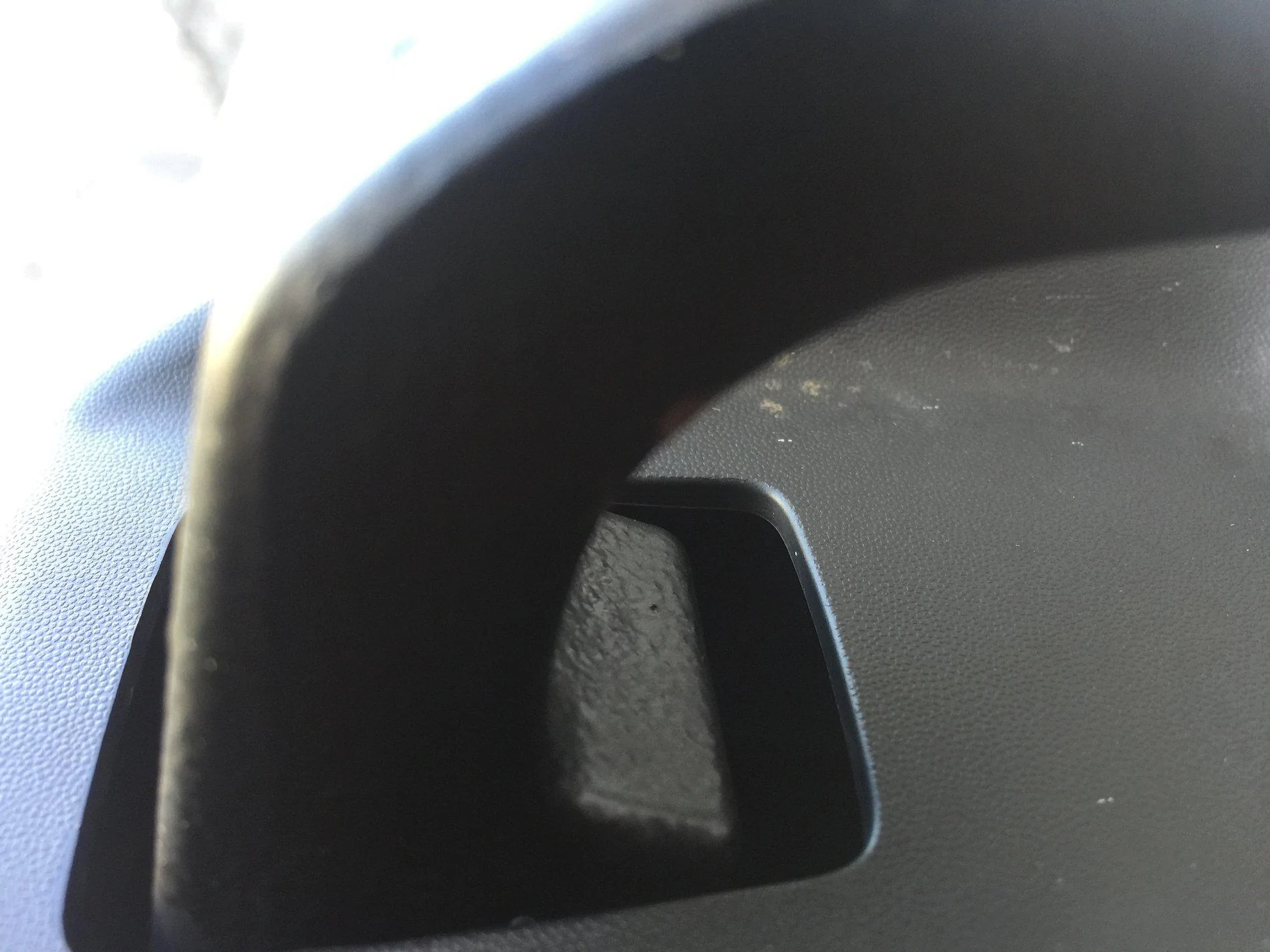

Received my JLUS on Jan 31st and already has rust spots on the front bumper hooks. Has only been 2 months. Wtf? And I had undercarriage rustproofed by Ziebart as well. Dealer said they’ll paint them. Do I have a case to have them fully replaced? To my understanding whether they are painted or not they will just continue to just beneath the paint and get worse.
