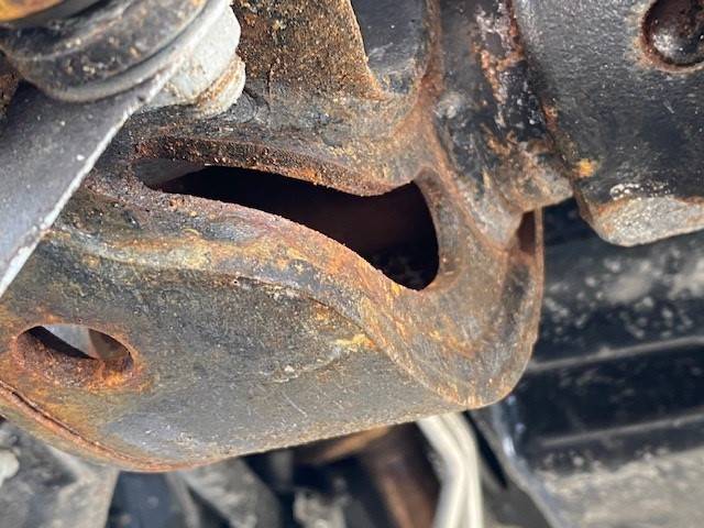

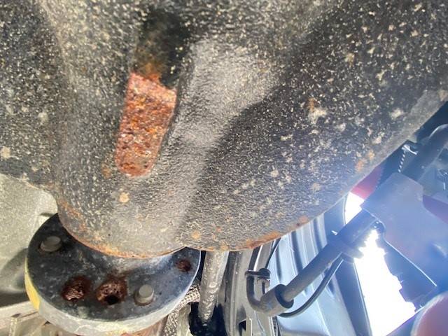

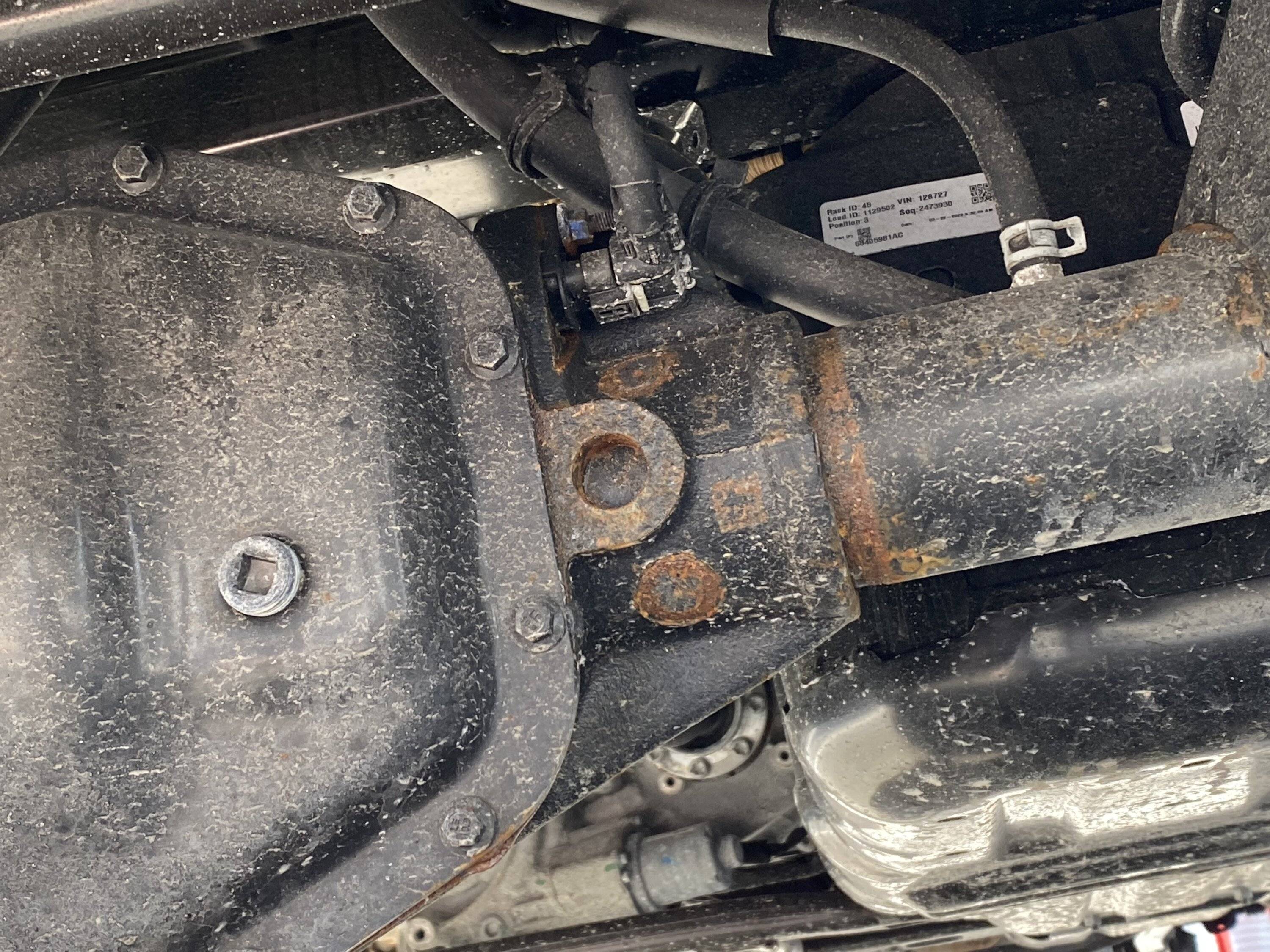

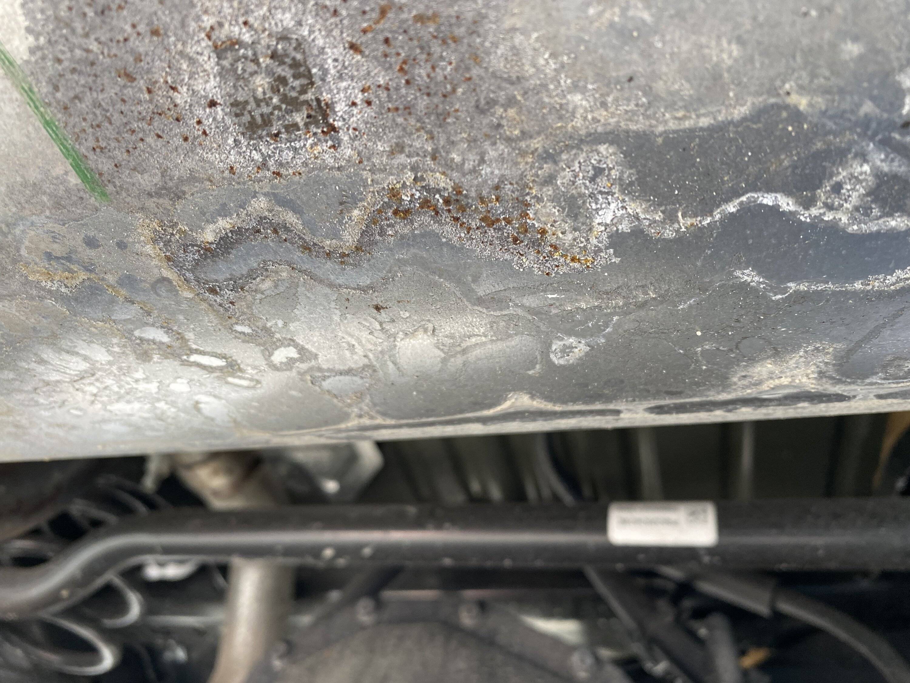

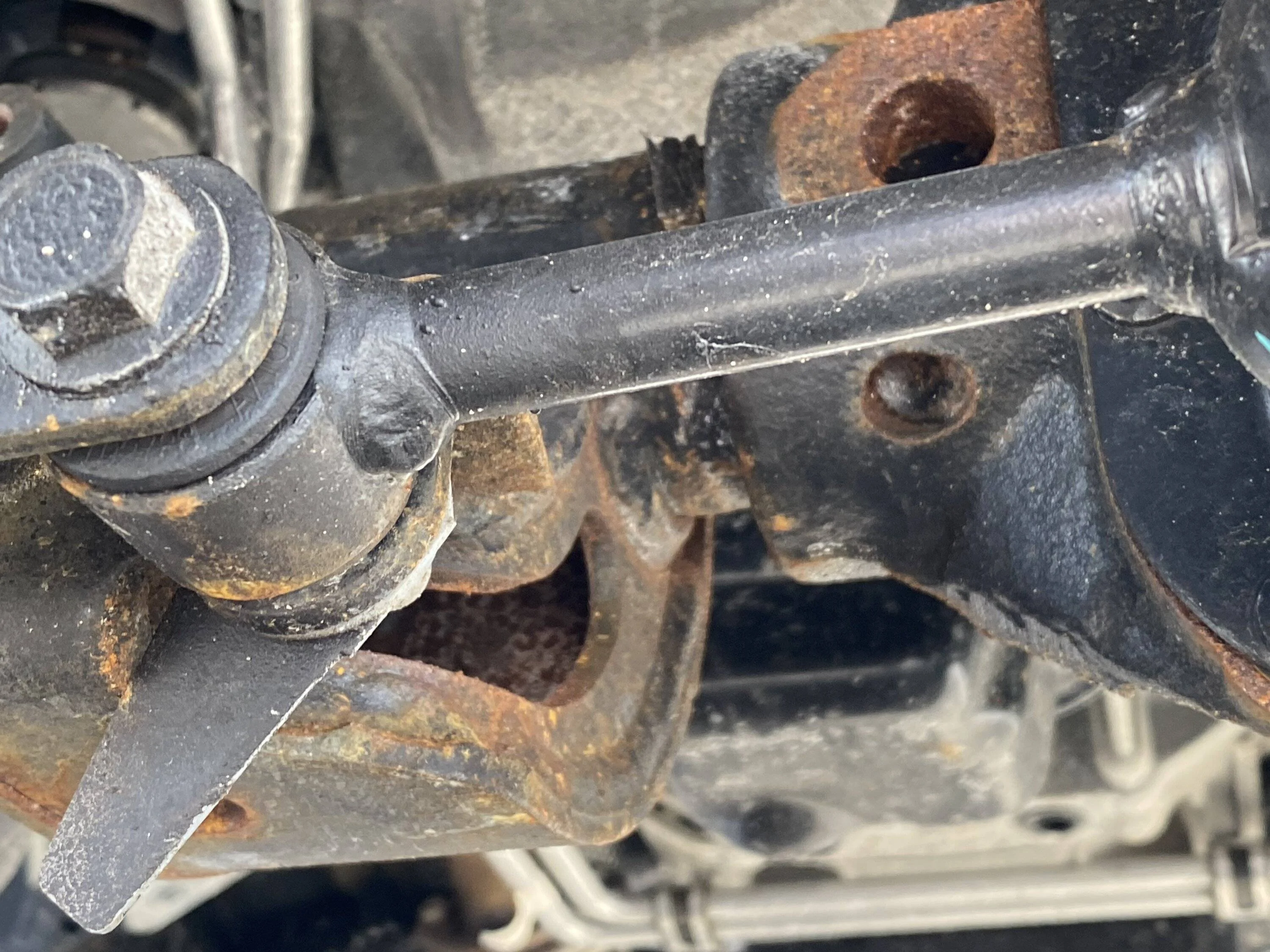

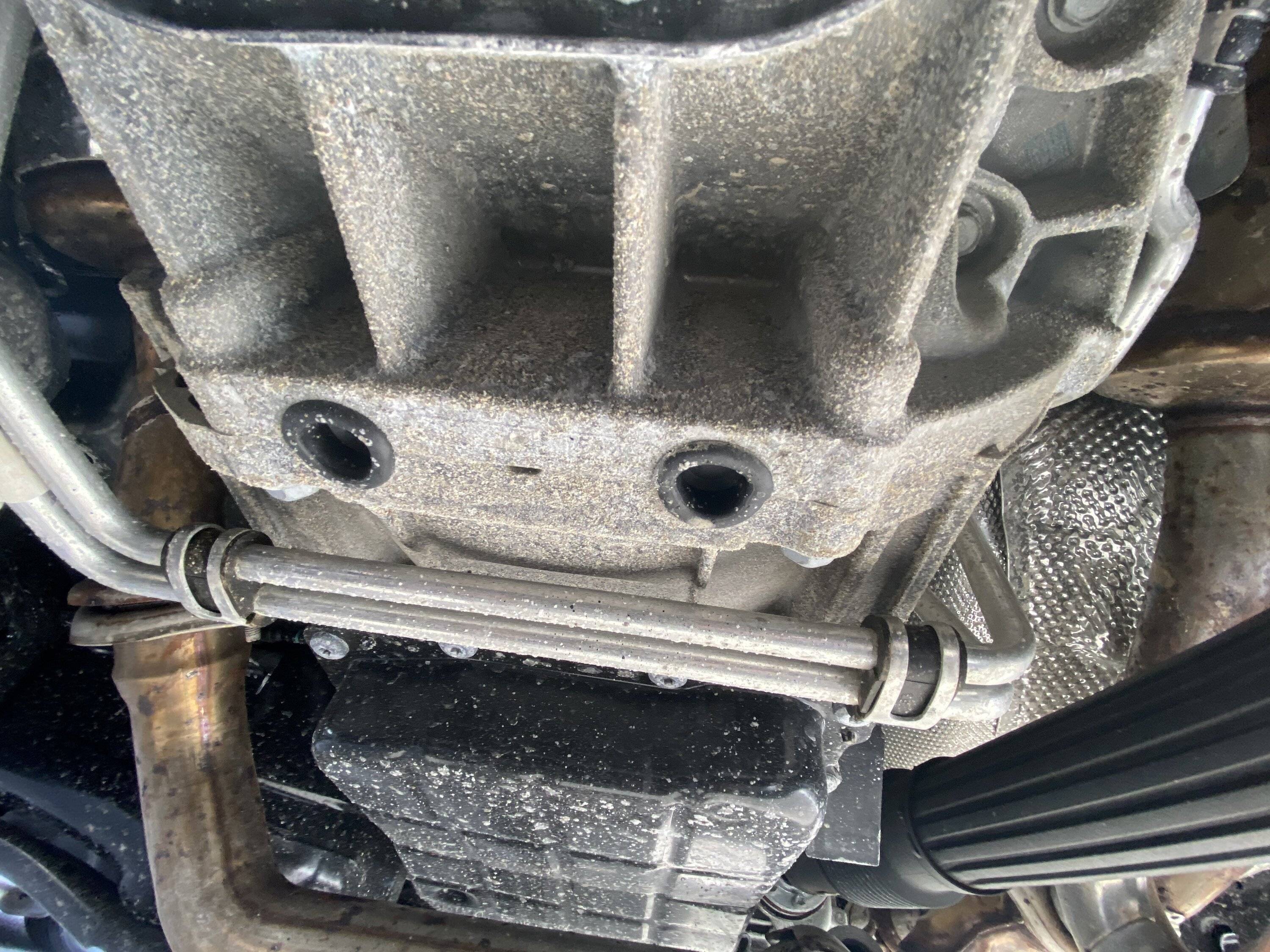

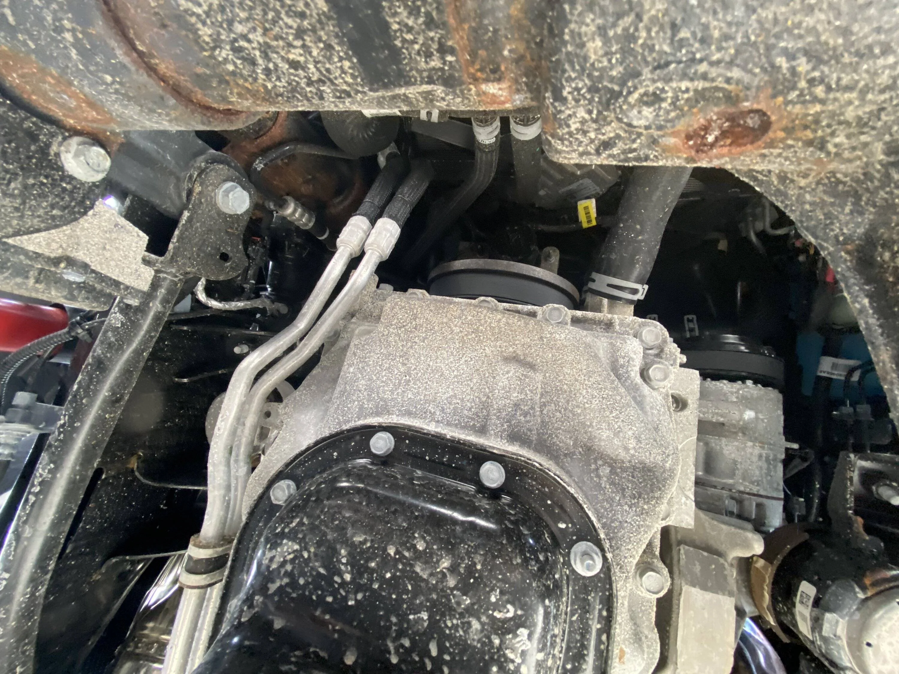

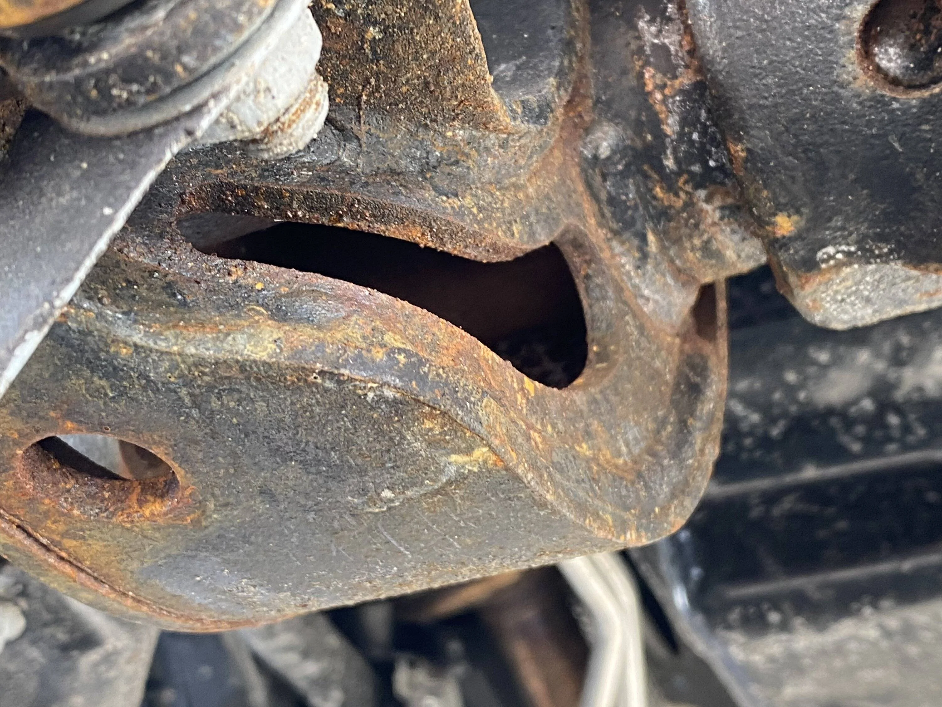

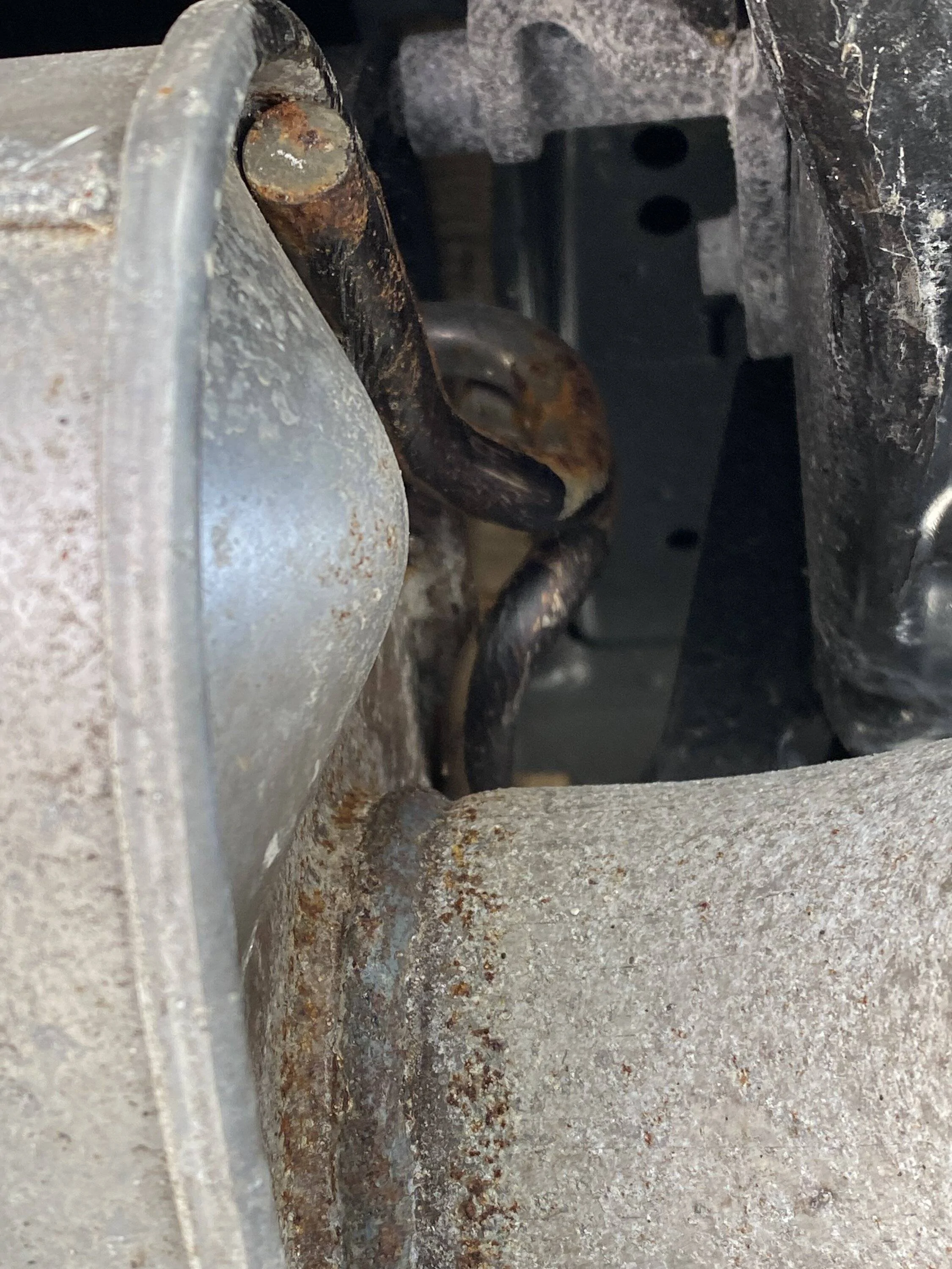

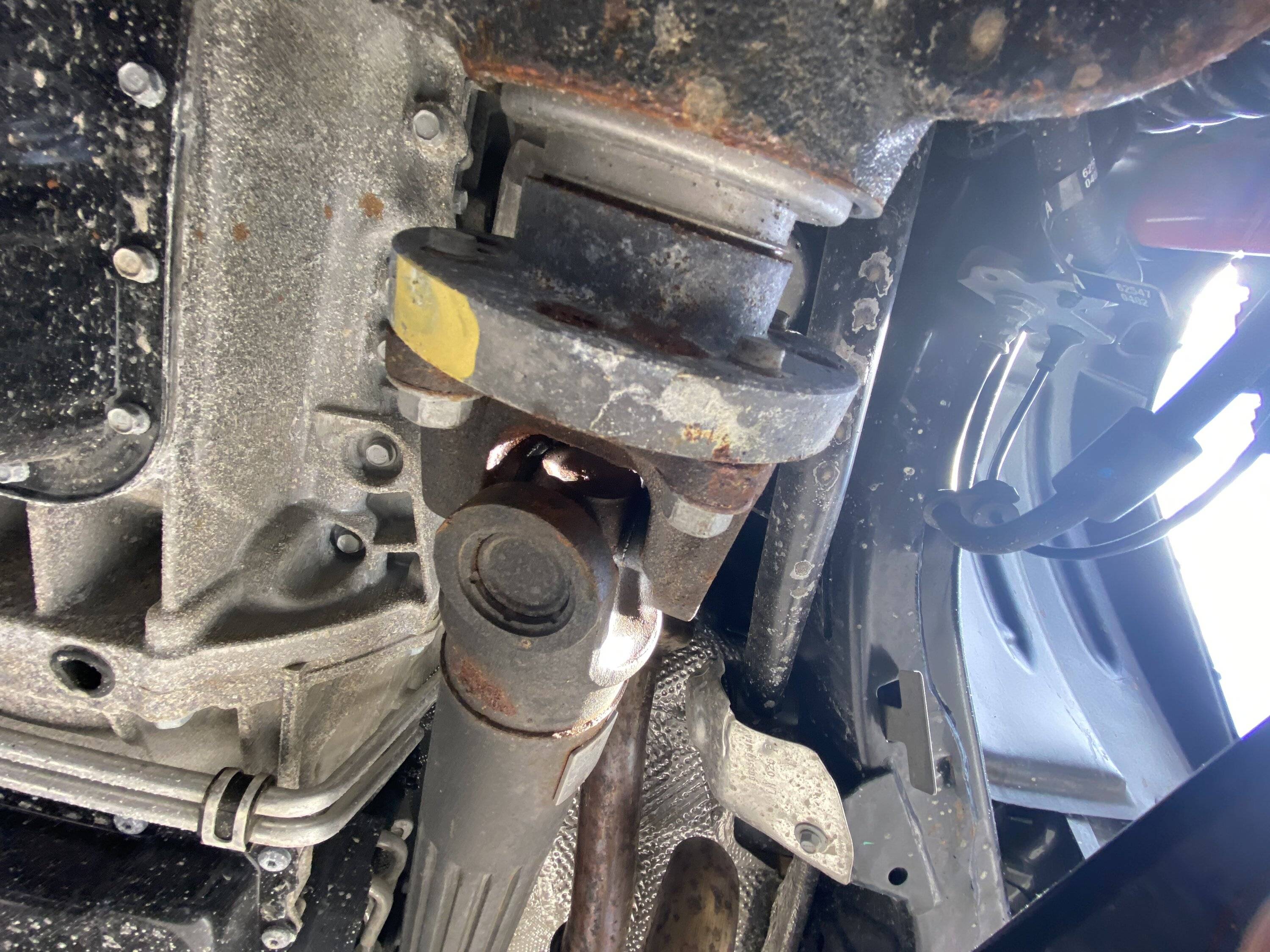

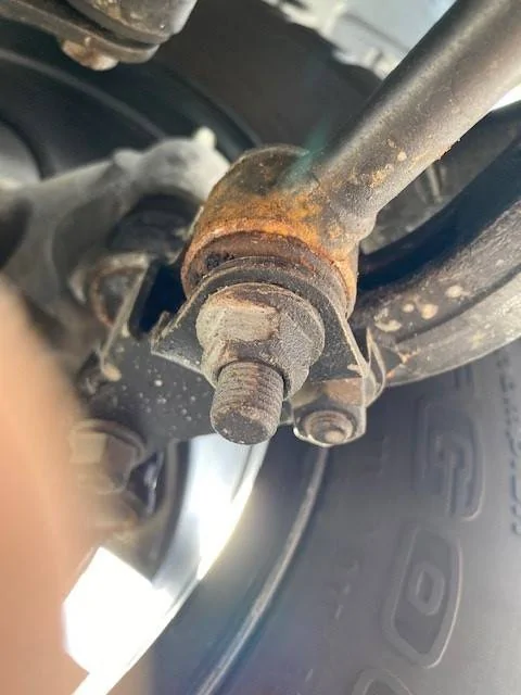

any one taken possession of a brand new jeep only to get home and whilst checking it out finds the undercarriage covered in rust ??
I've been asked to attach some Pics. Please remember that this is what I saw when I got home from picking it up. I've had plenty of new cars over the years and NEVER expected to see a brand new car in this condition. Really dampening my excitement of picking it up - and yes still get excited even though im 65! :)

Recommended undercarriage treatment to prevent it?
coat areas showing rust with ospho (rust neutralizer), and then hit it with something like rustoleum professional spray paint. etching primer it before paint if you're feeling crazy.

I personally wouldn't paint it, but instead treat it with something like Fluidfilm underneath once a year if needed. A lot of folks spray this, and similar treatments on farm gear, inside frames, on anything metal that gets frequent exposure. Fluid film will also keep it surprisingly clean and easy to knock off dirt or debris with a pressure washer. A lot of snow plow operators will coat their plows with something like this, front to back.
If you had SEVERE rust, which you don't, but I'd suggest POR15 as a protectant paint. I wouldn't be too concerned about it, but I would take measures to minimize it, especially in areas that see salt on the roads.

You need to take into consideration that your Jeep took a long boat ride to get to Australia. Post some pics of it. There is a big difference between surface rust and scale. Likely just surface rust and one of the products suggested above will take car of it. It's also good to use it regularly since you live in a coastal area.

One thing I would recommend instead of spraying the welds with Rustoleum is to buy a can of it and brush the welds instead. It will look much better and last longer. Spray cans are hard to use under a vehicle and the overspray looks bad.
I recommend cutting it with 10% mineral spirits and using a narrow brush that will make it easy to just coat the welds. I used to build and paint water towers in my youth, so I did a lot of welding, grinding, blasting and painting.
