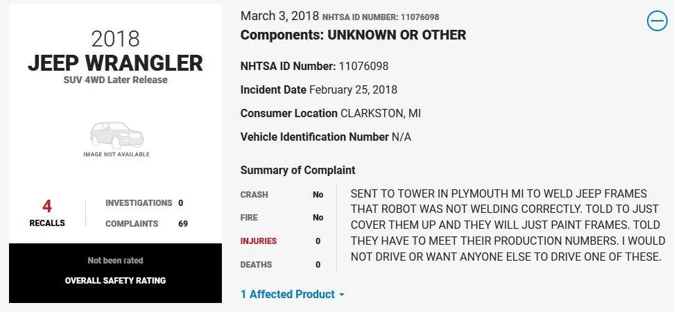

And then there is this from the NHTSA site. Someone else posted this earlier.
Jeep Wrangler JL Rusting welds Captur
