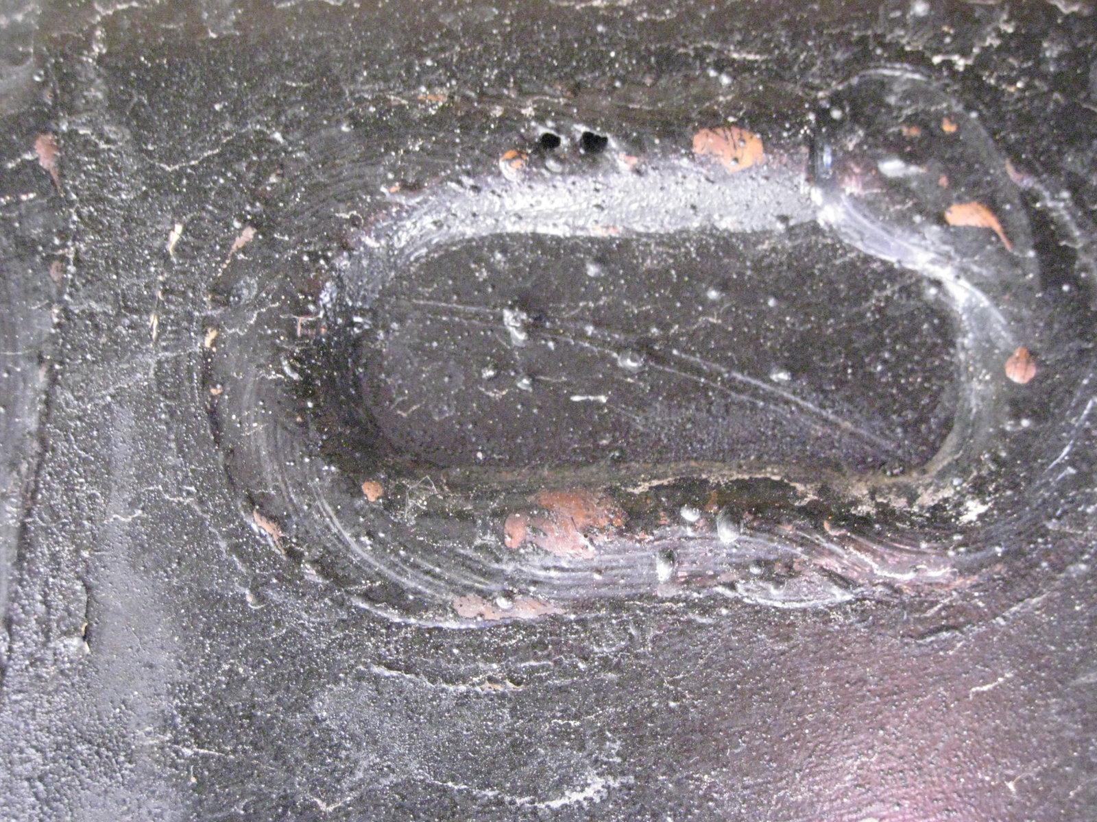

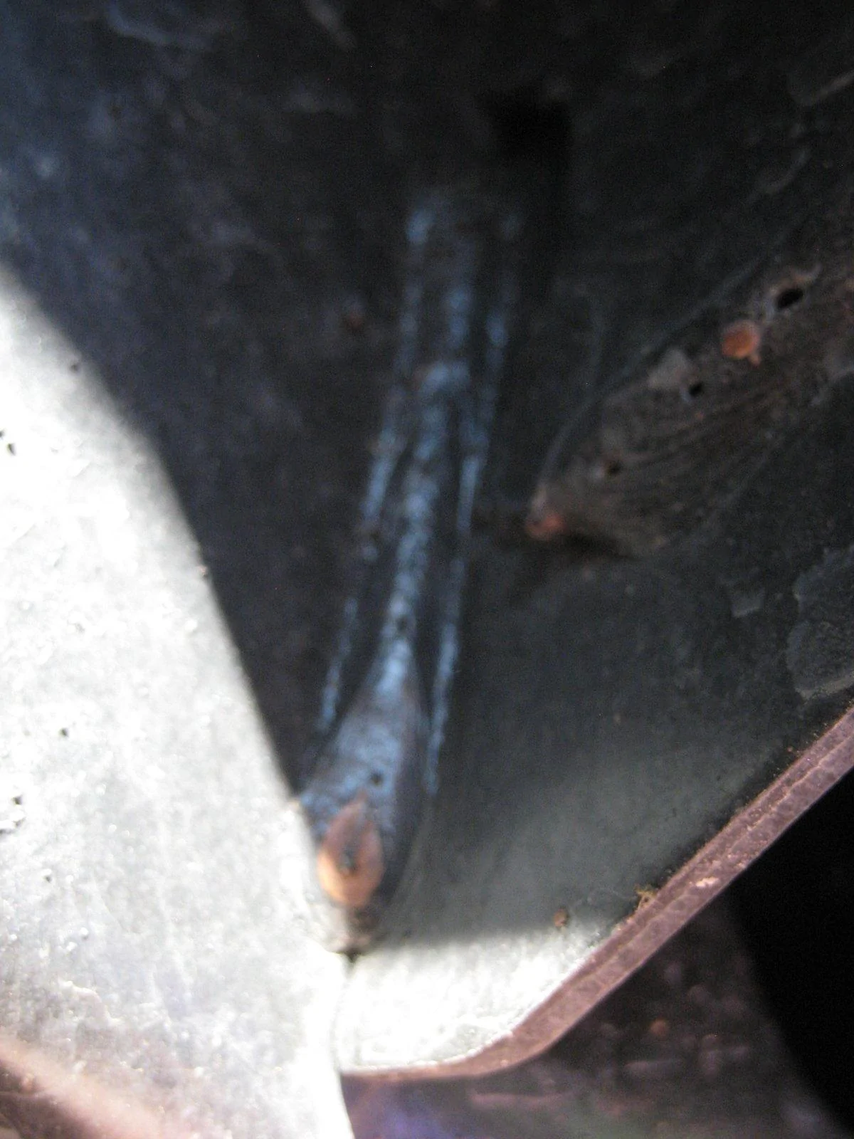

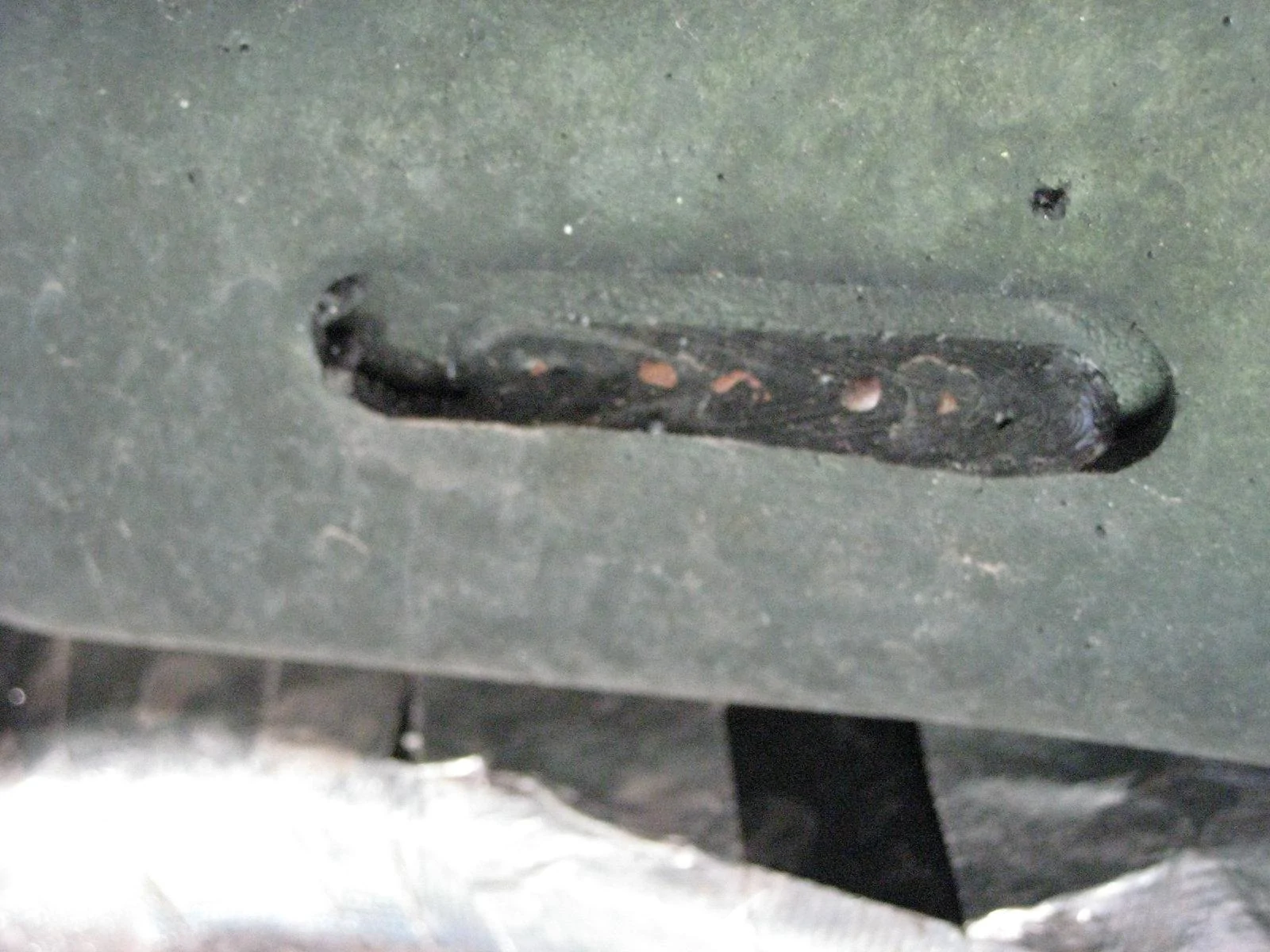

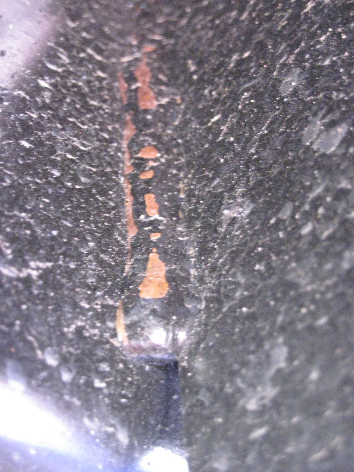

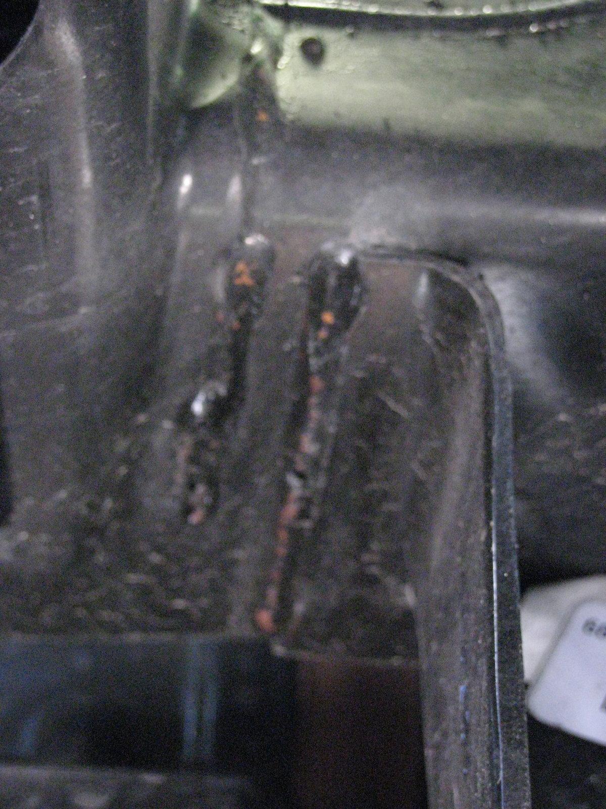

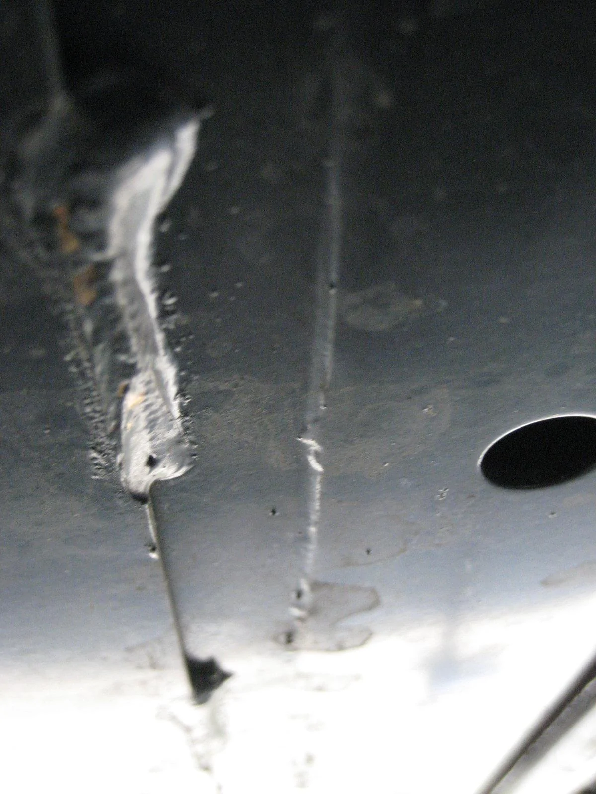

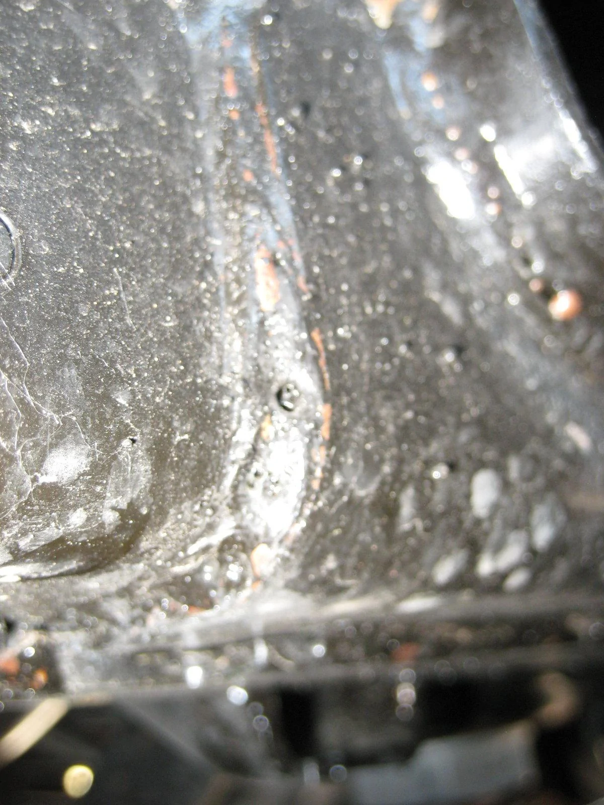

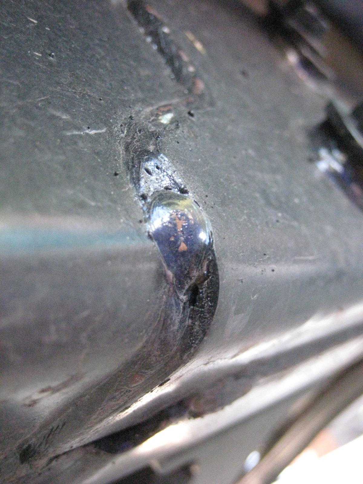

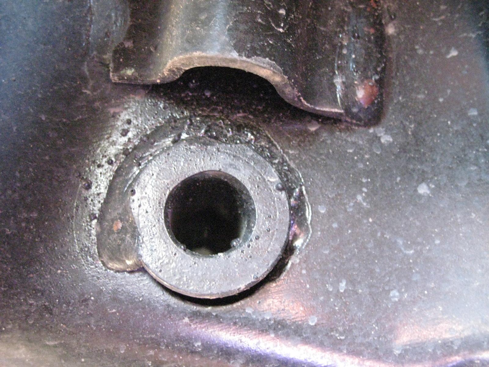

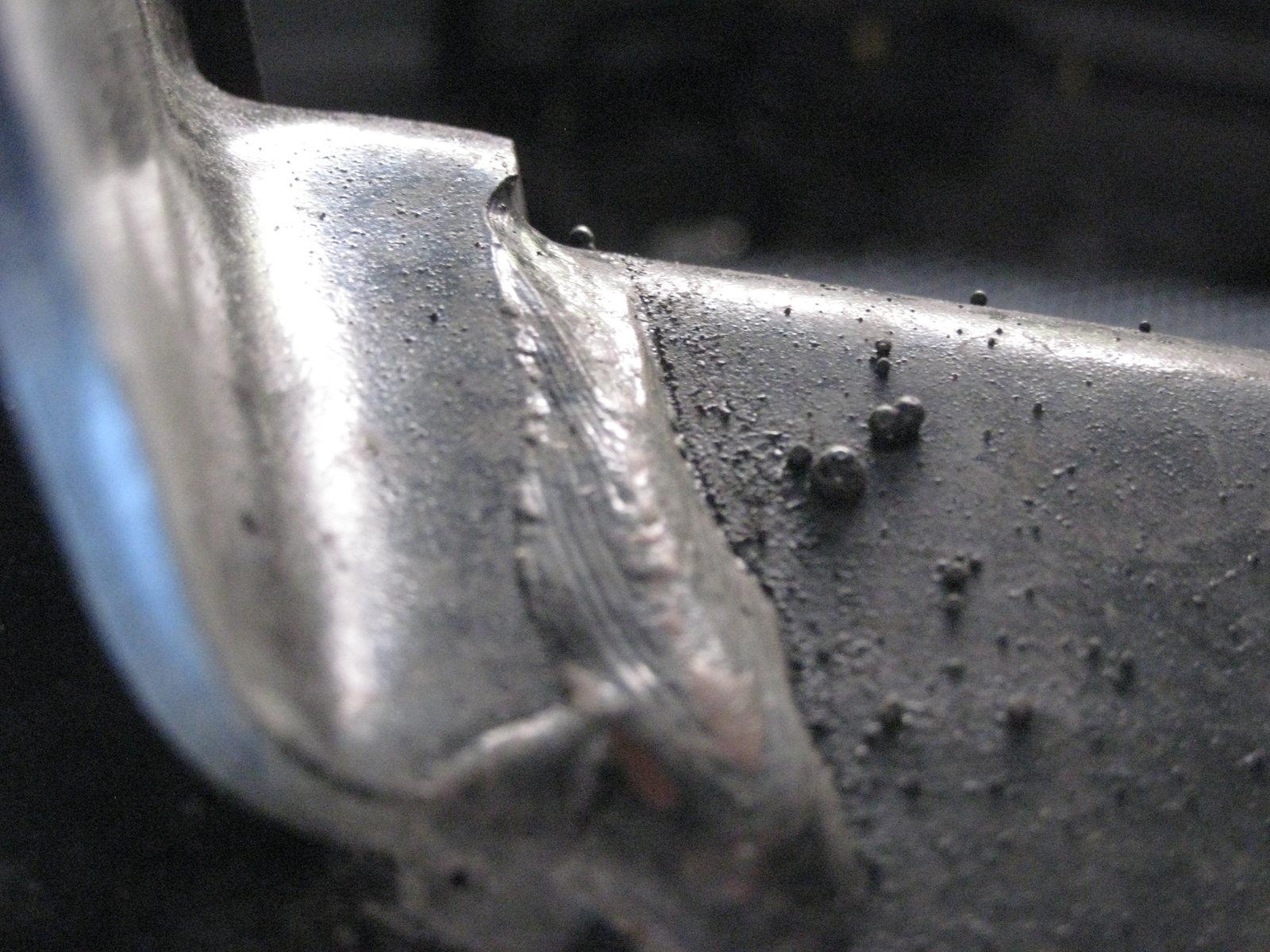

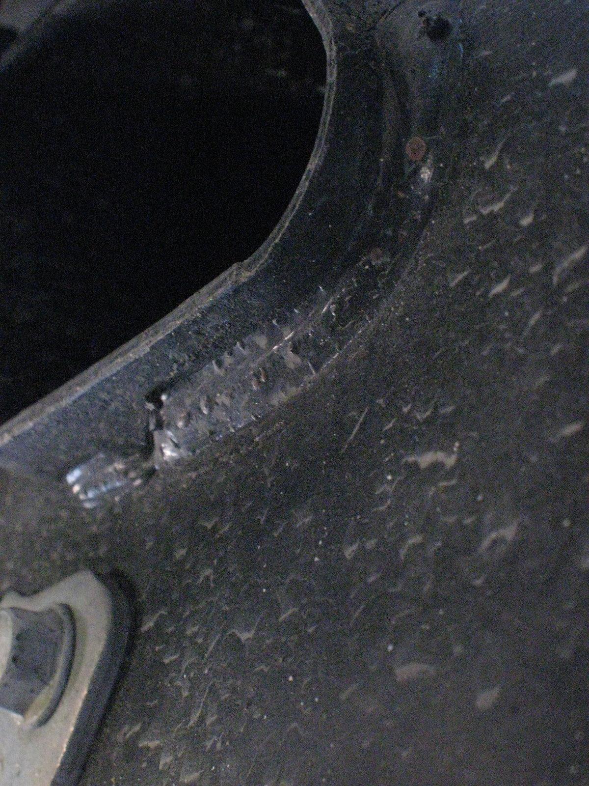

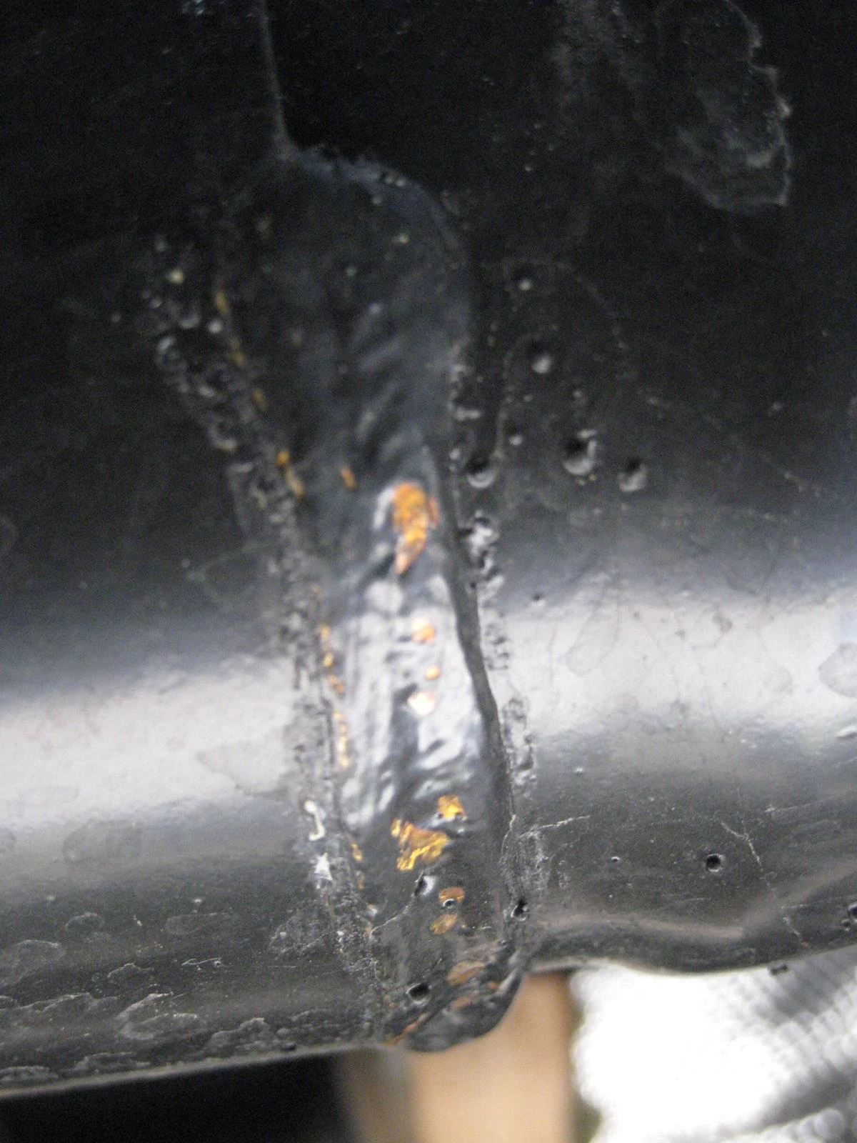

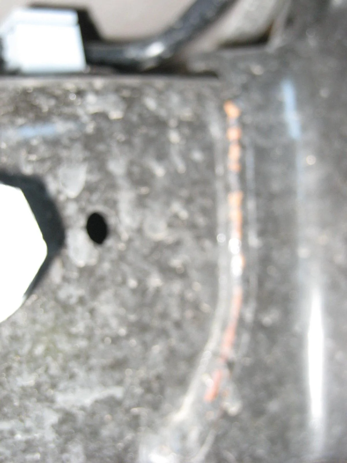

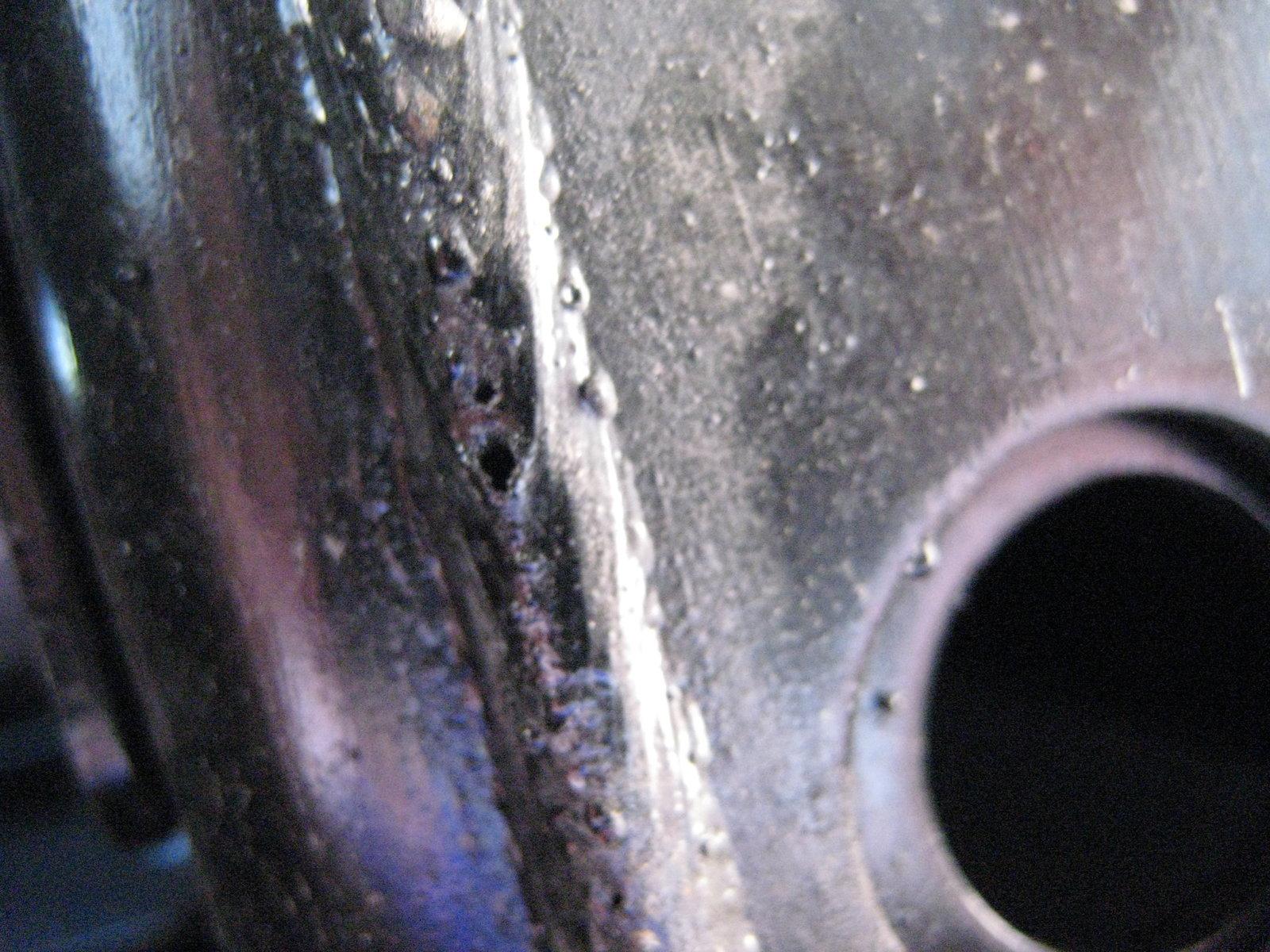

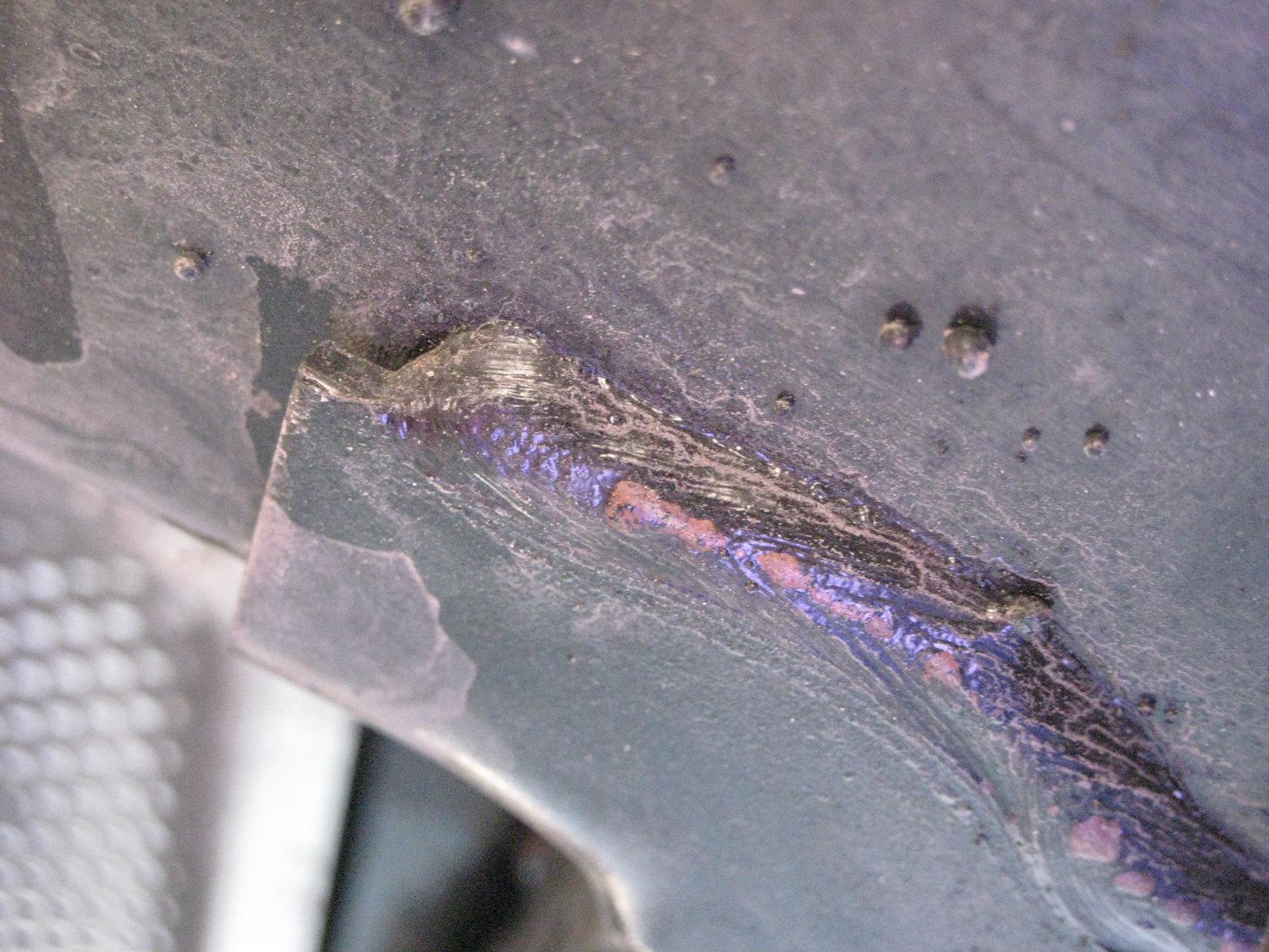

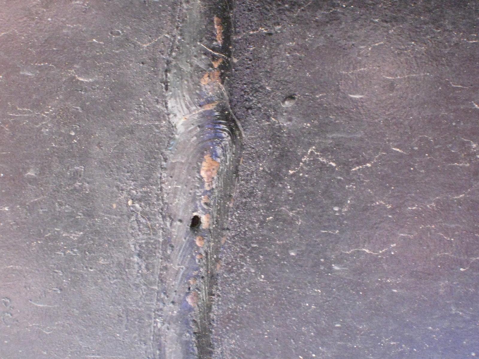

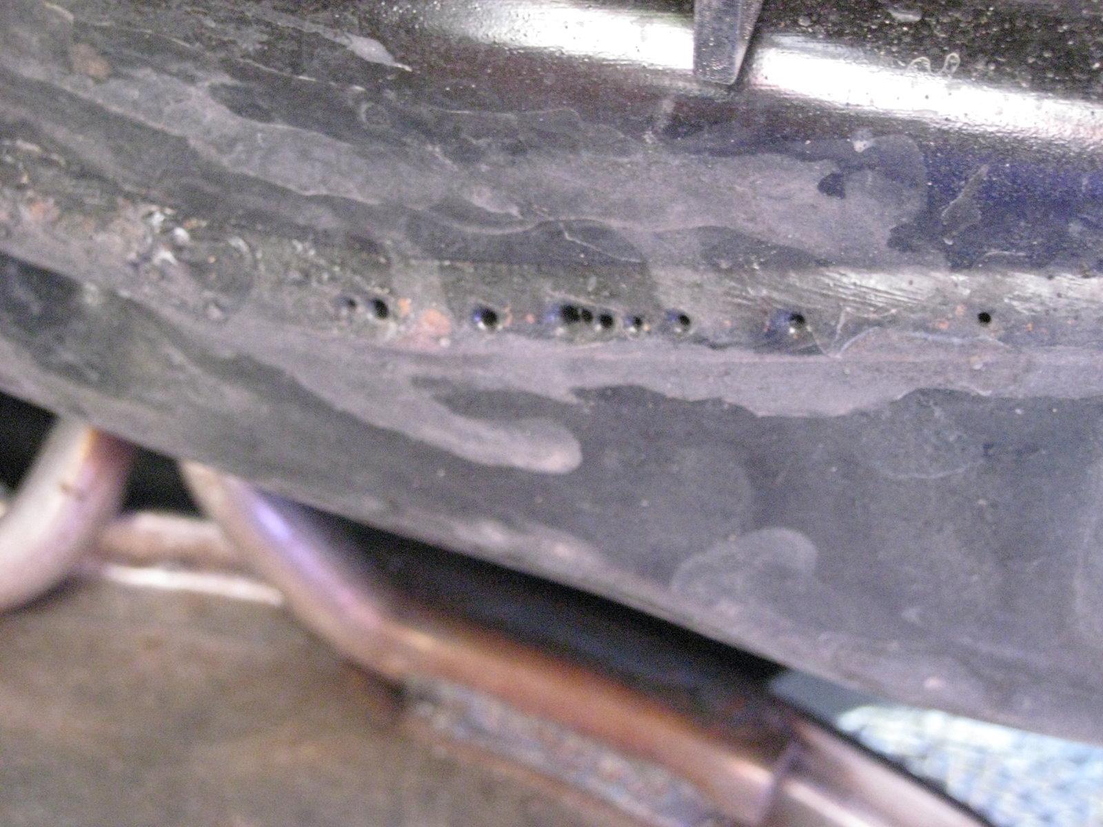

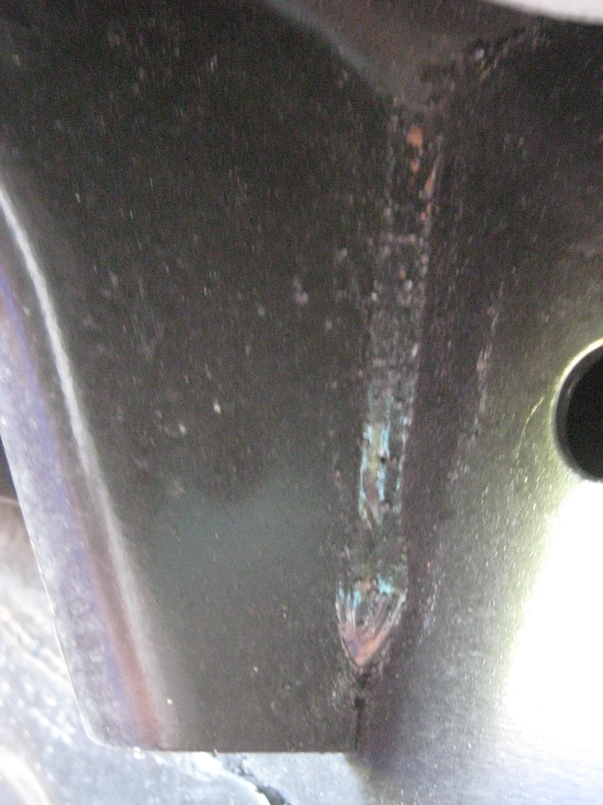

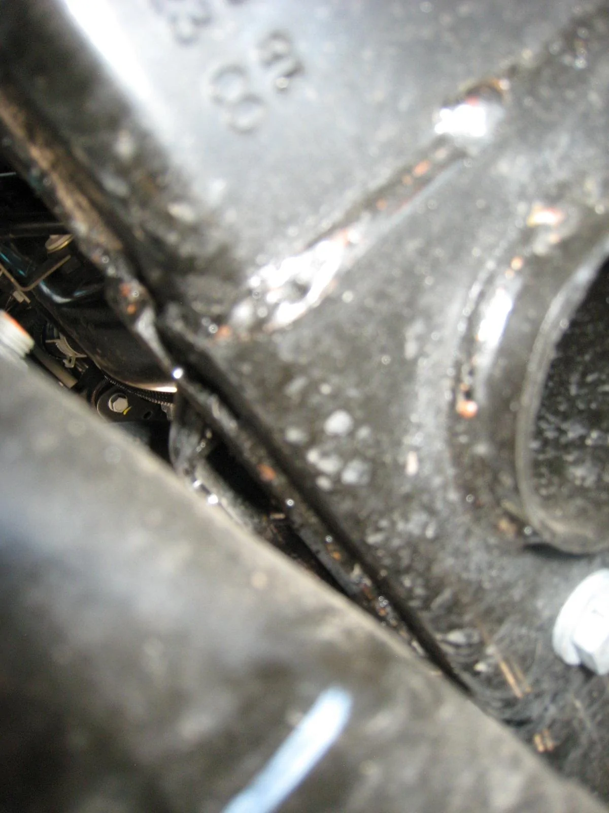

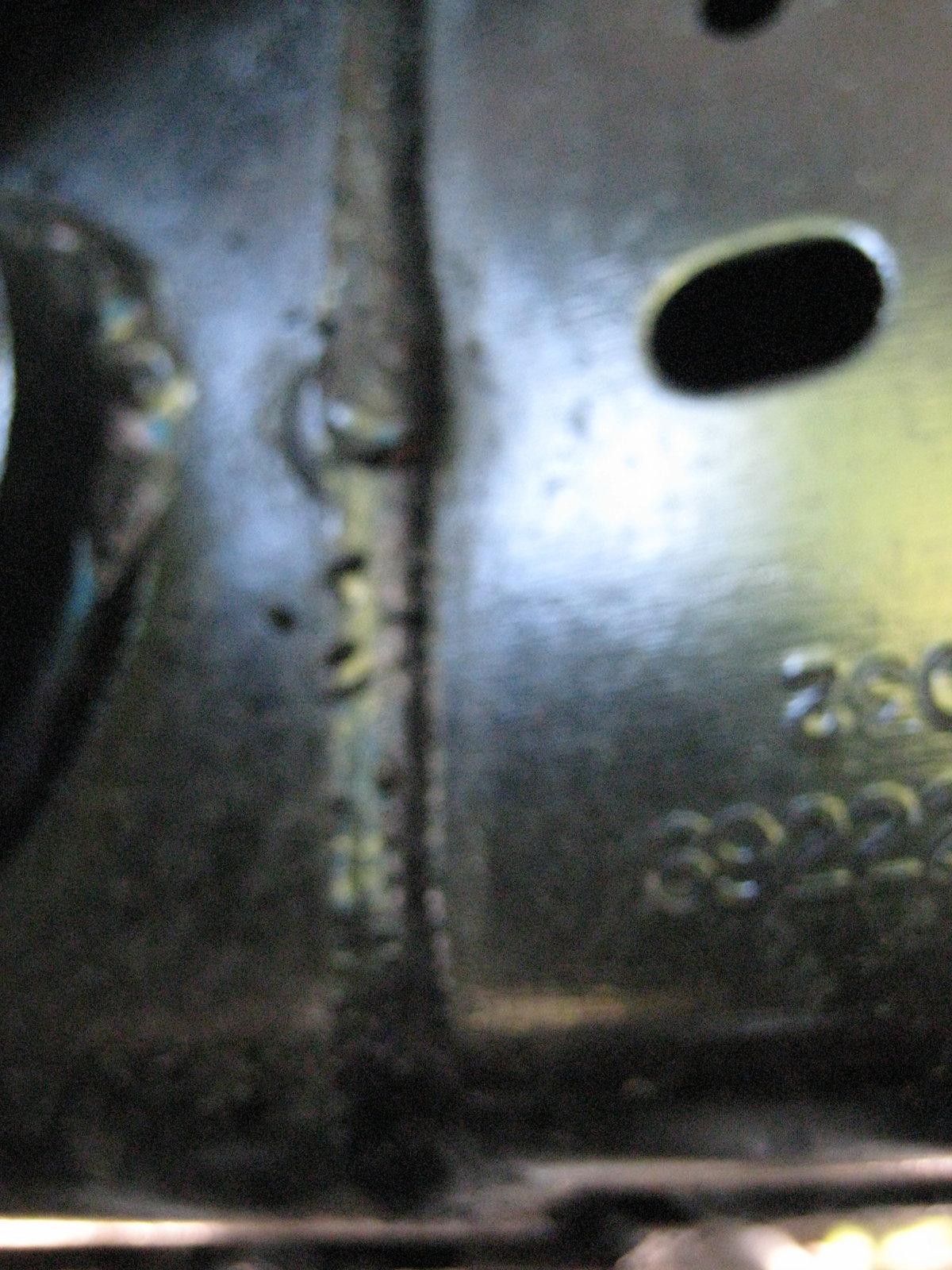

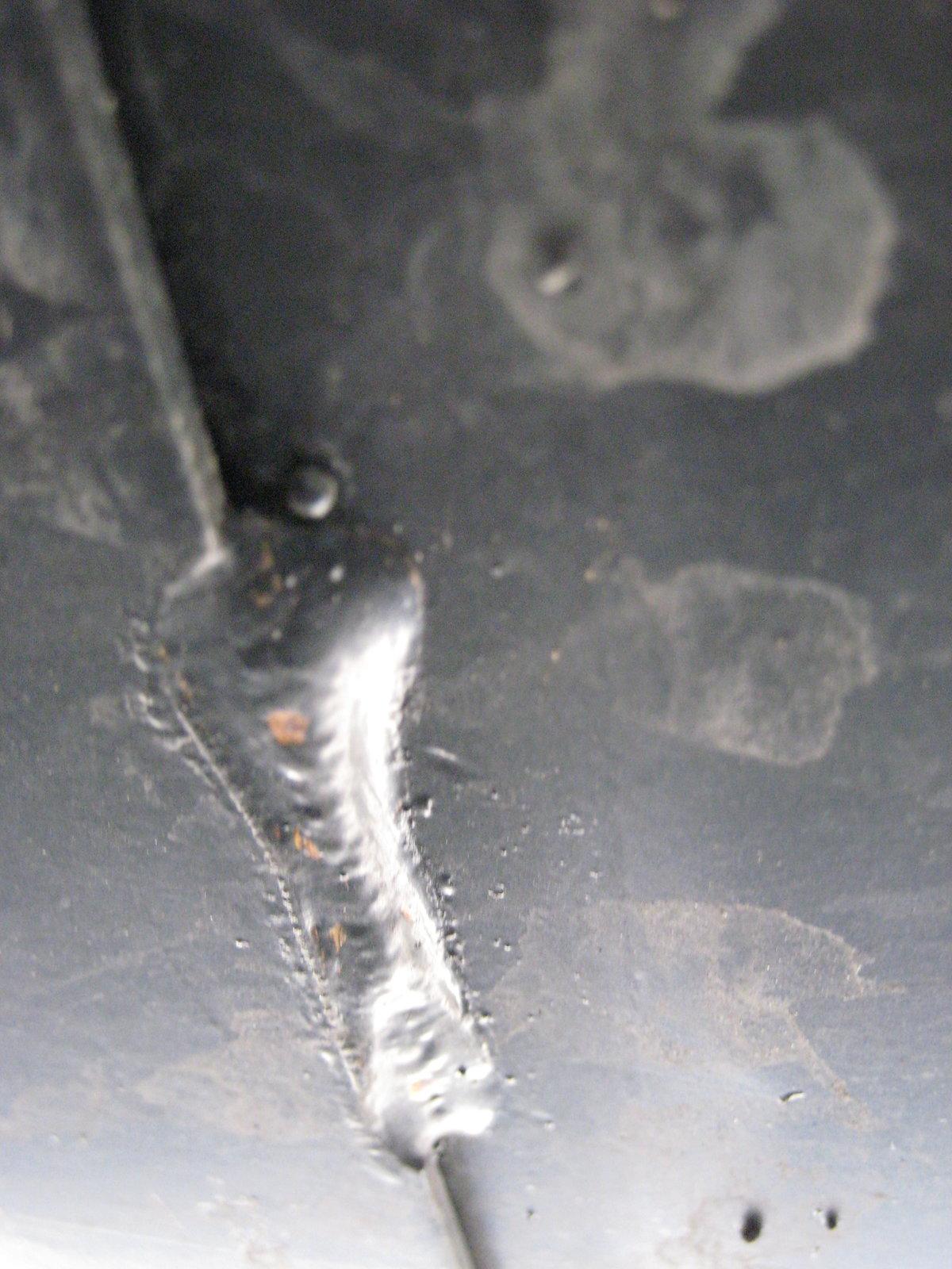

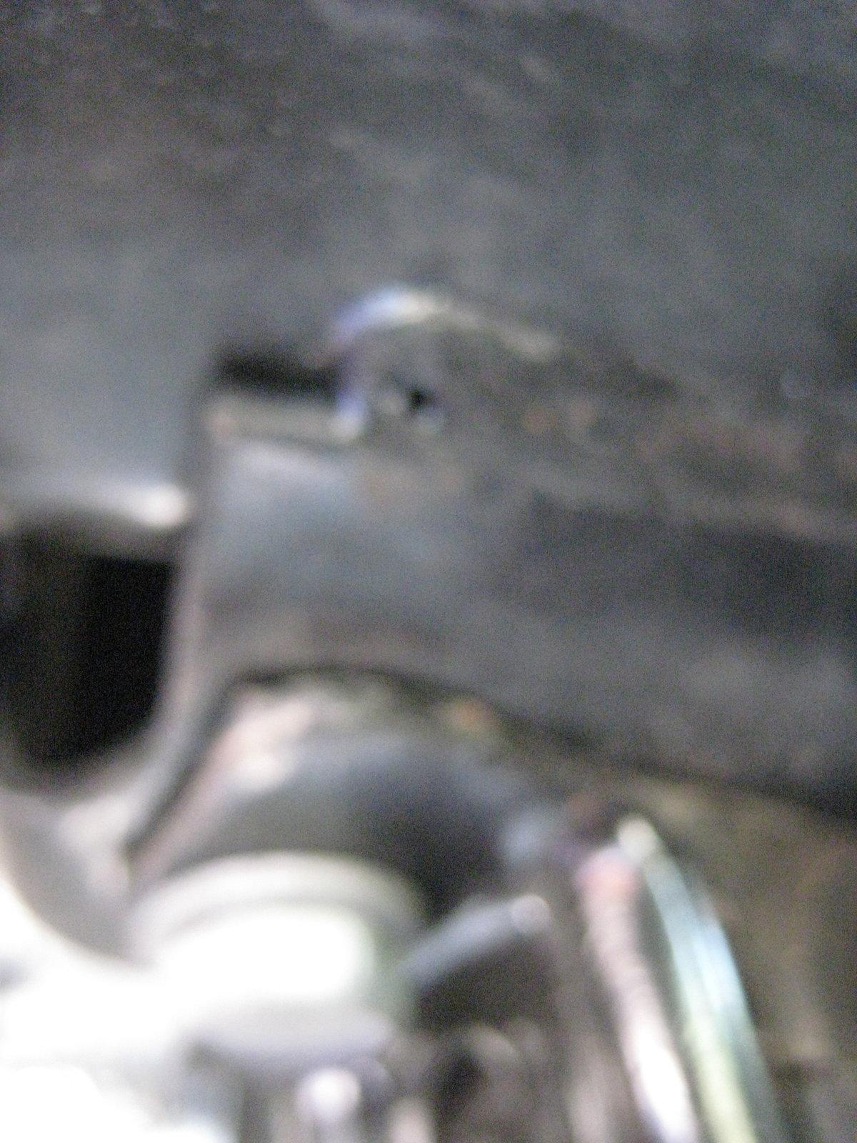

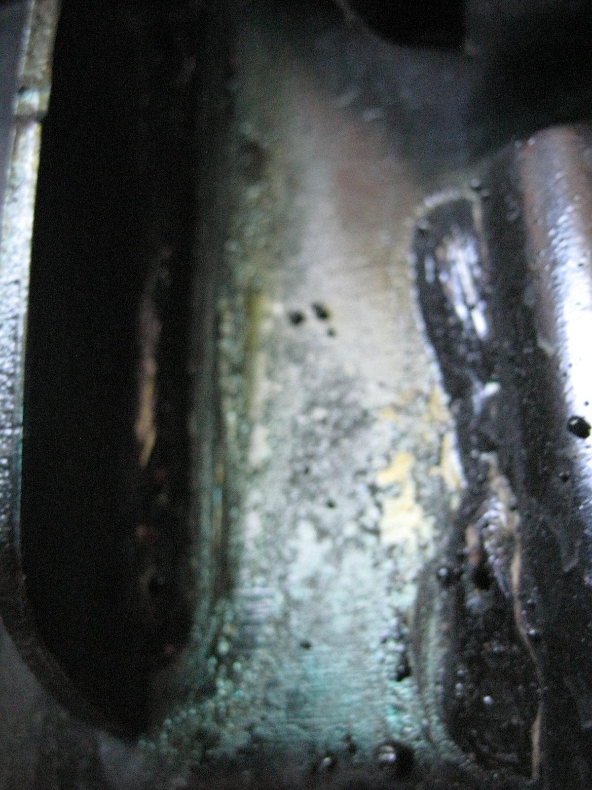

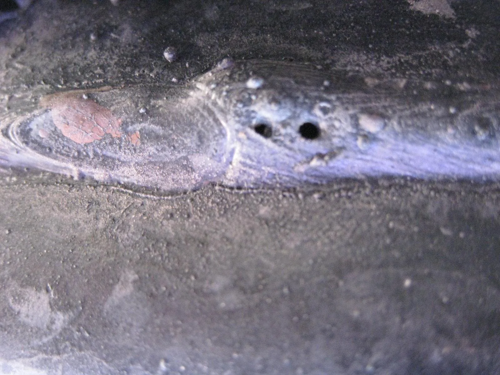

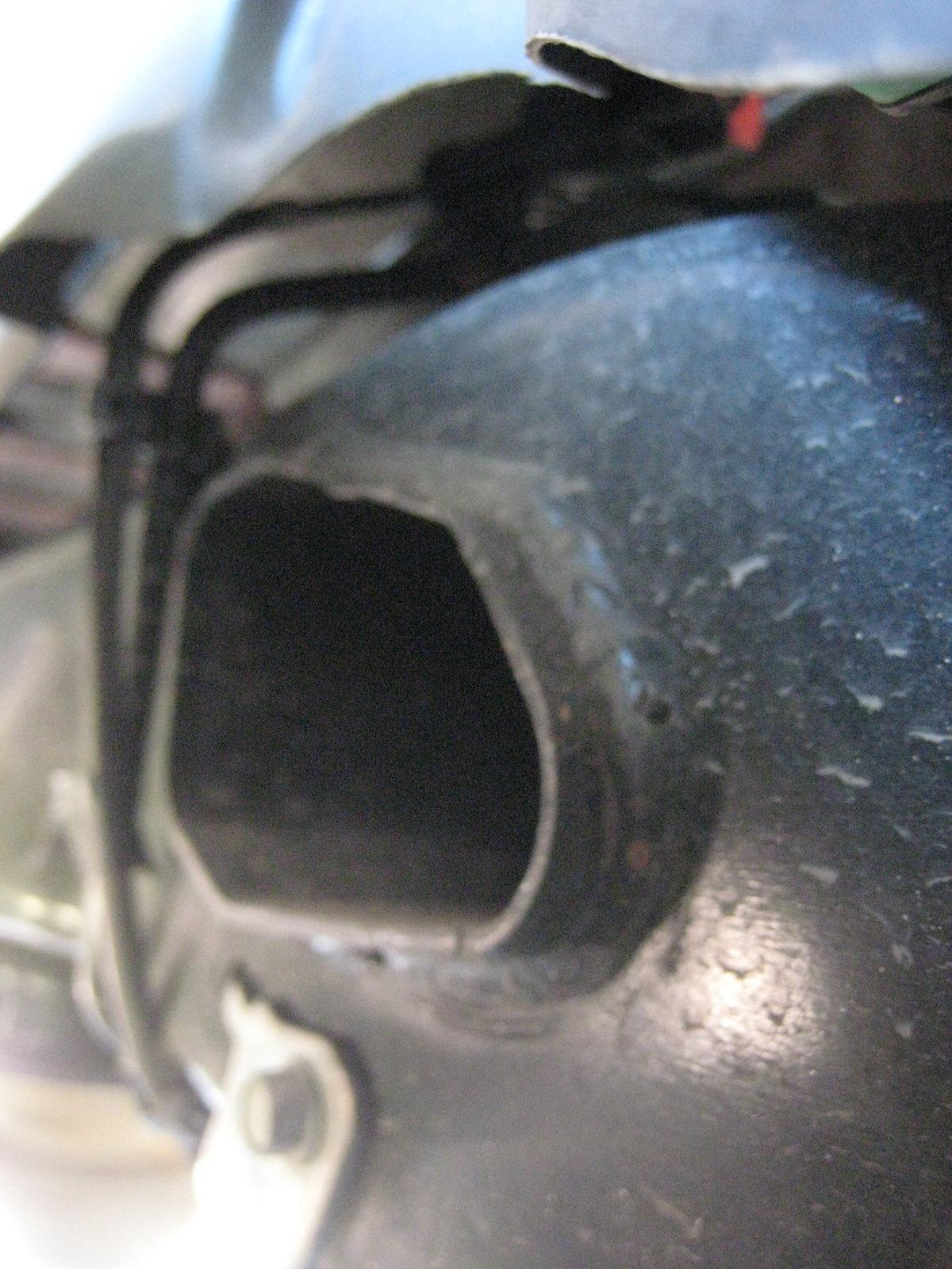

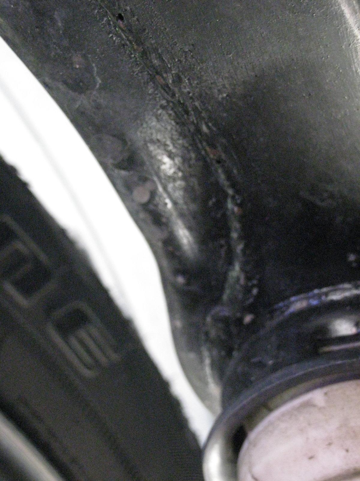

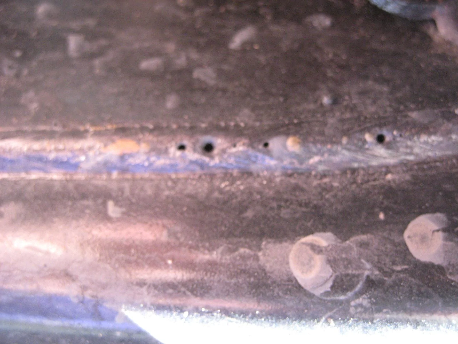

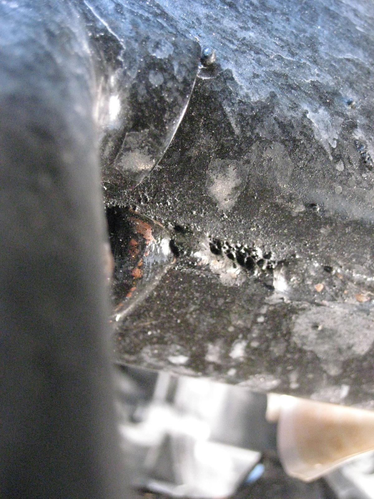

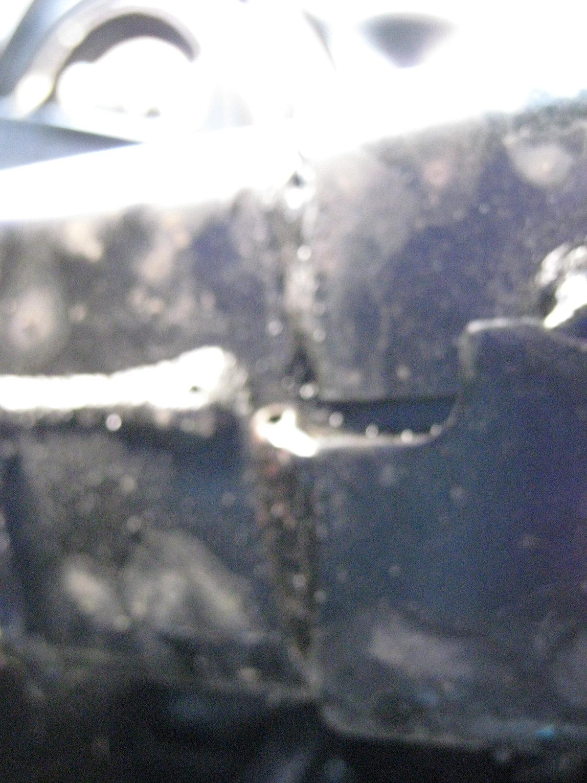

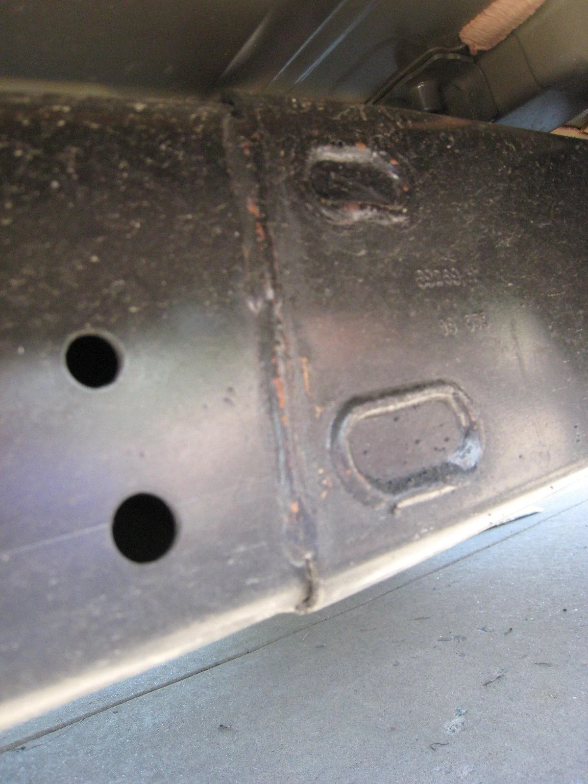

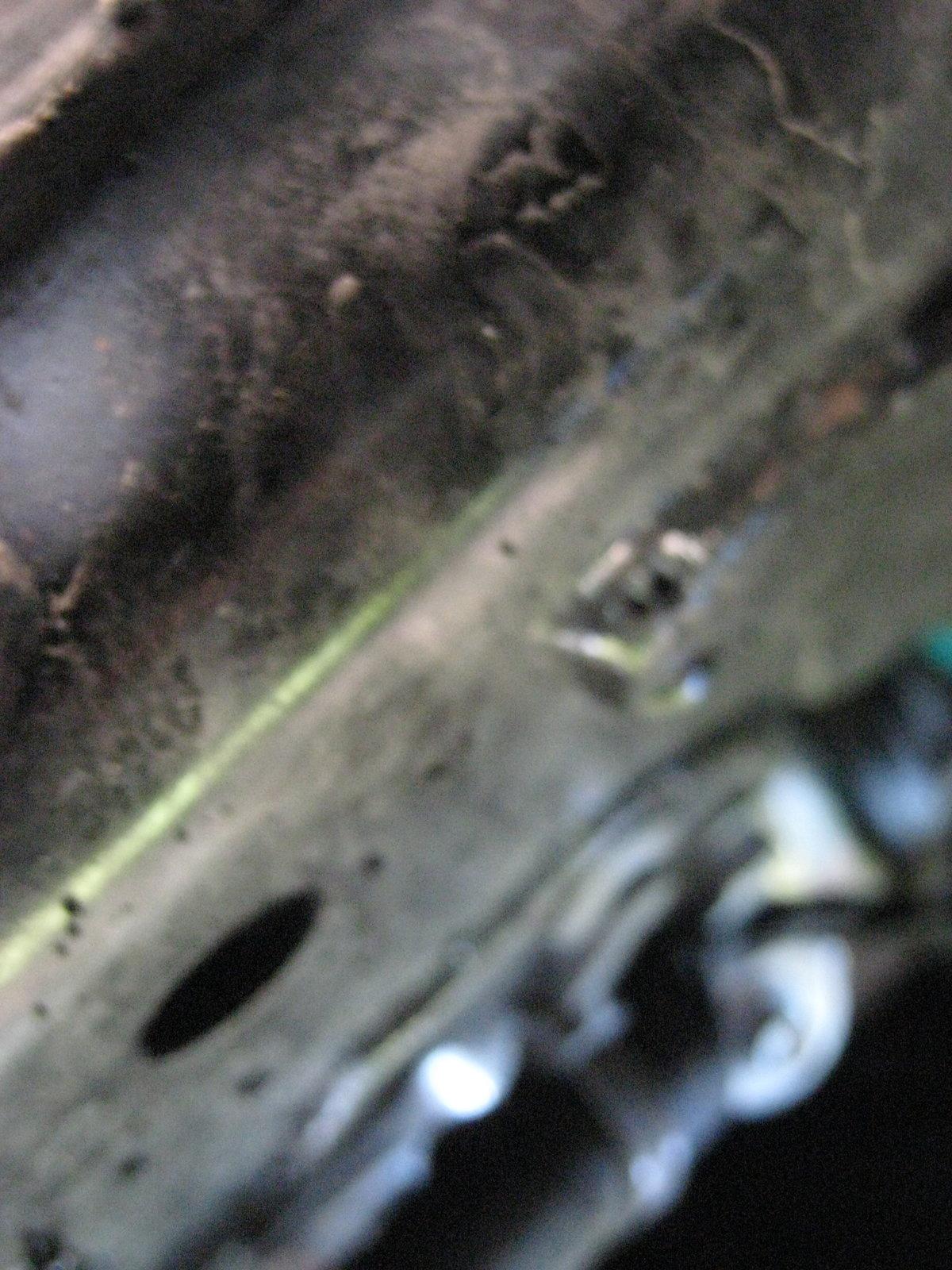

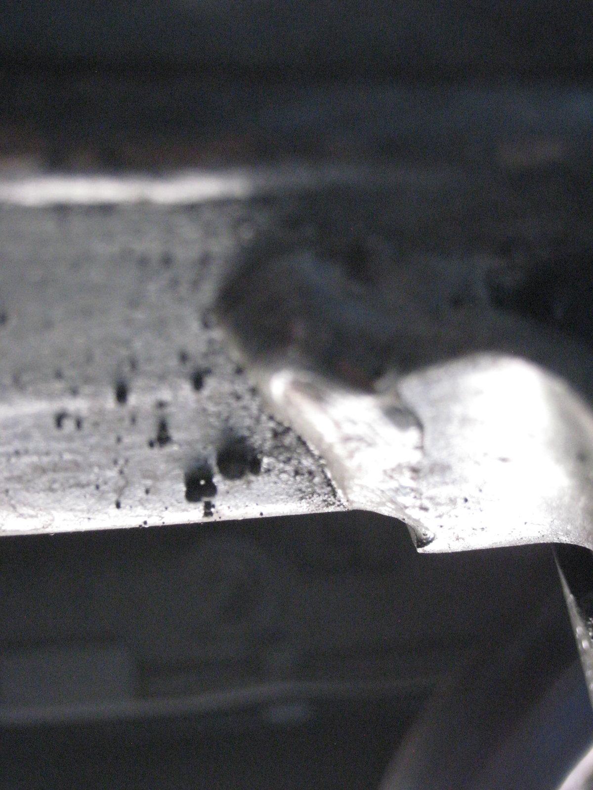

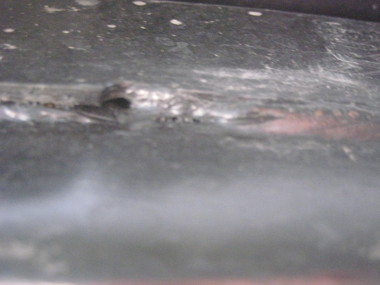

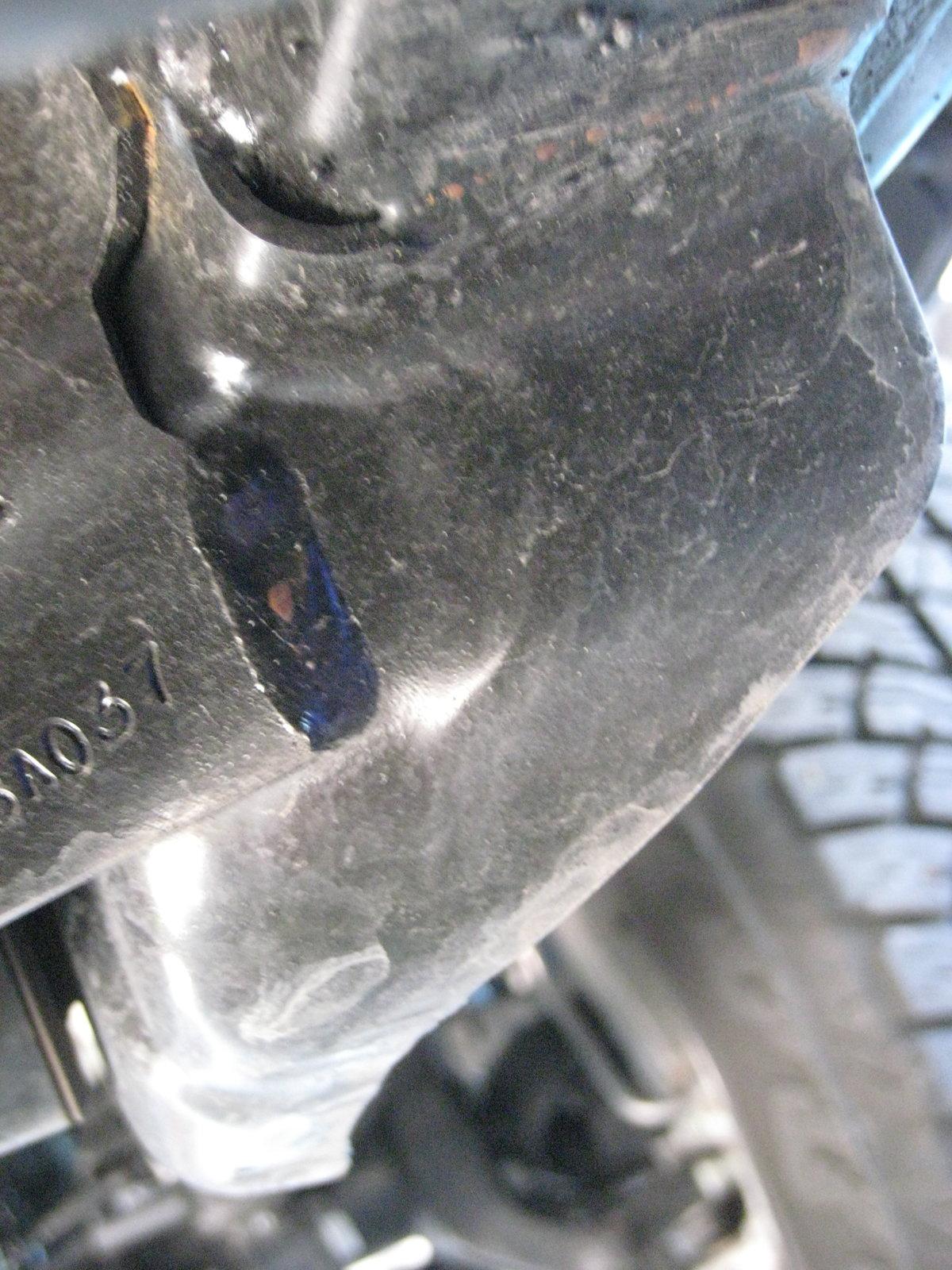

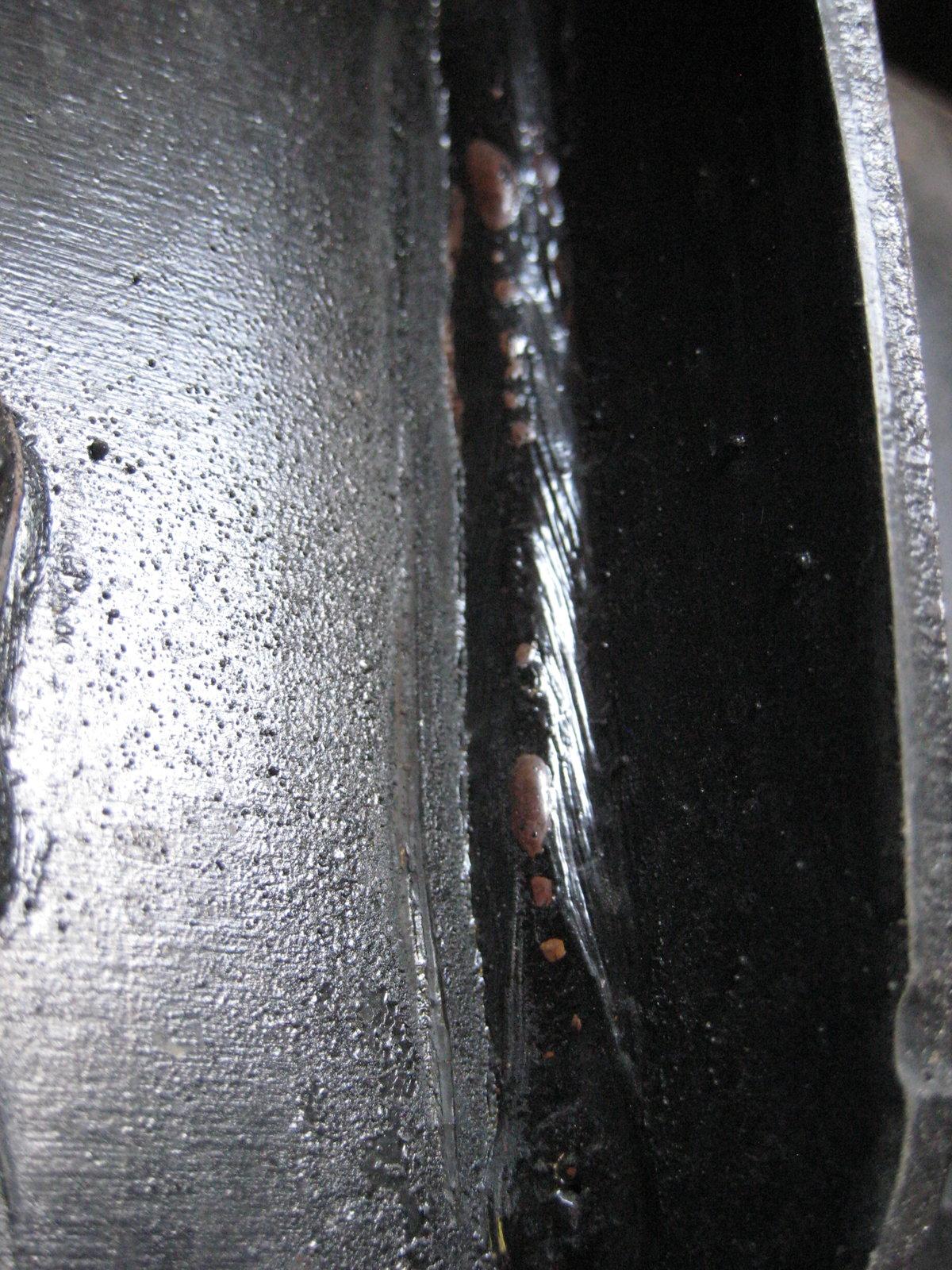

Pics of my welds. These wouldn't have passed my 9th grade welding class let alone should be on a On road vehicle. Sorry about some of the pic quality...my camera is garbage. This is only maybe a 3rd of the welds that had slag and missing paint on them. So we have porosity, slag, lack of penetration, incomplete welds, wandering welds, and a shit ton of weld splash. Not pictured were all the weld drips/overweld
Overall I'd say 85% of my welds have slag on them and are missing paint. A lot of porosity too. Some of the others who have posted have welds worse than mine. Left side seemed worse than the right...especially under the doors. I sent Jeep Cares over 150 pics and they blew it off. at the time of these pics this jeep had seen colorado rain 3 times and had about 1k miles on it.
