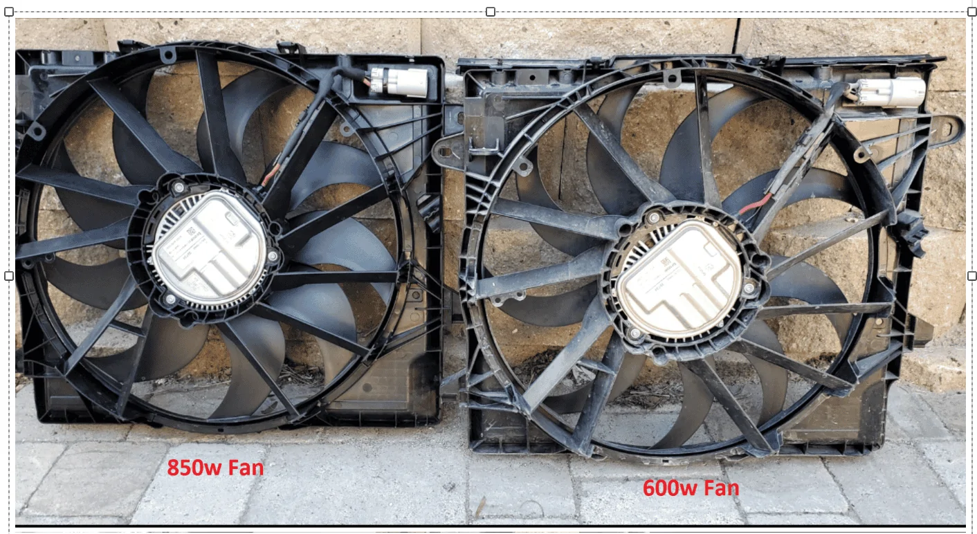

So I have a 2023 JL unlimited on 37’s running 513 gears. So the temp gauge on the gauge cluster never moves no matter what, but the off road gauges on the radio show my temp running 220-235 at times, and same with the oil temp. It’s out of warranty, but Reguardless I feel like replacing the radiator with an upgraded 4 core radiator and possible an oil cooler. Has anyone else had these kind of issues and what are some fixes?
On Gladiators that have Tow Package, it is equipped with 850W heavy duty fan and 240A alternator. The regular duty fan is 600W. You might consider upgrading the fan, I think the JL would be compatible with the 800W fan if yours has a 240A alternator.
Check the fitment though.
https://store.mopar.com/oem-parts/mopar-radiator-cooling-fan-module-68272755ad
They also have a 940 watt fan witch I have on my 2020 Willys put it WILL NOT keep your temperature from rising to 231 degrees or higher.
The thermostat starts to open at 190 and is fully open at about 212 degrees.
Like I said the fan comes on at 15% fan speed at 221 and 75% fan speed at 231 degrees.
On my Willys I installed the RPM Extreme JL fan controller and have only seen a max temp of 212.
On my Rubicon I did install the 850 watt fan and 240 amp alternator and saw NO reduction in temps. I will be installing the RPM Extreme JL fan controller on my Rubicon soon.

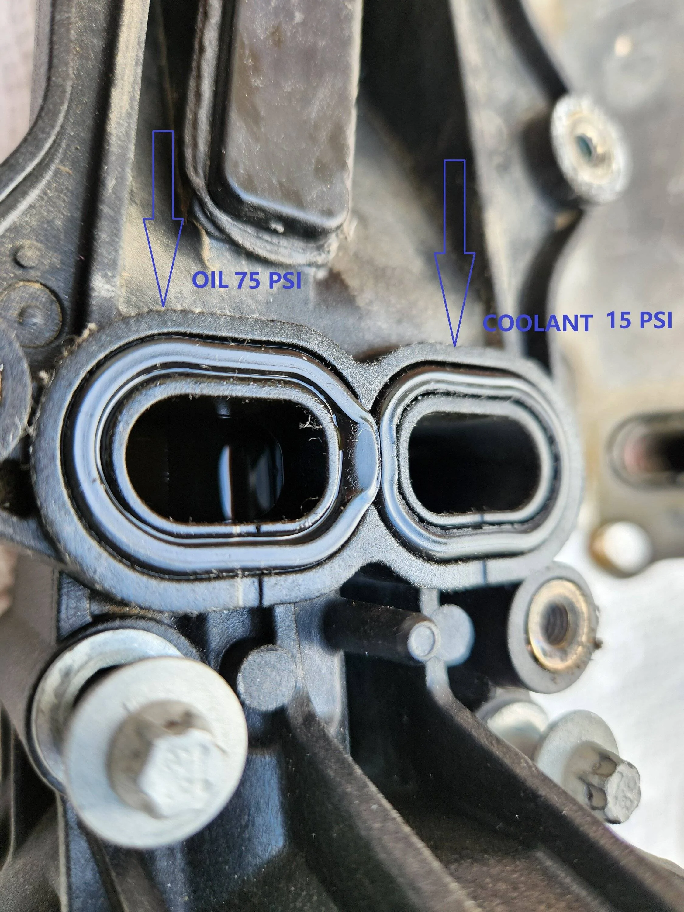

For all that believe Jeep's engineers are infallible.
Here you go. 33,000 miles, never raced or wrecked. Oil changed well before the OLM and with oil much better than specified by the engineers, driven mostly conservatively by a little old man.
Who puts an oil port adjacent to a coolant port with a siamese seal and no separation? FCA engineering at it's finest.
That photo is pretty convincing. The difference in pressure, no support on the lip of the o-ring where they meet.
This is why I am doing all I can do to keep the OC and those seals in good shape, using good oil with additives to protect the seals, and I keep the oil temp in the HUD and started running cooldown mode on the tazer anytime the oil temp hits 199 F. If I am coming up to large grade on the highway, loaded down with extra weight, I will "pre-cool" the engine for about 8 mins before the climb and the last time I didn't event break 200 F.
It seems like if coolant is getting into the oil then it's even more important to control heat, and improve the viscosity the engine sees if it's being diluted/contaminated. Also, if the oil is contaminated, even more important to drain every last drop of old oil out. I use ramps and end up draining 5.5 qts for 3l.

Also makes a case for less spirited driving to keep the second stage of the oil pump from kicking in.
I like to downshift so may quit doing that, as well let up on the throttle a little....
But on the other hand.... thinking as I am typing this, if the pressure is higher on the oil side, I would think that would prevent the coolant from coming in. If those pressures were reversed then there might be more cause for concern.
@roaniecowpony the more I think on this, how would coolant seep into the oil side if the pressure is 2 to 5 times higher on the oil side? If anything, there seems there would be more of a case for oil getting into the coolant side and not vice versa??
When the engine is running, the oil pressure is clearly higher than the coolant system pressure. That's why my seals are pushed from the oil port toward the coolant port. Almost immediately upon shutdown, the oil pressure goes to zero. But the coolant pressure remains at operating pressure until the system begins to cool and the system contents contract. During that post shutdown period, but before coolant pressure is zero, it will seep through the compromised seal. That's why I found oil in the coolant and coolant in the oil.
O.K. How did you discover this? Did you notice oil in the coolant first? Or UOA?
You alluded to retooling the factory OC, is Stelantis changing the design?
EDIT: just saw your post
https://www.jlwranglerforums.com/fo...oil-filter-housing.121070/page-2#post-2633192
Did you swap yours out preventatively, or have a problem first?

UOA showed a ton of coolant constituent (potassium).
They changed the design sometime recently. Maybe the last year or so. I don't have a timeline. But they went from the single siamese figure 8 seal to the separated oval seals, where they added the web between them.

My recommendation is to change your oil filter adapter/cooler and do a UOA at every OCI.
