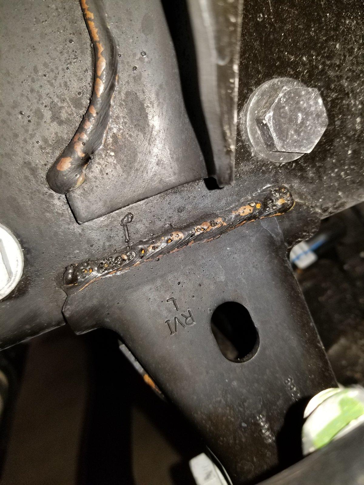

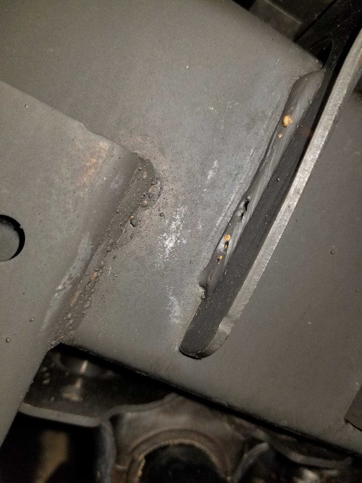

I fear my track bar bracket is about to go at any time. Porocity is horrid, welds tracks just on top of the bracket end with little overlap on the top of the bracket, large amounts of bubbles throughout, and the end of the weld tracks completely off of the bracket.
The underside of the track bar bracket welds are barely any better, with one end starting off thick with a more rounded glob of weld and then ending with a thin weld that barely has coverage and is at about 1/3rd the thickness of the start of the weld. Undercut welds also present that you can hook a fingernail into.
I have an appt on Tues with the dealership for the steering issue (loose steering and too much play) and will talk to them extensively about the welds on these crucial suspension and steering parts such as the track bar. If there is no resolution, then I have a tentative appt later in the week to talk with a lemon law attorney who has given me the number of their mechanical engineers who will inspect the frame and provide a written and signed statement of their findings for the dealership and FCA.
Hoping that since I've only put about 425 miles on this Jeep and it's a lease that they will just swap it out for a newer build. Will update when I know more. Thanks!

NCJeepn73 do you know when your unit was built?

I would hope so. I got under the Jeep again today to inspect more parts of the frame. It'll definitely help having it up on a lift at the dealership. The track bars look to be the worst welds. The driver's side also looks to be worse than the passenger side.
Just sucks because Wranglers are supposed to he built better than this. Definitely doesn't appear the early '18s are up to par by any means.
