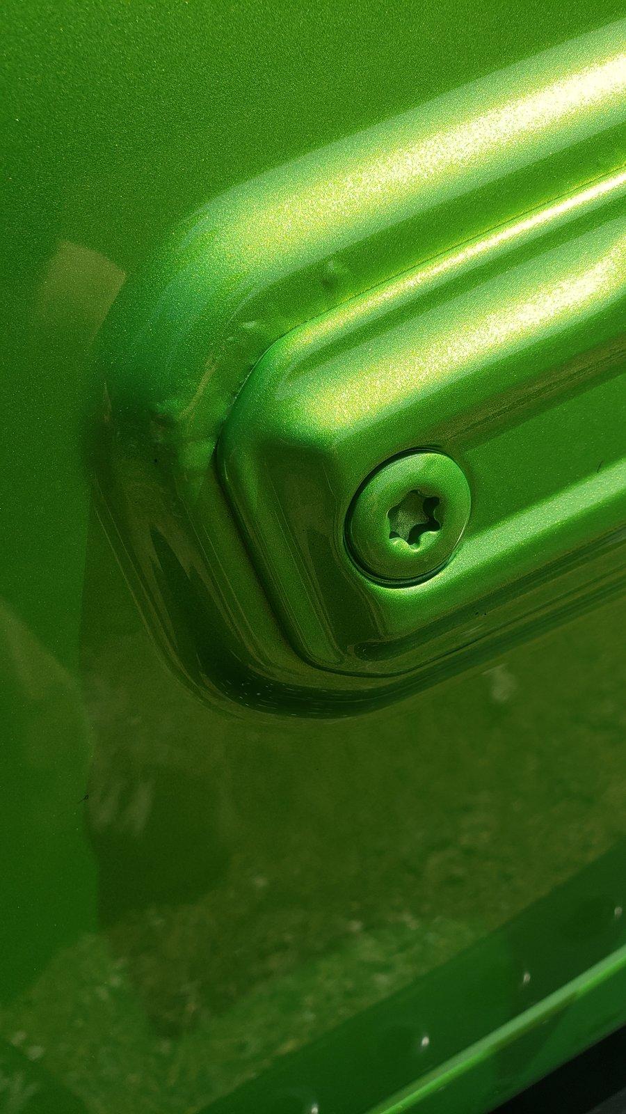

The problem is aluminum won't stop corroding if exposed to oxygen or water. It will spread wherever if can get air and as the corrosion bubbles it peels the paint from more aluminum letting the problem spread.Yes the doors are aluminum. That is corrosion building up behind the paint.
Not magnetic so seems to be aluminum? The only steel I found were the bolts.The JL press kit states aluminum doors and hinges. Not sure if this means the door skin is aluminum or steel skins with aluminum inner structure.
