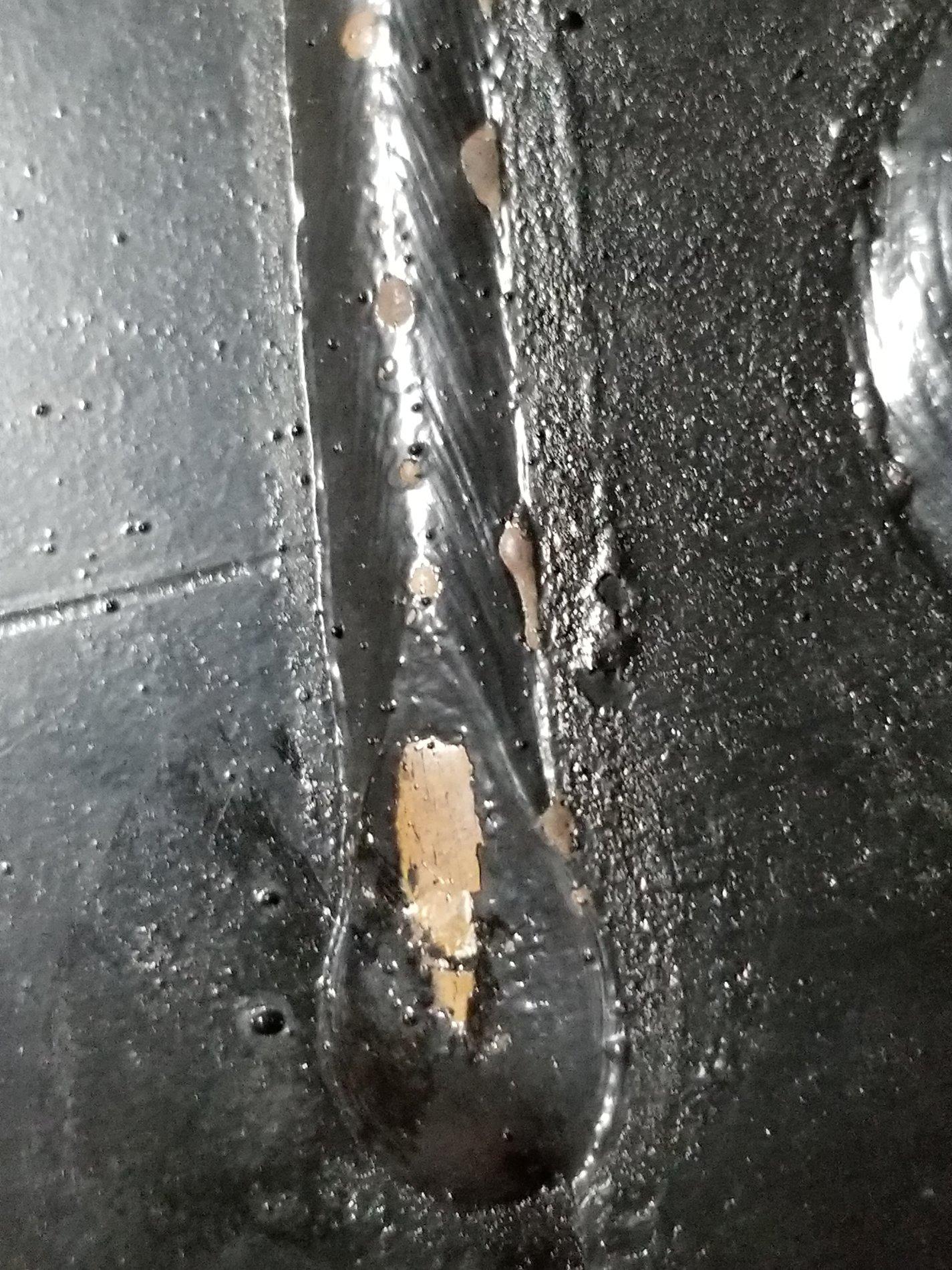

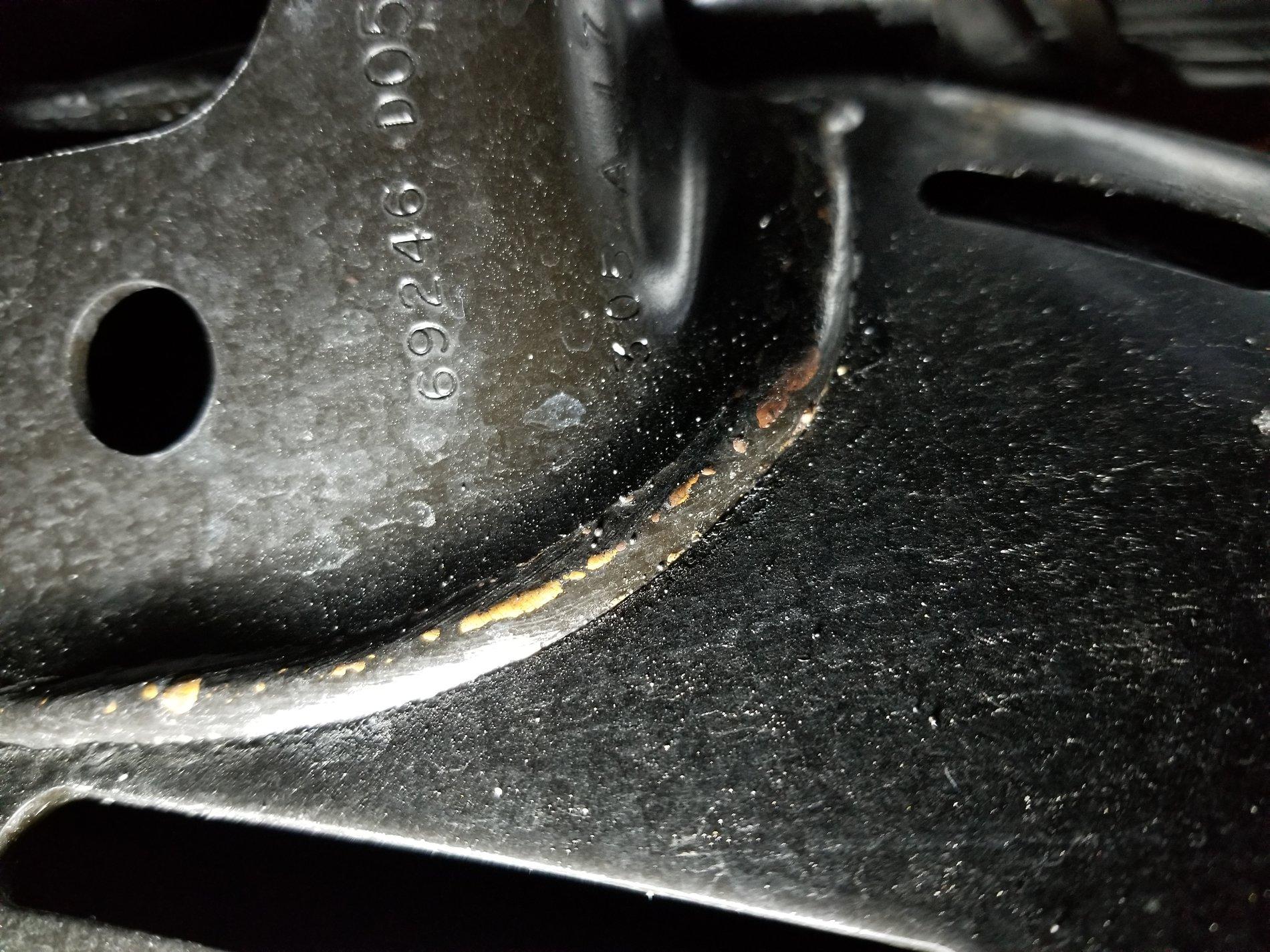

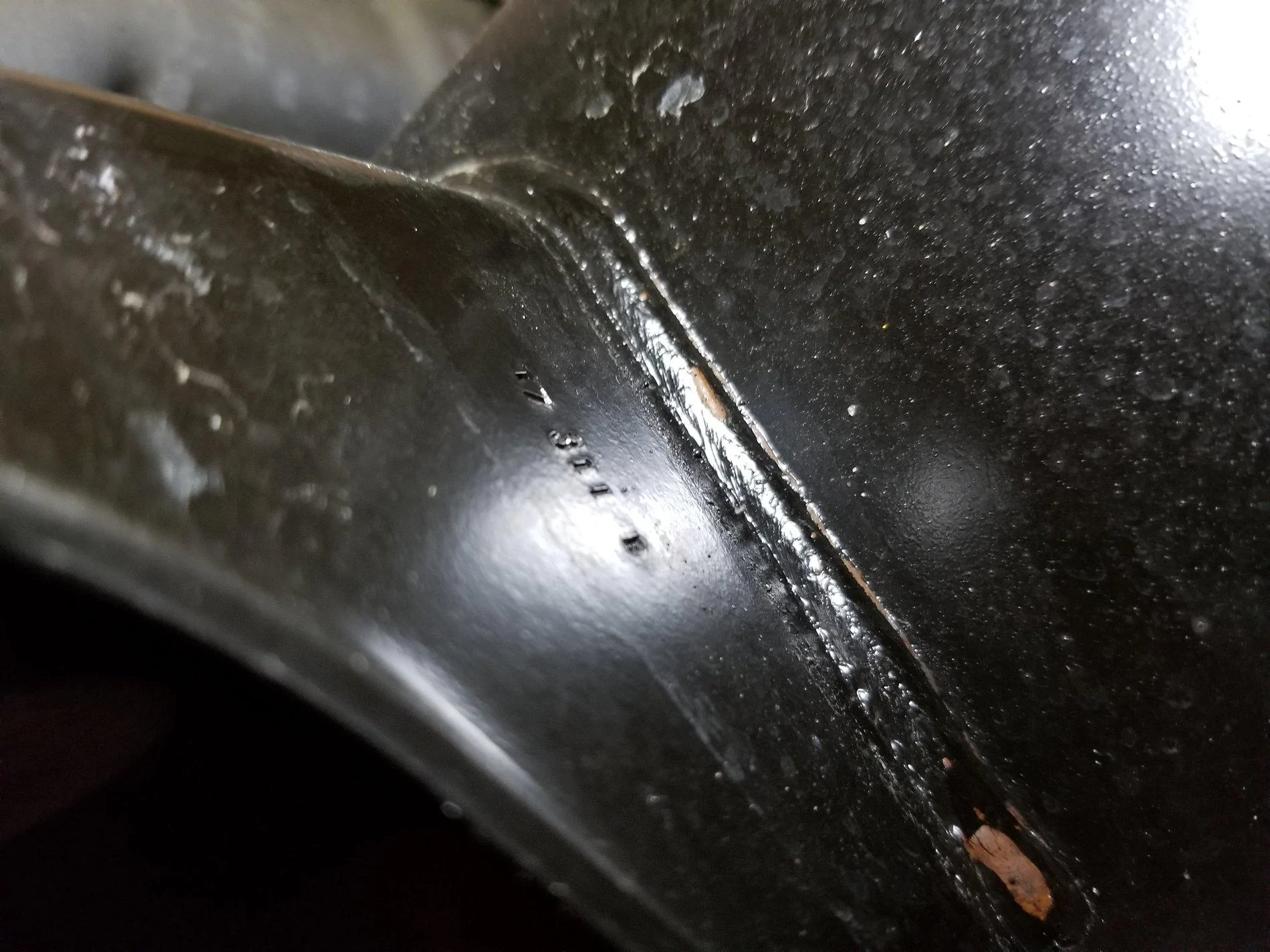

Heres a pic from me. Fahhhkkk I was hoping to look under there and not find anything. This was the only one "of concern" though.
Hey Darylkeys,
Where exactly was that rusted weld?

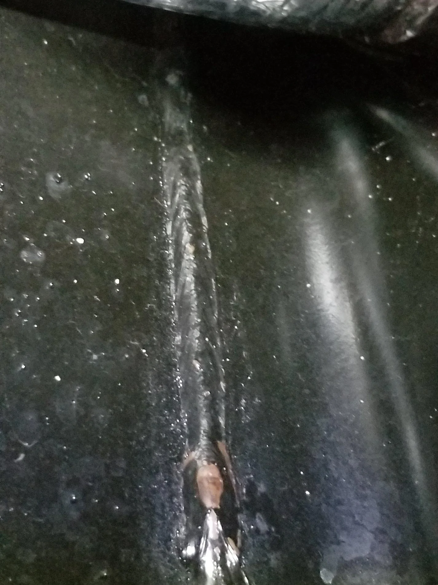

I just took a look under my JL Sport. Lots of rust spots on the welds. Also several places the robot missed a seam altogether. It's not slag in the pictures posted. While I've not been to the Wrangler plant, I'd bet a lot of money the robots use shielded gas welding (GMAW) which doesn't produce slag.
You will still have silicon slag from the GMAW process. Plus this frame is 80% galvanized, so those impurities are coming to the surface during welding.

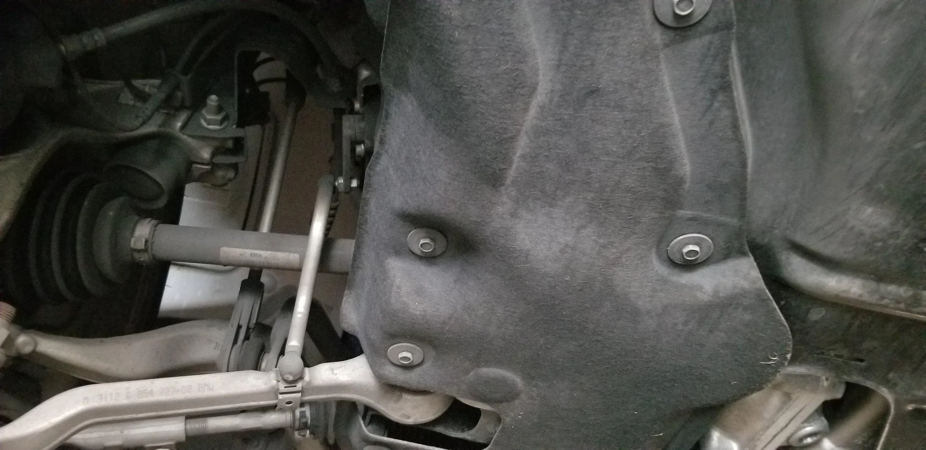

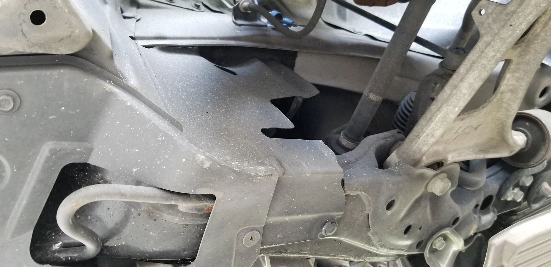

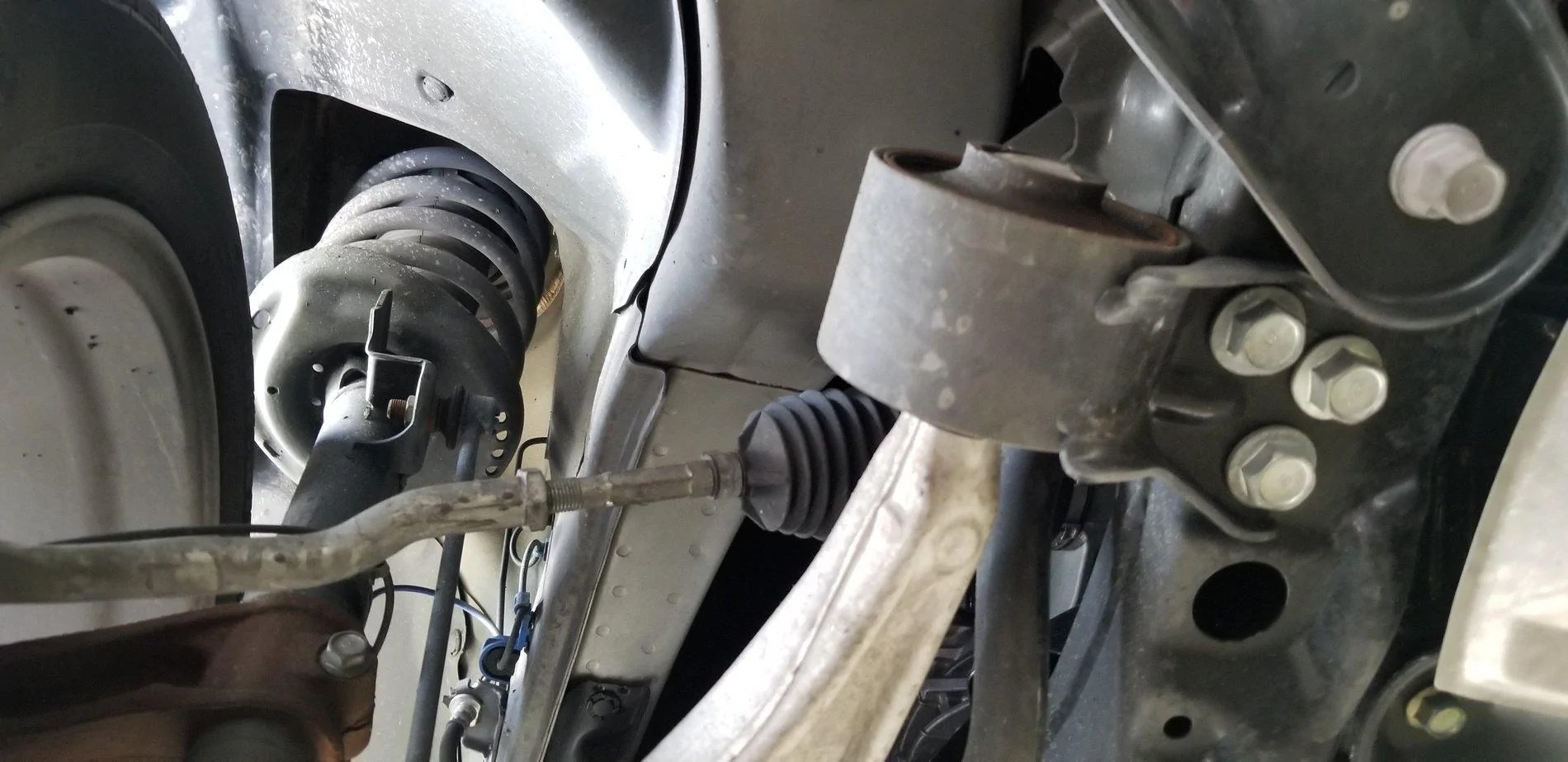

I know very little about welding, but I have gone through many posts about the weld and rust issues. Some of the member seem to suggest that rust is normal, and it's not unusual to see them on new car. It's just that Jeep rusts are more visible because of the ride height. So, I jack up 2 of my current cars and took a few pictures. Let me know what you think.
1 car is a 2016 BMW 235i xDrive which I had for 1.5yrs, the 2nd car is a 2017 Acura MDX which My wife has been driven for a little more than a year. I live in Pacific NW (Seattle), both cars are driven all year long, but the BMW is parked in the garage.
What do you think?

Jeepcity
Ron
Feb 13, 2018
90
120
BC
jl rubicon tj rubicon yj cj 8 cj 7 cherokee
check the difference in tie rod and sway bar links, compared to jl . and report back .

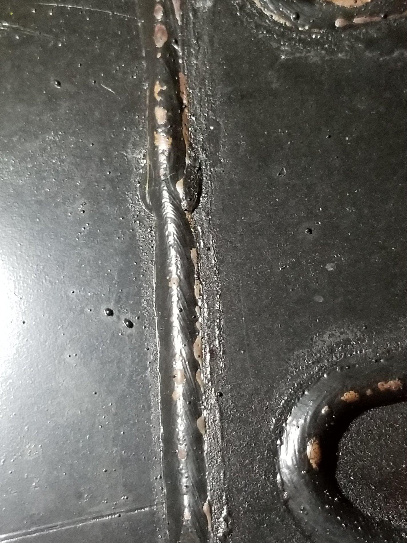

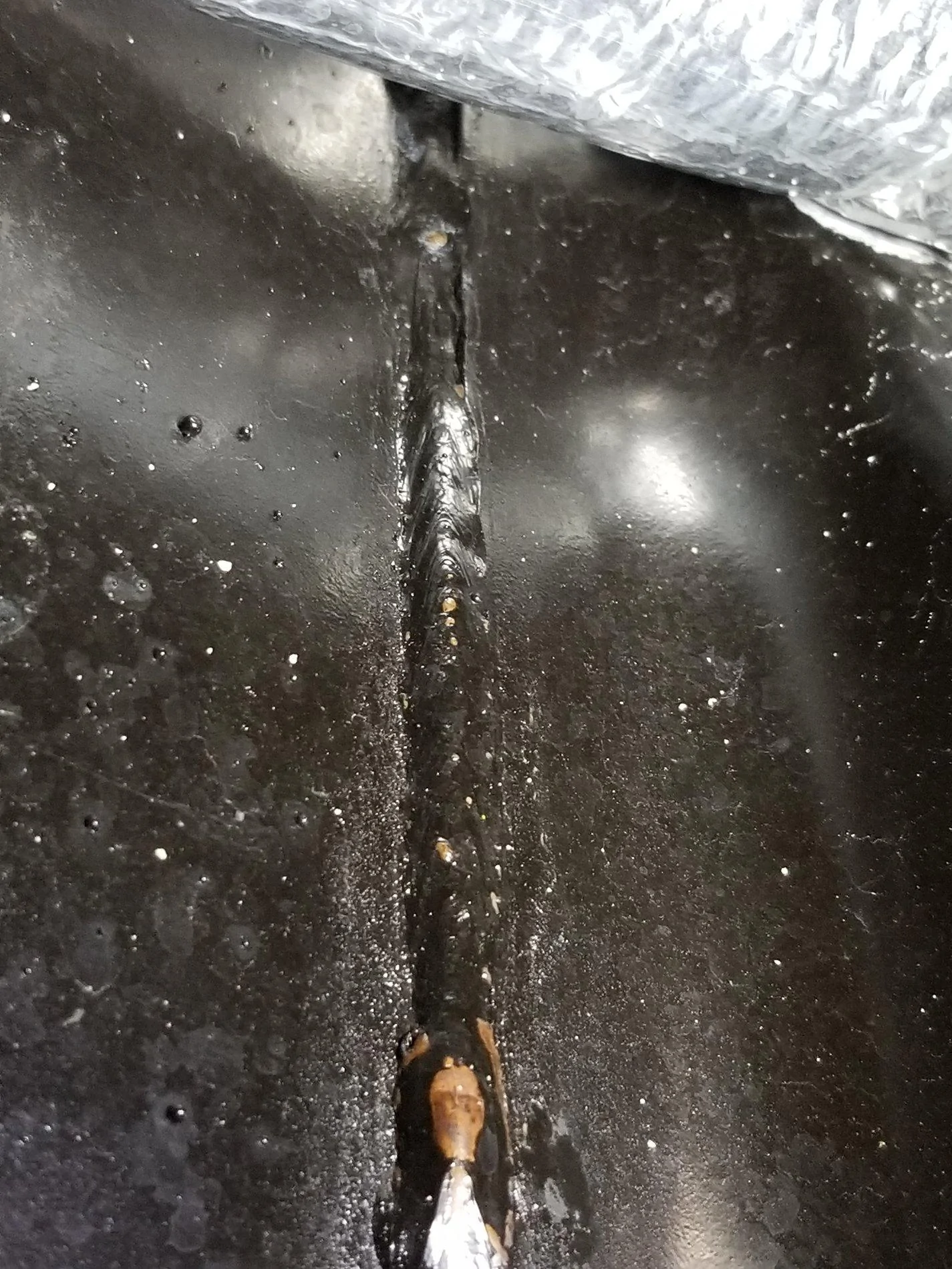

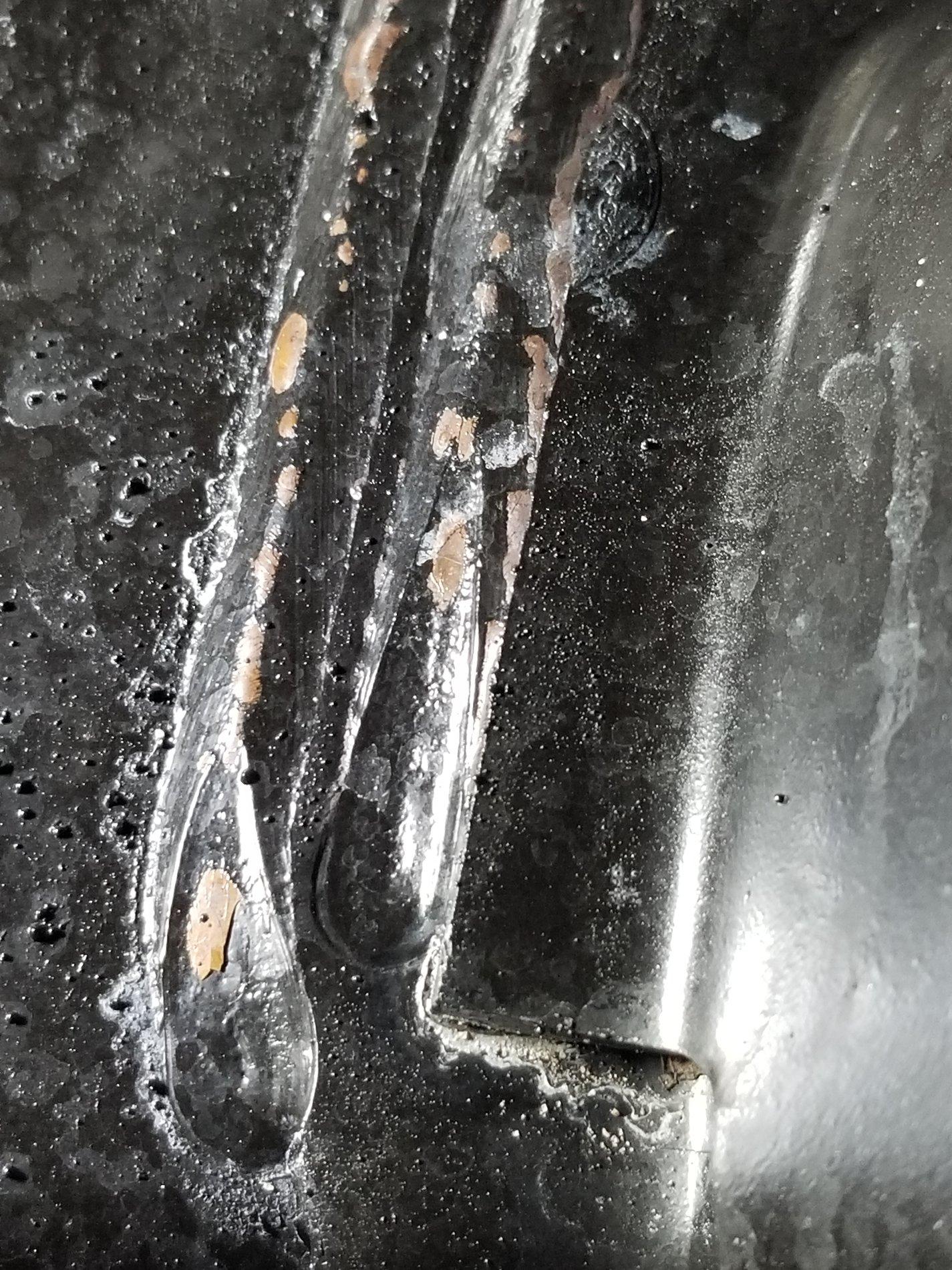

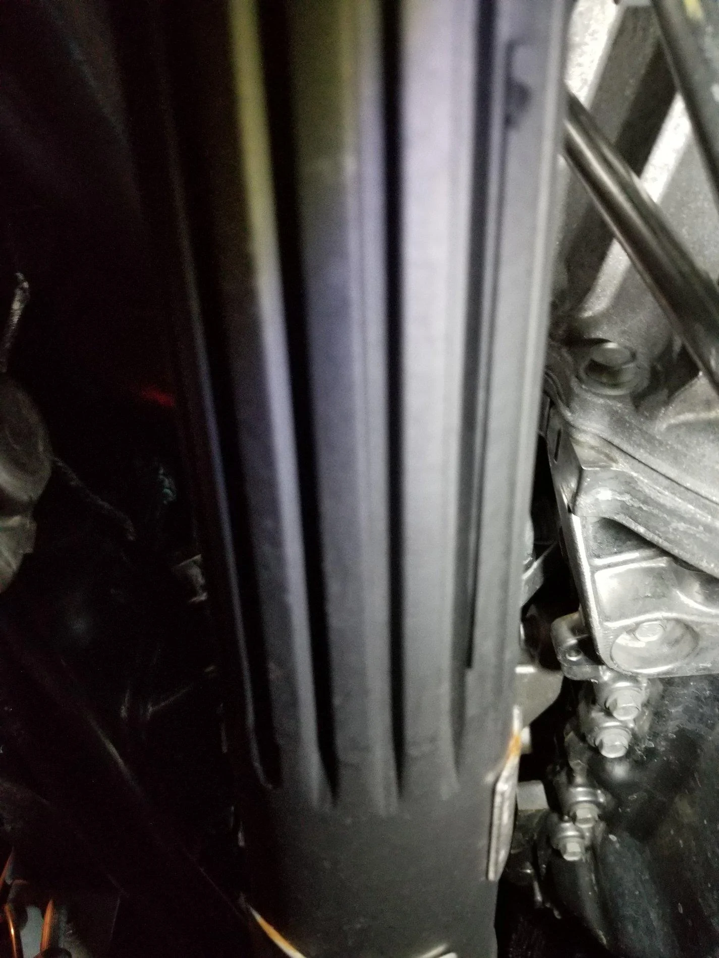

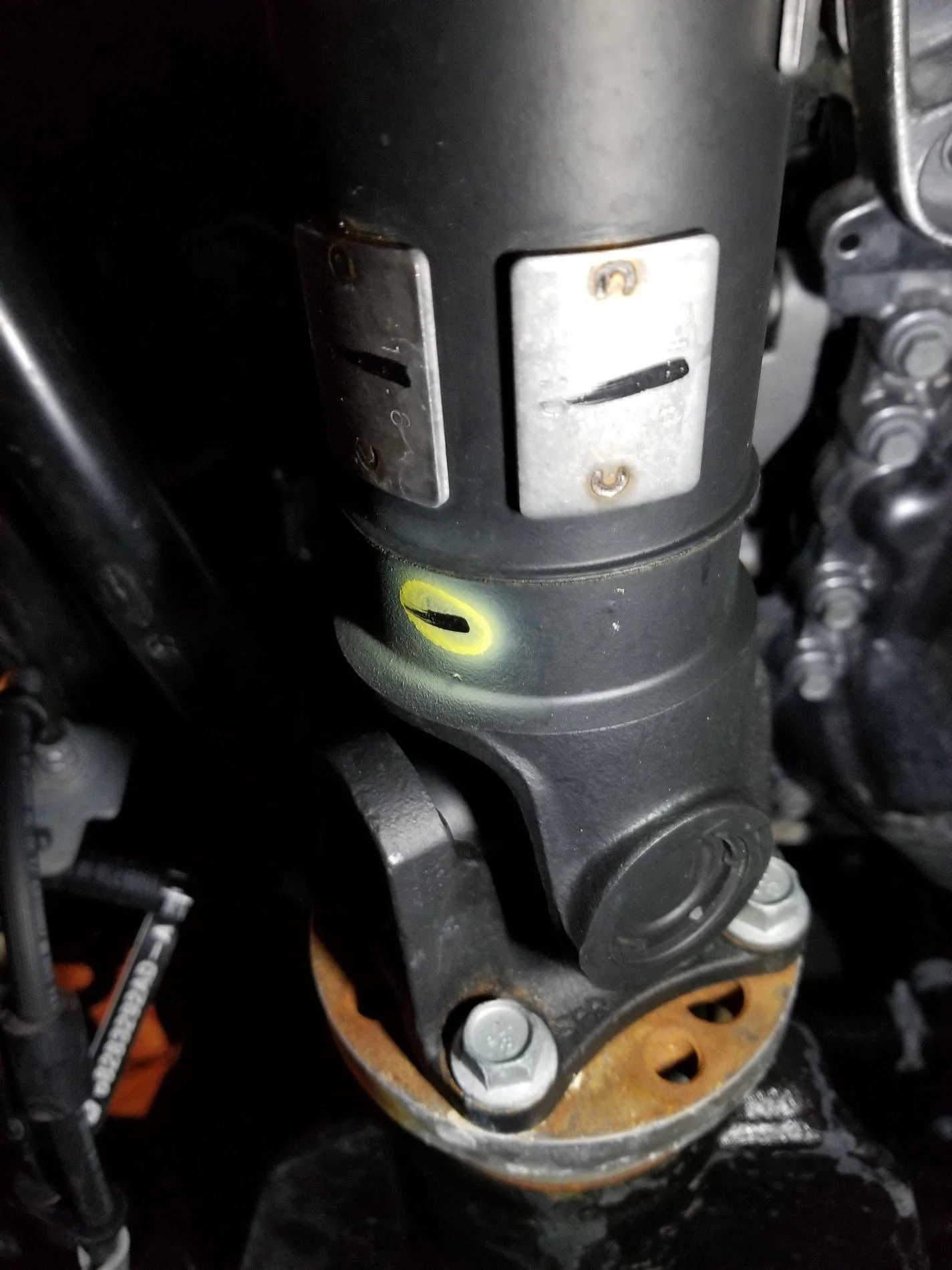

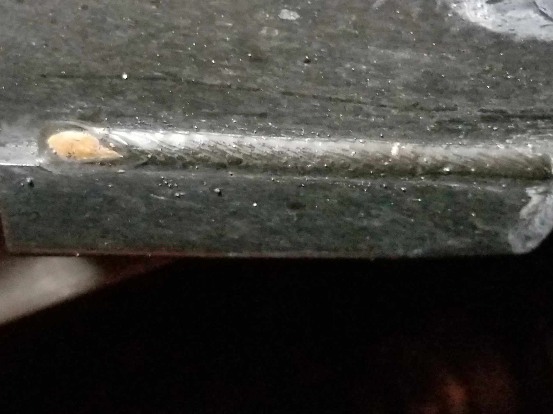

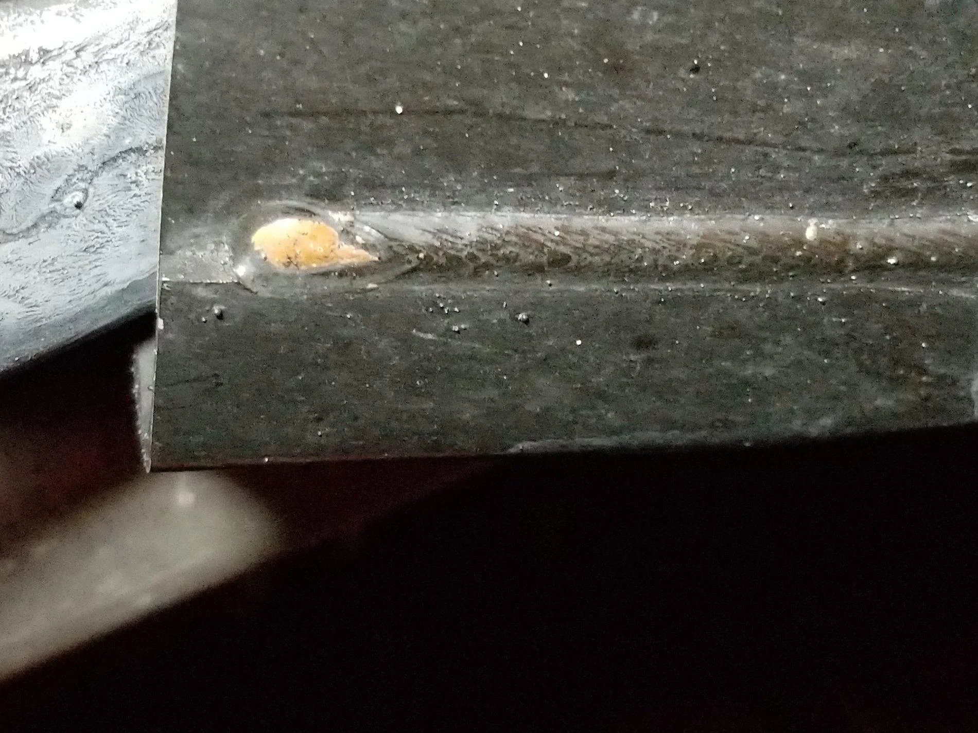

Ok I know nothing about welds! I just inspect "Ruby's" belly. I took a bunch of pics. For starters, I picked her up on Jan 17. (Ordered Nov 7, I think). Im in the Northeast and its rained or snowed a few times a week ,since the day I picked it up. Weather has straight up sucked!!!! Anyway before you look at these pics, know this, the brown on the welds IS NOT RUST! (on this Jeep) I know nothing about welds, as Ive said, but I do know rust. It looks like a brown paint or something or maybe something related to welding, I don't know but I can assure you this brown stuff is not rust. Nothing jumped out as horrible to me, I took a few other pics to while I was under her. (she was a little shy) lol. Anyway, check it out......
i have the same exact brown welds on my JLUR.

No major rust just some small spots. A very light sand and touch up with some BBQ Grill paint stuff is tough.

Capt-Zoom
Capt-Zoom
May 27, 2018
39
825
589
North
2019 JL sport s, 4door. 1999 TJ Sport

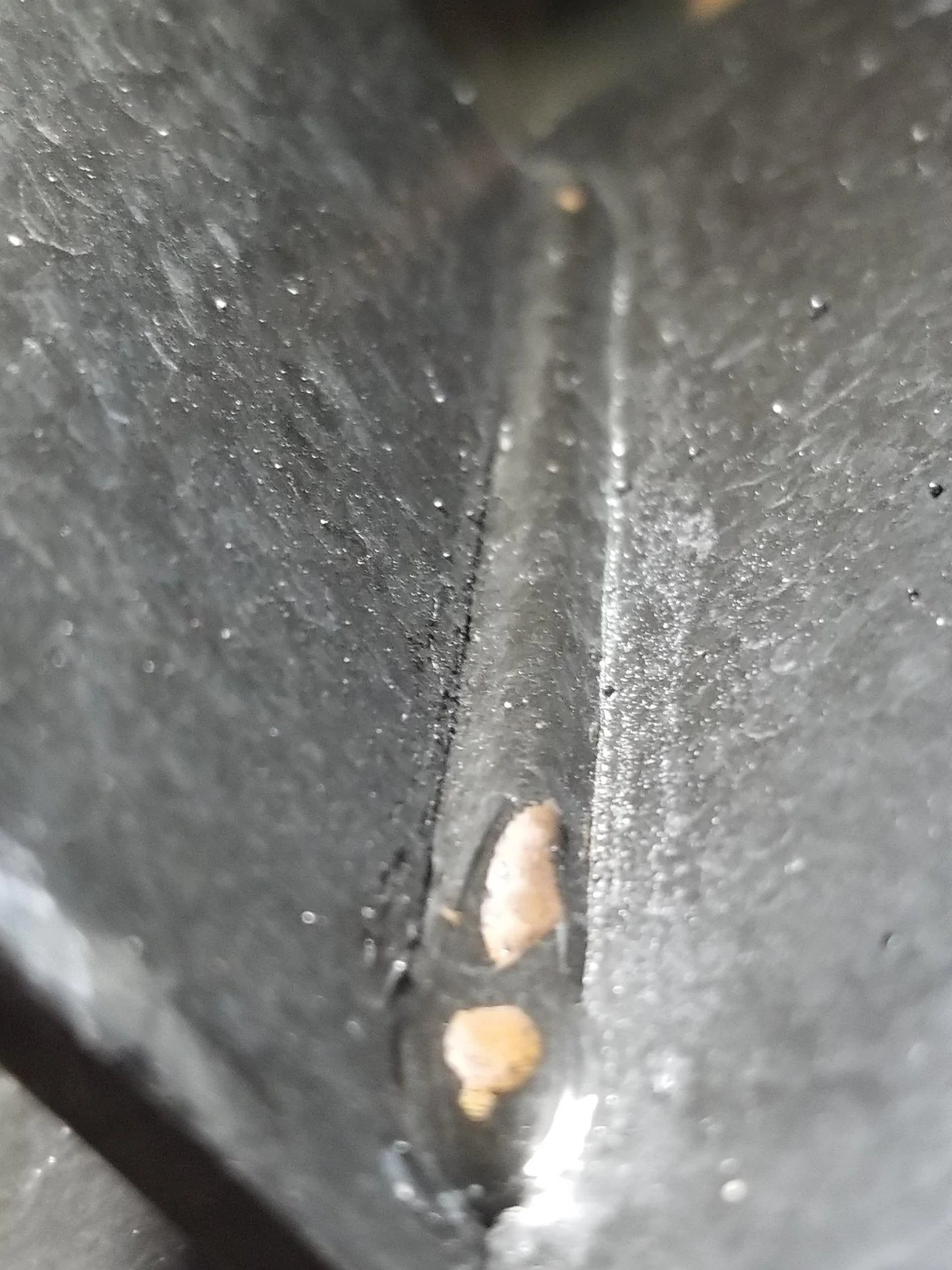

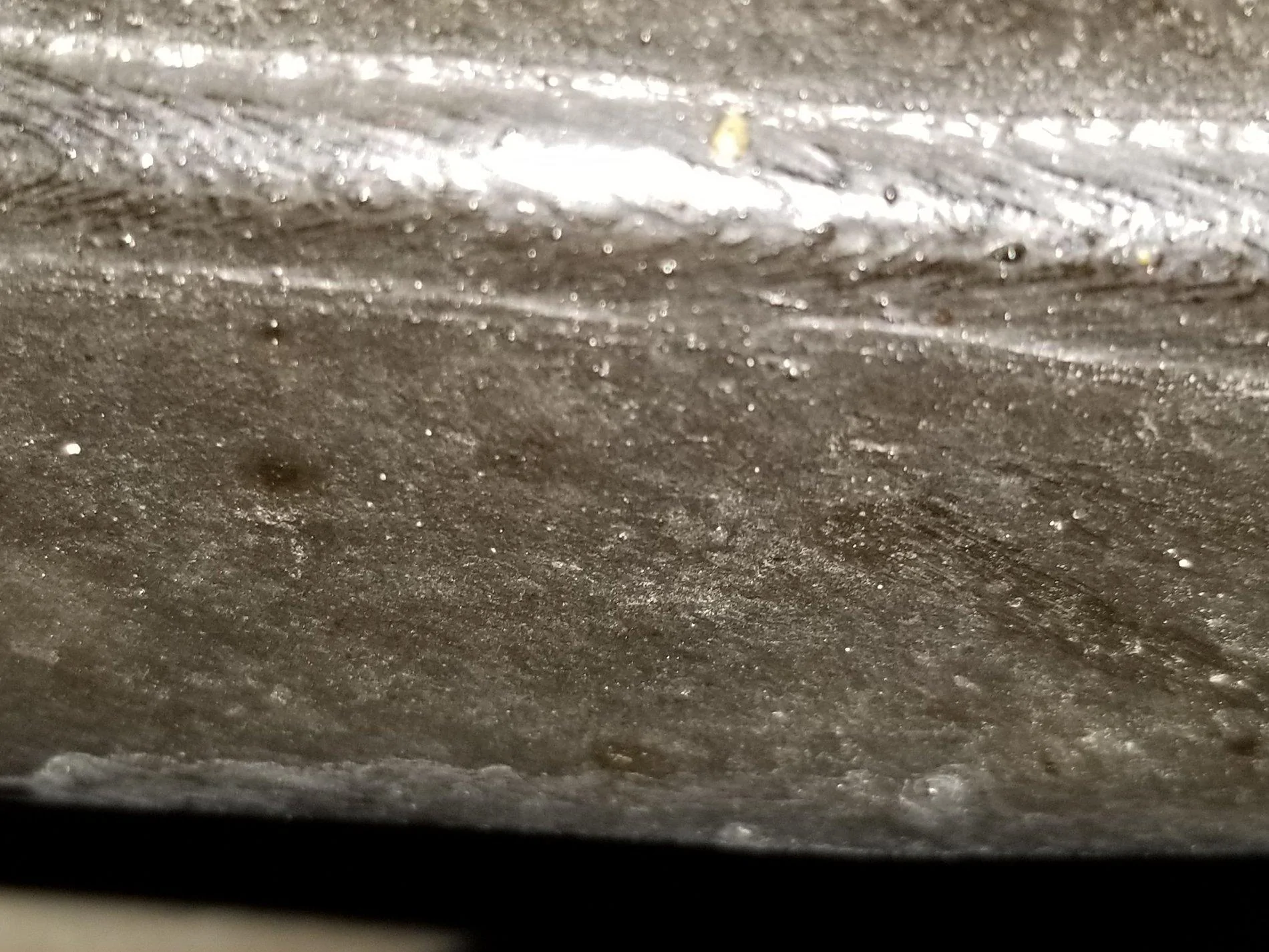

Feb 12 2018 build date. At the dealer at the moment. Dealer brought in some a hole from district who seems to think the following is ok and normal.
Slag on 85 percent of the welds
Overweld...big pools and weld wire left on frame
Porous welds..at least a dozen mabe 2 dozen
Track bar bracket is only half welded...looks like it wandered on the weld
Weld splash all over the place.
Dealer is trying to call their district head
I will be calling jeep cares later today.
I build custom motorcycles in my spare time and would never allow welds like this on one of my bikes.
