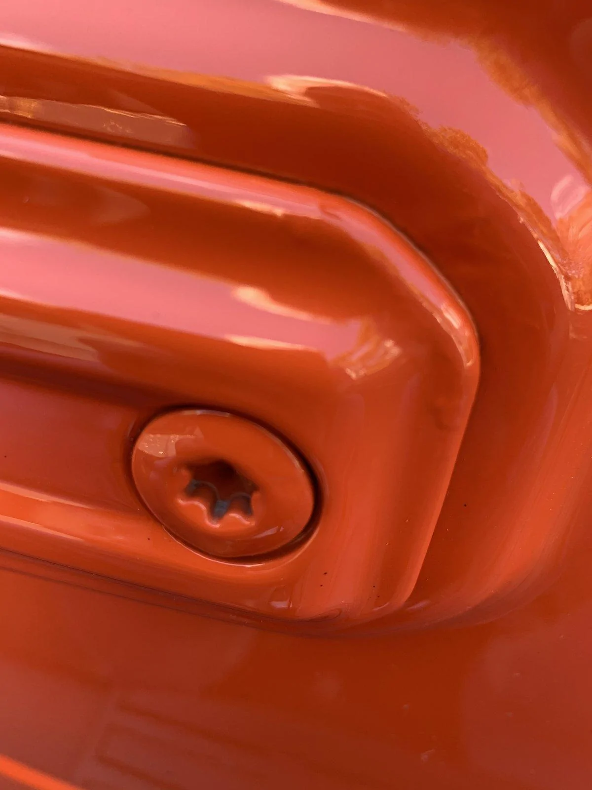

Just noticed this on two of my 2018 Punkin Sport’s hinges. I only have 3600 miles on it and it’s garaged at all times I’m not driving it. Not happy.

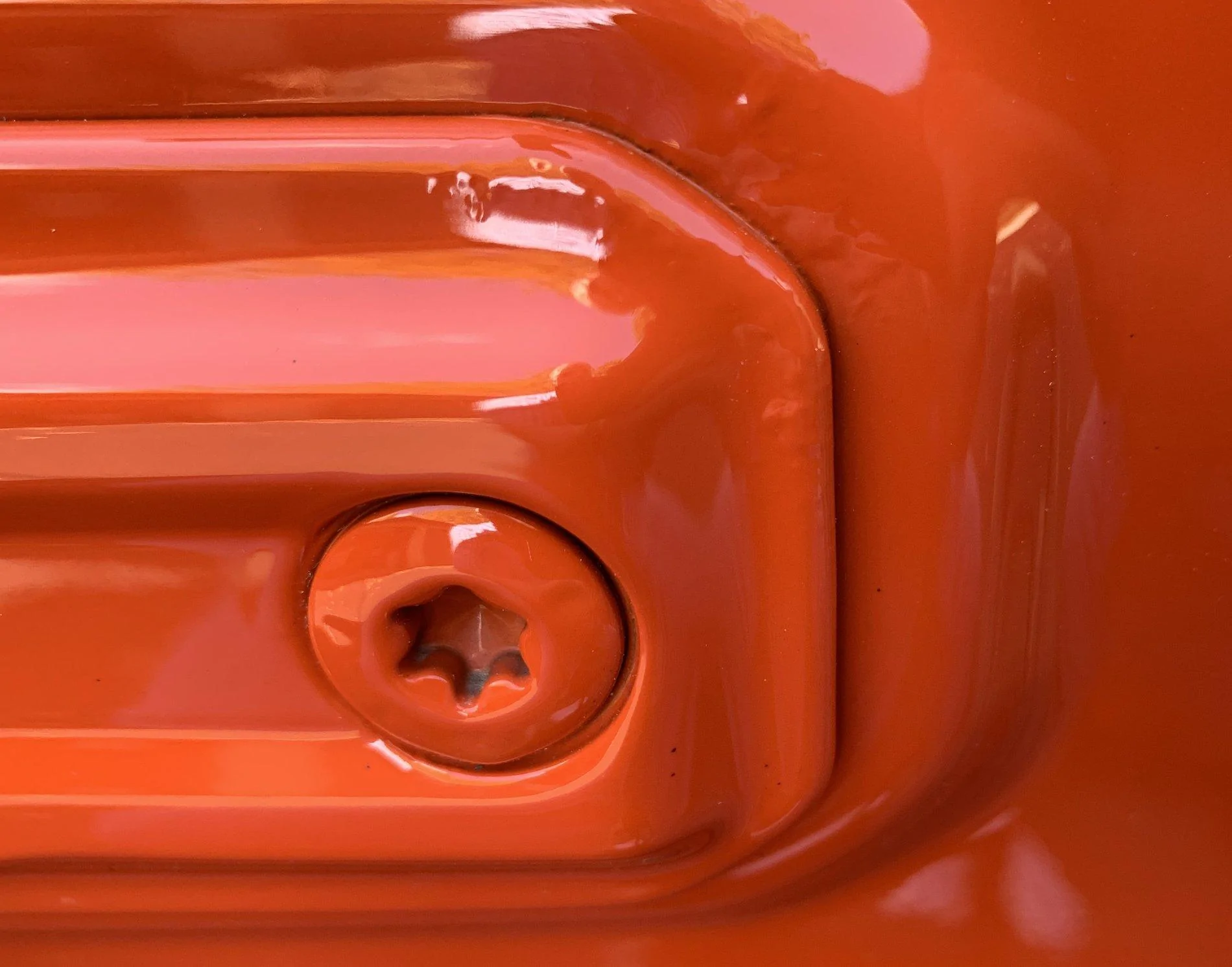

This same thing is happening to the area around my hinges! I bought my jeep in August 2018 and first noticed the rust/oxidation in May 2019. The dealership refused to fix it and told me it's just a paint imperfection. However this imperfection on the driver's door is growing and now I noticed it starting on the passenger door. How did you get them to fix yours?? Did they repaint your door (i.e. destroy the factory paint) or give you a new door?
Going in today for the same issue !!! I already heard from the dealer they may just paint the door but that doesn't fix the problem !!! May start a class action suit against FCA about this issue i spent close to 75000 on this brand new jeep 2018 and 2 years later it is rusting. Il keep everyone posted about the class action if it goes that way !

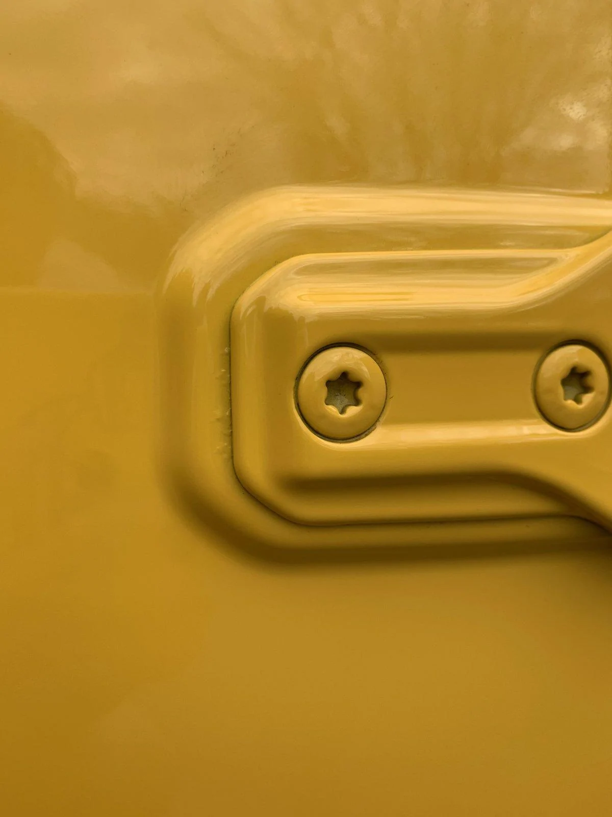

Just checked my 2019 and noticed this.
This is my third car and I never even take this out in the rain. It sits in my garage and I only use this when the weather is nice enough to put the top down.

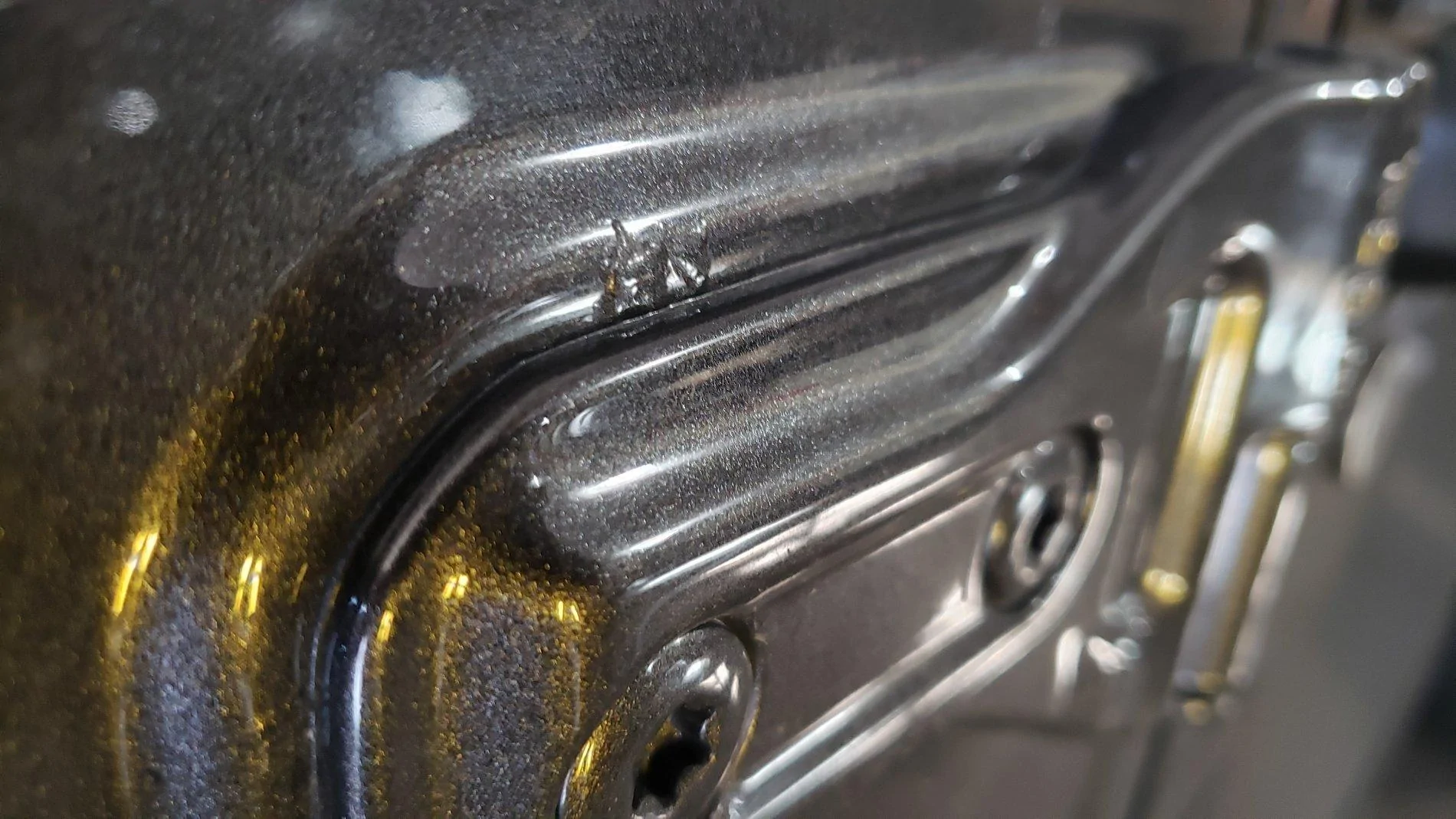

Adding my 2020 to the list. One of my favorite toys just became a problem.
