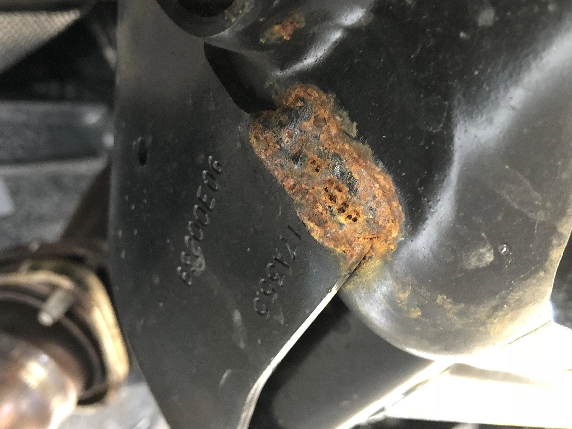

Heres a pic from me. Fahhhkkk I was hoping to look under there and not find anything. This was the only one "of concern" though.
Hey guys! Just an update. I went to dealership yesterday and got the Jeep up on the lift. While there is standard rust on the undercarriage, there was definitely concern with the weld I posted a photo of. At no charge, they will grind the weld down next week, re-weld it and seal it black. They were extremely helpful and I am ok with this solution after looking at the entire frame with my own eyes up on the lift. There did however seem to be some concern from the higher ups though about this potentially being a problem with many vehicles so who knows. Anyone else get good photos of issues like mine?
What?! No! We have to all cancel our orders to show FCA who’s boss! “They” haven’t notified “everyone” about this obvious flaw that they’ve known to have affected at least one person! :cwl:
Seriously, though, great news that your dealer is taking care of you, and thanks for sharing. This info will surely help the next guy!

I just took a look under my JL Sport. Lots of rust spots on the welds. Also several places the robot missed a seam altogether. It's not slag in the pictures posted. While I've not been to the Wrangler plant, I'd bet a lot of money the robots use shielded gas welding (GMAW) which doesn't produce slag.

Dhaummmm. That’s a horrible looking weld. Looks like a ball of old rusted steel wool instead of a weld.
Where exactly is that weld?
