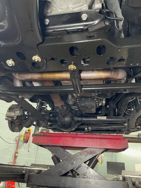

For comparison, here is the bottom of my daughter’s 2014 JK. Never been treated with anything but has lived most of its life in CA. Over 65k miles.

I mean, using a CA vehicle as comparison to almost any other region isn't fair, and I mean that in a good way. I have an 1987 honda crx that spent it's life in california and the underside looks this good, and those were made with thin crappy metal.

Gosh my 2013 JK didn’t look that good “NEW” back in 2013!

Yeah. I was pretty surprised when my mechanic sent me this pic.

Yeah, but a newly delivered vehicle should look at least as good. That’s why I offered as comparison for OP.
