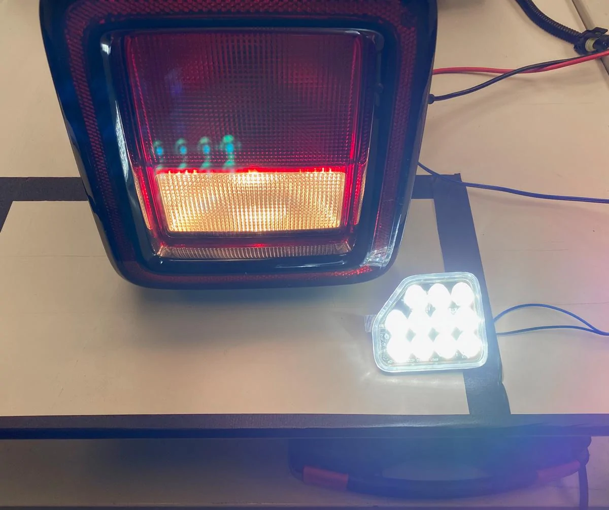

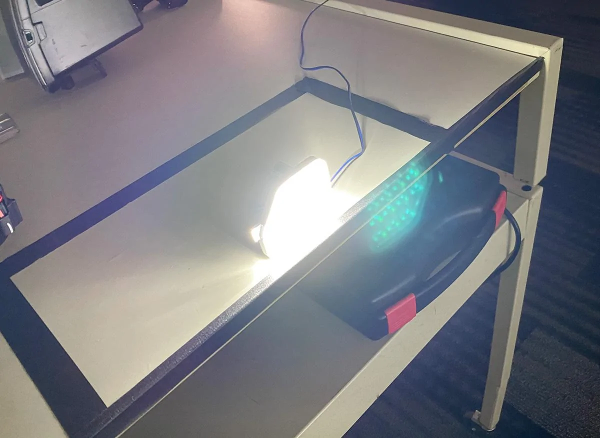

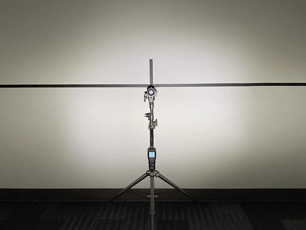

We completed some final testing on the lights today. This is a light tunnel we normally use for testing headlight output but it serves a purpose for testing reverse lights as well. The test was set up to measure Lux from 5' this is much shorter distance than we normally measure headlights but reverse lights have different optics which spread light in a wider pattern so this range gave best results for accurate readings. We tested the factory halogen reverse light, factory LED revere light, and the new LED bumper light.
Jeep Wrangler JL Rear Bumper Integrated LED Reverse Lights IMG_2175
Jeep Wrangler JL Rear Bumper Integrated LED Reverse Lights IMG_2159

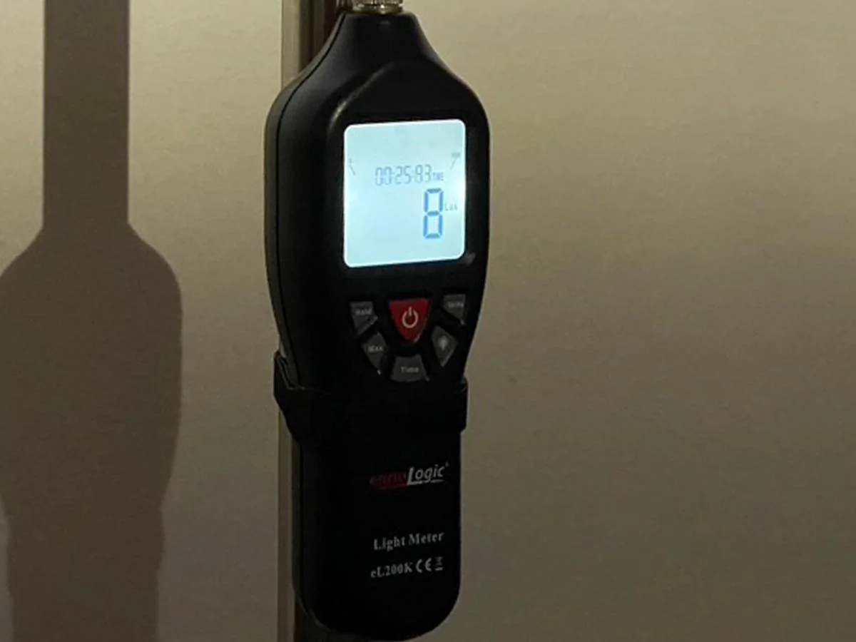

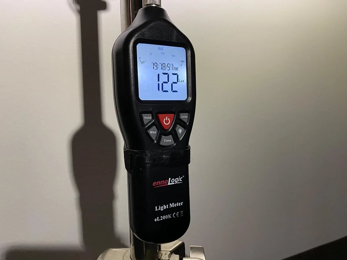

On the opposite wall we have a Lux meter set up to measure the brightness of each light. The Lux meter is set to Max to record the highest reading the and lamp is articulated back and forth then up and down to read the hottest part of the projection.
Jeep Wrangler JL Rear Bumper Integrated LED Reverse Lights IMG_2156

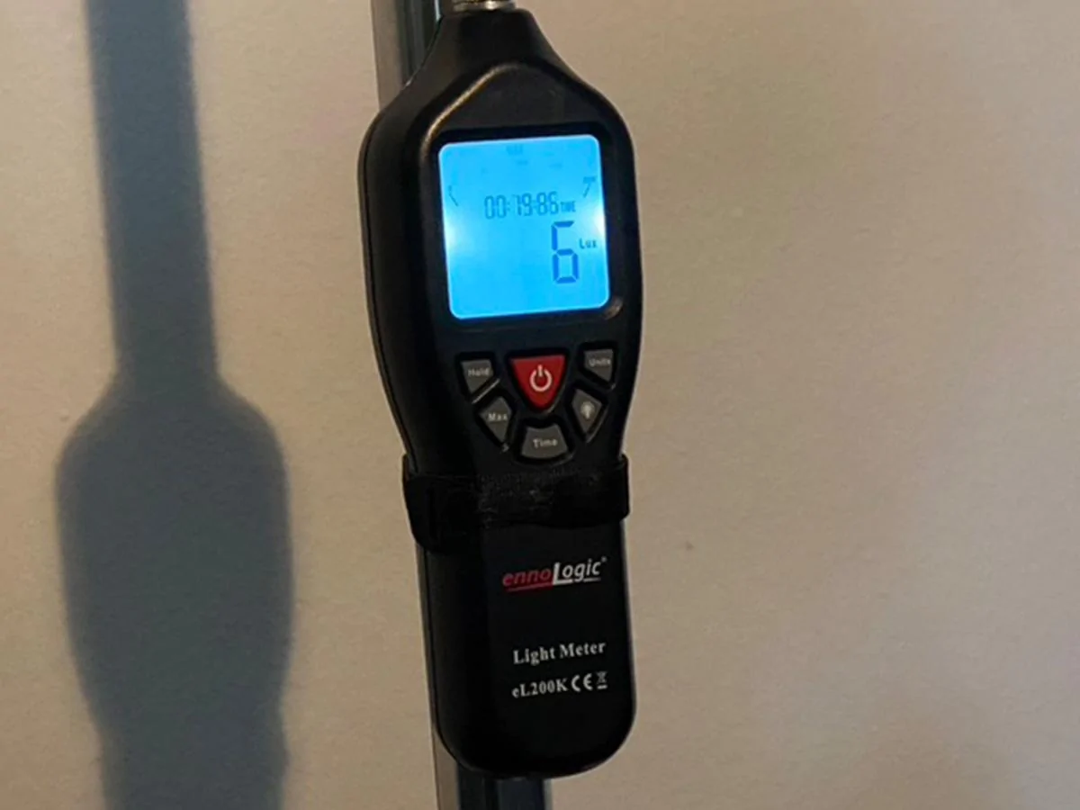

First up the factory Halogen light- Brightness of 6 Lux Max.
Jeep Wrangler JL Rear Bumper Integrated LED Reverse Lights 2-IMG_2158

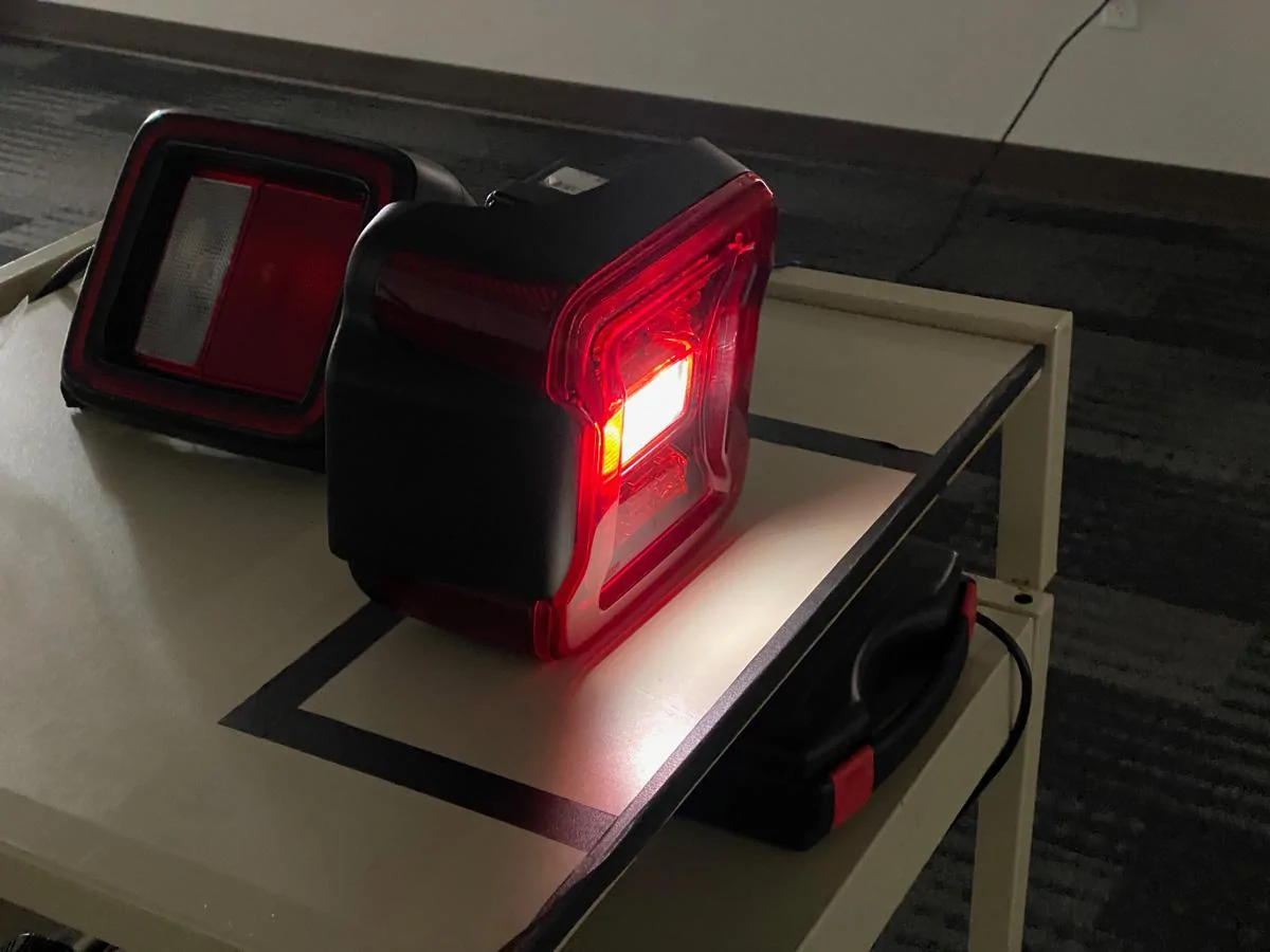

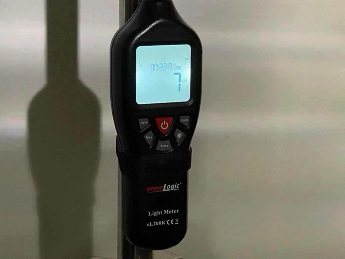

Next up the factory LED Tail light- Brightness of 7 Lux Max.
Jeep Wrangler JL Rear Bumper Integrated LED Reverse Lights I3MG_2158
Last up is the new LED Bumper Light Prototype- Brightness of 122 Lux Max.

Does the color temperature match?
Good question. For the LED tail lights the colors are close since they are both neutral color LEDs. For the halogen tail lights the halogen bulb looks yellow and dingy when compared to the LED but we do have a solution for that. We offer a LED bulb upgrade for the halogen tail lights that matches and we will have a package for the group buy to get a discount on both of you want to upgrade your halogen bulbs to LED at the same time.

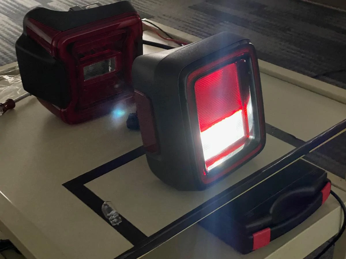

Here is the same tail light with the ORACLE 5133-001 LED bulb installed:
Jeep Wrangler JL Rear Bumper Integrated LED Reverse Lights IMG_2177
The 5133-001 LED Replacement Bulbs actually make the factory tail lights brighter than the factory LED reverse lights.
