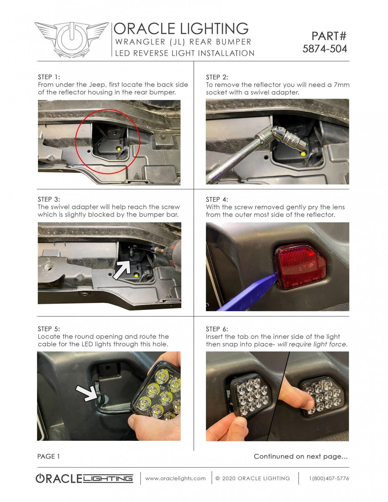

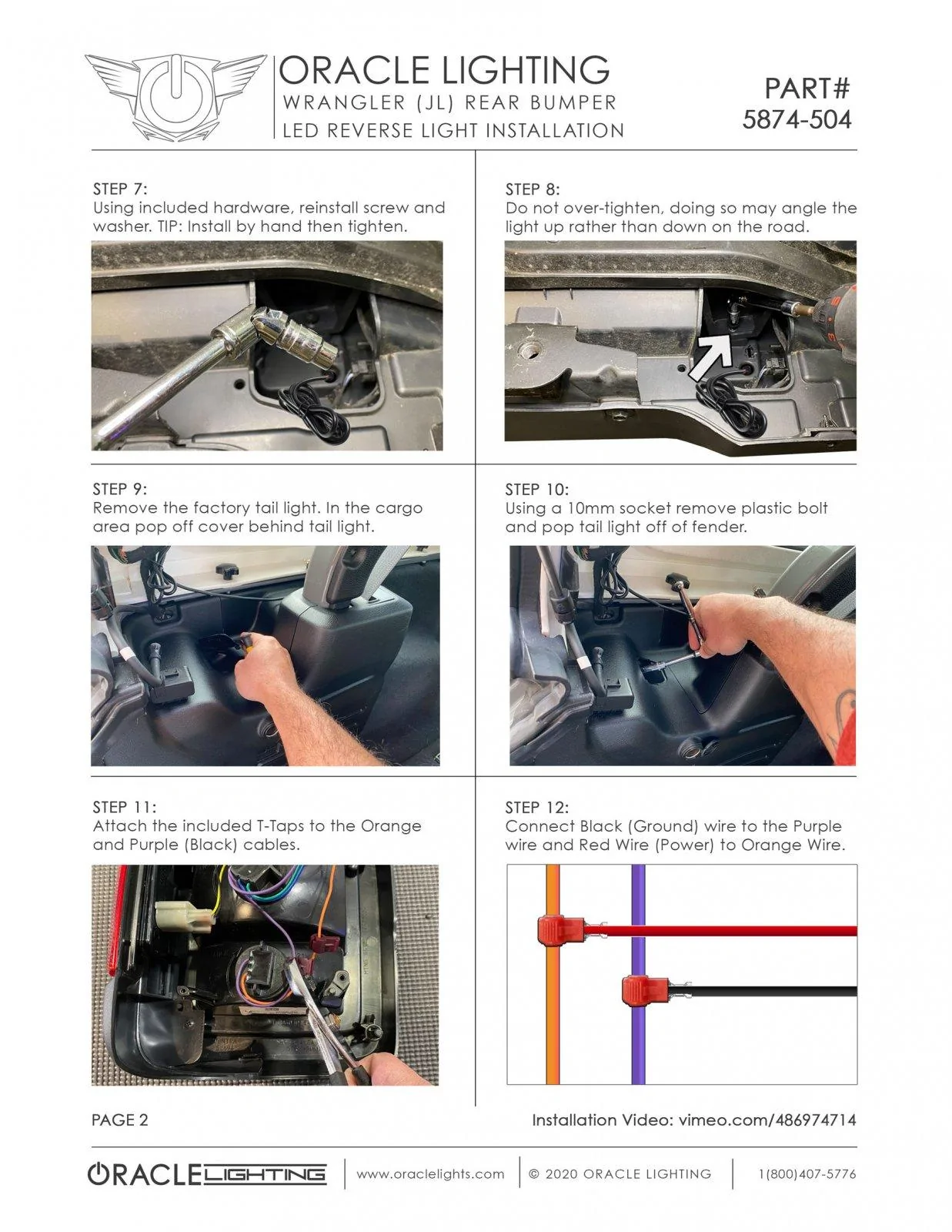

Could we see a copy of the installation instructions? It would be useful to see what is involved prior to the final purchase.
Jeep Wrangler JL Rear Bumper Integrated LED Reverse Lights 5874_Instruction_1
Jeep Wrangler JL Rear Bumper Integrated LED Reverse Lights 5874_Instruction_2

Awesome! Simple install!

This looks like the bumper is removed. Does this require a bumper removal before starting?
There’s nothing in the instructions about removing bumper. Seems pretty straightforward forward to me
Nope, you're going from underneath first and then popping in/out while the bumper is still on.

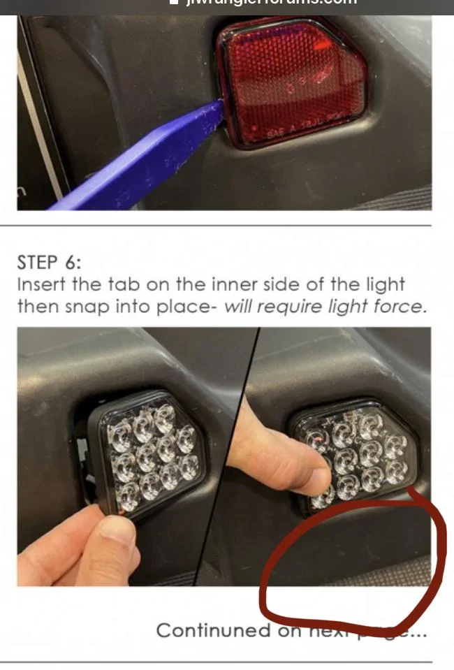

Step 1-3 appear to have the bumper removed (given the angle of it) and as you can see in step 6 the bumper appears to be sitting on a table...
ive circled it to make it more obvious for you...

Weird. Step 1-3 appear to have the bumper removed and as you can see in step 6 its sitting on a table...
Yes, our bumper is on the bench. One because our Jeep runs an aftermarket bumper and two to get quality photos for the guide. But like mentioned, you do not remove the bumper for install so it's super easy to do yourself. ?
