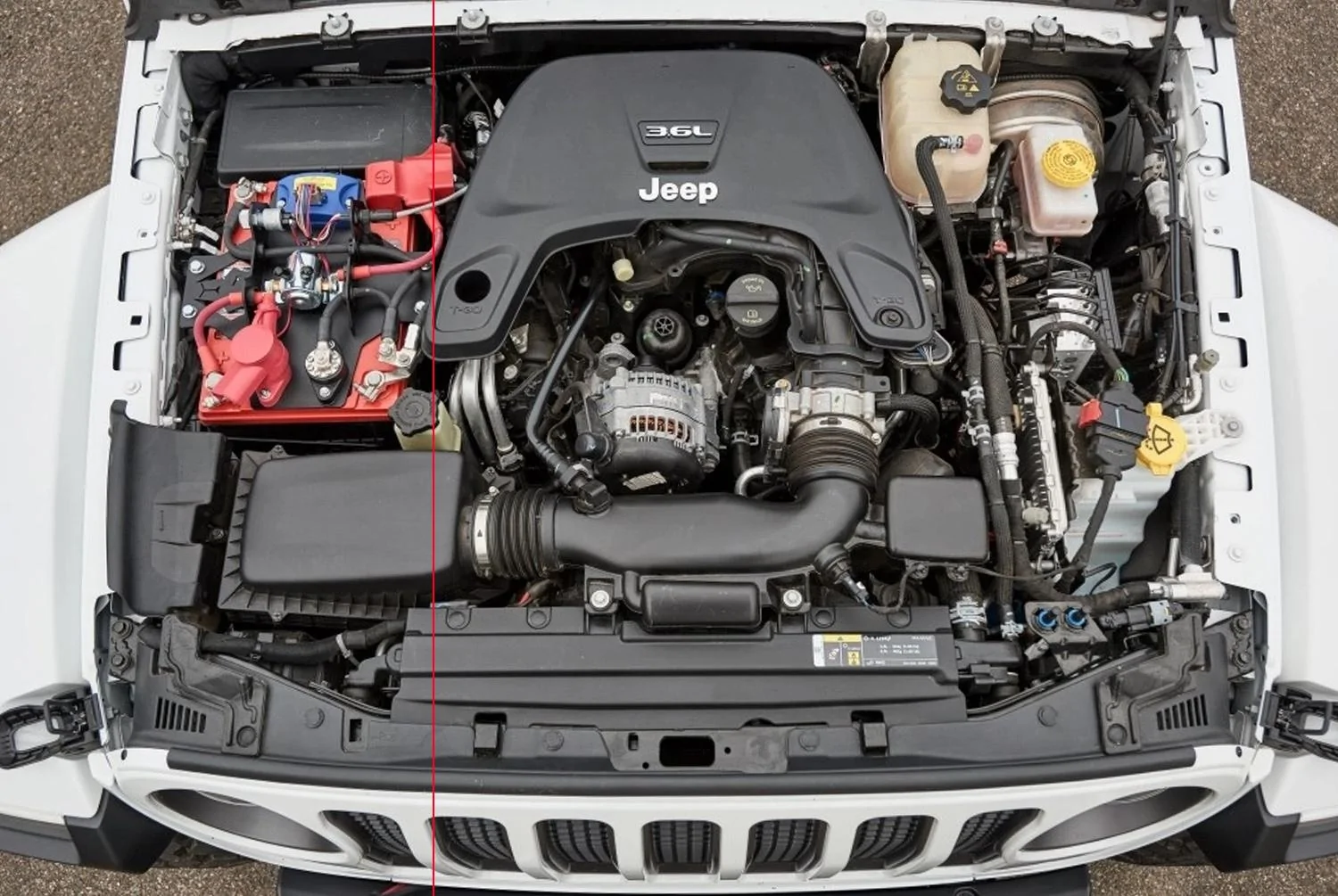

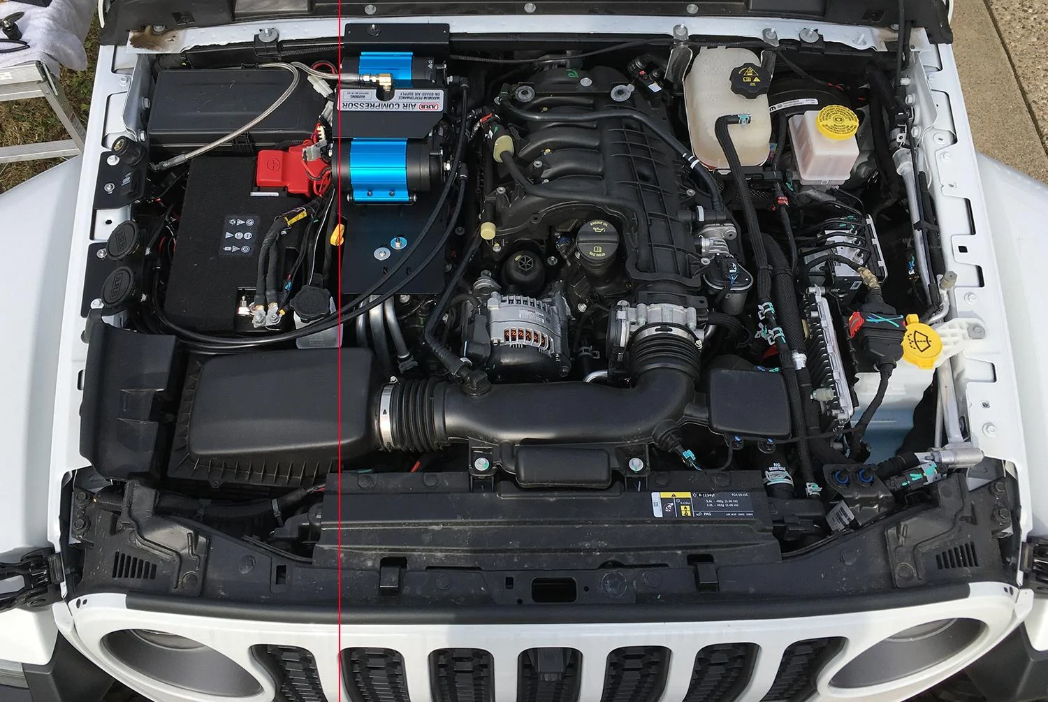

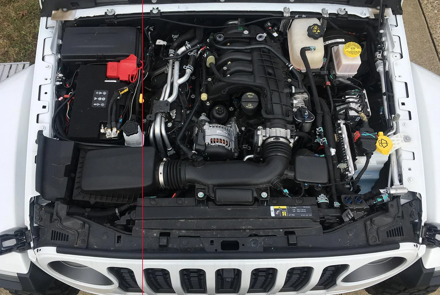

I have not tested it with the Genesis setup, but will be willing to work with someone that has it to see how fitment works. I made the following comparison photos using the photo from the Genesis site and my JT.
I have everything now, just waiting on the heat shield to arrive so I can apply it to the base mount. I will be working on install instructions, hardware packs, etc. this week and weekend. I should have them on the website next week. I can't add the website URL since I am only able to advertise on the Gladiator forum at the moment. 813fabrication is my site.
Jeep Wrangler JL Mounting ARB Air Compressor COMPARE-1
Jeep Wrangler JL Mounting ARB Air Compressor COMPARE-2
Jeep Wrangler JL Mounting ARB Air Compressor COMPARE-3

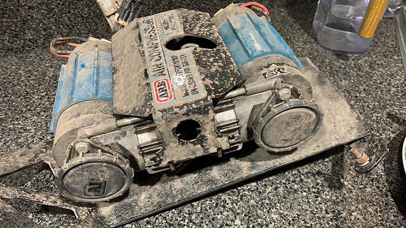

I don't disagree that it will be exposed to heat. As you say, it depends on how someone wants to set up their system. I will be offering a couple different plates for moving the filter/air intakes to a different location to feed a little cooler air. Given the lower mounts that go behind the wheel are sitting directly beside the CAT, I believe those are getting more heat. Enough heat actually that I have seen people remove the compressor due to fittings and wires melting. Most everything in that location is covered with heat shield. Not to mention they are at risk of water and mud damage. I had a customer buy one of our behind the seat mounts because his ARB twin was killed behind the wheel. Every location on the JL/JT will have pros and cons, it just depends on how someone wants to use it and what they want with their setup. This is why I have a mount for almost every location needed for the JT. Bed, in-cab, MOLLE panel, under-seat, behind-seat and under the hood.
Attached is a pic of the customers ARB from behind the wheel. Many have asked for another solution for above the engine. It won't be for everyone but many have ran them like that for years on the JKs.
Jeep Wrangler JL Mounting ARB Air Compressor toast

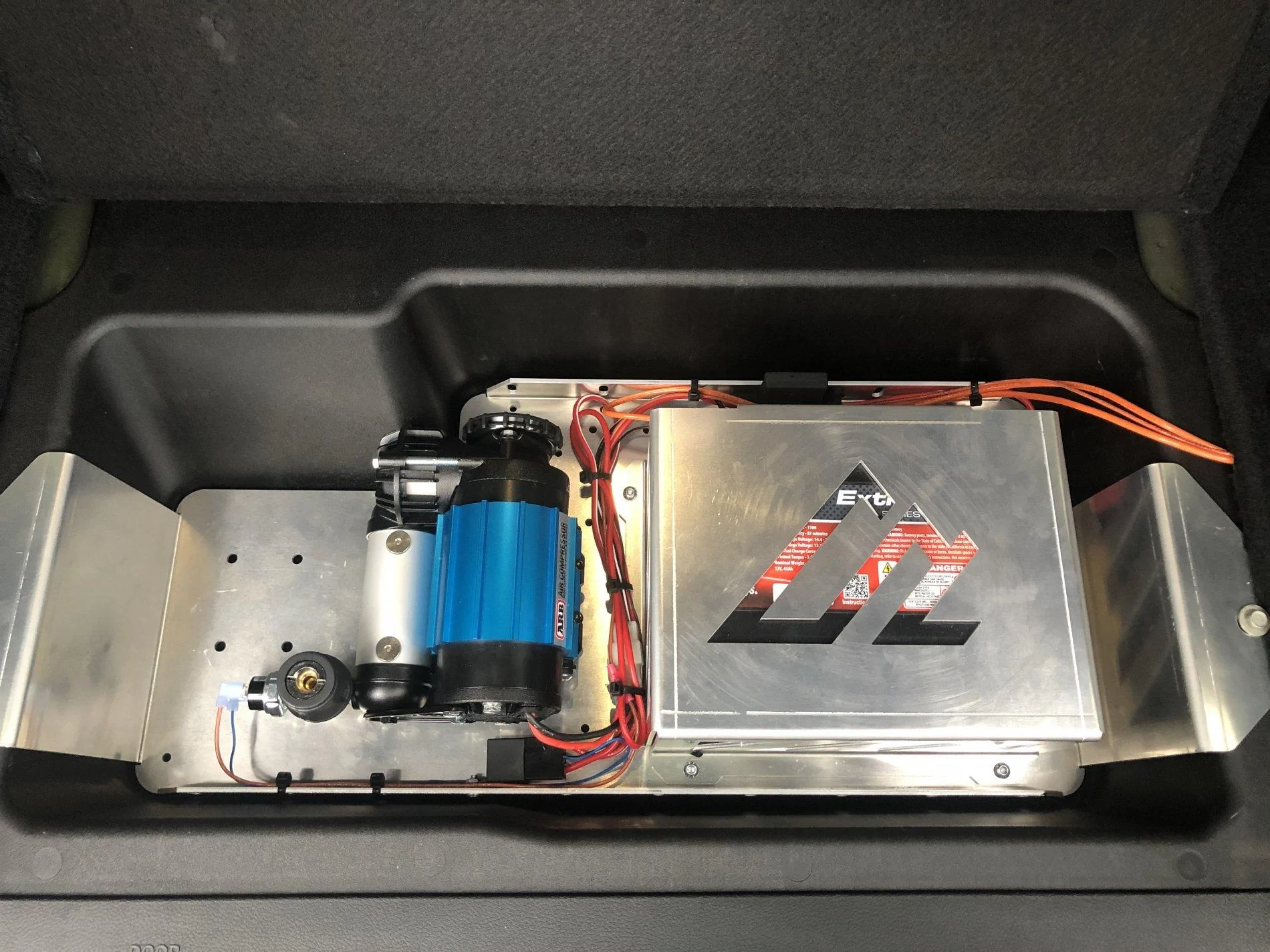

Just installed my single ARB compressor last night. Used the Aventure Lab rear tub mount and added the battery for s**** and giggles.
Jeep Wrangler JL Mounting ARB Air Compressor 7CBC1AA1-D080-4BB2-BF67-9FB8944BA740

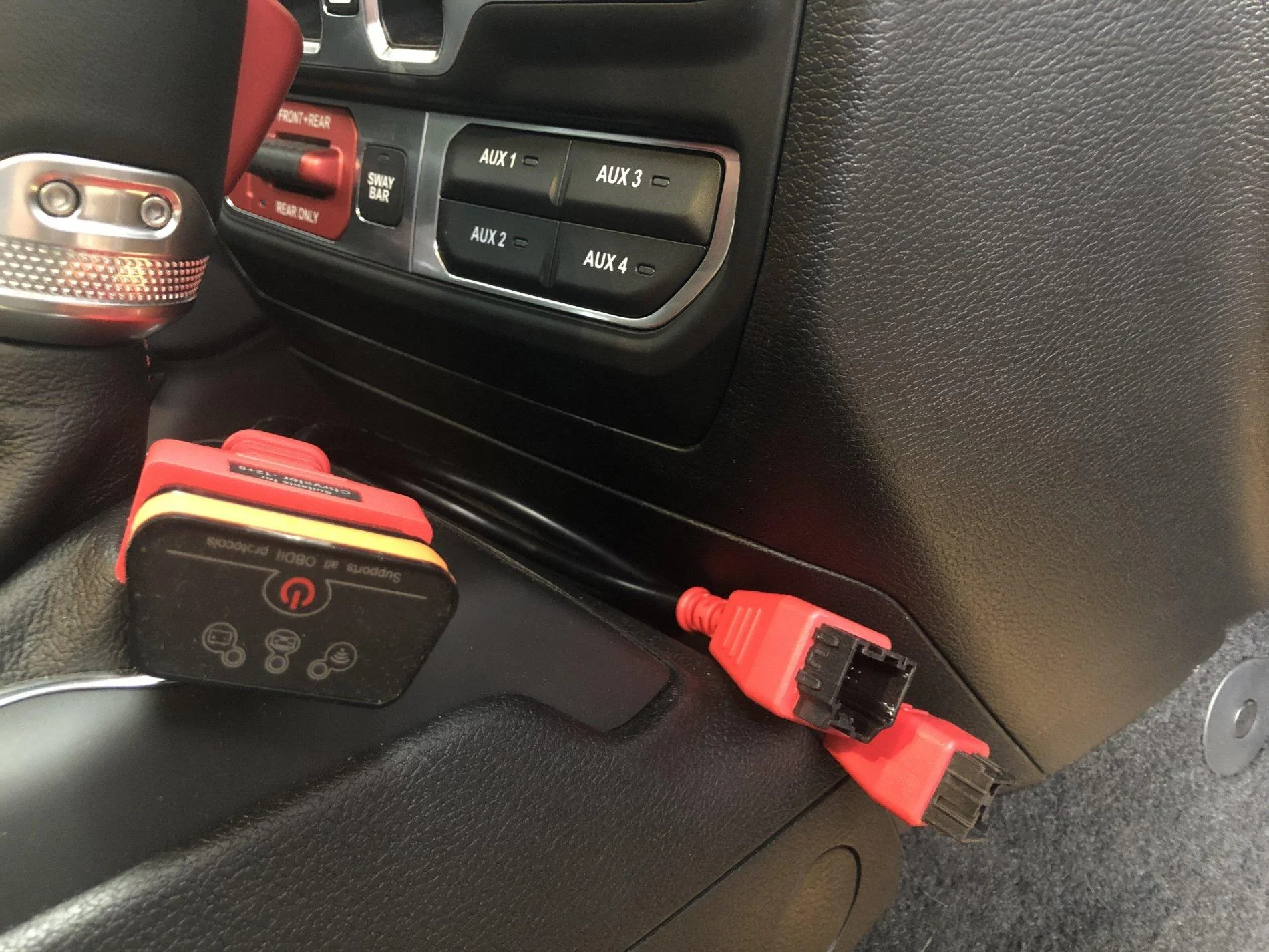

I fell I rushed the install, i was more concerned with the Mopar aux switch install to operate the compressor and didn't take my time with wire management. I will fix it latter.
Jeep Wrangler JL Mounting ARB Air Compressor Mopar Aux Switches
