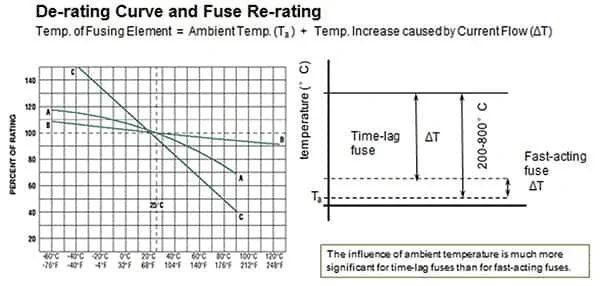

@Go4Low if you want an understanding of how your 40A fuses are really 30A fuses at room temperature (77F) and just continue to go down from there in rating as ambient temps increase under your hood, and how the effective AWG of your wiring is also reduced while the amperage draw of the compressor rises during high heat and loading, just hit me up. Not saying this is your problem, just saying this could be your problem.
I'm not as refined so let me help.
